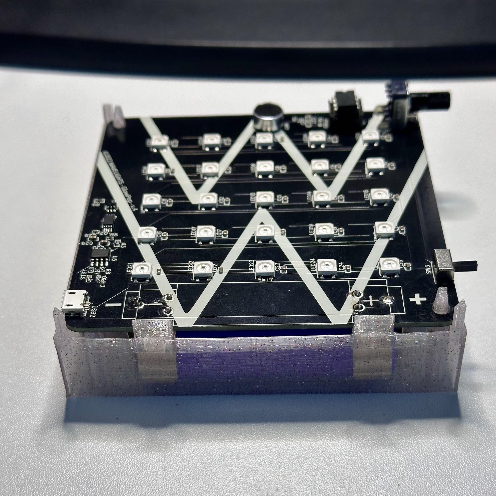

this show the "crystal-glowpop-bottom.stl" printed with clear PLA, you just insert the PCB and it snaps in place:

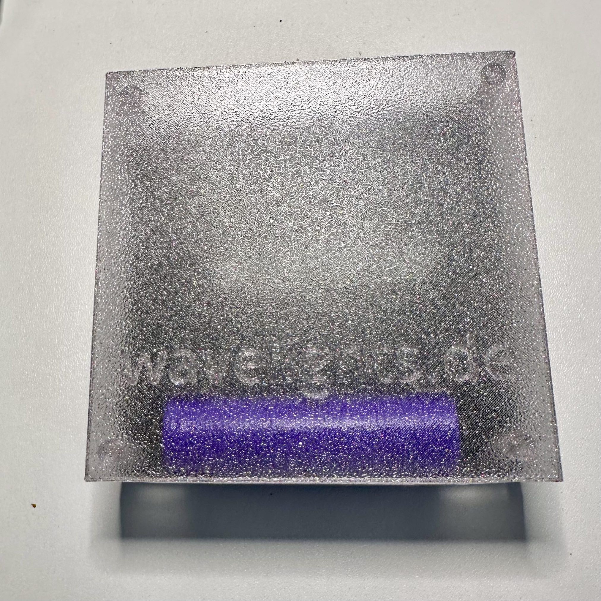

Bottom view with the battery visible:
this show the "crystal-glowpop-top.stl" printed with clear PLA, you just push the top an bottom together:
