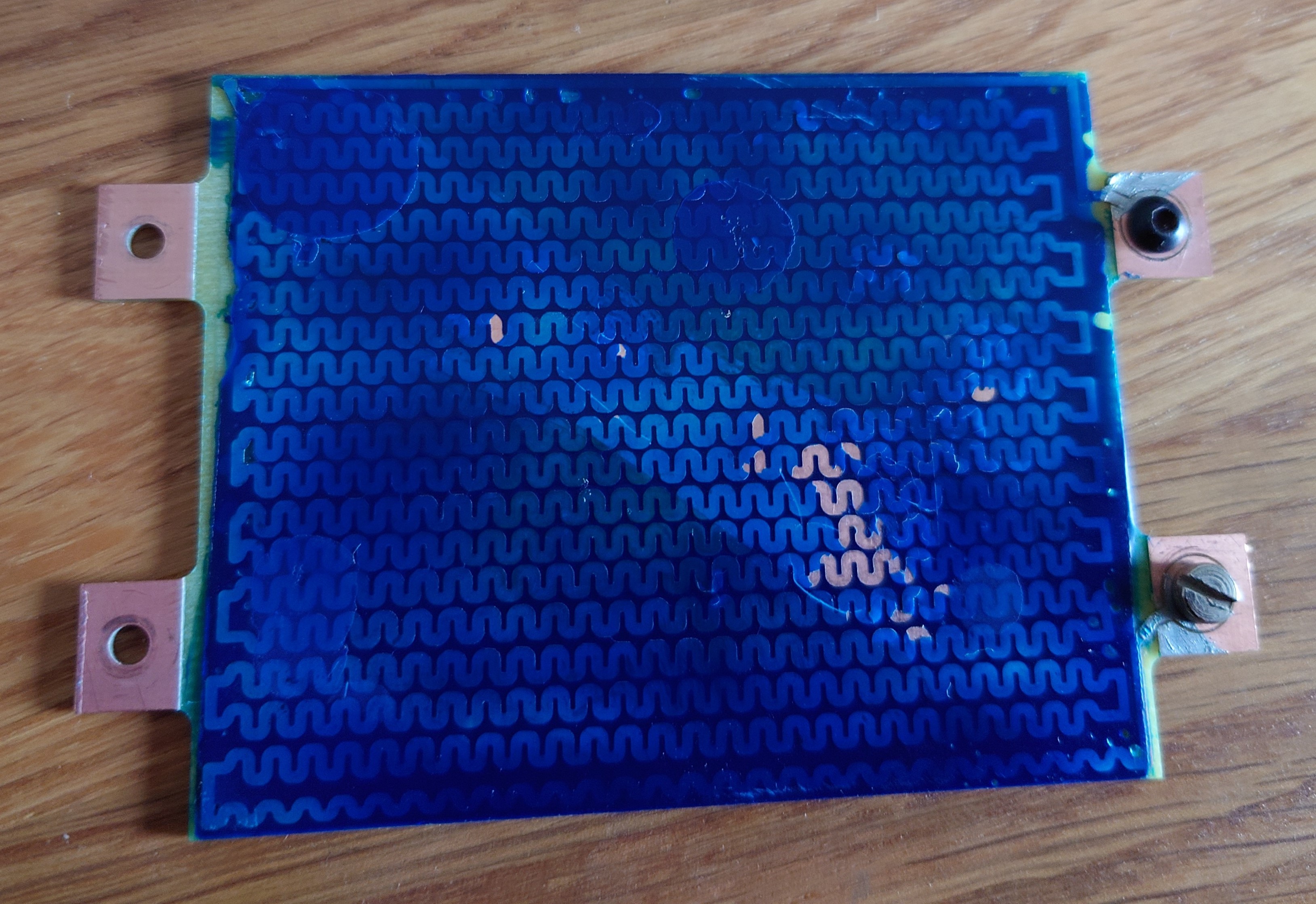

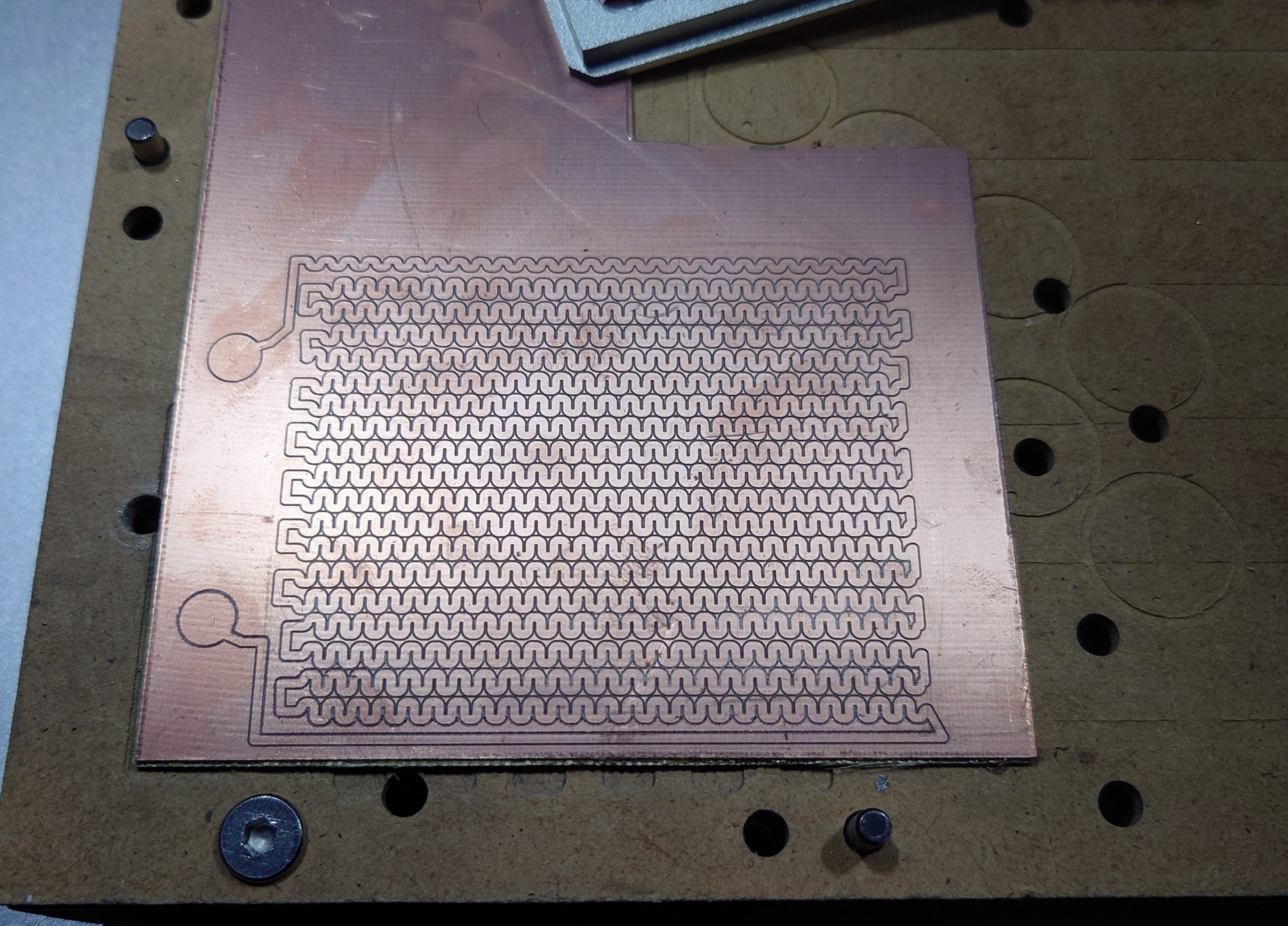

I wanna start the design with the centerpiece of this device, namely the heating element. There's a lot of good way to make a decent heater for a hotplate and I probably picked the worst one - an FR4 PCB, whose top layer has been routed into a long wire acting like a heater. But the reasoning for this decision is simple - the design works for lower temperatures where I intend to operate, and I have the capabilities to make PCBs at home, which means no extra parts needed. But I do expect it to fail at some point and have some ideas for improvements - but more on that in the project logs. Here, we talk the build :)

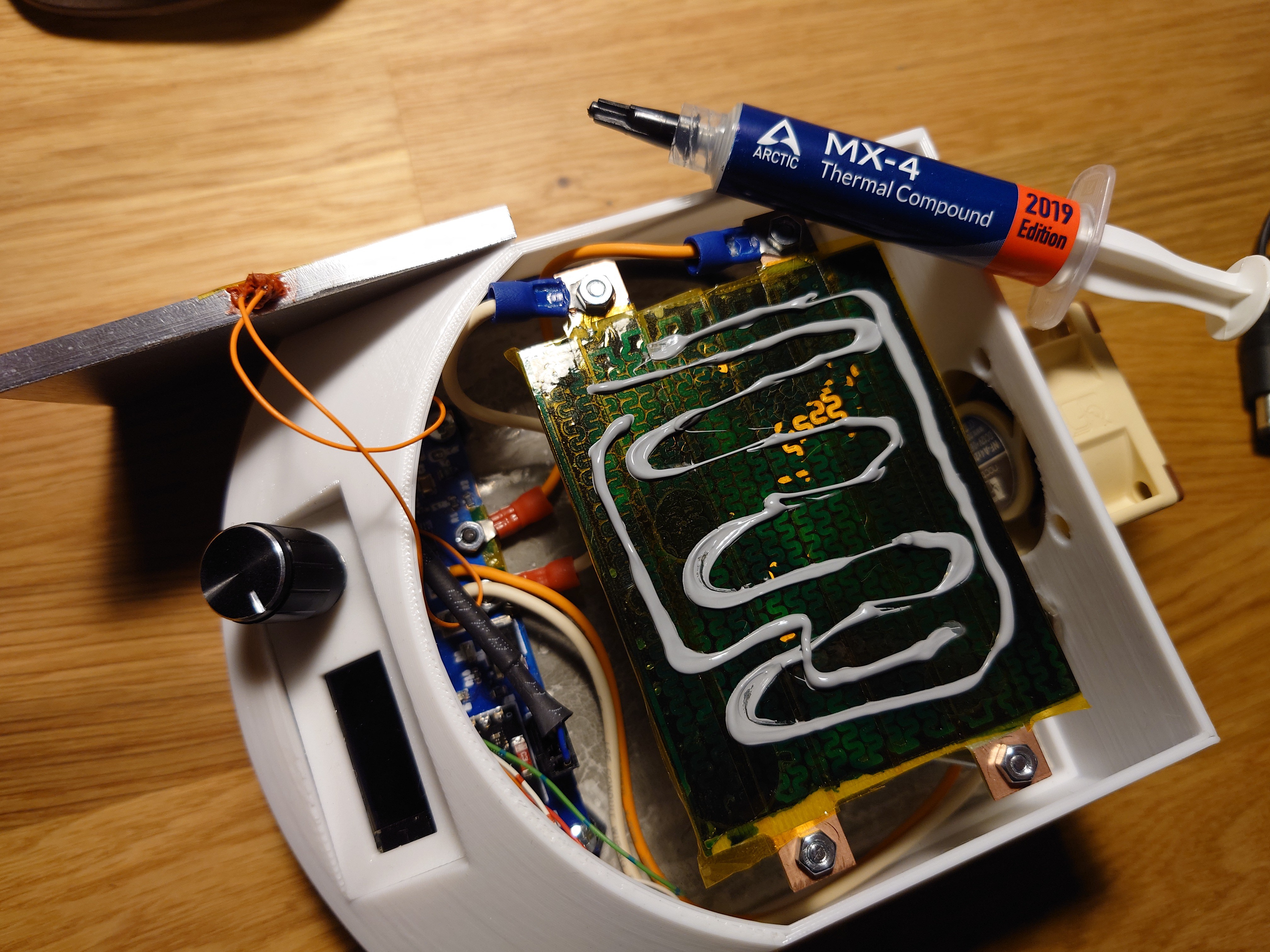

I went through the trouble of coating the board with soldermask, but that turned out to be a waste. Few heating cycles later, the soldermask started to chip off. To be on the safe side, the board got a layer of kapton tape before assembly to aid the electrical insulation. To help distribute the heat more evenly, I slapped a slab of aluminum on top of the heater - right after applying a nice coat of thermal paste. The thermal past specifies continuous use temperature of 150ºC so I'm curious to see long term effect.

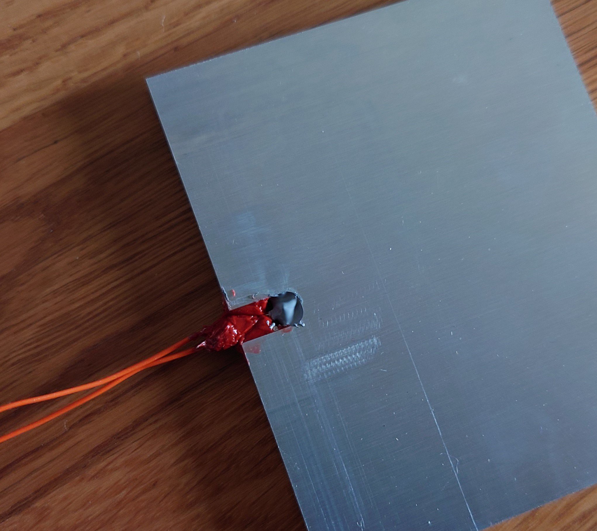

Aluminum plate is milled from a 5mm plate with a small slot for a PT100 temperature sensor, and the temperature sensor is fixed with the help of some high-temperature silicon, while the tip of the sensor is brought in contact with the aluminum, and the whole connection again bathed in thermal paste.

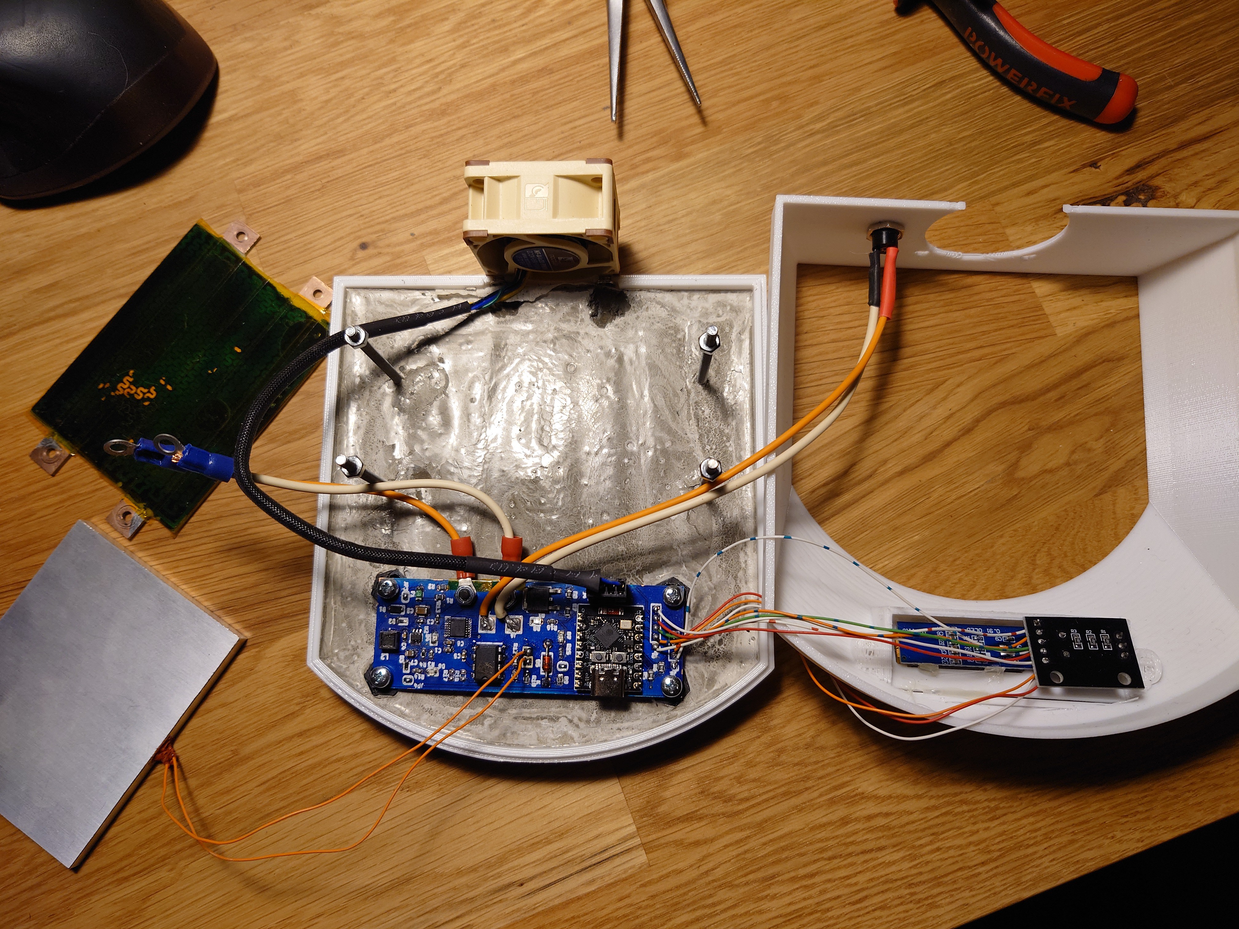

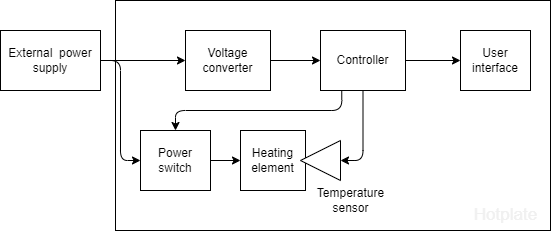

Electronic design started pretty simple, but then a couple of "fun" features snaked in as well. Both the schematic and kicad project can be found in the github repository attached to this project. But to give a short overview, there's a 5V buck converter built around RT6200 (using the reference schematic), connectors for OLED screen and rotary push button, no big surprises there. But then I went with Wheatstone bridge for PT100 for which I thought it would be fun to have a 3V zener voltage reference for no particular reason except that I've never done it before and really wanted to try it out. (Well, actually I hoped it would be more stable than 3.3V power supply to feed the bridge)
On the list of "definitely unnecessary" is an INA250-based current monitor, measuring just how much power is consumed by the heater. But I had one lying around, so why not?
To drive the heater, I picked a simple recommendation from a friend of mine. I opted to not use a gate driver circuit, mostly because I wanted to keep things simple and could live with having a very low PWM frequency of sub-1Hz to drive the FET.
Oh, and there's also a connector for a fan, because I thought it would help with the temperature of internals to have a fan blow some...
