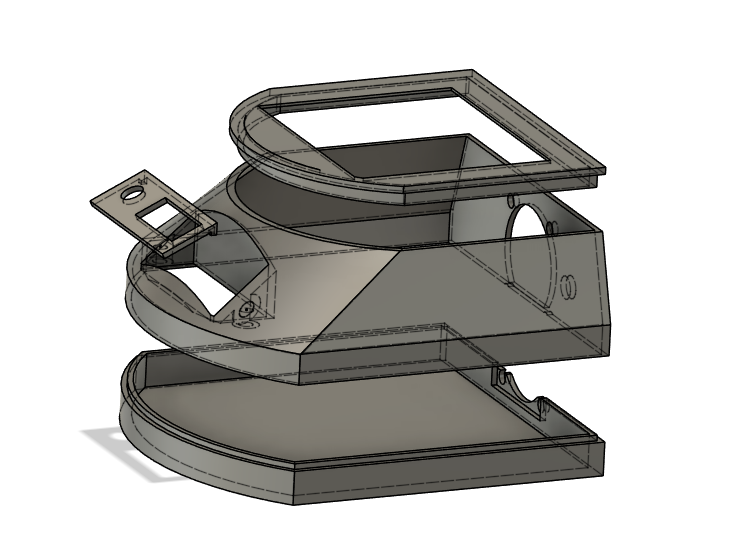

Casing
Casing for a project is the part I usually overlook the most and end up spending most of the time on. In part because I would like it to look and feel nice, but in part probably because I just don't have enough experience with designing housings (I'm a firmware guy by trade).
I went for a modular design, where the main case is split in half, for ease of assembly and printing. There is also a cap on top which is printed separately to match the placing of the heating element which doesn't have a strict placing position.
The mounting plate for HMI is also a separate component so that it's possible to play with angle of the plate, and distance to the electronics underneath. Namely, to place the PCB as far away from the heat, it resides right under the HMI section.
