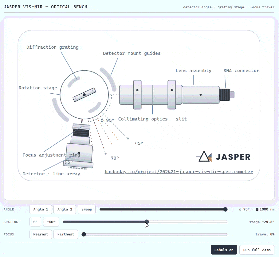

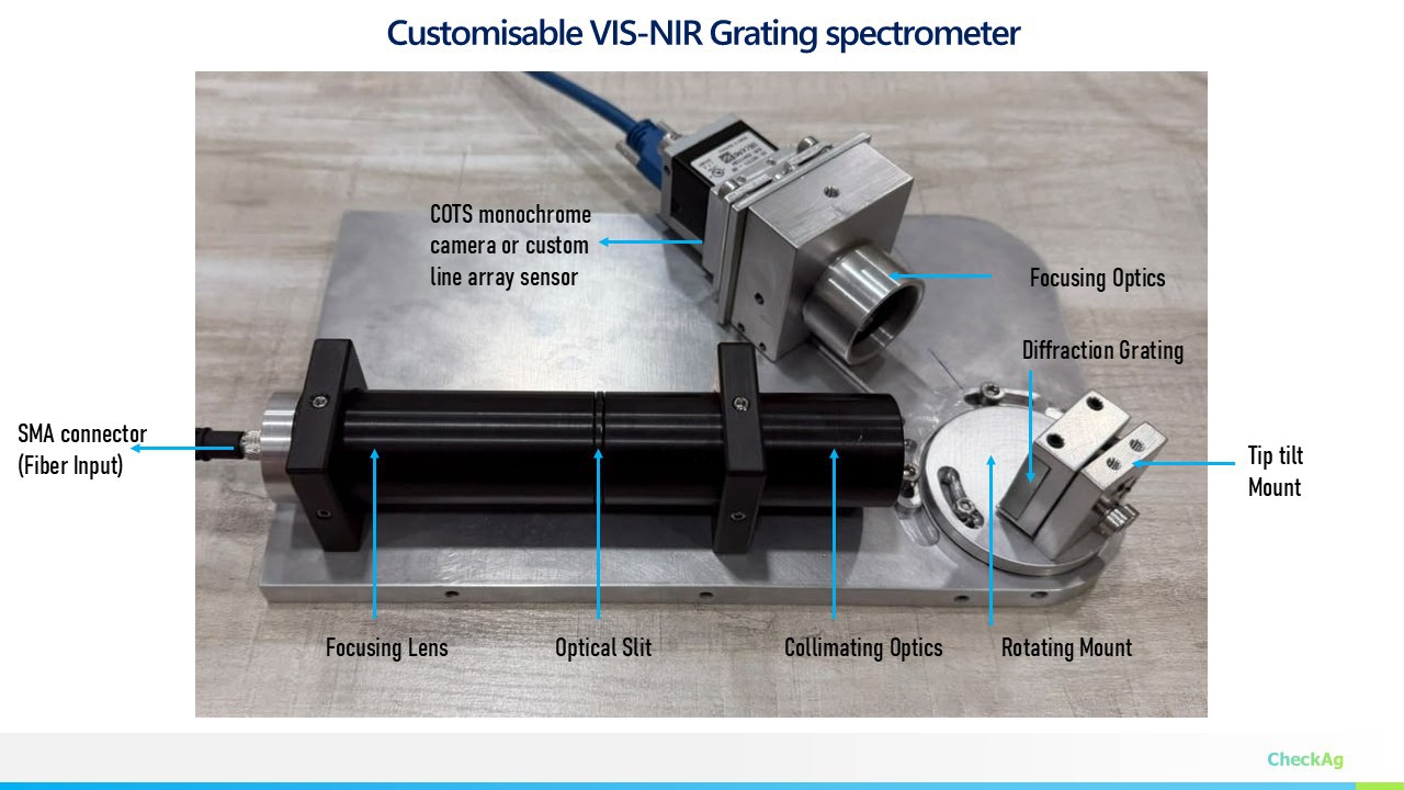

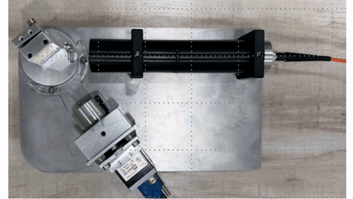

Customizability:
The real magic of JASPER VIS-NIR Spectrometer lies in its mechanical adjustability. JASPER allows you to customize your spectral span, resolution, efficiency, and sensor choice on the fly:
  • Adjustable Grating Engine: The diffraction grating is mounted on a precise rotating mount with integrated tip-tilt adjustments. Want to target a specific blazed wavelength or shift your spectral window? Just loosen, rotate, and lock it in.
  • Interchangeable Slits & Optics: Easily swap out the optical slit to balance throughput and resolution, or modify the focusing and collimating optics to suit your target application.
  • Variable Focal Lengths & Angles: The detector assembly is mounted on a sweeping curved track, allowing you to accommodate different focal lengths and align perfectly with any custom grating angle.
  • Dual Detector Compatibility: Choose your sensing paradigm. Plug in a commercial off-the-shelf (COTS) monochrome camera for quick spatial-spectral testing, or drop in our custom line array detector PCB for high-speed, dedicated industrial sorting.

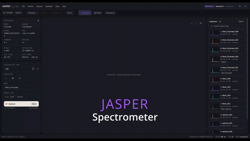

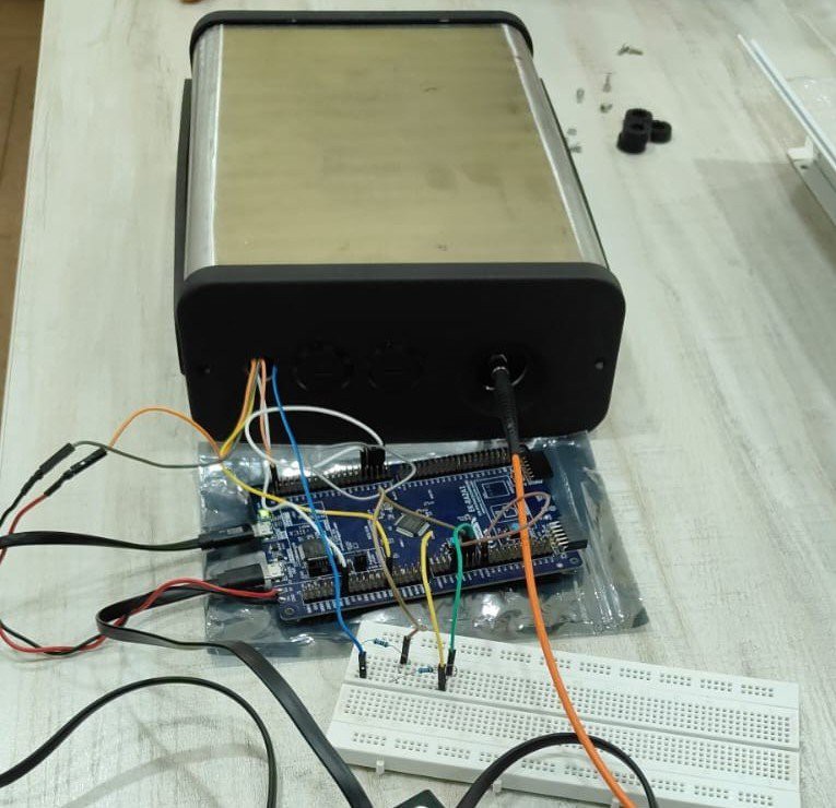

    This week we connected JASPER VIS-NIR Spectrometer to Claude through an MCP server. The video is a run on the bench:
    • Claude queries the device: real USB unit (/dev/ttyACM0), TCD1304AP
    • firmware 0.1, protocol v1, integration range 16-10000 ms
    • We ask for a capture at 100 ms integration with 10 averages
    • JASPER captures, and the GUI updates live, because the GUI and the MCP server talk to the same device service
    • Claude reports the result (peak about 34% of the 32,767 full scale, so nothing saturated) and flags, unprompted, that no dark was subtracted
    The hardware is a work in progress: optics in the enclosure, electronics on a Renesas RA2A1 evaluation board on the bench. Optical optimisation is ongoing, so the x axis is still in pixels; wavelength calibration against Ne/Ar lines comes next.

    Signal chain today
    TCD1304 output (OS) -> transistor (PNP emitter-follower) buffer on the sensor board -> RA2A1 16-bit SAR ADC, single-ended, with the on-chip DAC setting the offset reference -> ping-pong buffers in SRAM -> USB CDC-ACM -> PC.
    This works, with two limits we want to remove:
    • No gain stage, so the signal uses only part of the ADC range even in bright light.
    • The transistor's base-emitter voltage drifts with temperature (about -2 mV/°C), which shows up as a slow baseline drift.
    Next: two boards
    • Sensor board: the TCD1304 with an external amplifier right next to it. Keeping the CCD's output path short and amplifying before the signal leaves the board protects it from noise picked up on the cable.
    • MCU board: the RA2A1, generating the sensor clocks, setting the offset reference with its DAC, digitising the amplified signal and sending frames over USB.
    Splitting the boards also means the sensor board can change (TCD1304 or Hamamatsu) without touching the MCU board.

    Firmware frames go to a device service on the PC. The GUI, Python scripts and the MCP server all go through that one service, so they share live  state. The firmware reports its limits (integration time 16-10000 ms), and the plan is for the service to enforce them for every caller, including Claude.

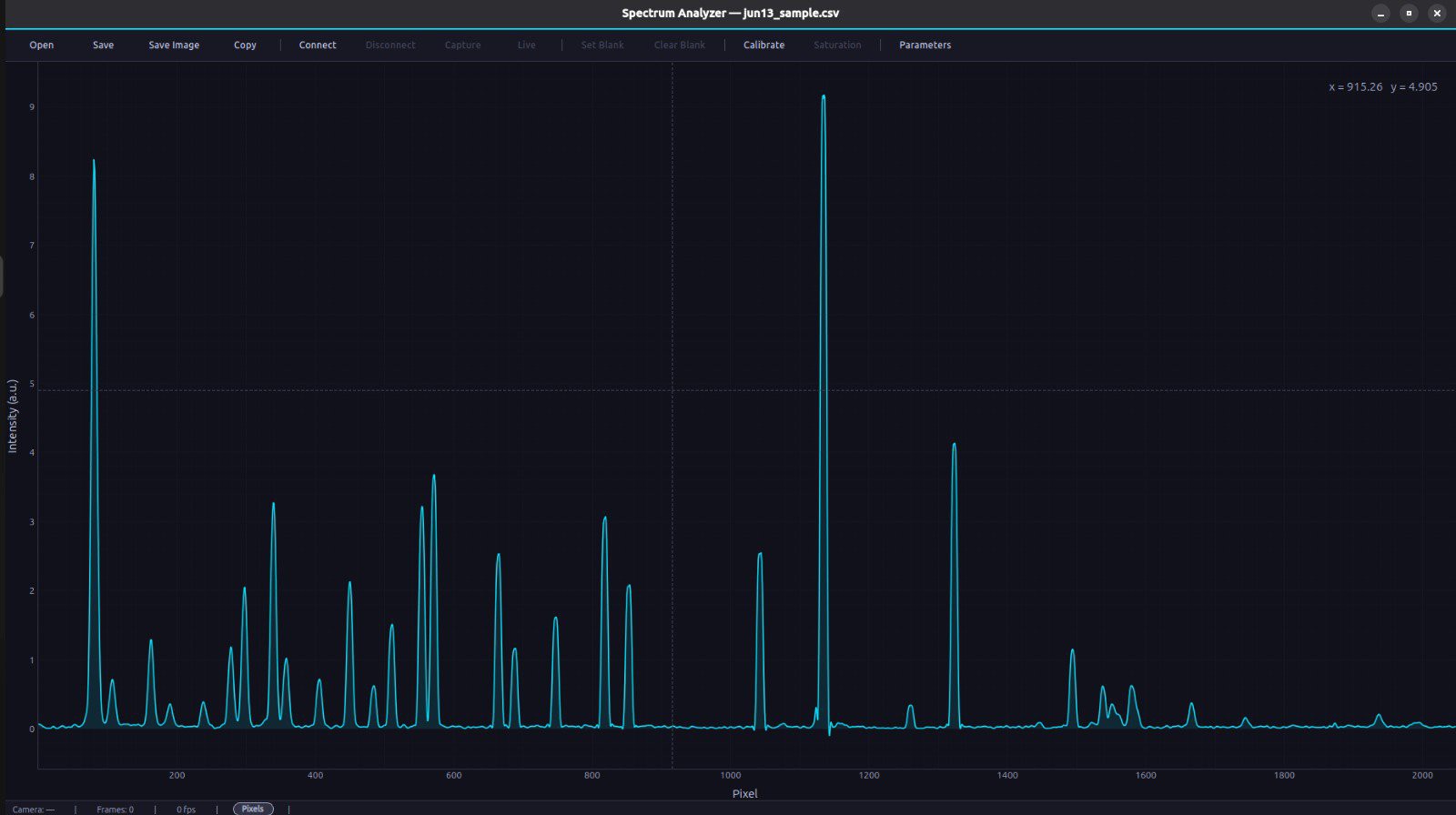

    • x axis in pixels until the Ne/Ar wavelength calibration is done

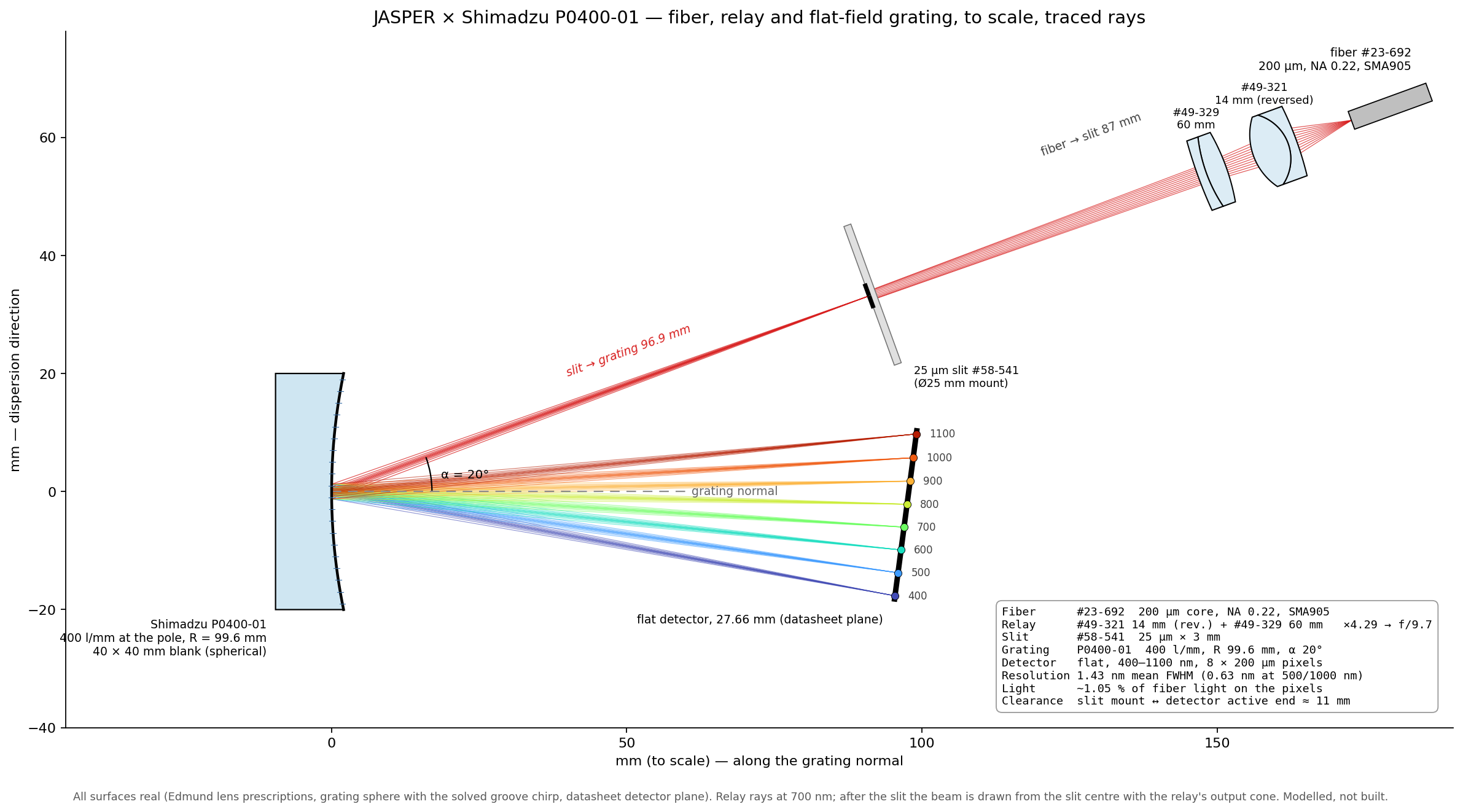

    Where we were. The last log designed JASPER around a single concave variable-line-spacing (VLS) grating that disperses and focuses 500–1000 nm onto a linear CCD. That grating was an ideal: a custom groove pattern that exists only in our model. A two-beam holographic exposure could write it — the repo now includes that check (recording_optimize_sim.py: a 488 nm exposure matches the fitted grooves' resolution to within 0.02 nm) — but it is not a part anyone sells, and a custom holographic master is out of reach for a small open project. A spectrometer you can't source isn't a design, it's a study.
    This log is the practical version. Every optical part is a catalog item:
    • Grating: Shimadzu P0400-01 flat-field concave grating — 400 l/mm, 400–1100 nm, full mount published.
    • Fiber: Edmund #23-692, 200 µm core, NA 0.22, VIS-NIR, SMA905.
    • Relay: Edmund #49-321 (14 mm) + #49-329 (60 mm) achromats, ×4.3 — turns the fiber's NA 0.22 into ~f/10 at the grating.
    • Slit: Edmund #58-541, 25 µm × 3 mm.
    • Detector: TCD1304-class linear CCD, 8 × 200 µm pixels, on the datasheet's detector plane.
    The one unknown: the grooves. Shimadzu publishes the mount but not the groove pattern — the P0400-01 is an aberration-corrected holographic grating whose chirp is proprietary. So we reconstructed it from the datasheet. The groove density across the blank is
    nu(y) = 400 + C1*y + C2*y^2 + C3*y^3      (lines/mm, y in mm from the grating centre)
    and here is how each piece is pinned down:
    1. 400 l/mm is at the centre. The grating equation with 400 l/mm at the pole gives diffraction angles of −10.49° (400 nm) and +5.62° (1100 nm) — exactly the datasheet's. If 400 were at either edge of the blank, the 1100 nm angle would miss by 0.12° or 0.76°, and the datasheet quotes it to 0.01°. That pins the centre density to 400 ± 0.16 l/mm.
    2. The detector is one flat tilted plane. The datasheet's two exit distances (97.1 mm at 400 nm, 99.5 mm at 1100 nm) are the two ends of a single flat detector, which the datasheet also gives directly: r′ᵢ = 96.9 mm from the grating, normal at βᵢ = −7.51°. All four printed numbers agree for r′ᵢ = 96.92–96.95 mm; we use 96.93.
    3. The radius of curvature comes from the blank. It isn't printed, but the blank is 9.5 mm thick at the centre and 13.6 mm at the corners (28.3 mm out): R = (h² + s²)/2s = 99.61 mm. A free fit gives 100.00 mm and the classical focus condition 100.29 mm — three estimates within 0.7 %.
    4. What each coefficient does. C1 corrects defocus: the defocus term becomes F20 = cos²α/r − cosα/R + cos²β/r′ − cosβ/R + λ·C1, so defocus vanishes at a wavelength when C1 = −F20,geom/λ. C2 corrects coma. C3 would correct the next order.
    5. Solve. With the centre density, detector plane and radius fixed, only C1–C3 are unknown. Ray tracing through the exact surface onto the fixed plane and minimising the spot size across 400–1100 nm gives C1 = +0.253 l/mm², C2 = −0.0172 l/mm³, C3 ≈ 0. Two independent checks agree: fitting C1 for a single wavelength in the ray tracer matches the analytic defocus condition to within 0.001 at all eight wavelengths (e.g. 0.300 vs 0.300 at 500 nm, 0.125 vs 0.126 at 700 nm, 0.244 vs 0.244 at 1000 nm). The groove density runs 388.1 l/mm at one edge, 400.0 at the centre, peaks at 400.9 l/mm 7.4 mm off-centre and falls to 398.2 at the other edge — a ~3 % chirp.
    6. A real exposure can write it. For seven common recording lasers (266–488 nm), a two-beam holographic exposure reproduces this chirp to within 0.1 l/mm across the illuminated aperture. Which laser Shimadzu used can't be told from the optics — any of them works with a suitable source layout.
    The model reproduces the datasheet's diffraction angles exactly and its 27.7 mm detector length (27.66 mm). That confirms the 400 l/mm at the centre — not C1–C3. Where each wavelength...

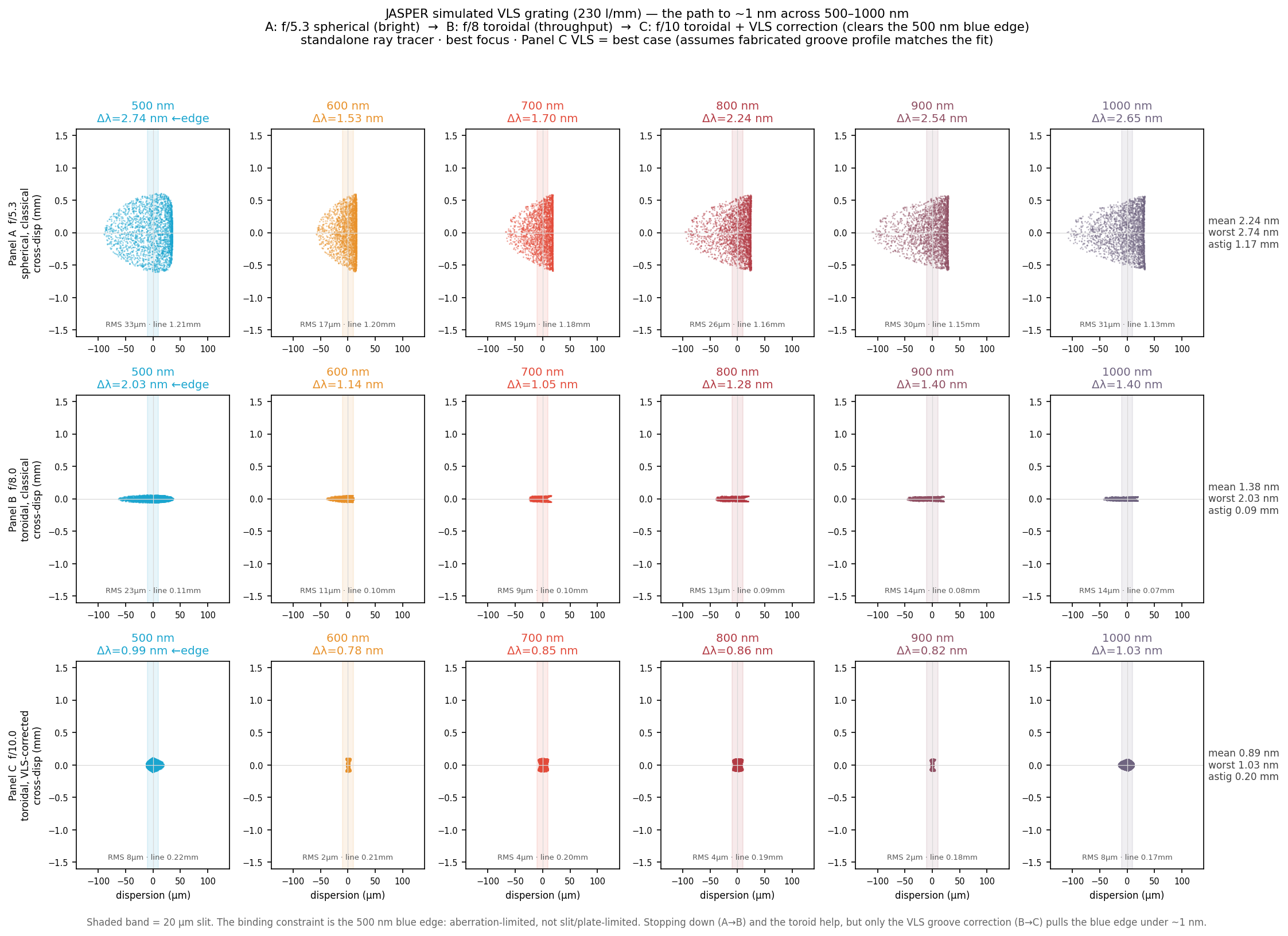

  • Toward 1 nm on a single concave Variable Line Spacing grating (VIS–NIR, modelled + code released)
    Tony Francis • 09/23/2026 at 17:39 • 0 comments
    Last time, a plano-cylindrical corrector flattened the camera's focal bowl and pulled mean resolution to ~1.9 nm — about a 40% gain — by patching our conventional collimator + grating + camera build. That corrected the design we had. This log is a different architecture: In place of the collimator and the camera lenses and let one concave variable-line-spacing (VLS) grating do both jobs — disperse and focus 500–1000 nm straight onto the detector.
    Up front: this one is modelled, not built yet — but modelled two independent ways that agree (analytic + ray trace), with all the code released. Posting it to get it constructive feedback before we commit.

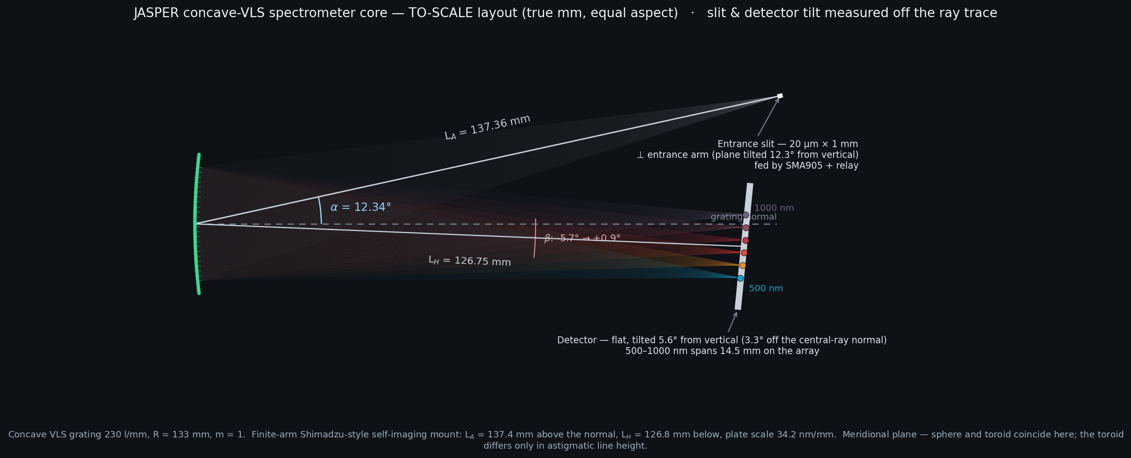

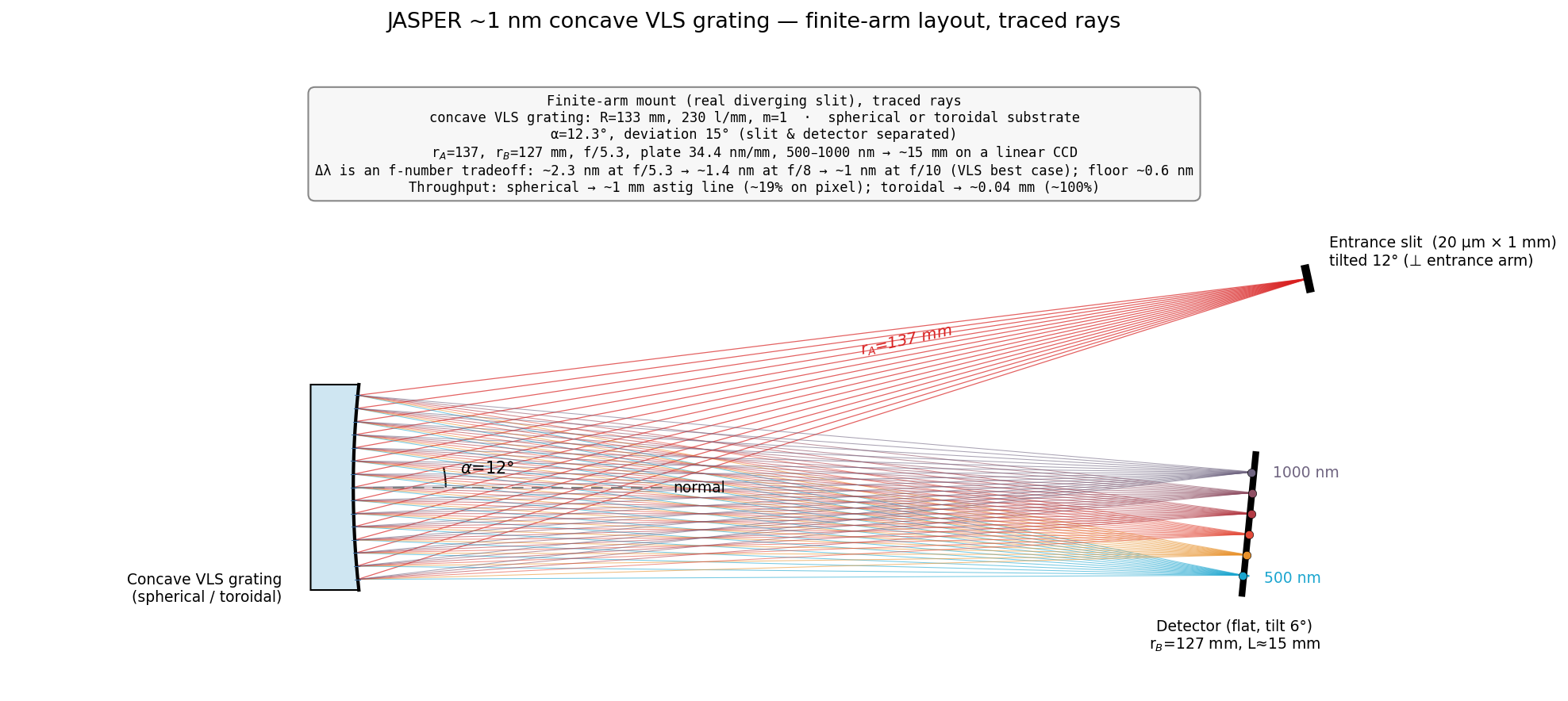

    The optical core
    One concave grating, no separate mirrors:
    • Grating: 230 l/mm, incidence ~12°, arms ~137 / 127 mm, R = 133 mm.
    • Plate scale: 34.2 nm/mm.
    • Detector: 500–1000 nm disperses across ~15 mm — sits on any linear CCD ≥15 mm; a $10 TCD1304 (29 mm, 3648 × 8 µm) covers it with room to spare. The same grating reaches ~400–1100 nm (~20 mm) if you want the wider NIR range.
    • Substrate — spherical vs toroidal: same resolution, but the toroid collapses the astigmatic line and boosts throughput ~25× (a throughput upgrade, not a resolution one).
    FIGURE: the optical core, real ray-traced (slit → concave surface → local VLS diffraction → tilted CCD), not a schematic

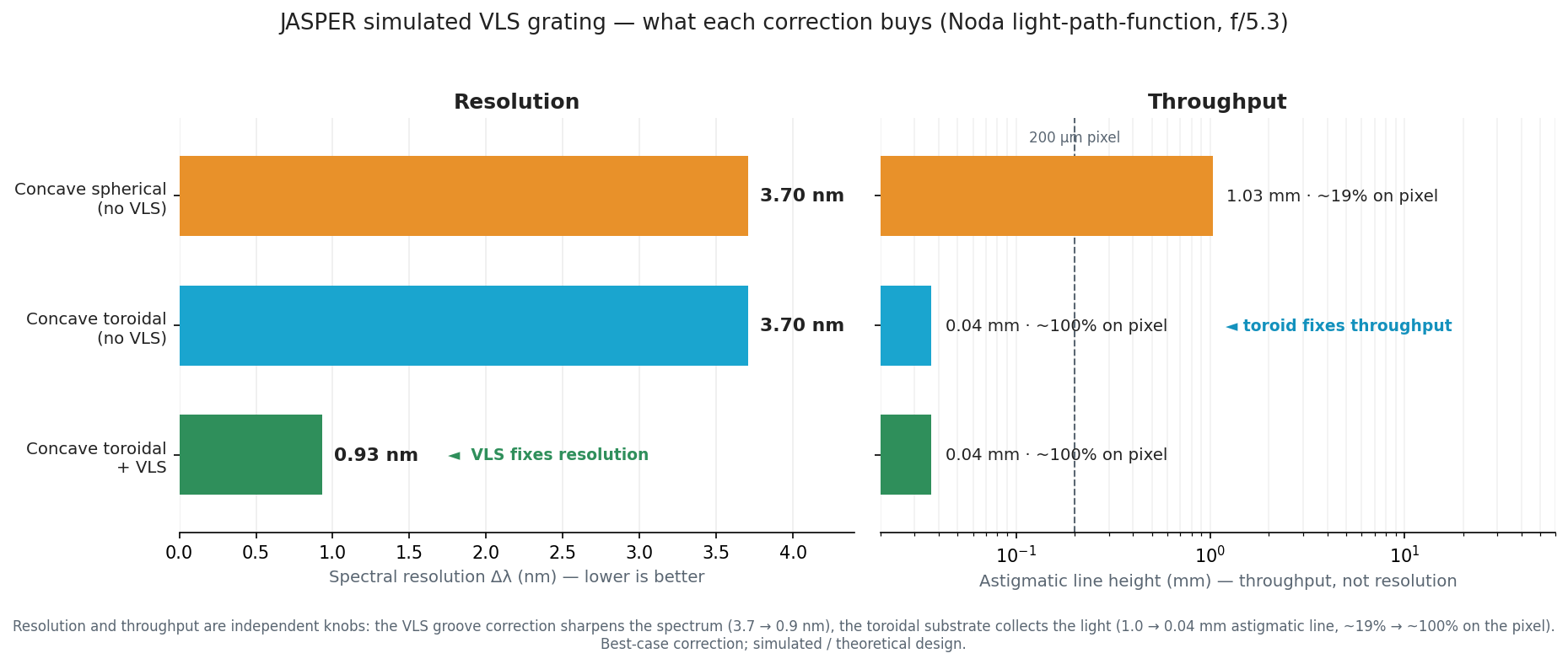

    Resolution is an f-number tradeoff — not a single spec
    The headline is a curve, not a number. Faster f = more light but more aberration; slower f + the VLS groove correction = sharper. Ray-traced across 500–1000 nm, three points along the path:
    working point
    mean Δλ
    500 nm edge
    f/5.3 spherical (wide open)
    ~2.2 nm
    ~2.7 nm
    f/8 toroidal
    ~1.4 nm
    ~2.0 nm
    f/10 toroidal + VLS correction (best case)
    ~0.9 nm
    ~1.0 nm
    floor (slit + pixel + diffraction)
    ~0.6 nm
    Takeaway: hitting ~1 nm across the band needs all three knobs together — stop down to ~f/10, use the toroid for throughput, and apply the VLS groove correction. None alone is enough. And the binding constraint is the 500 nm blue edge, which is aberration-limited (not slit-limited) — it's the last thing to come down.
    On "best case": the ~0.9 nm assumes the fabricated groove correction matches the design. The uncorrected classical grooves are the guaranteed floor; the VLS number is the plausible target a real aberration-corrected grating is built to hit. We're posting all, for a fair comparison.

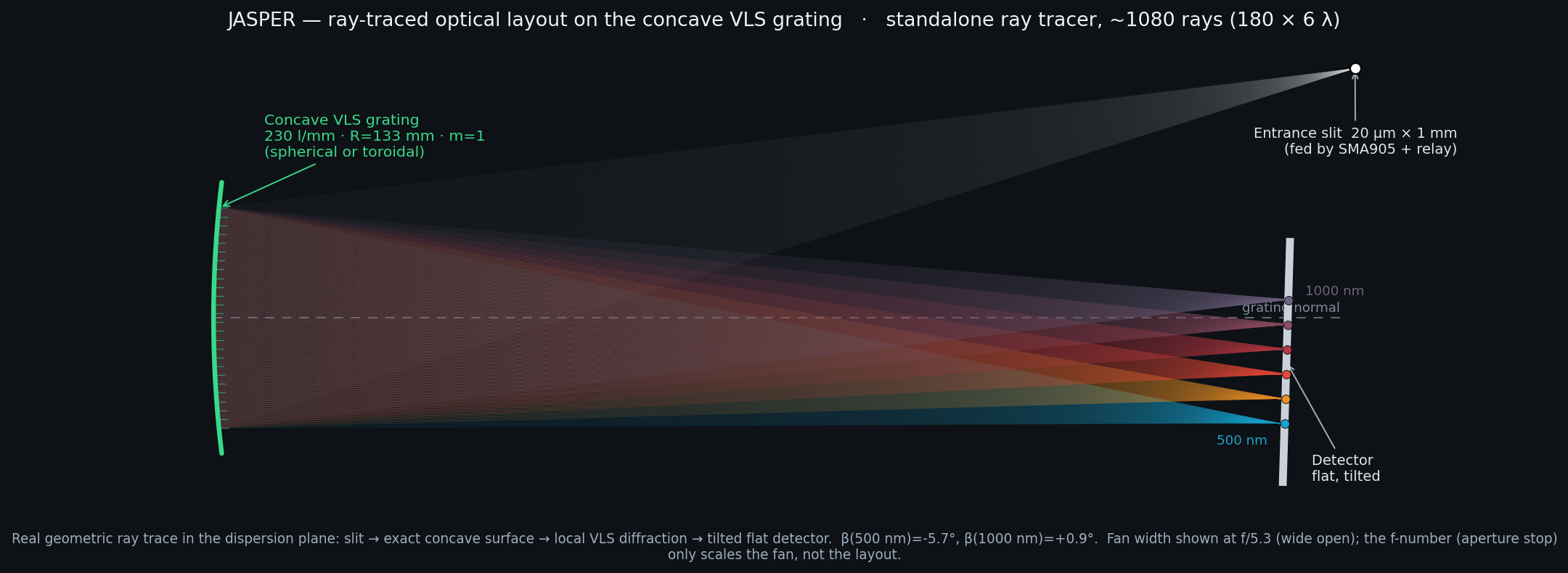

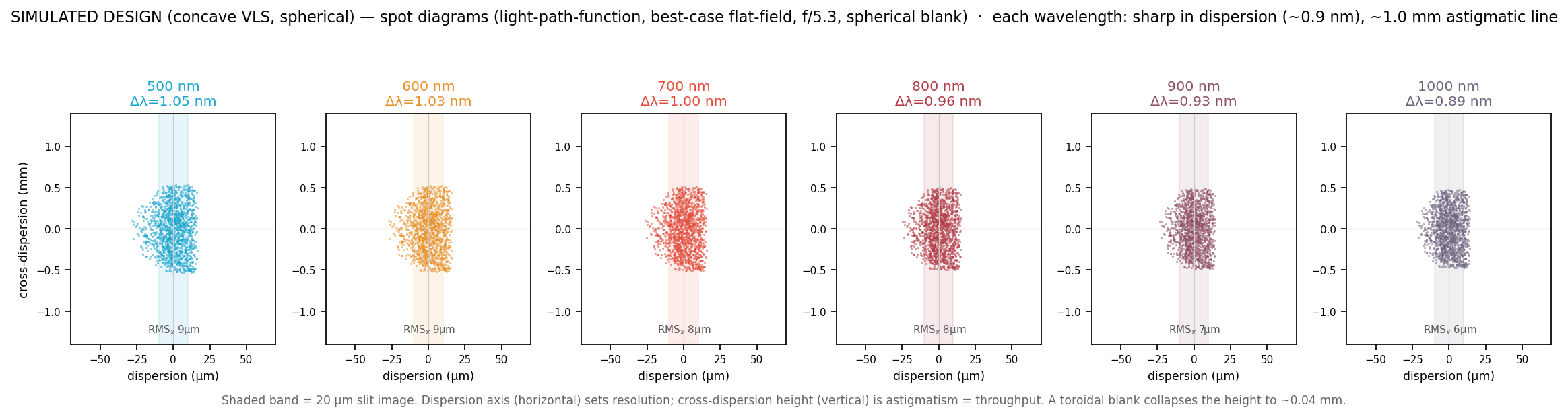

                FIGURE: the f/5.3 → f/8 → f/10+VLS path to ~1 nm, real ray-traced spots
    FIGURE: what each correction buys: the VLS grooves fix resolution (3.7 → 0.9 nm), the toroidal substrate fixes throughput (astigmatic line 1.0 → 0.04 mm). Two independent knobs, not alternatives.
    Modeled two ways
    We checked the design twice:
    • Analytic — Noda–Namioka light-path-function theory (grating equation → dispersion; aberration coefficients → spot sizes from the mount geometry).
    • Ray trace — our own standalone NumPy tracer, real rays through the exact surface with the local VLS equation.
    They match exactly on dispersion and astigmatism. On resolution they diverge slightly — the ray trace captures higher-order aberration the 3rd-order analytic theory truncates — which is why the honest number is the f-number curve, not the analytic floor alone. (A tooling note: we started in Optiland but it couldn't hold dispersion and focus at once for this off-axis reflective mount; Beam4 can't model variable line spacing at all — so we wrote our own tracer, which also draws the ray-fan layouts. All code in the repo, retired experiments marked.)

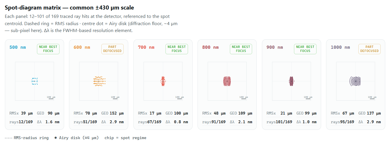

  • From 4.2 nm to 1.9 nm resolution: Cylindrical Corrector Delivers 40% Gain
    Tony Francis • 09/02/2026 at 11:20 • 0 comments
    Last time we shared a 500–1000 nm spectrometer design that landed around 3–4 nm resolution. Decent, but not great — best was 2.1 nm at 600 nm, worst stretched to 4.2 nm. We suspected the camera was holding us back. Turns out we were right, and the fix came from a lens that’s curved in only one direction. With it, the design now sits at ~1.9 nm across the band, confirmed in BeamFour. And as always, it’s open‑source
    Where we left off
    Our earlier log traced a cost-optimised 500–1000 nm spectrometer built from stock 1‑inch lenses. It worked, but the resolution sat around 3–4 nm and the spots got fat toward the edges of the band. We said at the time that the limit wasn't the colours and wasn't diffraction — it was something about the camera. This log is what that "something" turned out to be, and how we fixed it.
    Everything here is done in BeamFour, a free ray tracer, plus a few Python scripts. No expensive optics software.
    The problem: the camera focuses onto a bowl, not a flat plane
    When we looked carefully, every wavelength was actually sharp — at its own best focus. The catch is that "best focus" isn't at the same distance for every colour. It swings back and forth by about 2 mm across the band, in a smooth curve. The camera's focal surface is a shallow bowl, and our detector is flat, so only part of the spectrum can ever be in focus at once. The band edges (500 and 1000 nm) sit deepest in the bowl, which is exactly where the spots were worst.
    This is called field curvature, and it's a property of a simple lens — not colour, not diffraction. Tilting the detector helps a little (it lines up with the average slope), but you can't tilt a flat plane to match a curved bowl.

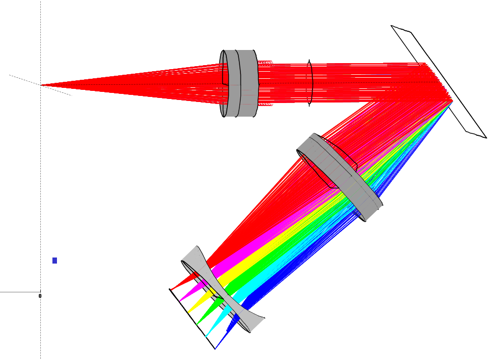

    The fix: a lens curved in only one direction
    Here's the key insight. In a spectrometer, only one axis matters for resolution — the direction the colours spread out in (the "dispersion axis"). Blur in the other direction (along the slit height) just smears the line vertically; it doesn't mix one wavelength into the next.
    So instead of a normal (spherical) corrector lens, we used a cylindrical one — a lens curved in the dispersion plane and flat in the other. It flattens the focal bowl exactly where it counts, and leaves the slit-height axis alone. A normal spherical corrector would also stretch the whole spectrum (it acts like a Barlow) and we'd run off the end of the sensor; the cylinder sidesteps that because it only has power in the one plane.
    It's a plano-cylindrical piece of N‑BK7, sitting just in front of the detector.
    Figure 1: The full trace. Fiber (far left) → collimator → grating → camera → the cylindrical field flattener (the small concave lens before the detector) → TCD1304. The rainbow is the 500–1000 nm spectrum being sorted onto the sensor.

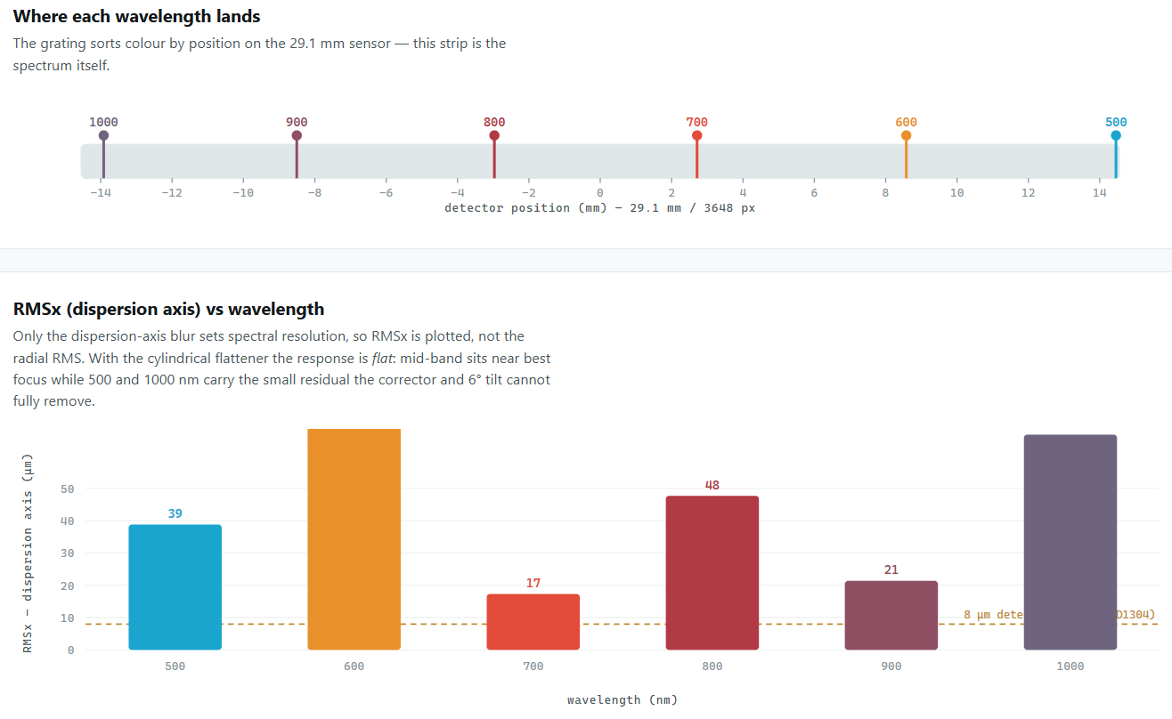

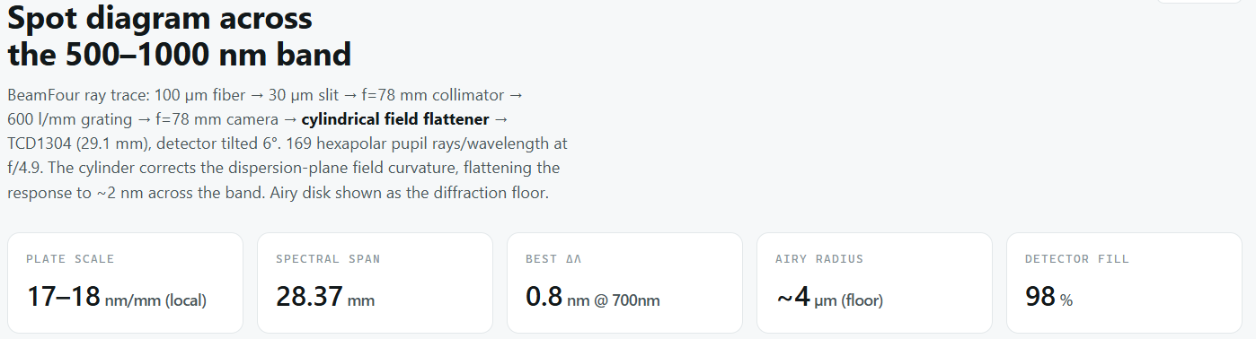

    The result: ~1.9 nm
    With the cylinder in and the detector refocused, the delivered resolution across 500–1000 nm is:
    • ~1.9 nm mean, 2.9 nm worst (single exposure)
    • every wavelength between about 0.8 and 2.9 nm — no bad outlier
    That's roughly a 40% improvement on where we were. And this number isn't just from our own script: we encoded the cylinder in BeamFour's own format and traced it there. Our offline tracer and BeamFour agree to better than a tenth of a micron on every wavelength, so the physics is trustworthy.
    Figure 2:The spot analysis from the BeamFour trace. Each panel is one wavelength; the numbers are the RMS spot size and the delivered resolution Δλ
    Figure 3: RMSx (spectral-axis blur) for each wavelength. The dashed line is one detector pixel.

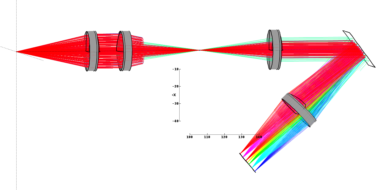

    The design
    Light comes in from an optical fiber, gets collimated (turned into a parallel beam) and re-imaged 1:1 onto a narrow entrance slit. That slit is the "object" the spectrometer looks at. After the slit, a lens collimates the light again and sends it onto a diffraction grating, which is the part that actually splits broadband light into its colours by bending each wavelength through a slightly different angle. A final camera lens focuses each colour to its own spot on the detector. Because different colours land at different positions, the detector sees the spectrum — a strip of light where position equals wavelength.
    It's called a 4f design because the lenses are spaced by their focal lengths in a way that keeps the beam well-behaved, and it's folded (bent with the grating and layout) so the whole thing fits in a small box.

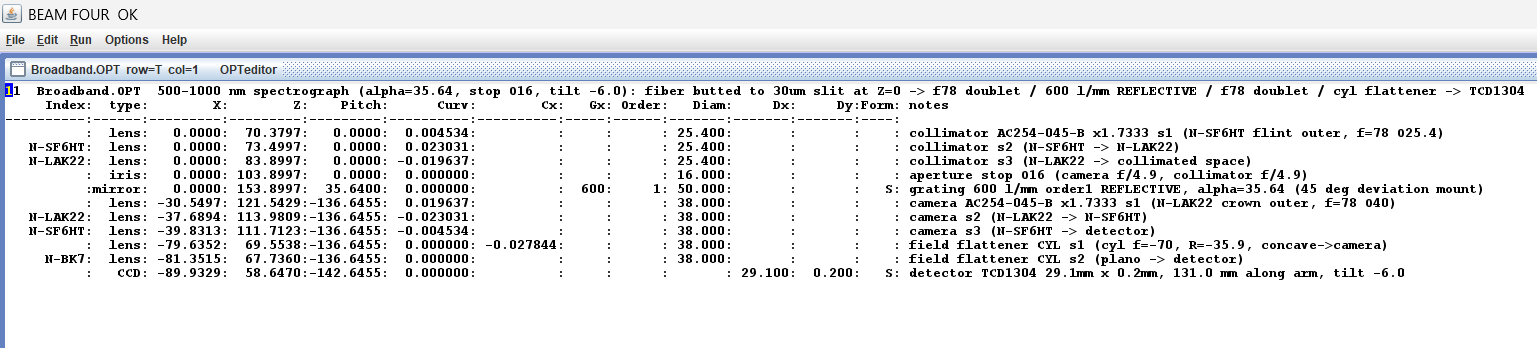

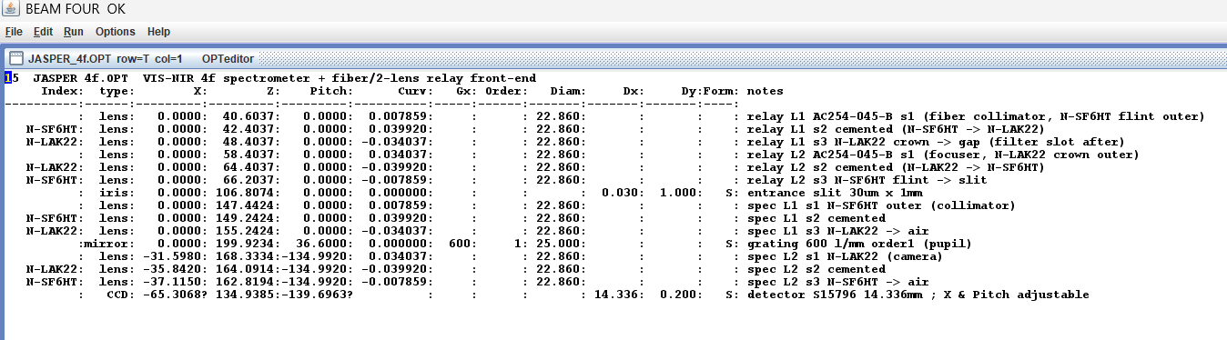

    Figure 1: The JASPER 4f prescription in BeamFour. Each row is one optical surface — the four doublets, the 30 µm slit, the 600 l/mm grating, and the tilted S15796 detector.
    This is the actual "recipe" for the instrument, as BeamFour stores it. Each line is one optical surface — one face of a lens, the slit, the grating, or the detector — described by where it sits and how strongly it's curved. Reading it top to bottom follows the light:
    • Four identical doublets (AC254-045-B). A doublet is a lens made of two glasses cemented together (here a crown glass, N-LAK22, and a flint glass, N-SF6HT). Gluing two glasses together cancels most of the colour smear a single lens would add. All four lenses in the system are the same stock 45 mm, 1-inch Thorlabs part — that's the "cost-optimised" part of the story. Two form the fiber relay, one is the collimator, one is the camera.
    • The 30 µm entrance slit. Listed as the iris, 0.030 mm wide.
    • The grating, 600 lines per mm, working in first order — the disperser.
    • The detector (CCD), a Hamamatsu S15796, 14.336 mm long, whose position and tilt we're allowed to adjust.
    Figure 2: BeamFour ray trace of the full folded path: fiber → 1:1 relay → slit → collimator → grating → camera lens → tilted detector. The colours fanning out at bottom right are the 500–1000 nm spectrum being sorted onto the sensor.
    This is what a ray trace looks like: the software fires hundreds of light rays through the design and draws where each one goes. On the left, the fiber light is relayed to the slit (the pinch point in the middle). It's then collimated, hits the grating, and the camera lens (lower right) focuses it down.
    The rainbow fan at the bottom right is the whole trick of a spectrometer made visible — the grating has bent each colour by a slightly different angle, so red, green and blue rays arrive at different places on the detector. That spread along the detector is the spectrum.

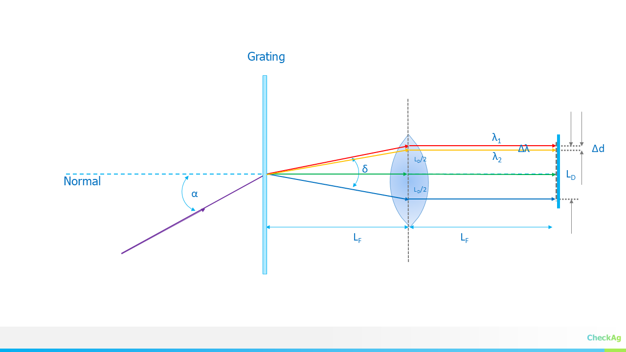

    How we judge the design — the parameters:
    Before the analysis charts, here's what each number means. Every one of these is measured from the traced rays.
    Spot / spot diagram. When the camera focuses one single colour, it should ideally land as one perfect point. In reality it lands as a...

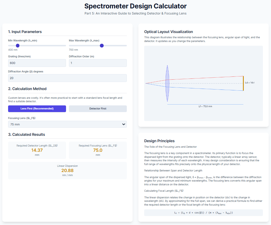

  • Interactive Optical Bench Simulator
    Tony Francis • 07/24/2026 at 19:30 • 0 comments
    Most VIS-NIR spectrometers designed for specific applications require fine customization of spectral span, optical resolution, or Signal-to-Noise Ratio (SNR).
    For instance, the Zemax spectrometer design guide highlights a system tailored for Optical Coherence Tomography (OCT) in retinal imaging. That specific application demands a narrow 50nm bandwidth (855 nm to 905 nm) optimized for deep, non-invasive imaging within the near-infrared biological window.
    However, standard optical simulation software (such as Ansys Zemax OpticStudio) often falls short when modeling physical diffraction efficiency curves, real-world blaze angles, and practical mounting tolerances. For researchers, optical engineers, and hardware builders, having a physical, reconfigurable benchtop setup is indispensable.
    We are building a truly customizable, open-source optical benchtop for reflective-grating spectrometers that allows you to easily swap and tune key hardware parameters:
    1. Slit Sizing: Interchangeable mechanical slits to balance optical throughput against spectral resolution.
    2. Optics Selection: Modular lens mounts to evaluate different collimating and focusing focal lengths.
    3. Grating Geometry: Independently adjustable incident (α) and diffracted (β) angles to test custom blaze conditions and spectral dispersion profiles.
    4. Sensor Versatility: Flexible detector positioning to evaluate COTS camera modules or specialized high-speed linear CCD/CMOS array sensors.
    To help refine the optical layout and clear aperture tolerances for the JASPER VIS-NIR Spectrometer, we built a lightweight, interactive simulator that models our optical bench mechanics directly in the browser!
    You can try out the live tool here:
    https://checkag.github.io/jasper-bench-sim/
    What the Simulator Models
    When designing compact Czerny-Turner or transmission-grating VIS-NIR optical benches, balancing detector arm placement against grating rotation is always a trade-off between spectral range and focus depth.
    This simulator lets you interactively adjust and test:
    • Detector Angle (Φ): Sweep the detector arm continuously from 45° to 95° across reference markers to see the central wavelength (λ) shift across the line array.
    • Grating Rotation Stage: Rotate the primary diffraction grating stage (0° to 50°) independently of the detector arm.
    • Focus Travel Calibration: Slide the sensor along its own optical axis (0% to 100% travel) to evaluate focal distance tweaks relative to the focusing optics.
    • Real-time Ray Tracing: Visualizes how the diffracted spectral band maps across the active sensor plane.
    Built for Open-Source Transparency
    Rather than relying on heavy desktop CAD packages or proprietary optical simulation software for quick spatial checks, we built this tool with pure, self-contained HTML5, CSS, and inline SVG. It requires zero external assets or dependencies, making it instantly scannable and accessible on desktop or mobile.
    Feel free to run the "Run full demo" loop on the page to see the automated mechanical sweep sequence in action, or turn off labels for a clean visual view!
    The repository is fully open-source under the MIT license:
    📁 GitHub Repo: checkag/jasper-bench-sim
    Give it a try and let us know your thoughts on the mechanical geometry

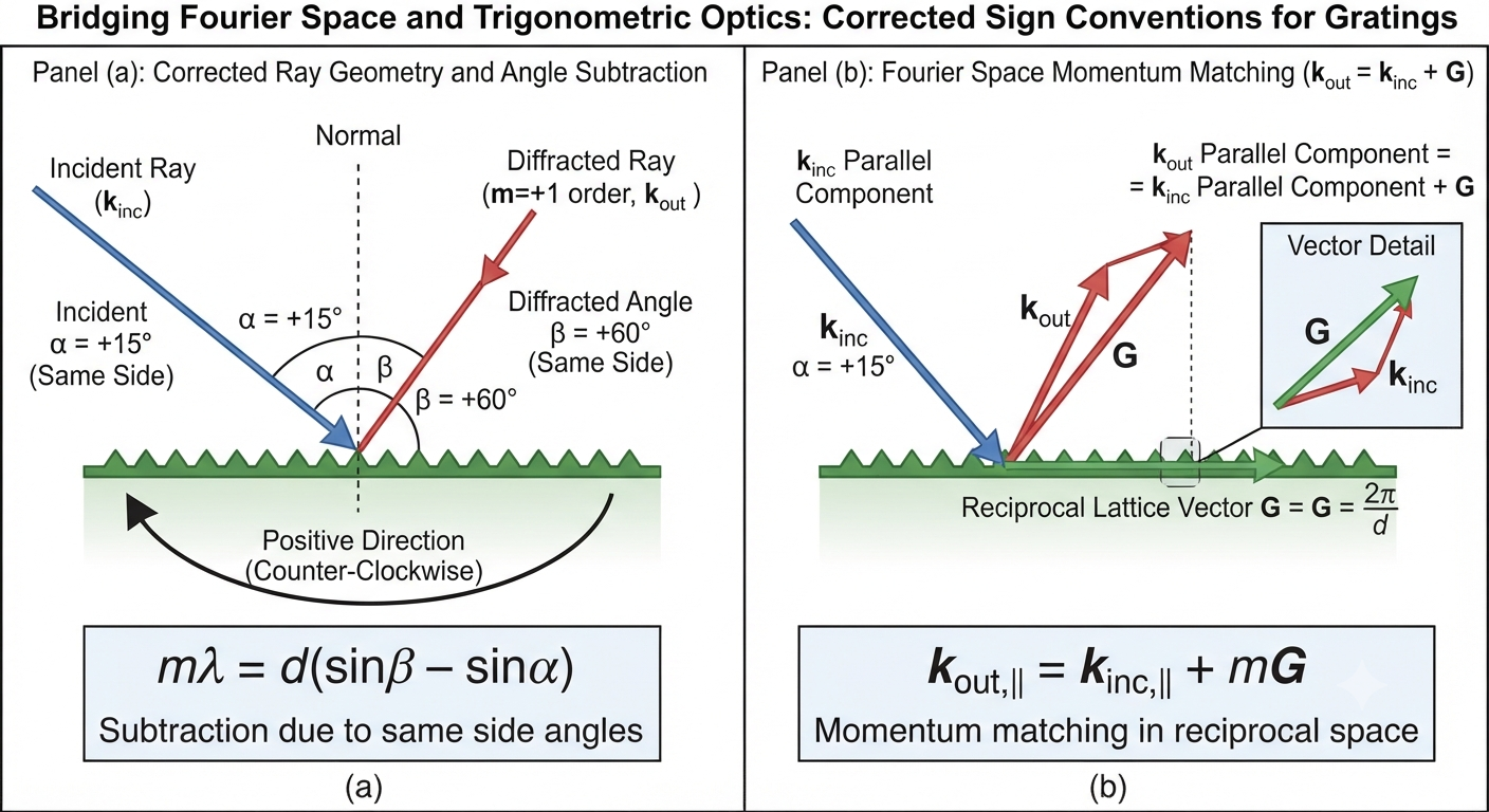

    It all started with a diagram in the JASPER project logs that didn't quite look right. The angle subtraction geometry for the diffraction grating felt ambiguous, leading to a rabbit hole of second-guessing and a quick post over on Reddit to see if the community could untangle it. A helpful comment pointed toward a deeper truth: if you really want to understand gratings, stop thinking purely in right triangles and start looking at them from Fourier space.
    That advice sparked a dive into reciprocal lattices, Bloch waves, and vector formulations. But rather than just taking someone's word that "vector mechanics and trigonometry are the same thing," let’s build the actual bridge between them.
    The Diagram That Started It All
    When dealing with real-world layouts, getting the sign conventions right for angle subtraction matters immensely. If your angles are on the same side of the normal, you subtract them; if they're on opposite sides, you add them. But why does the math behave this way? To find out, we have to look at the boundary through the lens of electrodynamics.
    The Fourier Space Perspective: Bloch Waves and Momentum Matching
    Periodic structures—whether an array of micro-grooves or nanophotonics particles—impose discrete spatial periodicities. From a rigorous standpoint, every electromagnetic field interacting with a periodic grating must obey Bloch's theorem. When you expand the grating's spatial profile into a Fourier series, periodicity naturally translates into discrete momentum contributions in reciprocal space. In wavevector terms, the parallel component of the outgoing wavevector isn't arbitrary; it is shifted by a discrete reciprocal lattice vector
    This component-based formulation
    is fundamentally the exact same concept as the classical grating equation, expressed as momentum conservation.
    The 2-Line Bridge: From Fourier Space to Trigonometry
    For a Hackaday audience, equations are best when you can trace them back to something you can plug into a spreadsheet. Let's look at the x-components of our wavevectors in 1D to see how Fourier space collapses back into the classic formula.
    Start with the reciprocal lattice condition:
    Substitute the wavevector magnitudes
     in terms of angles relative to the normal
    and the grating period
    results in
    Divide the entire expression by 2*pi / λ  and rearrange, and you arrive right back at the familiar form:
    Just like that, abstract Fourier-space momentum matching resolves cleanly into the trigonometry we use on the benchtop.

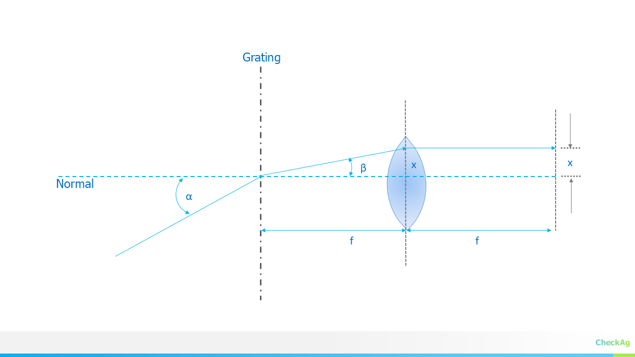

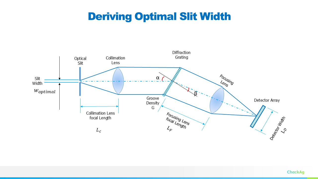

    When designing a grating-based spectrometer, the primary challenge is not solving the physics—it's managing the real-world constraints of Commercial Off-The-Shelf (COTS) components. We must design around fixed detector lengths (LD) and standard focal lengths (LF).
    This presents a chicken-and-egg problem: finding the right Grating Groove Density (G) without first committing to a fixed Focusing Lens Focal Length (LF). We can get an early estimate for G based only on the desired Wavelength Span and the Geometry of our optical setup.
    The Core Design Principle: The Grating Equation Governs G
    The fundamental constraint is that the total angle the dispersed light occupies (∆β) must be related to the total wavelength span(∆λ). This relationship is governed purely by the Grating Equation, independent of any focusing optics.
    Step 1: Grating Equation for the Span Edges
    The Grating Equation (for the first order, m=1) relates wavelength (λ), angles (α, β), and groove density (G):
    By setting up this equation for our minimum (λmin) and maximum (λmax) wavelengths, and assuming the Angle of Incidence (α) is constant:
    Step 2: Isolating G
    Subtracting the first equation from the second elegantly removes the α term:
    By rearranging, we get the key design relationship for G:
    3. The Early Estimate: Setting a Practical Angular Window (∆β)
     A COTS detector array can typically only capture light over a limited angular span (∆β), usually between 30° and 50°. By defining a center angle (βcenter) and a total angular span (∆β = βmax – βmin}), we can simplify the numerator using a trigonometric identity:
    This gives us the final, actionable equation for estimating the required groove density:

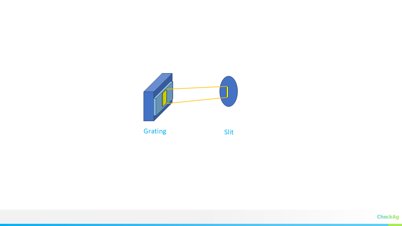

    When designing a spectrometer, every photon counts! You can buy the fanciest grating in the world, but if your collimator mirror or lens is shining light past it, you're throwing away precious signal.
    The key to a high-efficiency spectrometer is ensuring your grating is wide enough to capture the entire cone of light emitted from your input slit or fiber. This isn't just the beam diameter—it's the beam diameter plus a correction for the angle at which the light hits the grating.
    Here’s the step-by-step derivation to find the absolute minimum physical width required for your diffraction grating  Wgrating
    Step 1: Defining the Light Cone and the Collimated Beam
    The light exiting your input source (fiber or slit) spreads out in a cone defined by its Numerical Aperture (NA).
    • Numerical Aperture (NA): This value is usually provided for optical fibers. If you have a slit and a lens, you calculate the NA from the lens-slit geometry.
    Where θNA is the half-angle of the light cone.
    • Collimator Focal Length (Lc): The light cone hits the collimator mirror or lens at a distance Lc. The collimator converts this diverging light cone into a parallel beam.
    The maximum radius (R) of the light cone at the collimator mirror, and thus the radius of the resulting parallel beam, is found using basic trigonometry:
    The total beam diameter (Dbeam) is simply twice the radius:

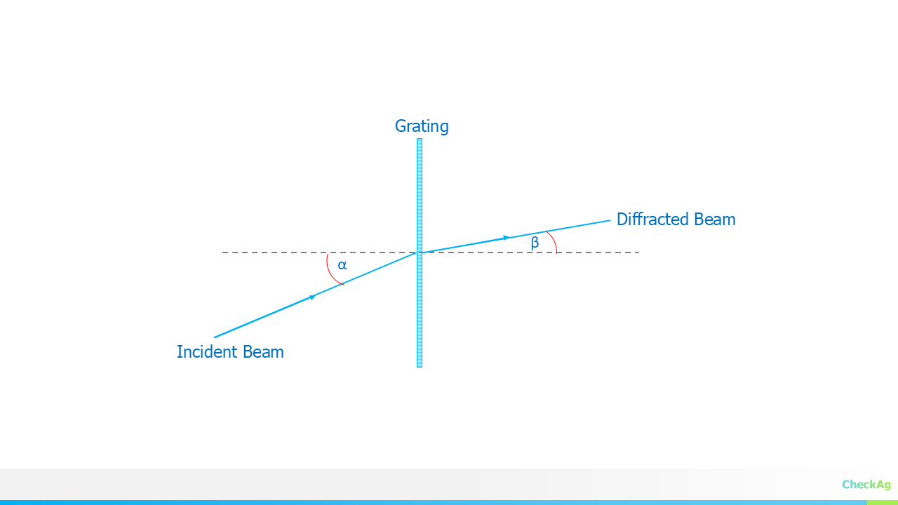

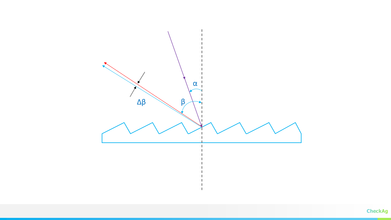

    The Grating Equation and the Two Geometries
    The physics of diffraction is governed by the Grating Equation:
    where:
    • G is the groove density (grooves/mm)
    • λ is the center wavelength
    • α is the Angle of Incidence (AOI)
    • β is the Angle of Diffraction (AOD)
    • The +/- sign depends on whether alpha and beta are on the same or opposite sides of the grating normal.
    The confusion arises from how the total Deviation Angle (φ)—the fixed angle between your collimating and focusing optics—is defined:
