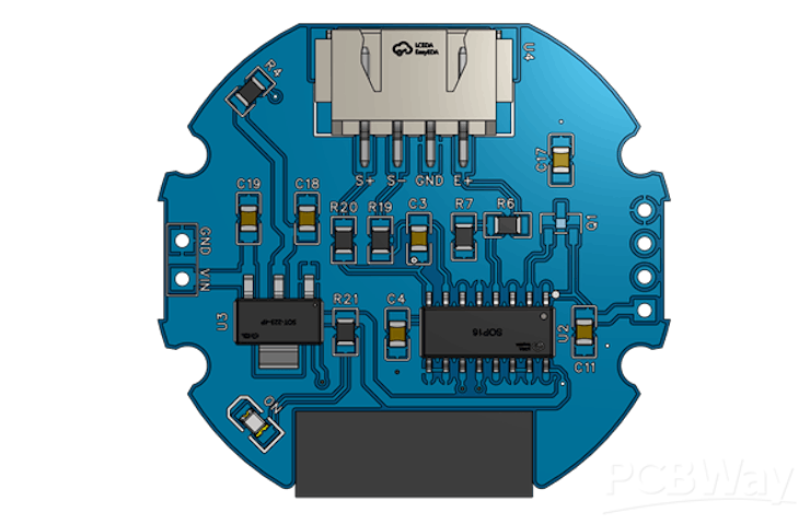

Printed Board Specifications
The PCB was designed to be compact and optimized for accurate weight measurements. Below are the main specifications and features of the board:
Dimensions and Layout: The PCB has a compact design, allowing easy integration into different applications. The tracks were strategically positioned to minimize interference and optimize communication between components.
Main Components:
- Load cell: Responsible for converting the applied force into an electrical signal proportional to the weight.
- HX711: 24-bit analog-to-digital converter that amplifies and digitizes the signal from the load cell.
- Power and communication connectors: Allow interfacing with the ESP32 and proper powering of the circuit.
- ESP32 as a microcontroller: Responsible for processing the data acquired by the HX711 and communication with other devices.
- 100nF decoupling capacitor: Helps stabilize the HX711 power supply, reducing noise and improving reading accuracy.
Power supply: The board can be powered by 3.3V or 5V, making it compatible with different microcontrollers and applications.

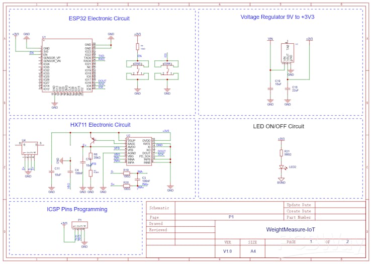

Below was presented all electronic schematic of the electronic circuit.

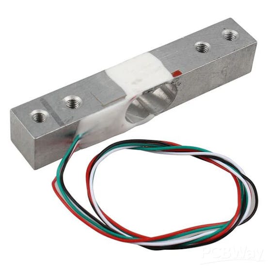

Load Cell Operating Principle
The load cell is a transducer that converts mechanical force into electrical resistance variation.
This variation is measured by a Wheatstone bridge, generating a small voltage signal proportional to the applied weight.

Schematic and PCB Layout
The PCB was designed to ensure efficient and reliable operation of the weight measurement system. The design includes a strategic arrangement of components to minimize noise and electrical interference, as well as an optimized distribution of the tracks to ensure efficient communication between the modules. In addition, decoupling capacitors were used to ensure power supply stability and measurement accuracy. The main elements present in the circuit are detailed below.
The circuit includes:
- HX711 connected to the load cell via the Wheatstone bridge.
- Noise filters (capacitors) to ensure more stable measurements.
- Connectors for ESP32 that allow easy integration with other systems.
- Optimized tracks to minimize interference and electrical noise.
- 100nF capacitor next to the HX711, ensuring power supply stability.
- The PCB was designed to be easy to assemble and compatible with different load sensor configurations.

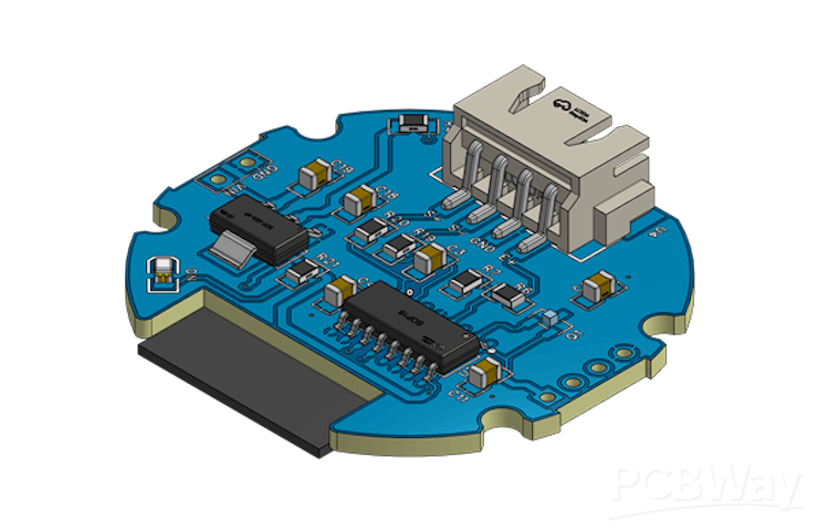

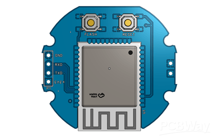

Below we have the result of the printed circuit board.
