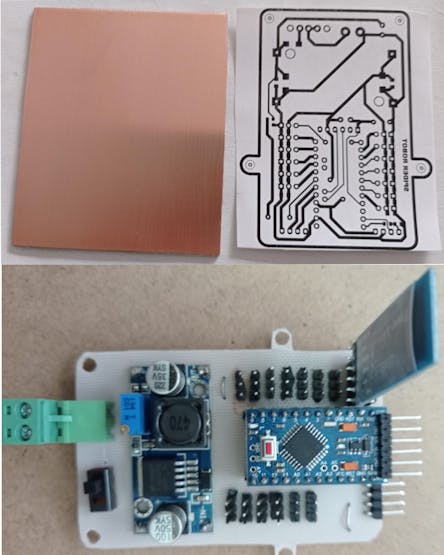

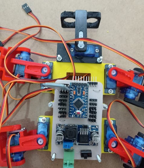

The spider robot moves by measuring the distance of the objects in front of it with the help of an ultrasonic sensor, and we can control it from the phone with bluetooh.

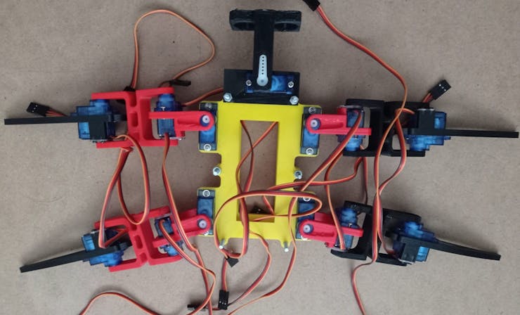

Developing a standard 4 legged spider robot, we made a spider robot that can turn its head so it can look left and right.
We know that it provides 12 servo control with arduino, but we used 13 sg90 servo motors in our project.
The working videos of our project are as follows.t.
https://play.google.com/store/apps/details?id=appinventor.ai_aladdin683.Arduino_Ant_Robot&hl=tr&gl=US
You can download android app from play store.
NORMALLY 12 SERVOS CAN BE CONTROLLED IN ARDUINO, IN THIS PROJECT I PROVIDED 13 SERVO CONTROL. 13TH SERVO MOTOR IS CONTROLLED BY SOFTWARE
