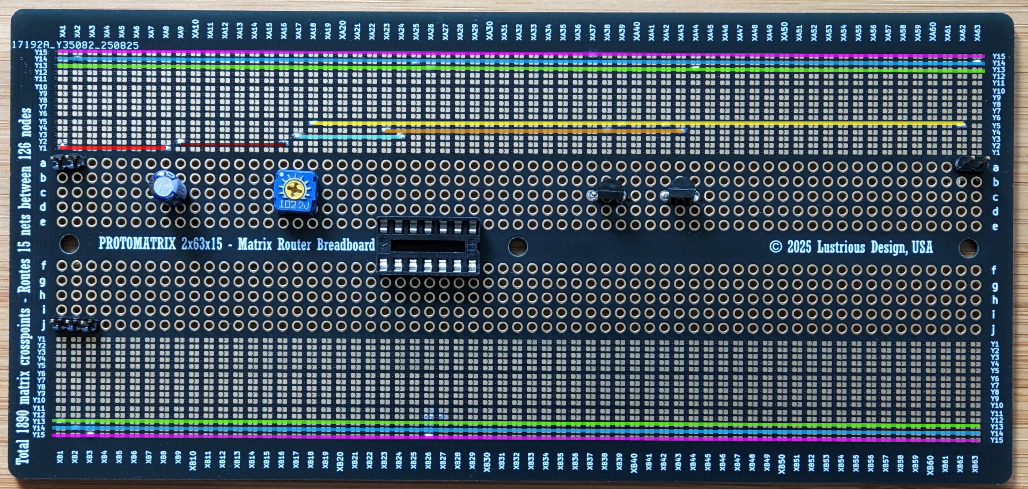

  • Basic power amplifier circuit everyone should know
    Vlad Shcherbakov10/11/2025 at 01:48 0 comments
    Designing The Circuit

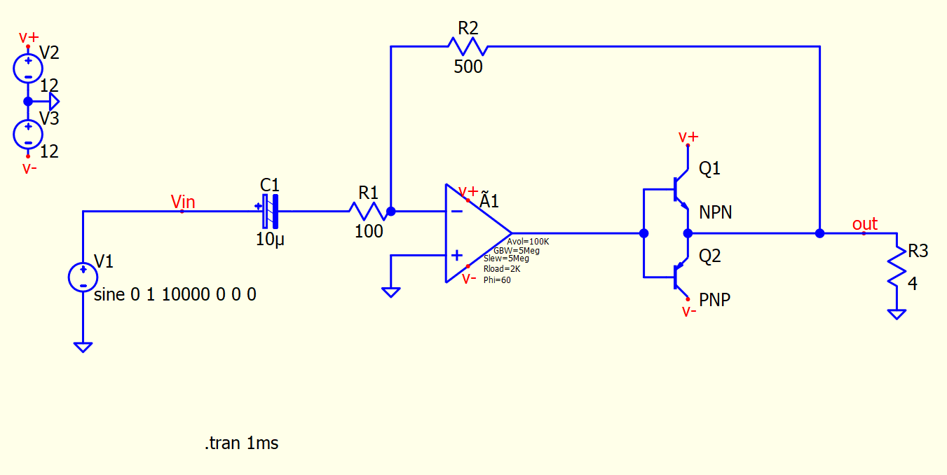

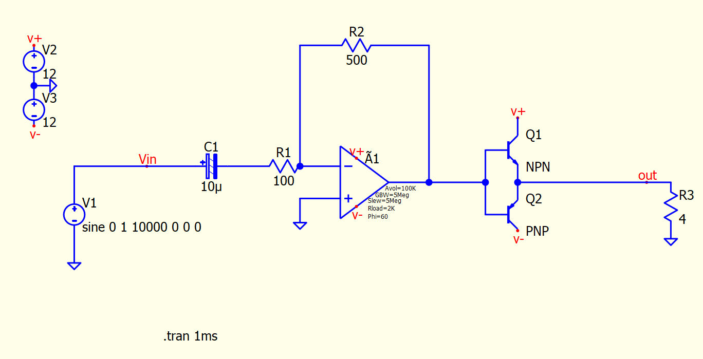

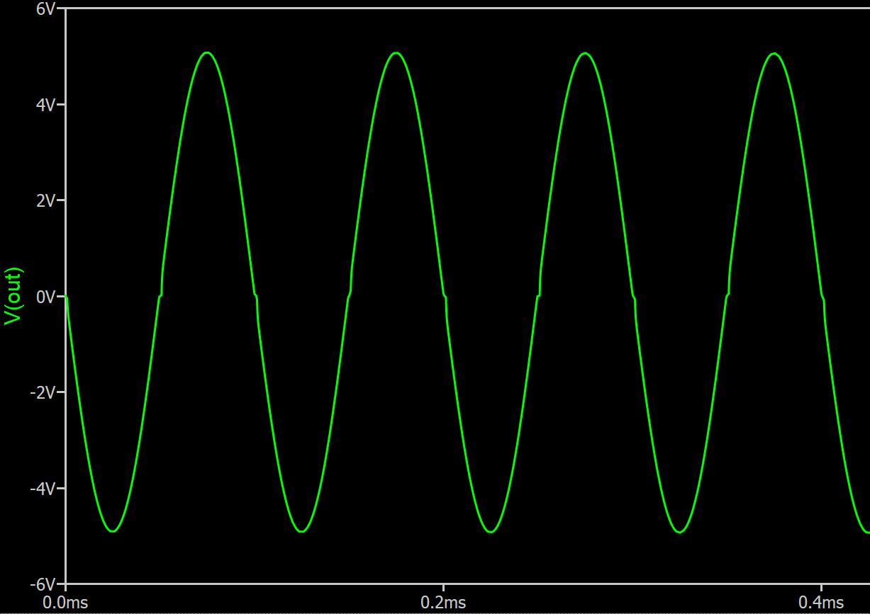

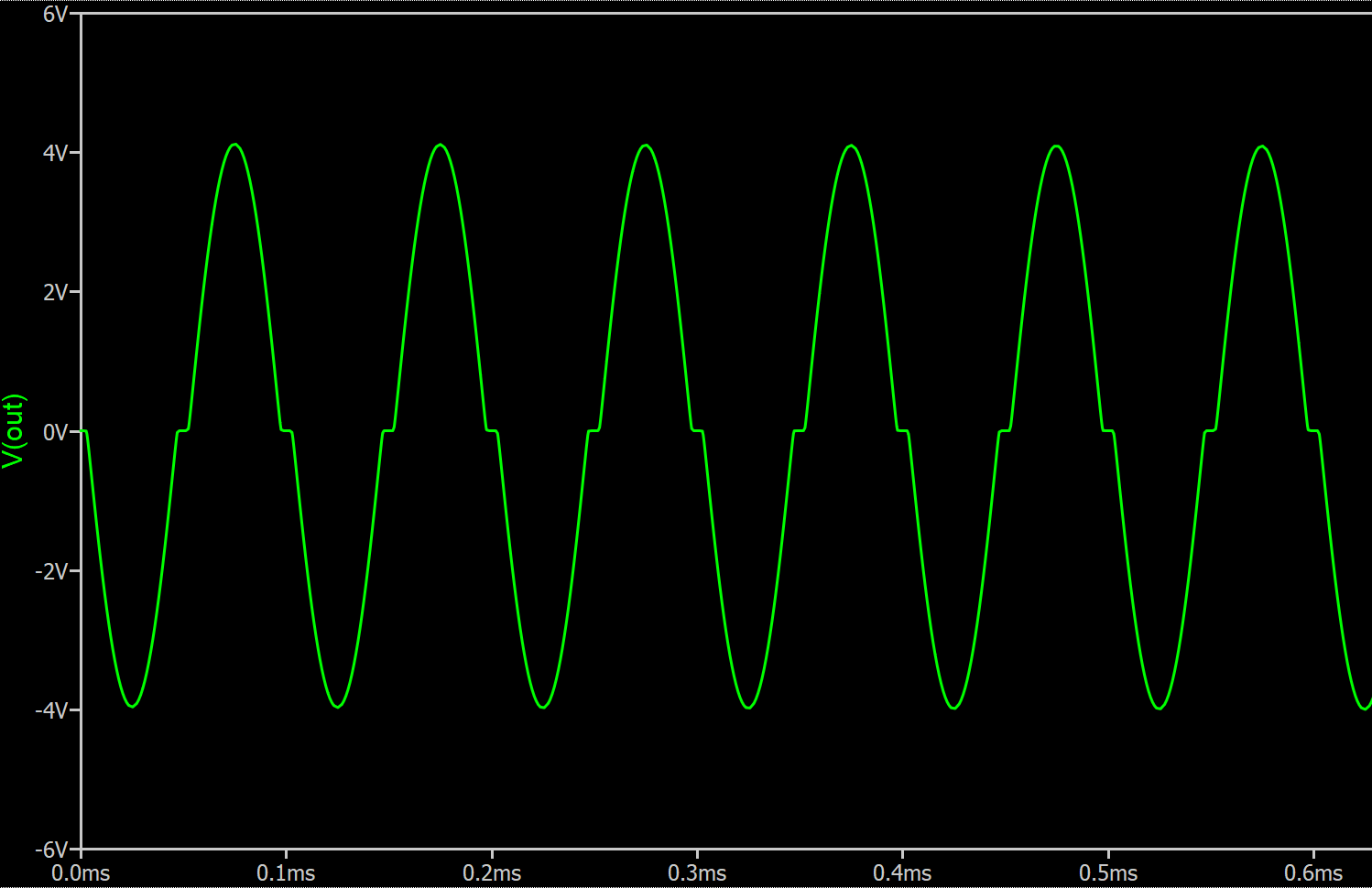

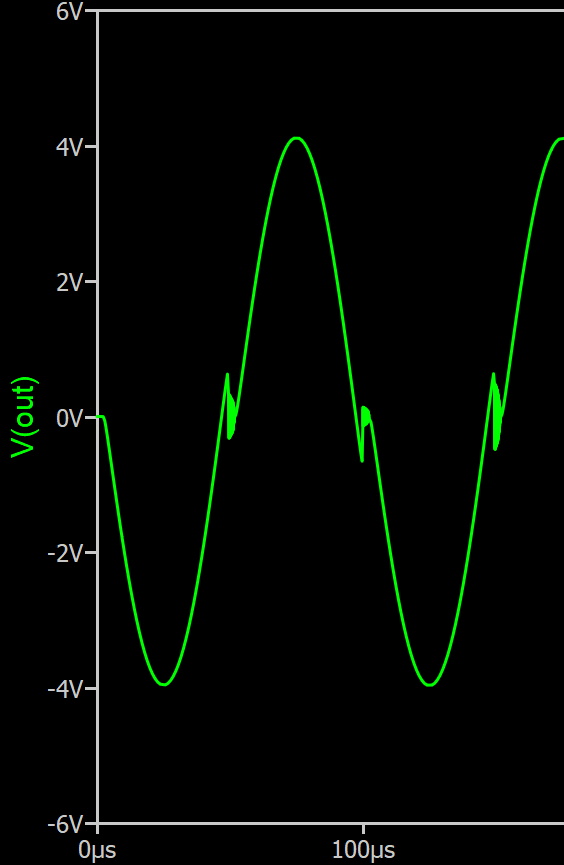

    In this log I'm going to use my matrix router breadboard to put together a simple audio amplifier made of push-pull stage and a op amp in inverting amplifier configuration. If you ever tried building a push-pull stage without feedback you probably noted horrible distortion around zero due to transistors falling out of active region and starting to act non-linearly.
    Note the flat regions of the waveform where input is crossing 0.6V.
    If you were to connect an actual speaker it would look even worse due to inductance and dynamic nature of the load.
    The op amp has a closed-loop gain of 500/100 = 5. And in the circuit above it is simply providing a linear gain before power stage as well as low impedance. The fix is surprisingly simple, just close op amp feedback around the output and it will do its best to keep it linear! In the next circuit, the op amp will become aware of the push-pull stage.
    The magic of an op amp is that it is kind of a control system in itself working in a closed loop with feedback. By closing its feedback loop around a parameter you want it to control you can improve your circuit performance. In this case this circuit closed the feedback loop at output of the push-pull stage so that the op amp can maintain a gain of 5 despite non-linear behavior of the transistors around zero. I read about this trick in the Art Of Electronics, and this is the circuit we are going to build using a matrix router.
    NOTE: The capacitor polarity in this circuit does not matter. This sometimes bothers people, they think they are hurting the poor thing. The purpose of capacitor is to block DC bias. If there's DC voltage across the capacitor you should orient it according to polarity. You may ask: but doesn't audio signal change polarity when zero-crossing? Yes, but for AC of large enough frequency the capacitor is considered to be a short circuit. Therefore the voltage drop across the capacitor for AC signal is zero and polarity does not matter. Bottom line, watch DC bias, don't worry about AC. If you got it wrong, it will explode and you will know you got it wrong. In my circuit I oriented negative side to the virtual ground node, because at DC inverting input of the op amp will try to be equal to whatever is connected to the non-inverting input (ground). So if there was a DC bias coming from some audio input, it would be on the positive side of capacitor.
    Split The Circuit Into Nets
    Since I'm going to use a matrix router breadboard, the first thing to do is to split the circuit into NETs. A NET is a just a group of connected pins. This is no different from the process that a PCB layout software or a circuit simulator would do, except we have to do it by hand. Below I colored and labeled all NETs.
    Solder Parts Into Matrix Router Board
    There's really no magic to it, you just put them anywhere you want, that's kind of the point of using a matrix router.
    Implement The NETs
    The next step is to close the jumpers. I go over each net's Y row and close the jumpers at X columns where the device pin is located. It is best to do it one Y row at a time to make sure you don't miss anything.
    I also added connectors for power, audio input and audio output for external speaker and for probing. I usually use outer tracks Y15, Y14, Y13 for power distribution, similar to conventional breadboard (obviously conventional breadboard does not have a dual power supply rail, but here you can do whatever you want). The op amp that I used was LM324N (though mine had issues and I rewired it for LM412). I also replaced the resistors with a 1k potentiometer. Transistors are N23904 and N23906, they do the job, but I would like to replace them with something heftier.
    Below, I also colored sections of Y rows using same colors as in schematic. In hindsight, I should've had the board made in white so I could use a color marker to draw on it.
    The matrix...

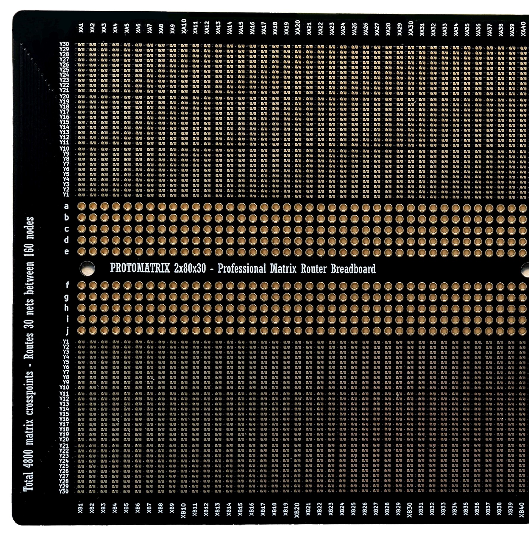

  • What is matrix routing?
    Vlad Shcherbakov03/15/2025 at 01:36 0 comments
    Matrix routing is one of those concepts that everyone claims to understand—until they actually face the challenge of routing something with a matrix and end up in a tangled mess. I first encountered matrix routing when exploring PXI-based matrix switching systems. In that world, the prevailing mindset is to spend a hefty amount each year on the "magic" routing software and to avoid reinventing the wheel. But honestly, what's so wrong with reinventing your own wheel every now and then? That's one of the things I love most about engineering: understanding how things work so you can put your own spin on them, combine ideas, remix, and integrate them into something new.
    Matrix routing, at its core, is actually quite simple. Here’s a step-by-step guide to implement any arbitrary circuit using a matrix:
    Matrix Routing Procedure
    1. Break your circuit into nets (groups of connected nodes).
    2. Attach the device nodes to X columns.
    3. Assign a unique Y row for each net in the circuit you want to route.
    4. To route a net, close the crosspoints where the X column of each node intersects with the Y row of that net.
    It might take a little time to fully grasp why these steps work, but once you do, you'll have a powerful tool at your disposal.
    I made some router boards to try the idea out. You can get them if you want to support my project: Protomatrix 2x30x80. More to come!
