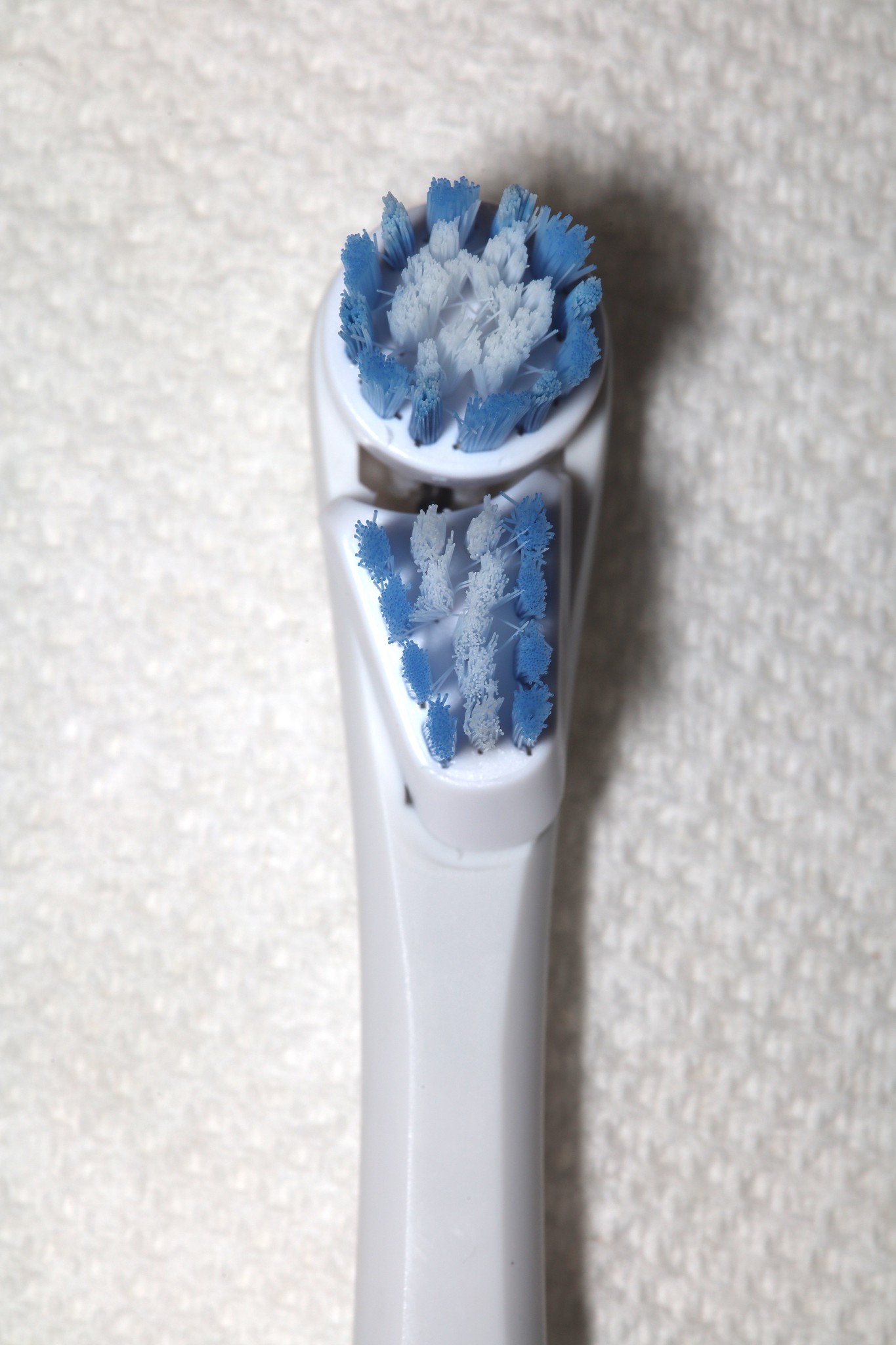

After living with it for a while, the latest thinking was to permanently fix the linear brush, disconnect the motor from it & just mobilize the rotating brush. This should increase the speed of the rotating part.

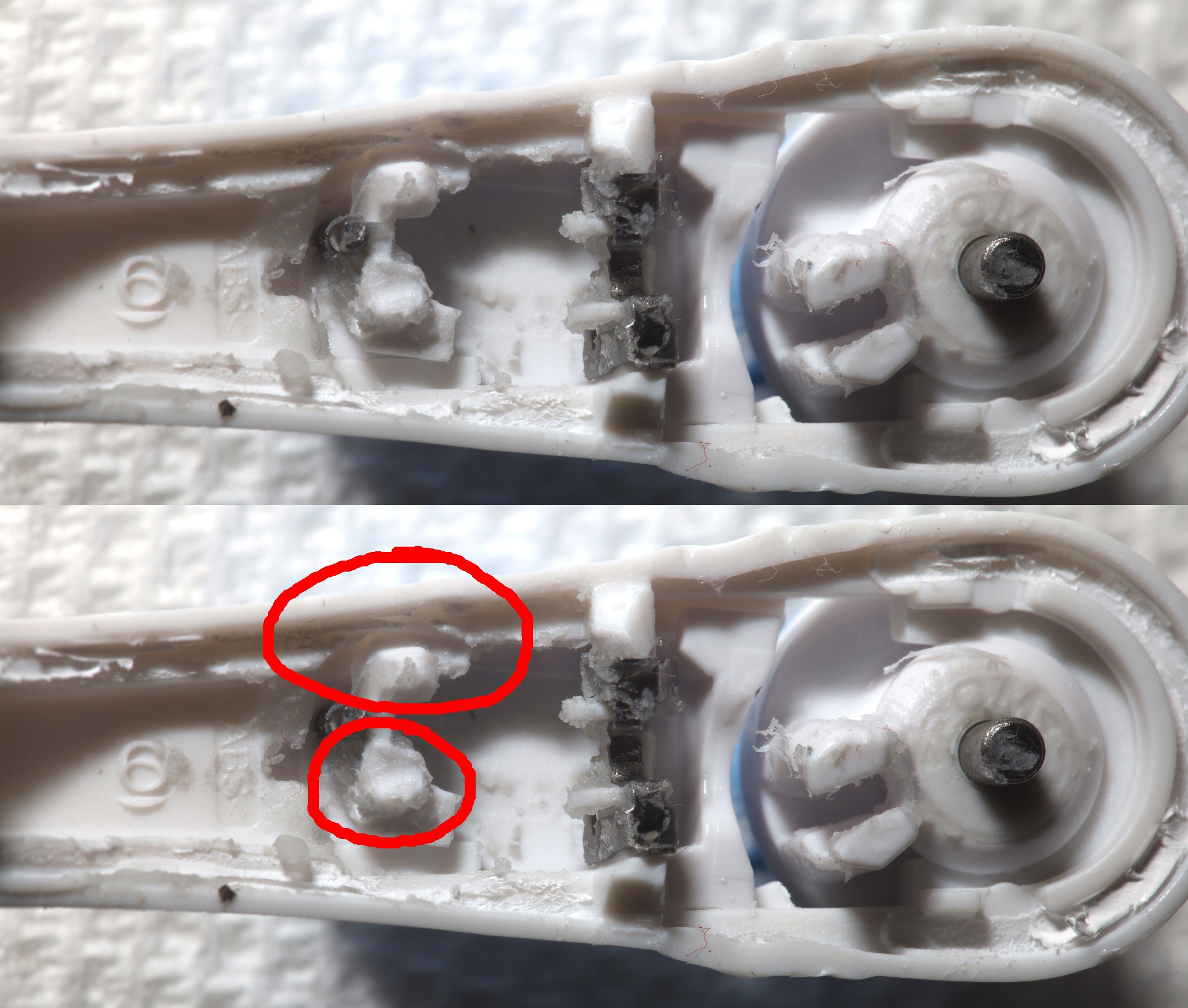

Unfortunately, after 3 weeks of brushing, the linear brush broke off.

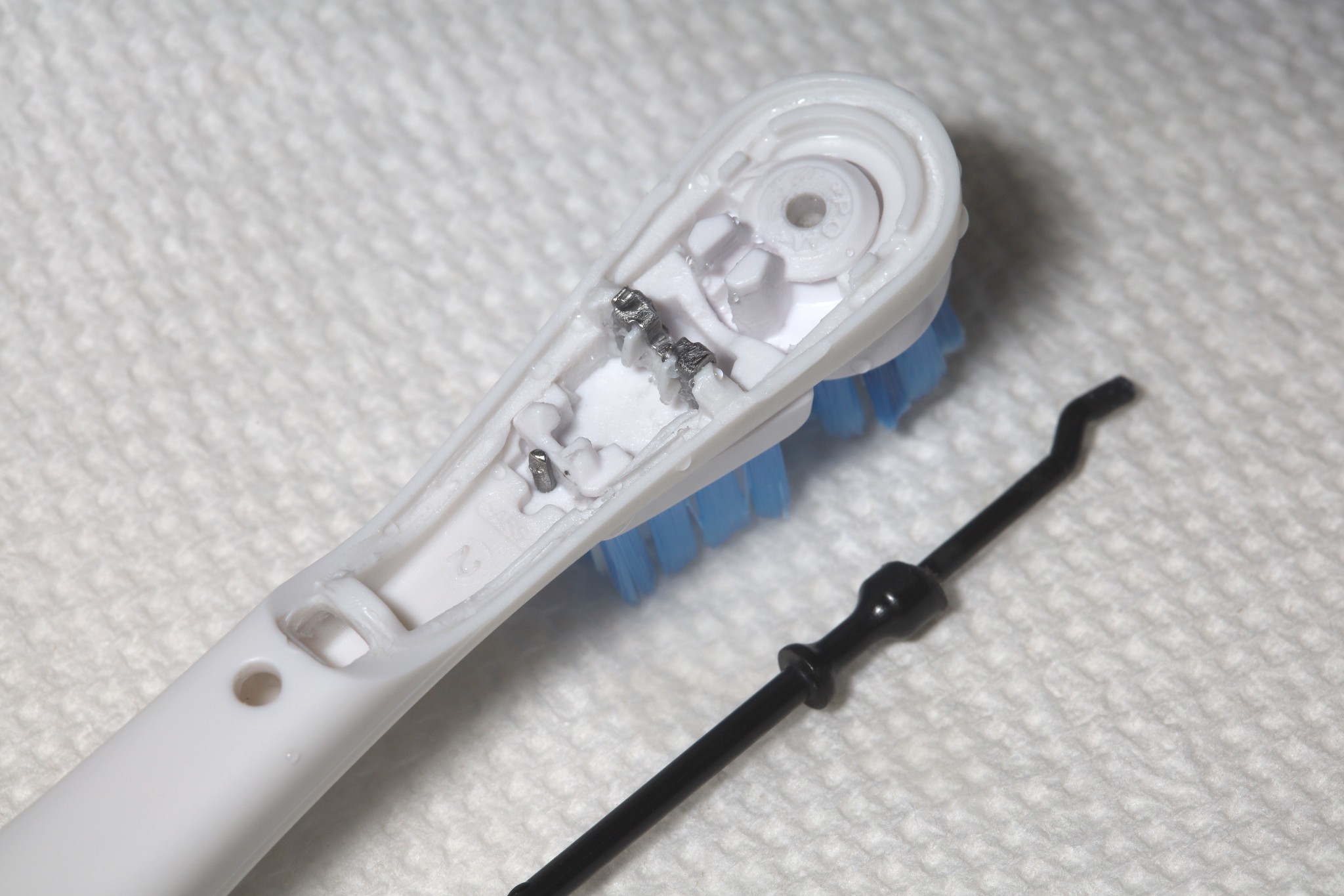

2 bits of plastic wore down.
Tried the idea of gluing the linear part, but the problem was reassembling it. The cover would no longer go on without jamming the rotating brush. They're probably designed to self destruct after 3 weeks.

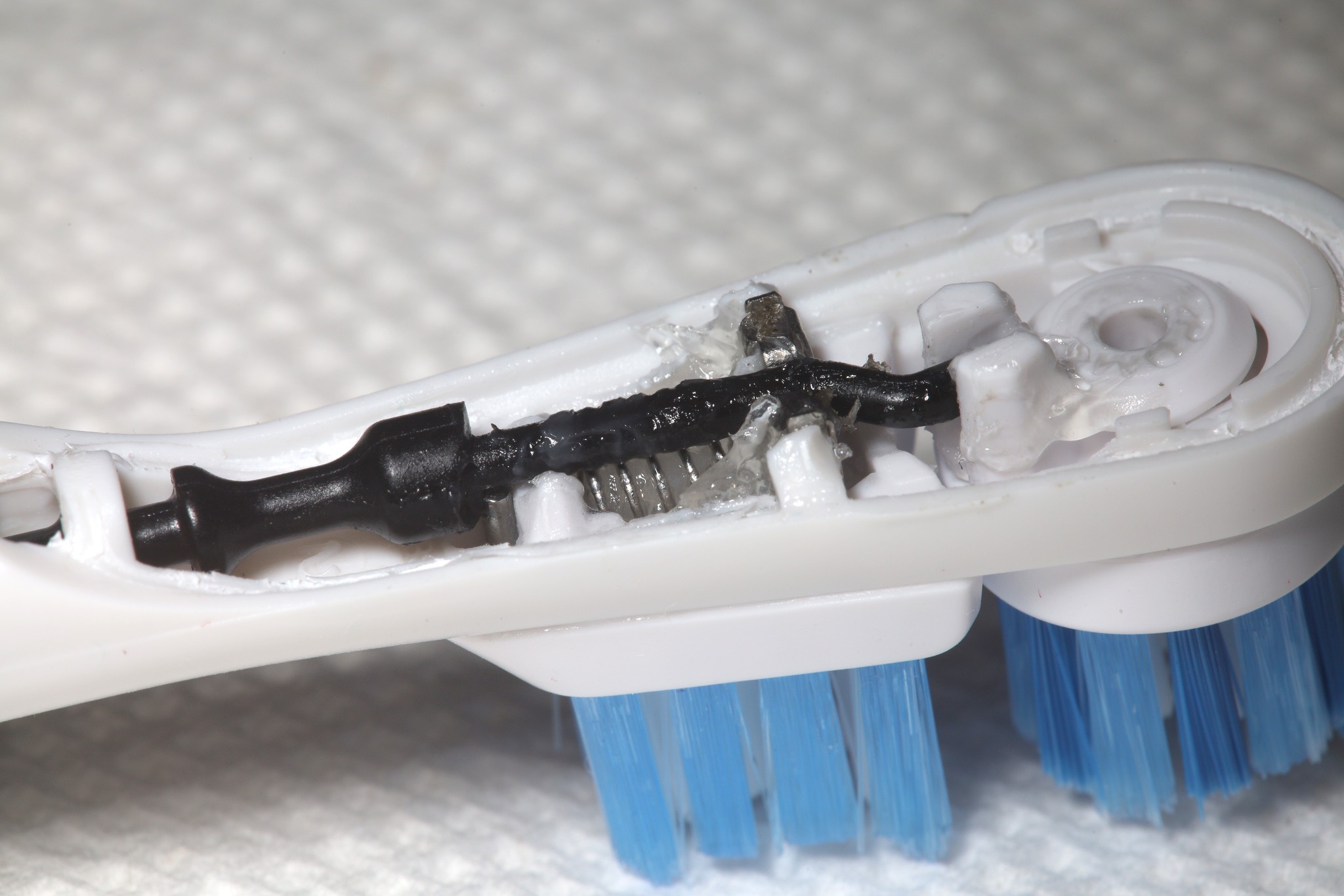

It became clear that the rod wasn't pushing like the old design but rotating. The 2 cam parts were converting rotation into reciprocating motion. The linear brush needed the spring to push it into the cam.

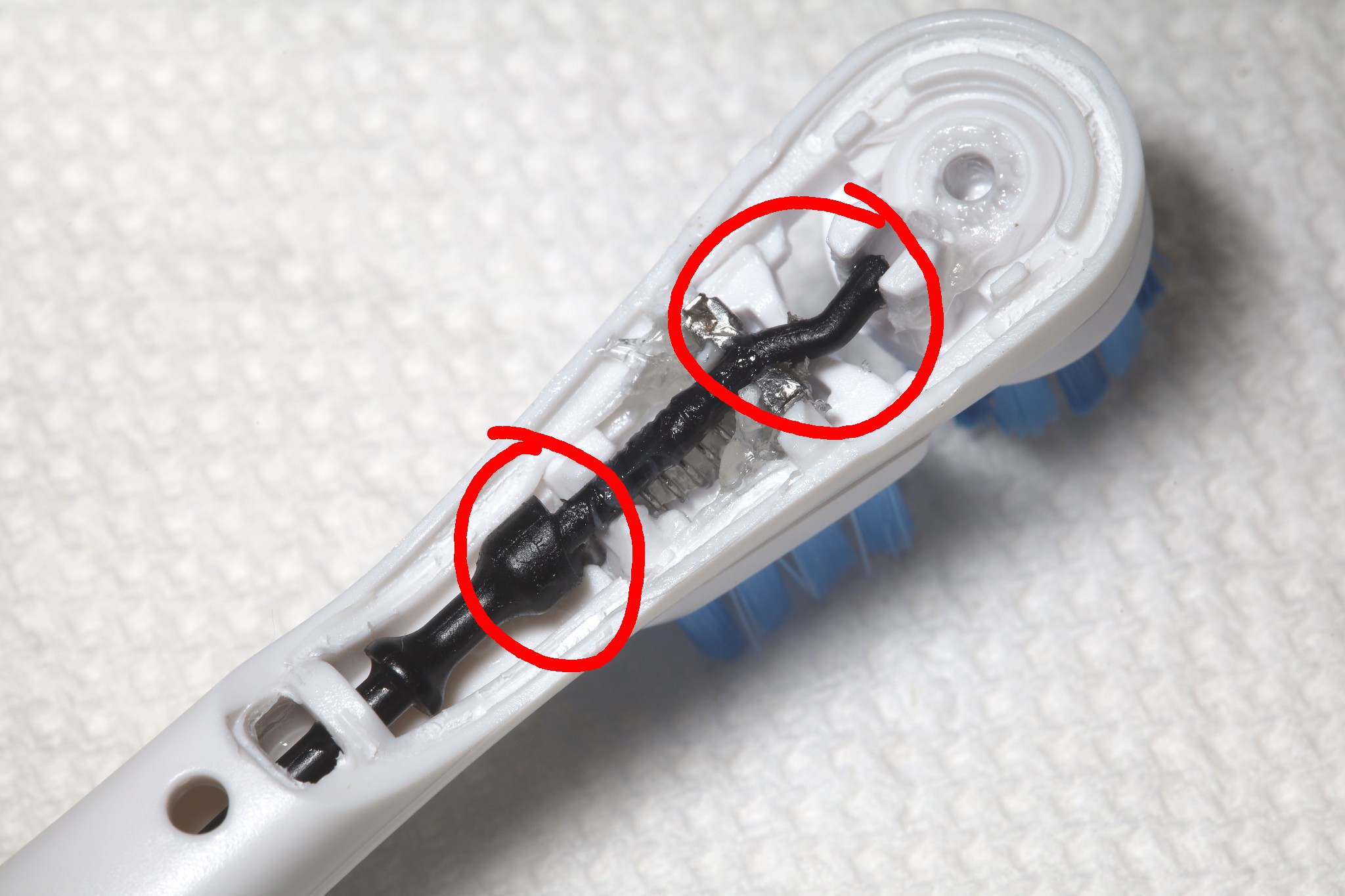

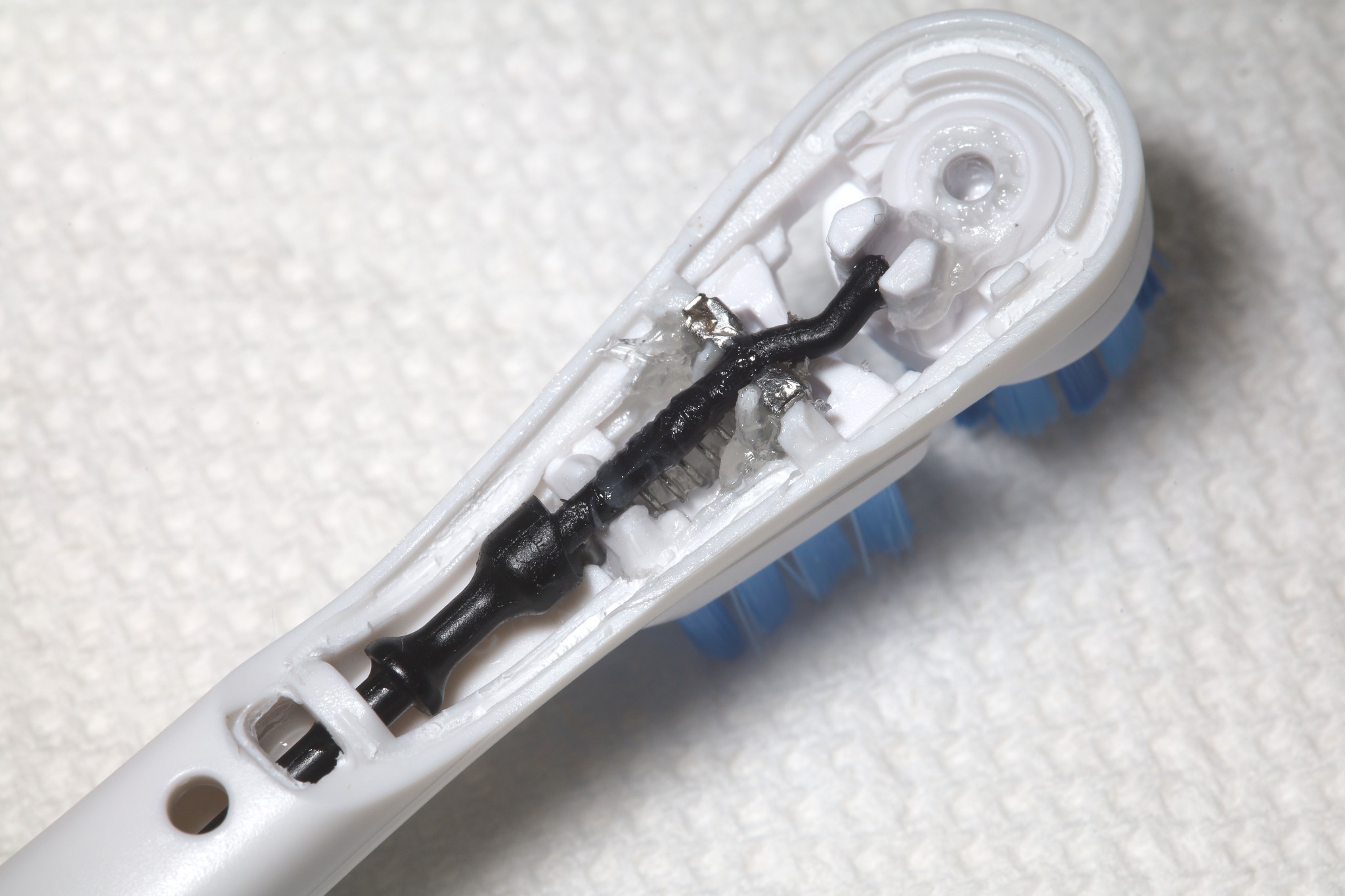

The current design has a single ABS pushrod creating a linear brush motion & a rotating brush motion. The rear cover can be popped off with destructive force. It still can be pressed back on.
The problem is the motor pushes 1 way on the linear section while relying on a spring to push the other way. The spring doesn't have enough force, so the stress of the bristles tends to stick the brush all the way in 1 direction.
The motor seems to push both ways on the rotating section, so it doesn't have any problems.
The 1st idea was to clean off all the silicone grease & try gluing the pushrod to the linear brush. Helas, a medium CA glue just went all over the place & stuck the brush solid. It actually did stick to the pushrod, but fractured between the pushrod & the brush.
During this process, it became clear that this mechanism was intended to reduce the manufacturing precision. The start & end point of the linear motion is non deterministic. The easy solution is to have the motor push 1 way from any starting position. Then the spring pushes the other way from any ending position. Trying to fix the pushrod to the brush would make the pushrod hit a hard stop & break.
