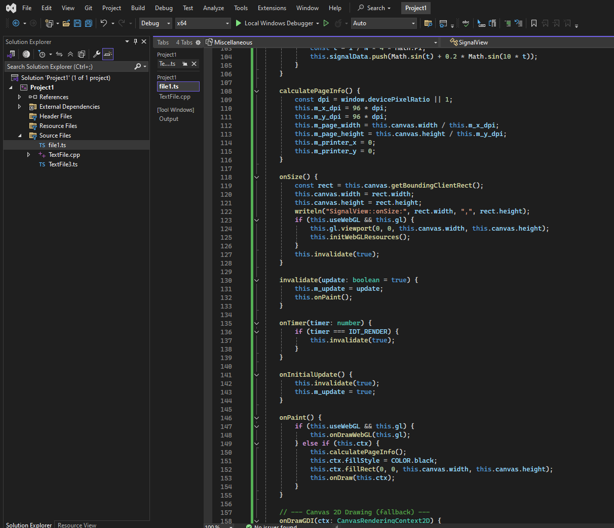

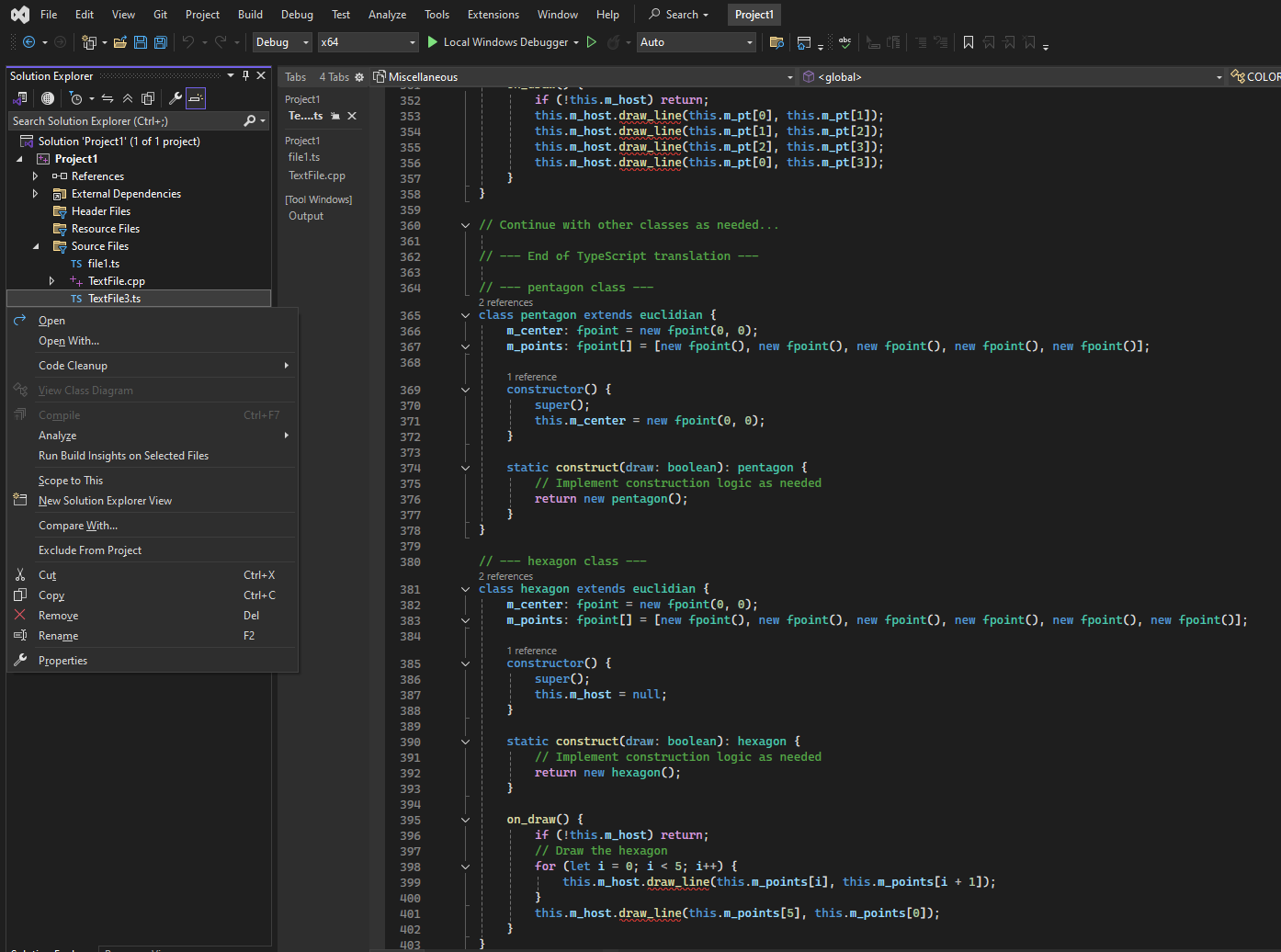

    So, I went ahead and decided to see how difficult it would be to convert the entire project to TypeScript, on the one hand, or else, while also considering just how difficult it might be to write a complete REACT environment from scratch.  Maybe not that hard at all.  Easy weekend project?  Maybe.  It is usually never actually that simple, but why not give it a whack?
    First, I went ahead and started working on converting my CSignalView MFC class into TypeScript, since ideally JavaScript should be deprecated and not used for new work, but as usual, your mileage may vary.
    So far, so good.  Things look even better on the WebGL side, as far as doing some of the OpenGL initialization.  That is to say, if any of this actually works.
    So, the particular tool that I used seems to have just enough know-how to give me some boilerplate WebGL code that appears to have the ability to draw a grid and even plot some "waveform" data.  So maybe if I decide to use Euclidean geometry, WebGL style, this could be adapted, while remaining faithful to the implementation details of the Euclid.cpp code.  Not surprisingly, or perhaps quite surprisingly (take your pick), when trying to convert the Euclidean stuff, the tool that I tried using pretty much fell apart.  Maybe it will work better if I ask it to convert one function at a time, which is pretty annoying.
    As you can see, the conversion tool in question pretty much gave up on certain functions, like the pentagon construction, hexagon construction, and also the angle bisector stuff, and that is all just a bunch of straight-up function calling and simple mathematical manipulation.  Like I said, maybe it will work better if I spoon-feed it one or two functions at a time.  Yet it is kind of funny that it does so well with some really messy code like WebGL initialization, yet falls apart on the same code that Co-Pilot fell apart on a while back.

    Decided to try an online code conversion tool that converts C++ to Typescript. Does it work?  I don't know.  In any case this is what the actual function that calculates the position of the sun in the sky, given the longitude, latitude, and time of day appears to look like.
    compute_local_aspect() {
        let solar_time, ra_base, ecliptic_aspect;
        this.m_gmt_seconds = 3600.0 * (this.m_hour - this.m_daylight_savings - this.m_time_zone) + 60.0 * this.m_minute + this.m_second;
        solar_time = this.m_gmt_seconds * (1.0 / 3600.0);
        this.m_julian = julian_day(this.m_month, this.m_day, this.m_year) - julian_day(3, 20, 1900) + solar_time * (1.0 / 24.0);
        ecliptic_aspect = ((this.m_julian % 365.242191) * TWO_PI) / 365.242191;
        const ecliptic_aspect_vector = tensor.rotate_z(ecliptic_aspect).multiply(_vector(1, 0, 0));
        ra_base = (ecliptic_aspect * 24.0) / TWO_PI;
        const SIDT = tensor.rotate_z((solar_time - ra_base) * (TWO_PI / 24.0) - TO_RADIANS(this.m_longitude));
        let local_xyz;
        const p = new polar_orientation();
        p.m_theta = 0.0;
        p.m_phi = TO_RADIANS(this.m_latitude);
        local_xyz = p.get_xyz();
        const ROTL = tensor.rotator(
            _vector.normalize(local_xyz.cross(_vector(0, 0, 1))), p.m_phi - PI_OVER_TWO
        const GLSUN = ROTL.multiply(SIDT).multiply(this.m_ROTX);
        this.m_local_solar_vector = GLSUN.multiply(ecliptic_aspect_vector);
        const q = polar_orientation.from_axis(this.m_local_solar_vector);
        this.m_el = TO_DEGREES(q.m_phi);
        this.m_az = ((360.0 + TO_DEGREES(q.m_theta)) % 360.0);
     Pretty much a no-brainer, once most of the real work has been...

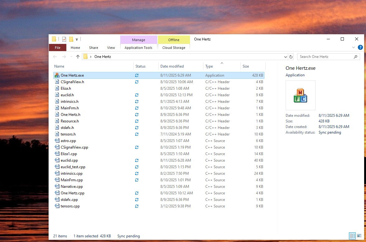

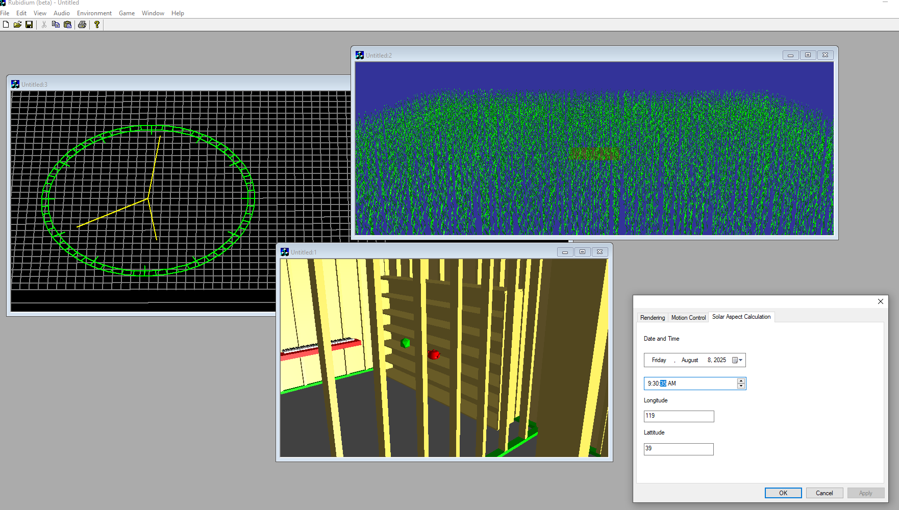

    OK, this is where the project stands right now.  I have the "Teapot In the Garden Stuff running in one "application" which is OpenGL aware, and which has a whole bunch of fun stuff, like wave audio playback, multi-document support, and so on.  Here, it would be easy to implement an OpenGL clock face, so that I can perhaps have my "clock on the wall" or a clock tower in a garden scene, whether in a game-like environment, or based on GPS data.
    In another application, I have been merging the GPS with the input stream that feeds to an Eliza-style chatbot, for purposes of testing the ability to decode the live streaming data, when available, among other things.  Here is an example where I simply copied and pasted some test data from Wikipedia, so as to test GPS string parsing in "Eliza" and verify that the data can "optionally" be streamed to an MFC-style CEdit View, while diagnostic data verifying that the NMEA string parsing of the "tokenized" stream is working correctly, and that the associated azimuth and elevation of the sun for the relevant location is also being calculated.
    Likewise, the "Propeller Debug Terminal" application, which is available on Git, and will be updated at some point, also supports GDI-based graphics, in the CSignalView class, as can be seen with some of the sample plots of oscilloscope data and the plotting of something resembling a Smith Chart.  In this configuration, actual GPS data can also be streamed from a GPS module, where it is simply being displayed alongside a here-seen, partially drawn Smith-Chart.  Perhaps what I should try next, therefore, is to go ahead and see if the Propeller Debug terminal can make calls into the Euclidian geometry library via the CSignalView class, instead of simply "drawing a Smith Chart directly".
    Then maybe add Open-GL support to the Euclidian library, so that I don't have to try to implement a full Open-GL stack in software, since I really only would need that if I were going to port the application over to another platform, like running it on a Propeller P2 board, which I have, or some other alternative platform, like a commander X16, which I do not have, or even a full ground up FPGA based system, with custom CPU operations done in Verilog.  Not quite there either.  Maybe some other time.
    Maybe a nice Win32 application with OpenGL support, but without MFC support, that could perhaps be compiled as a control panel, screen saver, DLL, or even as an Active X control so that it can be tested as a possible "browser plug-in".  What am I leaving out? Haven't ever done much with "Processing", even though it does appear to be a popular platform, and that would possibly help with MacOS, and or Android support, along the way.  Maybe I should look into whether anyone else has ever tried creating Windows Desktop accessories in Processing.
    Or maybe some other time, in some parallel universe. Then again, it is quite simple to try to create a pure standalone application without full Document-View support, but which makes use of the Euclid stuff as an externally linked library, even though that takes a whole world on its own of fiddling with settings for whether I want to render for a certain page size, or whether I want to resize for the current view, i.e. so as to fit to the current window, and so on.  Then I will need to add in the GPS over USB stuff, and create some dialogs for adjusting the settings.  Not sure how some things work in Windows 10, but it used to be possible to take a regular exe and simply change the suffix to cpl and you had a control panel, or you could change the suffix to scr to get a screen saver, provided that you also added in the needed command line parameters to tell the screen saver whether it was in preview mode or whether it should be in full screen mode.
    Now, subclassing an actual Microsoft Windows application?  Well, the old-fashioned way...

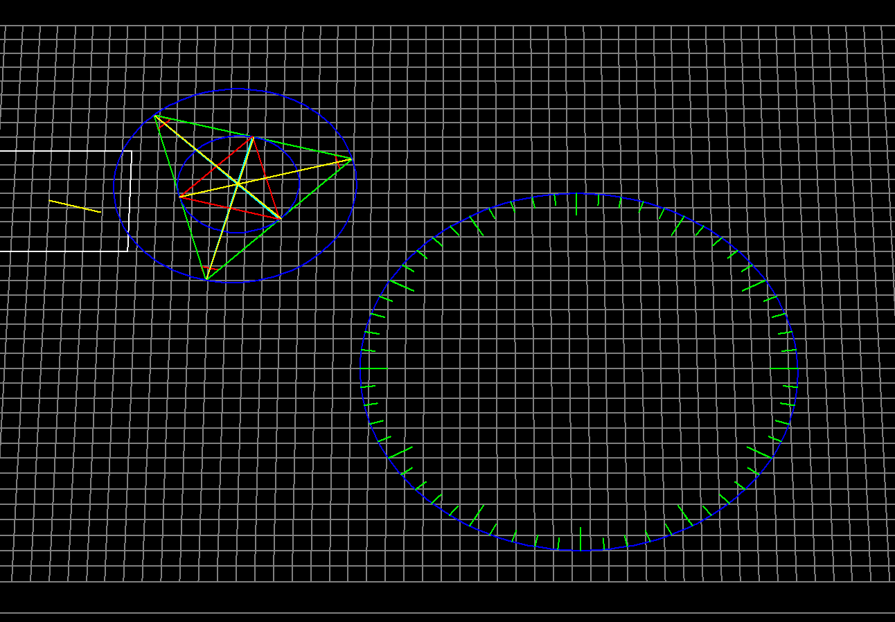

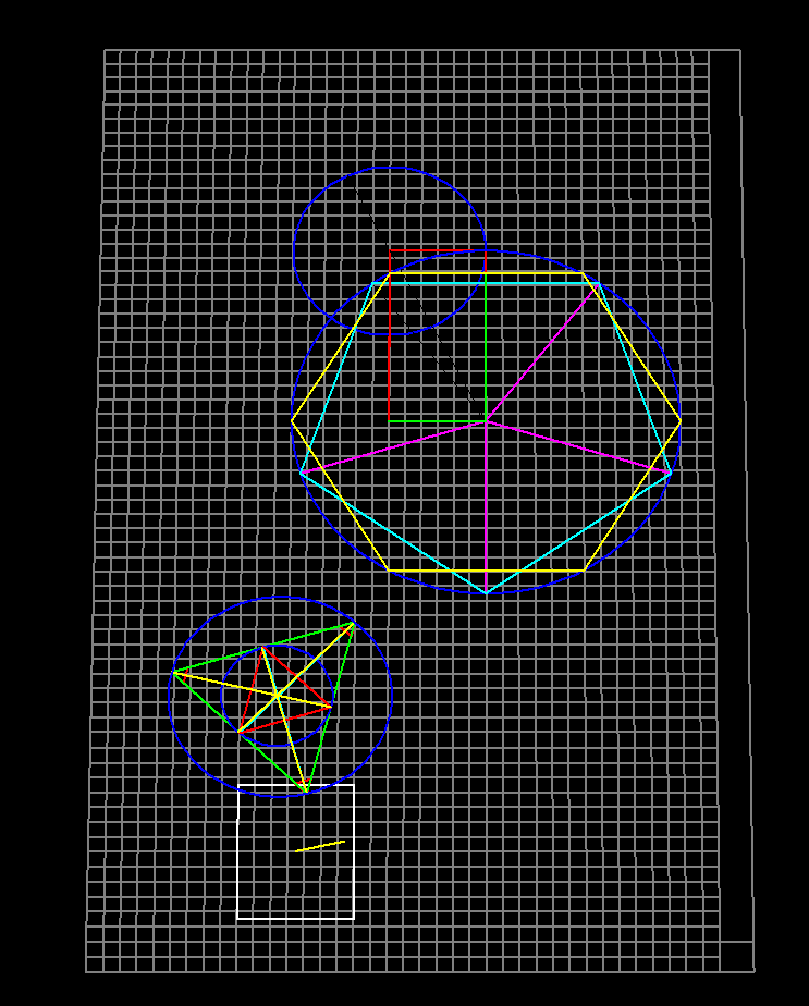

    First attempt at doing a test rendering of the "calculation" for the minute marks with this code.  Ran "correctly" on the first try. Zooming out will show what is really happening.
    With this code no less:
    void euclidian::draw_clock ()
        vector<fpoint> hrot;
        fpoint minute_marks [60];
        dodecagon hour_marks;
        pentagon penta;
        hour_marks = construct_dodecagon (false);
        penta = construct_pentagon (false);
        euclidian::bind(*m_host,hour_marks);
        hour_marks.on_draw (true,true);
        fpoint center = hour_marks.m_center;
        fpoint radial = hour_marks.m_points[0];
        m_host->draw_polygon(center,radial);
        int i,j;
        angle a;
        hrot.resize (12);
        for (i=0;i<5;i++) {
            a = angle(fline(penta.m_points[i],penta.m_center));
            for (j=0;j<12;j++)
            hrot[j] = hour_marks.m_points [j];
            a.angle::rotate_points (hrot,hour_marks.m_center);
            for (j=0;j<12;j++)
            minute_marks[12*i+j]=hrot[j];
        SETCOLOR _(m_host->m_pdc,COLOR::magenta);
        for (i=0;i<60;i++)
            m_host->draw_line (hour_marks.m_center,minute_marks[i]);

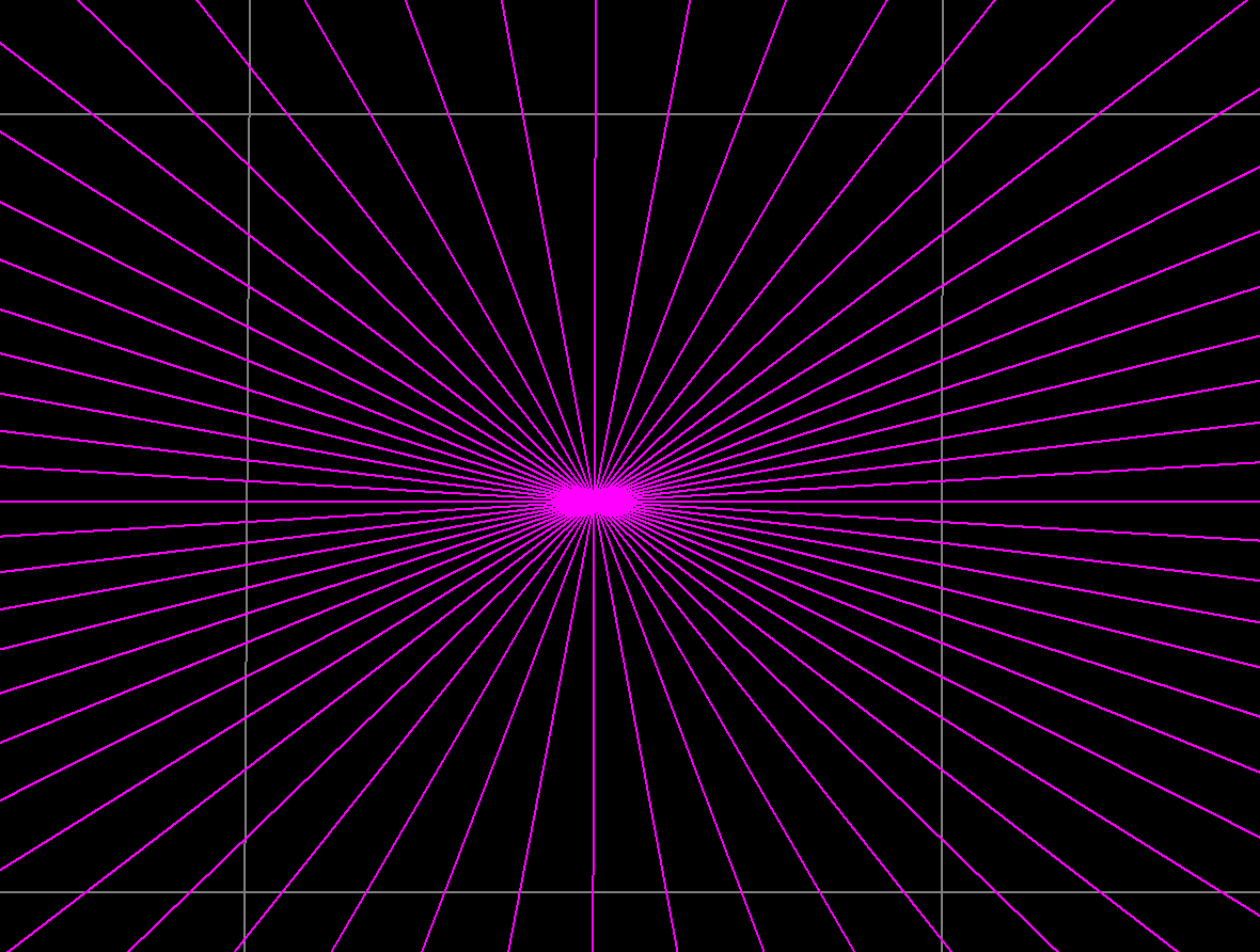

    Well, there is still a bit of work to do.  Like I might want to consider running quick sort on the minute marks, because they are most likely written to the vector of fpoints in a somewhat scrambled or shuffled fashion.  Even though now that I am thinking about it, that wouldn't be necessary if all that we are doing is using the point cloud to decide where to draw the actual and therefore properly determined minute marks, which should therefore be possible to draw, now, that is, in another piece of code. Hopefully, let's say, after a whole lot of this stuff gets refactored and then moved to a constructor.
    Or maybe I can actually run quicksort on the array, using a custom comparison function that compares the angles of adjacent points.  Something that is certainly worth looking into, even if that involves using trig functions, just to see what is really happening here.  Of course, if you didn't know that Gauss, I think, was the one who figured out how to do a 17-sided rigorous construction, and of course, 3 times 5 times 17 is 255, which means that a regular 255-sided polygon is also a theoretical compass and straight edge construction, which will have to wait for another time.
    A quick screenshot of some debugging information, where I call a function to calculate the actual angle of each line, as it is being drawn, shows what is happening.
    The good news is that it is exactly what I was expecting!  That being the nature of the design, code, compile, test, debug, etc., cycle.  Wanting to see results.  Now!  And getting an interesting, fun surprise now and then.  Now, like I said, I am thinking that I can still calculate the locations for my minute marks with this stuff.  Not a problem there.  Yet, I must confess that I have some circle drawing code that elsewhere is actually pre-calculating the points of a polygon with a "large number of sides" by actually making some calls to sine and cosine.  And THAT code needs to GO, since what I want to try instead is some kind of quadratic interpolation based on sets of three or four points, depending on the required resolution, and so on, and that will require that the points be sorted.  What to do, therefore?  Quicksort the array, or figure out how to fix the issue with modular arithmetic as the array is being created?  Hmm?  What would Eratosthenes or Pythagoras do?  Or Ptolemy, for that matter?
    Well, anyway.  A little more tweaking with the drawing code, and it is starting to look like something.  Even if the array that holds the coordinates for the minute marks is still unsorted.  Then it occurred to me, that in order to actually draw the time, without using trigonometric functions, I am going to need to be able to do a table lookup of the relevant locations, so that I can use a...
