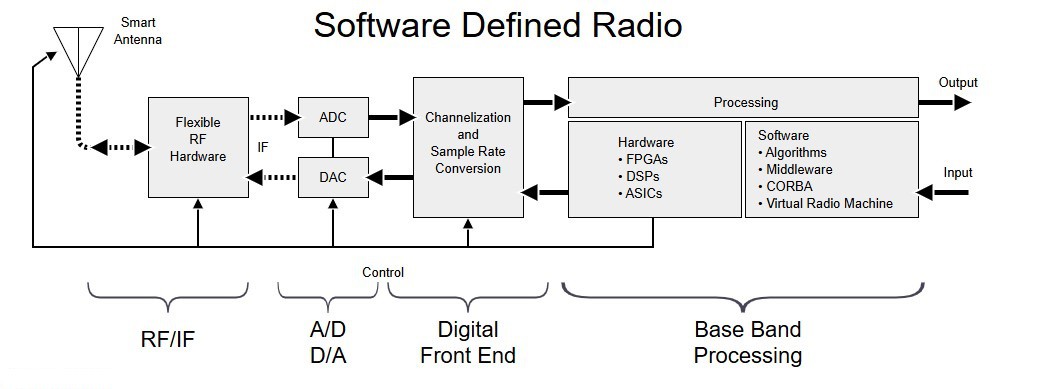

This flexibility allows SDR to be highly versatile and adaptable to different communication standards and frequencies.

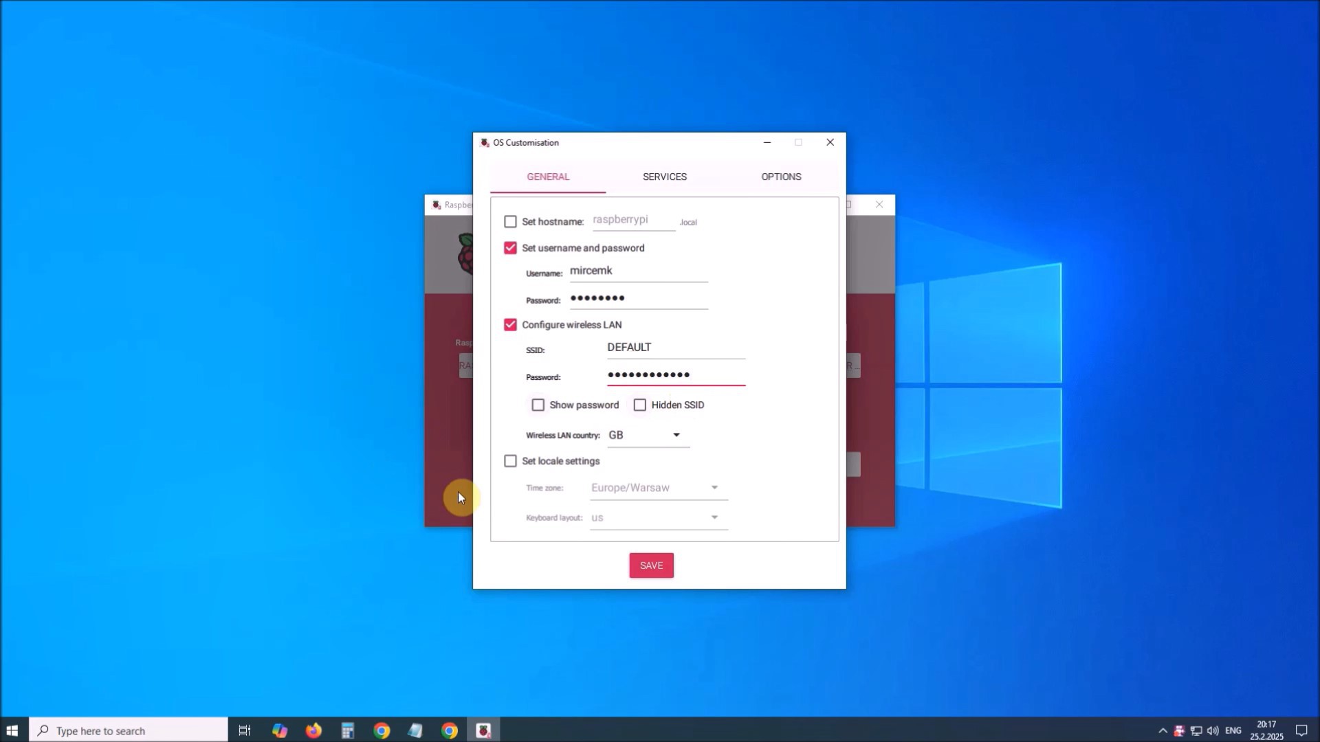

First, we need to download the image from the OpenWebRX+website. Then, we need to download the Raspberry PI Imager application, which will be used to install the image on an SD card. First we select the device - in my case Raspberry Pi 5, then we select the storage on which the image will be installed, and finally we select the operating system, selecting the Use Custom option, and select the image that we downloaded previously from the given address. Now it is desirable to perform some custom OS settings. Here we enter username and password, wireless LAN credentials and locale settings.
Then we go to Services and check Enable SSH. Now we press Yes and wait for the installation to complete. The installation takes a few minutes after we insert the card into the Raspberry Pi to which the SDR radio hardware is previously connected, in my case the RTLSDR USB stick.

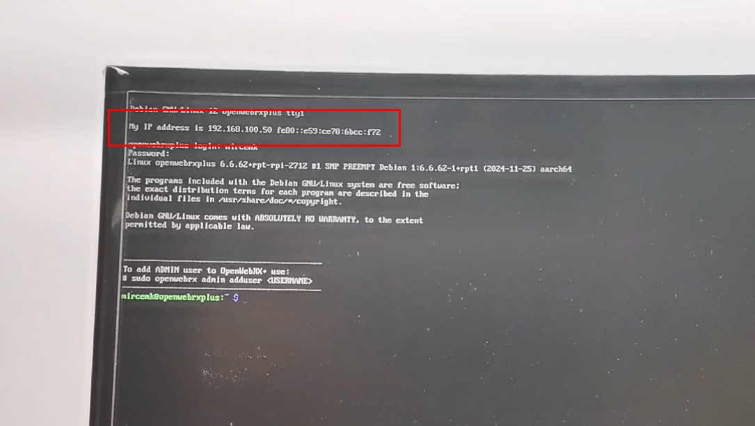

Now we start the operating system for the first time, during which it will reboot several times. We need to log in with the previously defined username and password. Now we need to create an ADMIN user for the OpenWebRX software according to the given instructions. At the top of the screen, you can see the IP address that this device has obtained on the local network.
And this is the complete installation procedure. From this moment we can use the SDR Radio from any computer in the local network via a web browser by entering this address. The next time you turn on the Raspberry Pi, you don't need a monitor because the software starts automatically.
