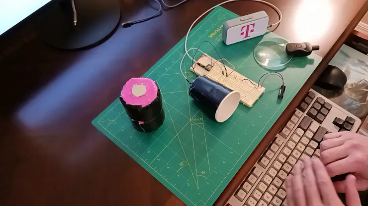

Even still, the photophone is a fascinating invention. It was so far ahead of its time, and it operated on such a clever and simple mechanism. So, I just had to recreate Bell's greatest invention, and this is how I did it.
Above is my transmitter. It is a pill bottle attached to a tripod, with the lid removed for speaking into. The other end of the bottle was melted out with a soldering iron with an old tip. A balloon was stretched over this end to act as a flexible diaphragm. A small mirror was hot-glued to the diaphragm. When sound enters the open end of the bottle, it causes the diaphragm (and the attached mirror) to vibrate. Light being reflected off of that mirror picks up the vibrations.
My receiver - top
My receiver - front
As for the receiver, I have used a paper cup that is covered in Gorilla tape to block out ambient light. At the back, in the center, there’s a photoresistor. I have a lens that refocuses the incoming light onto that photoresistor.
Current passes through the photoresistor, which is in series with a 10, 000 ohm resistor, and as light from the transmitter is received, the current varies. It outputs to an electromagnetic speaker — one that is much more modern than the one Bell used of course, and with an amplifier circuit built-in — but it operates on the same principles.
You may have noticed by now that there is just 1 lens in the build. That’s because I chose to use a laser instead of sunlight. This modern addition doesn’t change the principles of operation at all, but does let me avoid using most of the mirrors and lenses. If Bell had a laser available to him, I have no doubt he would have used it.
I have 5 volts DC running through the circuit, and one note on that — use a decent quality power supply. If it’s not a clean DC signal, you might get oscillations that distort the audio. I had that happen with cheap AC adapters.
When you have the components assembled, you just need to line them up. The laser needs to shine on the transmitter’s mirror, and that needs to reflect back to the receiver’s photoresistor. Then when sounds are made near the back of the transmitter, they will instantly be reproduced by the speaker.
That’s it. You’ve got the world’s first wireless phone!
Receiver circuit
My implementation
