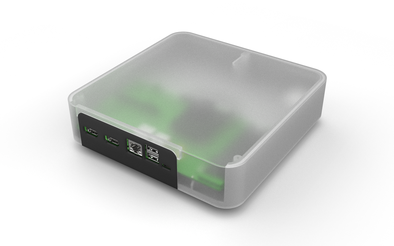

Enclosure Design
We begin this project by importing the model for the Compute module 5 together with its Evaluation board, which we got online in Fusion 360, and then aligning it so that we can create a Box-like Body around it. The goal was to create a design based on the Mac Mini, where the aluminum top is all that is visible and the I/O ports are all accessible from the back and covered by a black section. We divided our design into four parts: the main body, which holds the Compute module 5, and the I/O Cover, which is printed in black PLA and connected to the main body with two M2 screws.
To make the design more like a Mac Mini, we also created a Lifting part that lifts the whole model off the ground; this element is secured to the main body with three M2-sized screws.
On the main body, we have also included a circular opening where we will place the ON/OFF Push Switch, which will be used to restart the Compute Module 5.
Then we have the Top Lid Part, which is put above the main body and covers the main body within it; we designed it so that it acts as a cover for the main body and the rest of the model. The only visible components are the I/O Cover, which is located on the back side of the design.
My original idea for this project was to electroplate the top lid with zinc powder using the copper paint method; however, I was unable to do so due to materials not arriving on time. I also attempted painting the cover, but it turned out awful, so I printed the top lid with transparent PLA, which looks sleek and professional. If you use an SLA printer to print the Top Lid part, it will look exactly like an actual production part because of the support ribs and screw bosses.
After finishing the model, we exported all of the component mesh files and 3D printed them on our Ender 3 printer. The main body and lifting part were both painted with gray PLA, the top lid was printed with transparent PLA, and the I/O cover was built with black PLA.

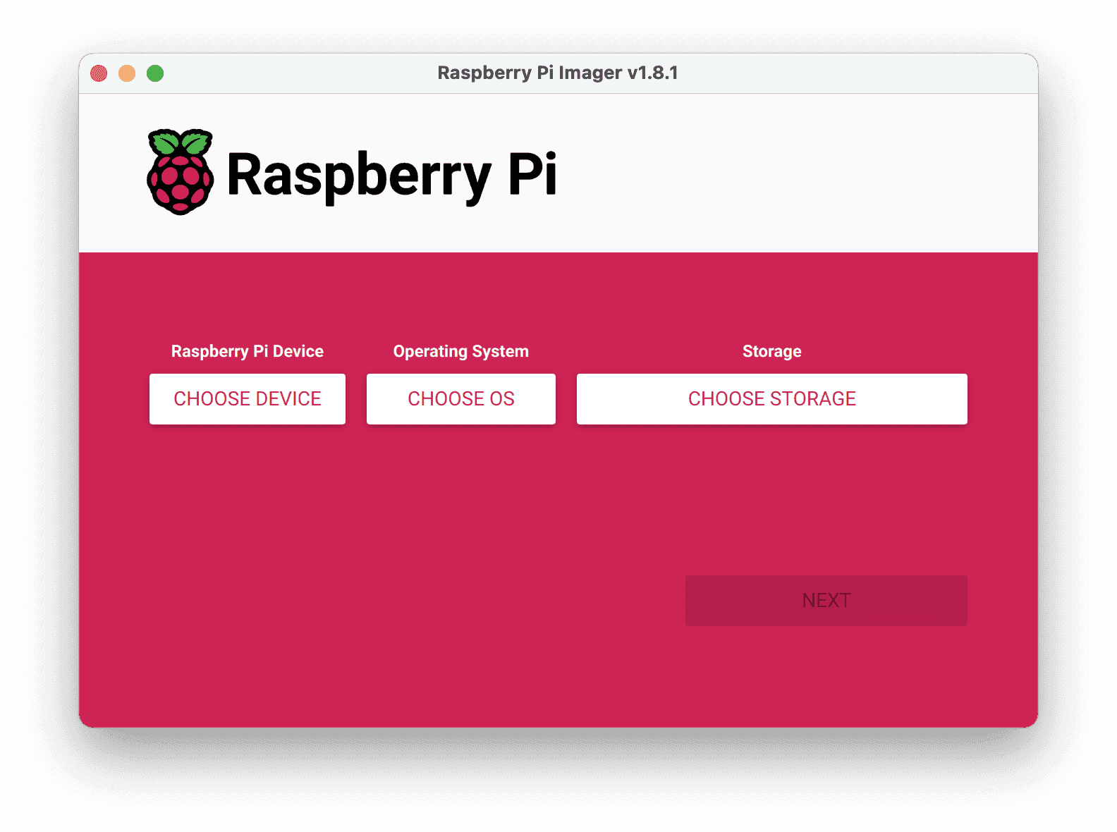

The simplest method is to use an SSD adapter to connect the SSD to the PC so that we can use a Raspberry Pi imager to burn the operating system directly onto the SSD. Alternatively, we may use the SD card to store the operating system first and then clone it onto the SSD.

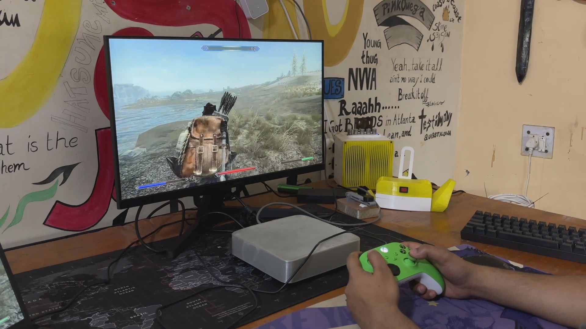

For the final phase in this small project, we installed Steamlink using Pi Apps, connected our laptop to Steam, and ran a few games, including HALO4, Silent Hill 2 Remake, and even OG SKYRIM.
The Pi CM5 handled everything we threw at it. Games are not running directly on CM5, but on our PC, Steam is streaming them via Compute Module 5, and they are working well, as demonstrated by the Gifs and linked youtube short.
HD video playback is also extremely smooth thanks to the CM5's VideoCore VII GPU, which includes hardware-accelerated decoding for H.264, H.265 (HEVC), VP9, and other modern video codecs, ensuring that high-resolution content plays smoothly.
The increased processing capacity of CM5 makes things a lot more enjoyable, and I will be experimenting further in depth with this board owing to the enclosure we prepared for this project.
