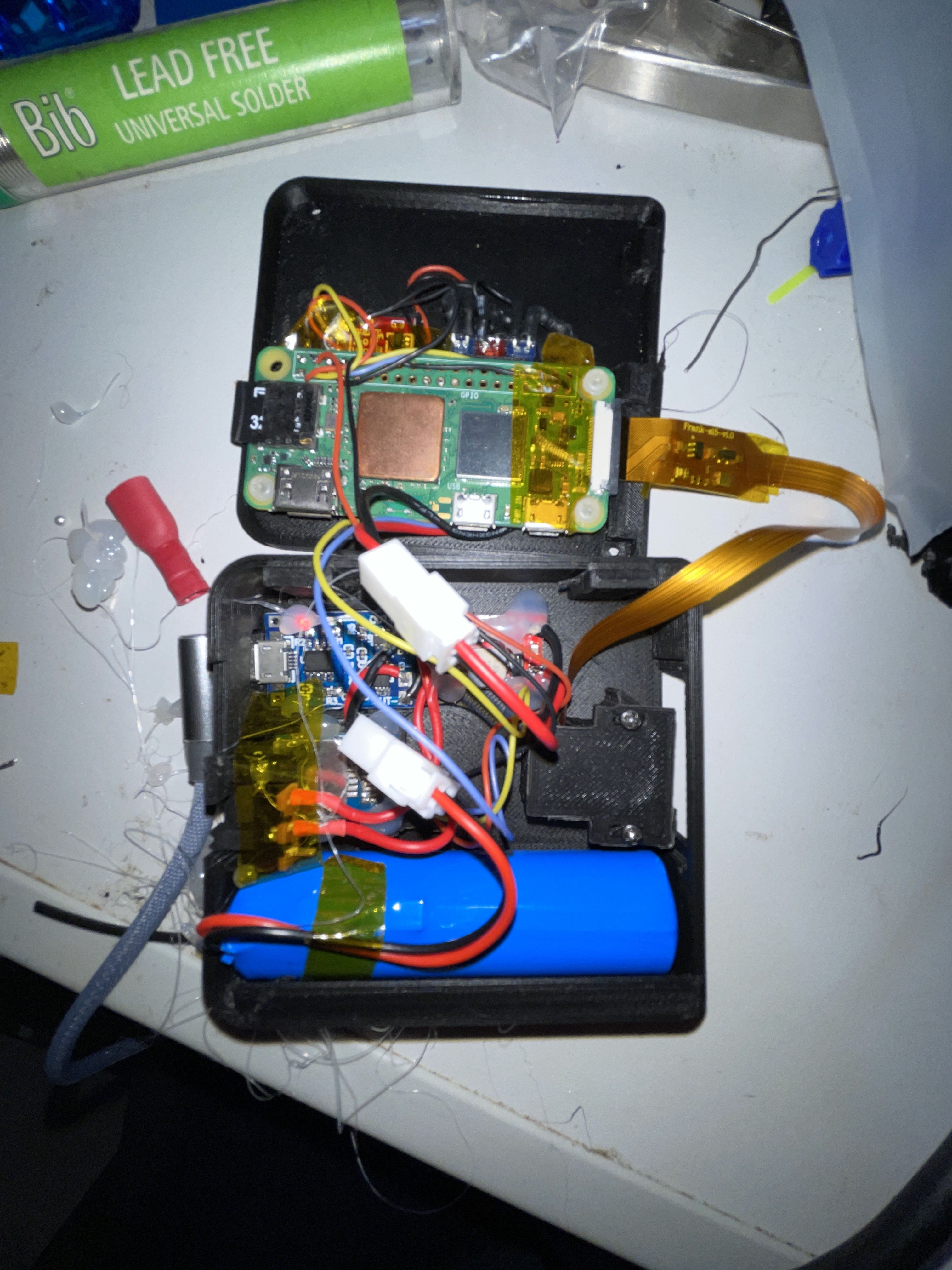

    This update is a small but vital step in this project. The digi cart is now running under its own power. I have swapped out the bad DC to DC converter.
    This new one can go up to 5 amps, so plenty of headroom. I have also found a micro switch small enough to fit in the case that can also take 1 amp at 5 volts ( max for this circuit )
    I've installed everything into the Digi Cart to see how it fits and to find out any issues
    Issues so far
    1 . Raspberry Pi standoffs need lowering to allow some more space for ribbon cable, as it is hitting the camera module when I try to close the lid fully
    2. The SD card reader is the type where the micro SD card sticks out, something I had not realised until I tried it in the case. I will need to rework the case design to move this SD card reader back.
    Before I address these issues, I'm sorting out the camera itself, trying out different ways to mount it, different-sized extension tubes, and making sure I don't need to change the mounting points on the case.

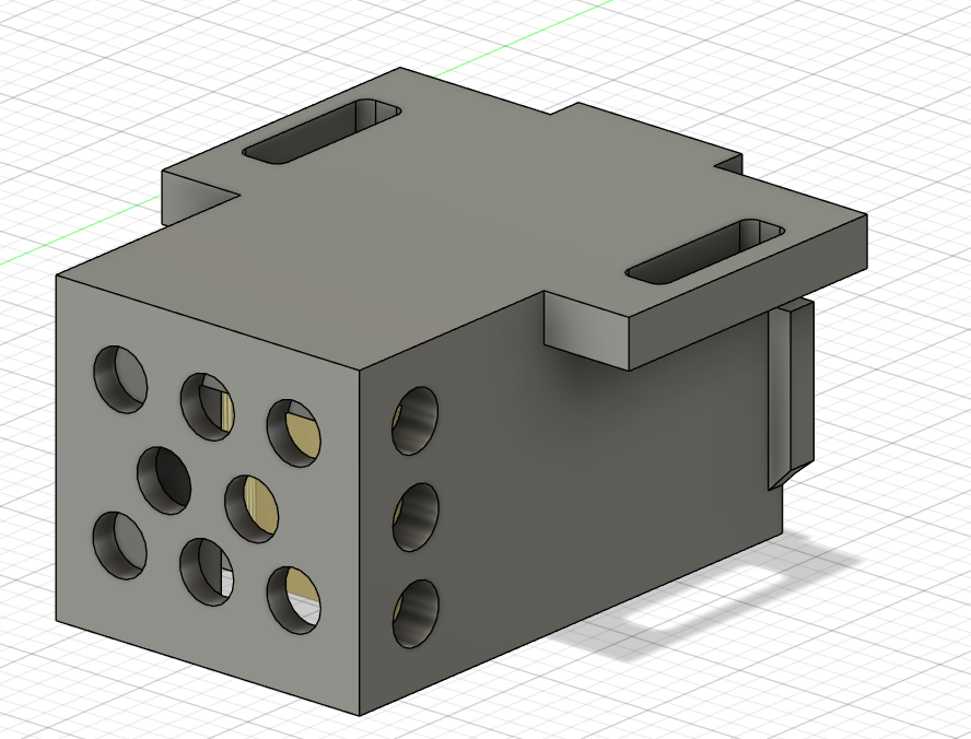

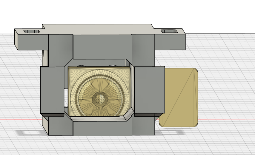

    I have been working on the camera mounting. After far to many editions ( more then you can see below ) I finally have a mount that works for my camera.
    This mount locks the camera from moving away from the focus plane while leaving enough space for me to experiment with different cameras/measurements from the focus plane.

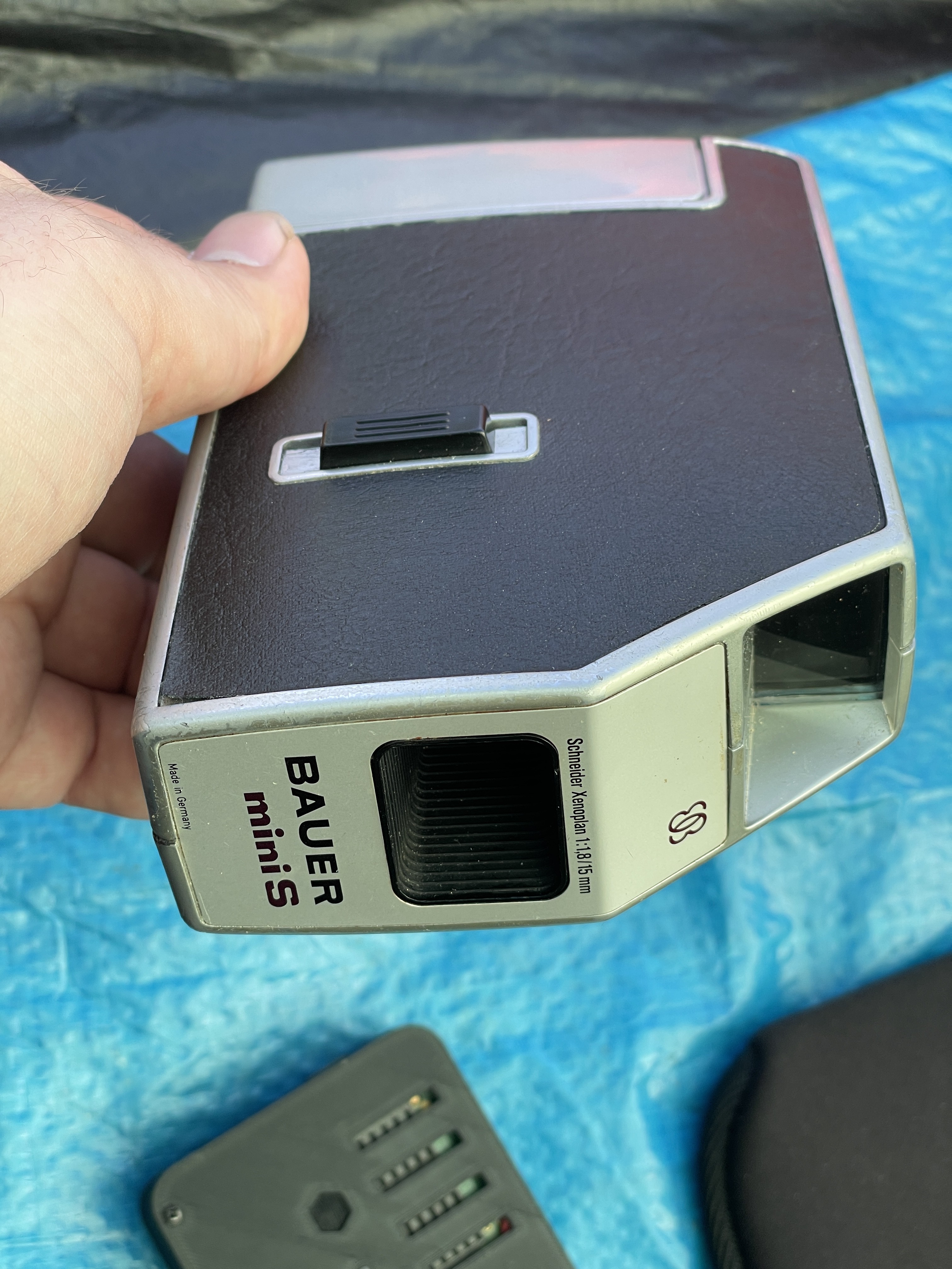

    I have two Super 8 cameras, one side-loading and one rear-loading. I have been trying this out with both cameras using the side loader so I can adjust the parts inside the DIgi Cart easily, and in the side loader, and I can confirm compatibility by trying the rear loader.
    After a lot of adjusting the position of the camera and the focus, we have success, I finally have an image, its not perfect but its a start.
