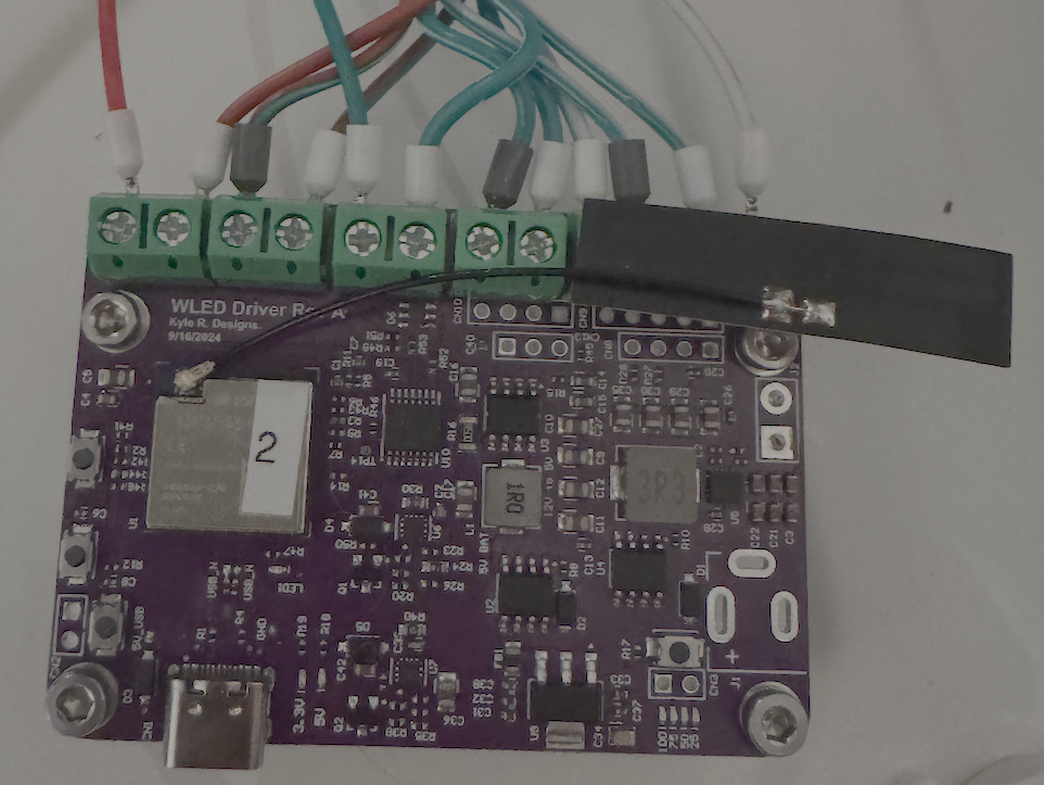

I used my custom WLED Titan board:

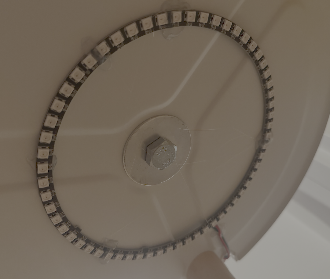

I added am LED ring on the bottom:

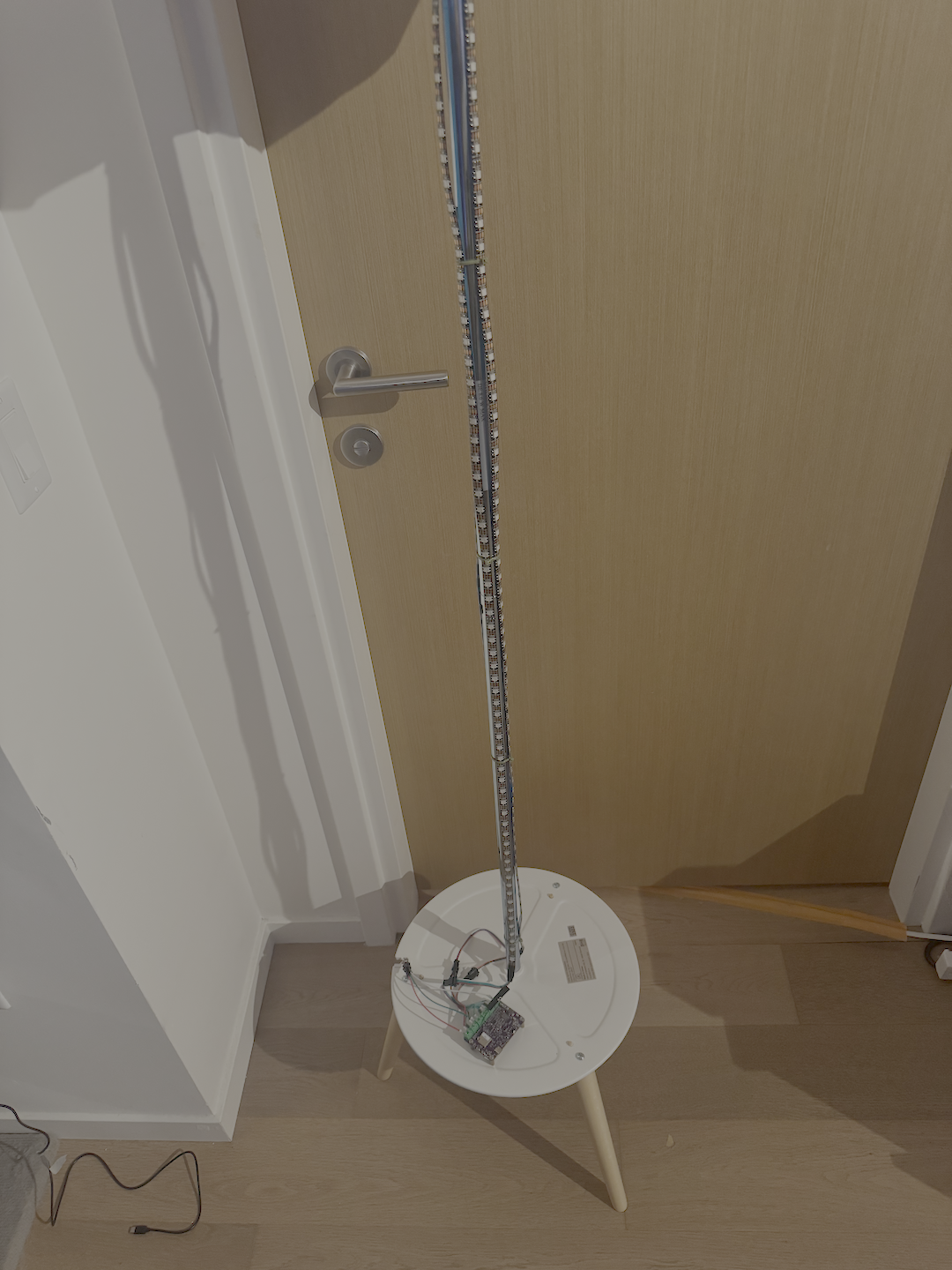

i used 3 segments of WS2812 60 LED/Meter on the pole:

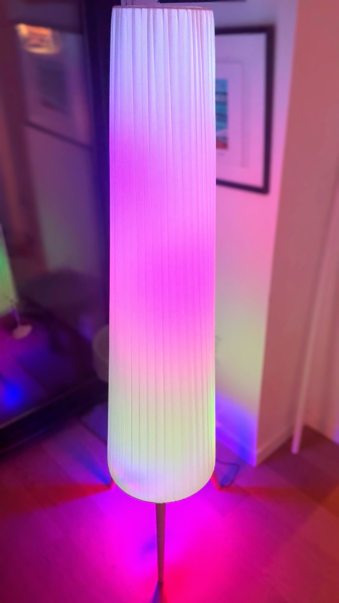

Final Product:
