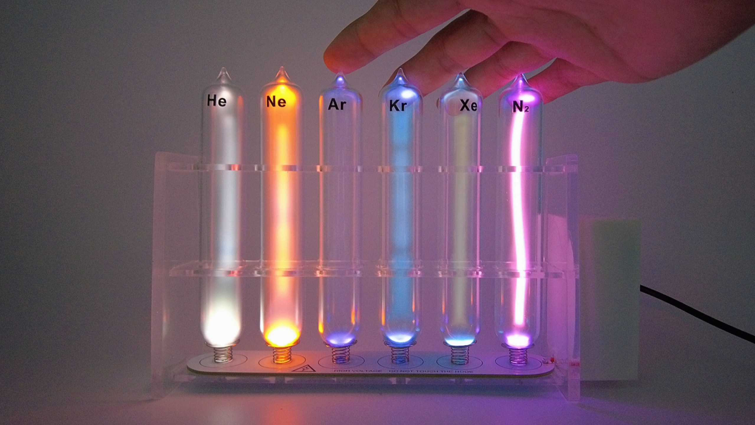

While the glass tube is still connected to the system, we can use a Tesla coil to check whether the gas inside has been properly filled. If the glass tube displays the correct color under excitation from the Tesla coil, sealing can proceed.

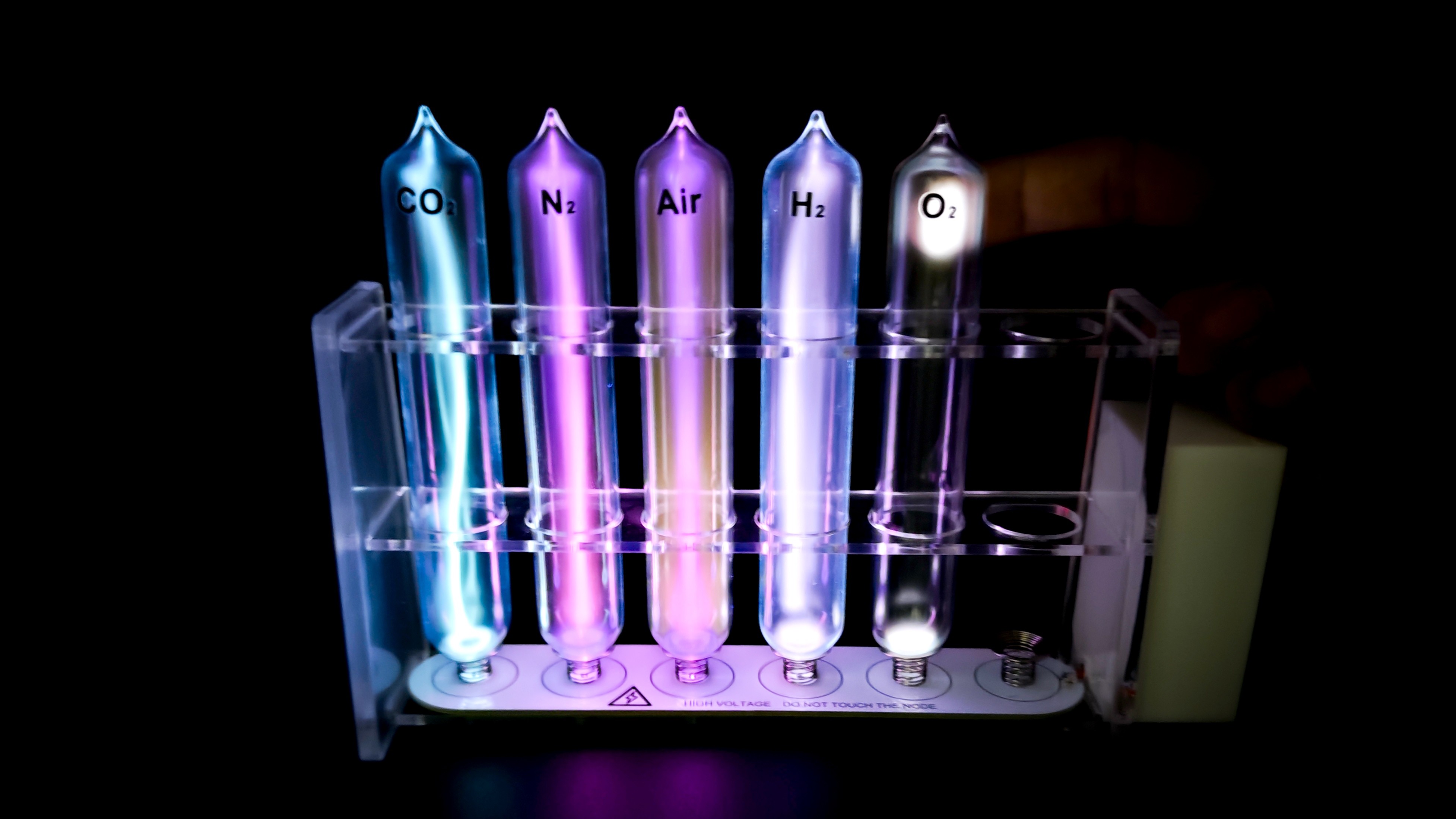

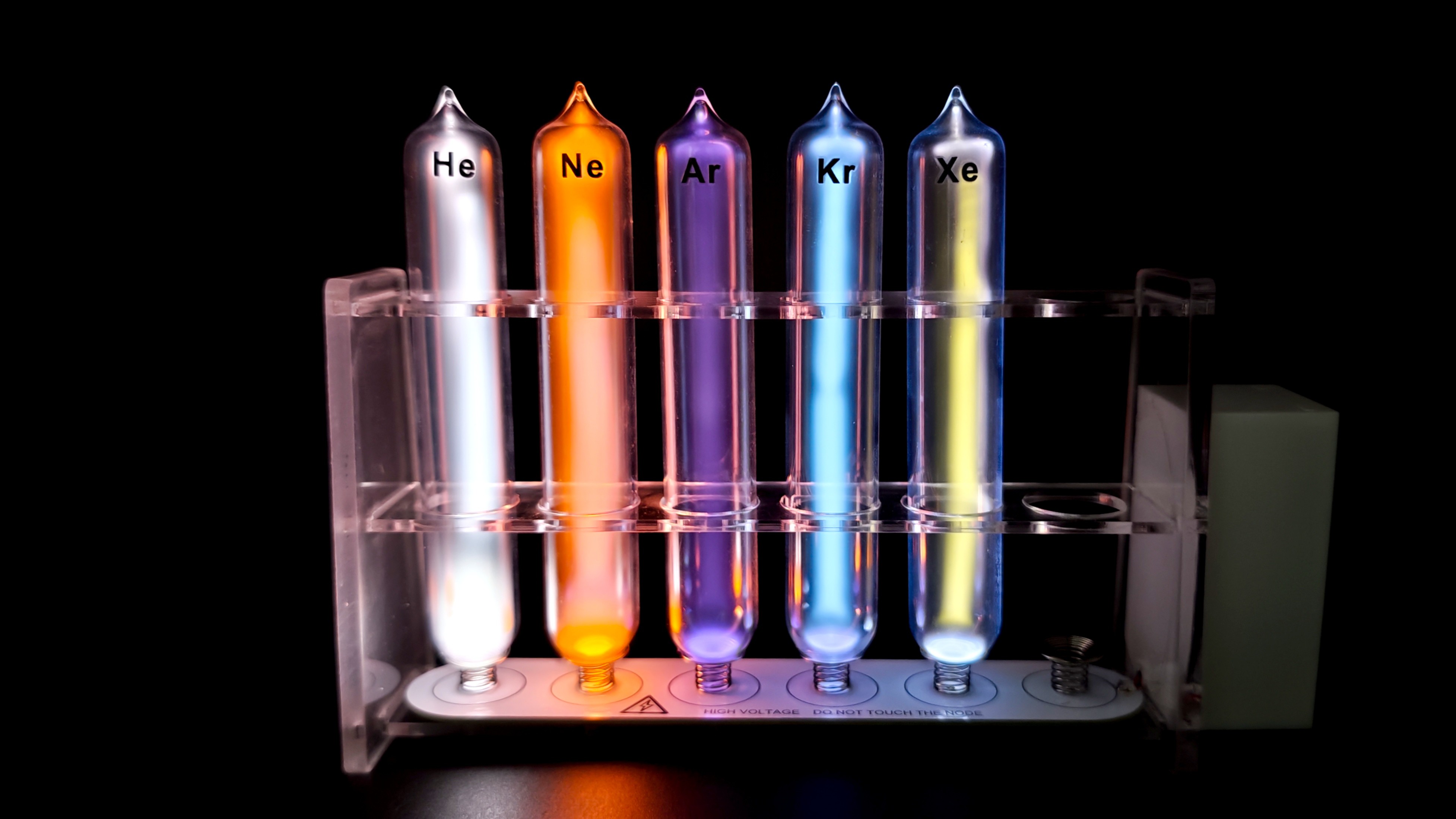

Step 5: Appreciate the Beauty of Noble Gases Glowing

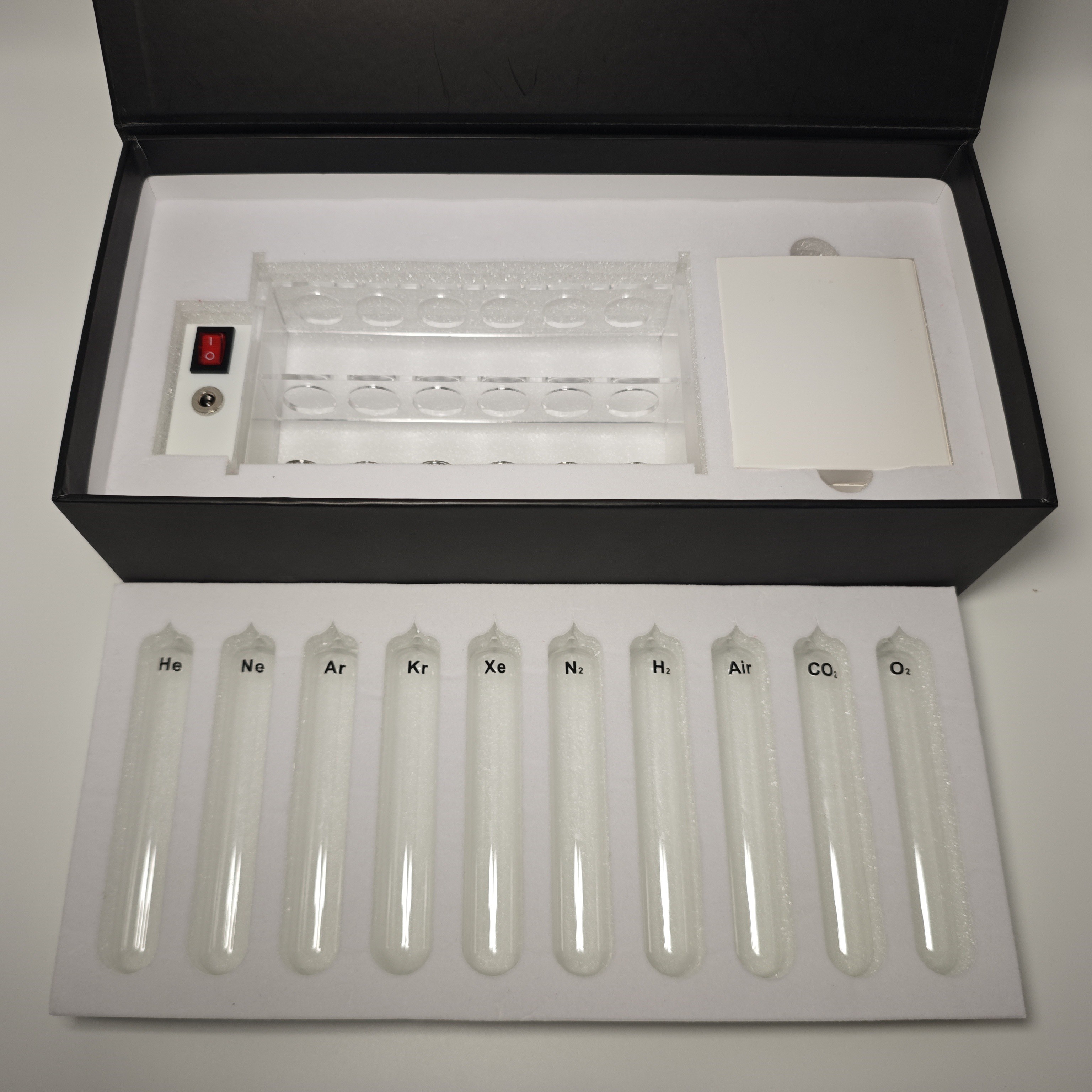

I created a variety of gas-filled glass tubes, including helium, neon, argon, krypton, xenon, nitrogen, carbon dioxide, hydrogen, oxygen, and air. Under high-voltage excitation, each gas displayed its own distinct glow.I named this project Lumora — a combination of "luminous" and "aurora." Since many friends were interested in this gadget, I also launched a crowdfunding campaign on Kickstarter. To preserve them properly, I even had a custom box made. This has been my favorite project of the year.
