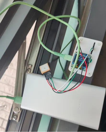

Outcome
Place the antenna outdoors or by a window to maintain connection.After powering up, it takes about 30 seconds for the module to start receiving and displaying clock, coordinates, and speed information.
For more details about the development board, visit the LCSC Open Source Hardware Platform.
OLED Display
Conclusion
This article introduced the design process for creating a GPS clock using the Ai-Thinker GP-02-Kit development board, providing a reference for further development and applications based on the GP-02 module.
