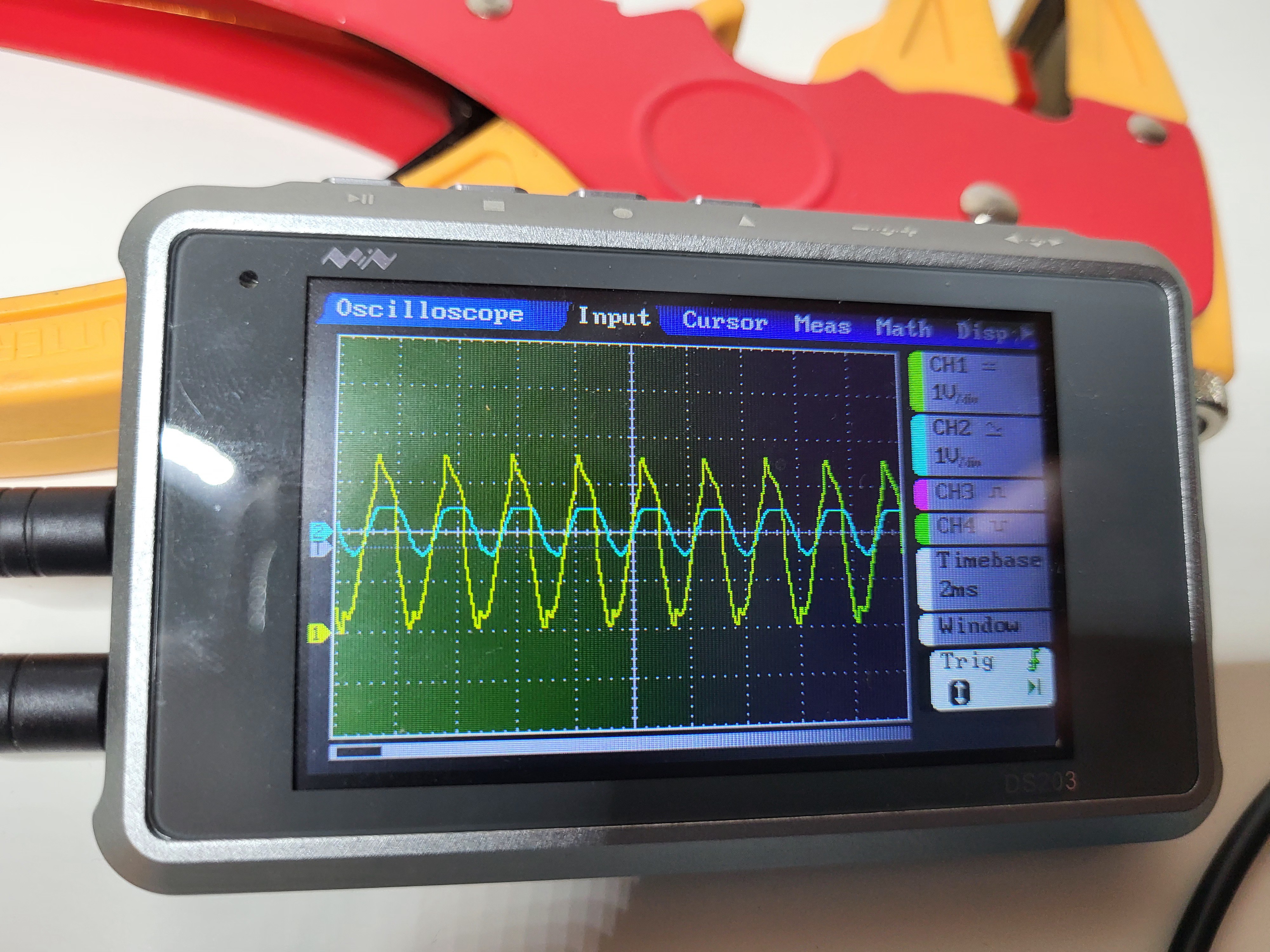

    In the previous Post, I described that I have sporadic overtones in the Fork measurement which slightly shifts the base frequency.
    The main Feedback is this (taken from the Inspiration's Project):
    There, R4 and R5 together with C2 and C3 form a Bandpass filter. Mainly I suspected the large C3 (High-Pass) to be too big.
    So I used my "trusty" DS203 oscilloscope and attached Probes to ForkOut (Yellow) and Pin 3 of the Tuning Fork Inductor (Blue). It is labelled 47^3 because of the 47 nF Capacitor at C3.
    Notice the sharp edges  at the low and high spots of the Yellow trace, as soon as the blue trace (the driving coil) either Turns on or the first step-off. (I don't know why it does the first step down. Well, I am not an Electrical Engineer...)
    Then I tried different Values for C3. From Top to bottom: 47^3, (10+22)^3, 10^3, and 68^2.
    You can notice the timing of the sharp edges being later with a smaller value, and also the drive of the Fork is more smooth with a lower value. Probably the Transistor was overloaded, but I don't know (Not an EE...)
    The Final Fork signal, after choosing a single 10nF Capacitor for C3 and moving the Fork until the trace looks optimal, I am much happier with the ForkOut signal, because it looks much more like an actual sine wave:
    Well, now off to a new test run for logging :)

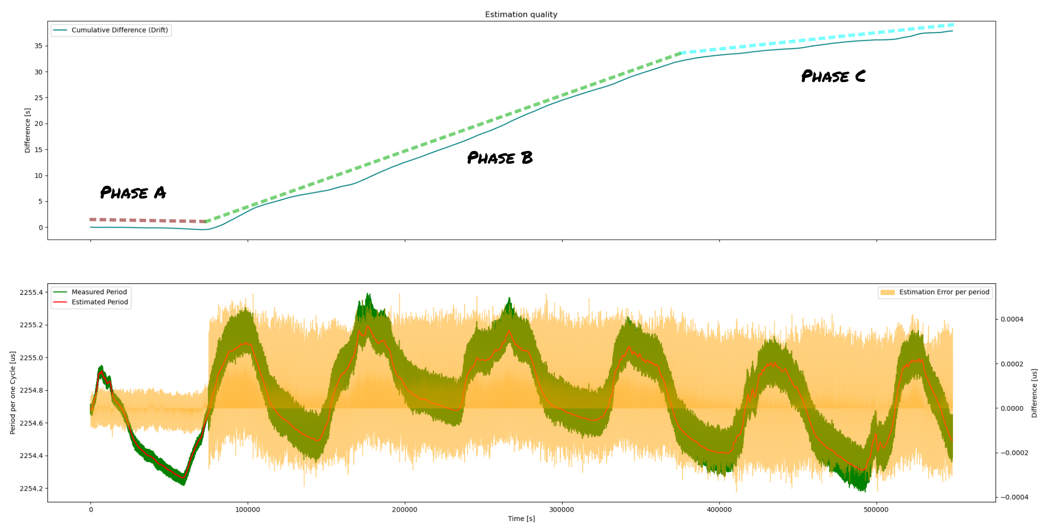

    As the deadline for the one hertz challenge approaches, I need to conclude the current validation test run. The changes mentioned in the previous post - mainly the hot display - increased precision quite a lot. However, as one can see in the previous log run, the Oscillating Feedback Loop on the Fork seems to sometimes produce noise overtones which seems to slightly change the base frequency. I will address that by tuning the feedback loop capacitors, but sadly this is too late for the Challenge entry. And only the hard facts count!
    For the good side: The Drift, before the noise kicks in (Phase A), is around -0.5 seconds per day, which is a great project success for me. And in the last Phase C, when the frequency seems to settle, so does the drift (remember: Measured against a one-megahertz reference GPS "ground truth").
    And to allow everyone to look at it themselves, the raw data of that graph is published here.
    The other part of the Project was also the question what kind of Model is needed to estimate this System. This is fortunately answerable :)
    The final Process Model consists of 1. a rolling-average Temperature Dampening to estimate the temperature of the Fork based on the Sensor, 2. a two-degree polynomial for the Fork's frequency response, and 3. another two-degree polynomial for an estimation compensation based on the Temperature-Change-Rate to accommodate the warm-up of the fork for fast temperature changes. But, as you can see in the factors, the (3) Temperature-change-rate has a very small influence on the overall system, but increases the fit by a minor percentage.

    So, in conclusion: It is very possible to reach less-than-one-second per day of drift with a cheap tuning fork, a basic self-exciting circuit, and a lot of statistics and math :)
    I am sure that this can be done better, and I will also try to find out what in the circuit causes the noisy overtones / frequency nudge.

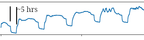

  • Tricked by Myself and the Power-Hungry Display
    PP07/27/2025 at 21:11 0 comments
    While the test-run with the sub-microsecond estimation precision is running, I was reviewing the logs from the previous run:
    ... which was not too great considering some data loss and an unstable GPS readout.
    Small side-note: actual pulse counter was working, but only the register readout had a too-small timeout value. This is a topic for another post, but with the reference clock being switched back- and forth, you also see the drift of the internal clock compared to the GPS.
    But you also see periodic temperature drops, which made me wonder where they come from. Is some abrupt heating / cooling happening when I am not in the office?
    But after watching the Video of CuriousMarc about the Display and remembering "Taking a lot of power"... It hit me.
    Do you see it? I dim the display at nighttimes to reduce Eye-Strain and in that glass-dome the "dayBrightness" (5 of 7) actually heats up the thing! And to make matters worse, the heat rises up to the Temperature Sensor, but most of the Tuning Fork is actually below the display, making it worse to correlate measured temperature with actual tuning fork temperature.
    So my first change will be to set it to "medium brightness" all the time to not throw the measurement off, and on the long run probably will drill a vent-hole into the Glass-Dome's top to allow the air to circulate (and / or put the temperature sensor on the bottom half).
    Weird Problem to have; but when the PPMs count, this is actually measurable in the precision!
    Here in the last image you see that the "Difference per period" (which is a measure of precision) is actually worse (most off-zero) when the system is non-uniformly heated by the display.
