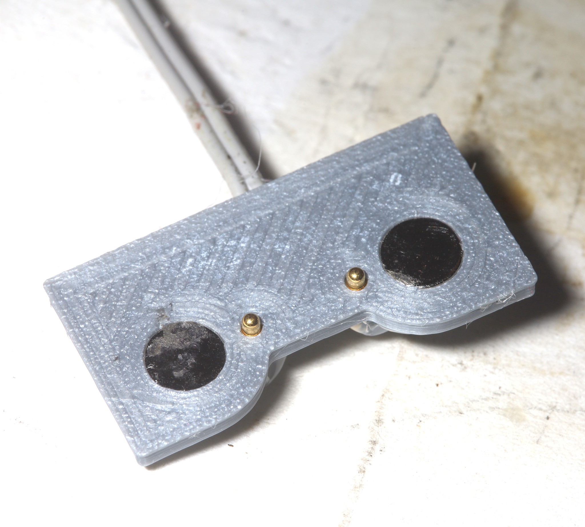

    lion mclionhead05/04/2025 at 01:12 0 comments

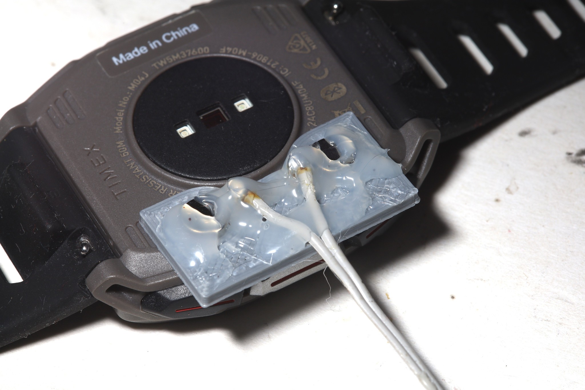

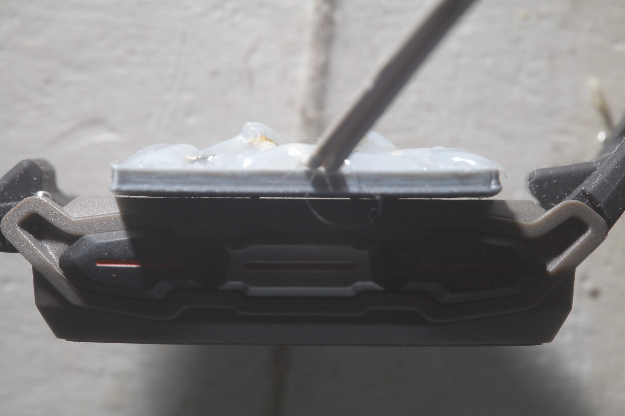

    The pogo pins from the mismatched chargers did well enough to try building another mag charger out of them.  It was just a lot of hot snot on a panel.  There was just a right amount of protrusion to keep the pogo pins from lifting the magnets off while still conducting.  This could be fudged & then the hot snot slathered on to keep it in place.
    It self aligns better than the clamp design & is reliable enough to not require any fuss.  It would be a more compact solution for traveling, but it could also give up the ghost in transit.  While the magnets are not as secure as the clamp, it's not going to slip off the contacts like the clamp.
    Ran for 4 hours with it in airplane mode & heart rate detection on, which left it at 22%.  It's nowhere near the 20 hours of a new battery.  It's not likely to last through a lion marathon.  The only way to replace the battery would be to release the screen adhesive.   It would also be nice to get rid of the magnets to make  it lighter.  Making it lighter trumps any benefit to the magnetic charger.

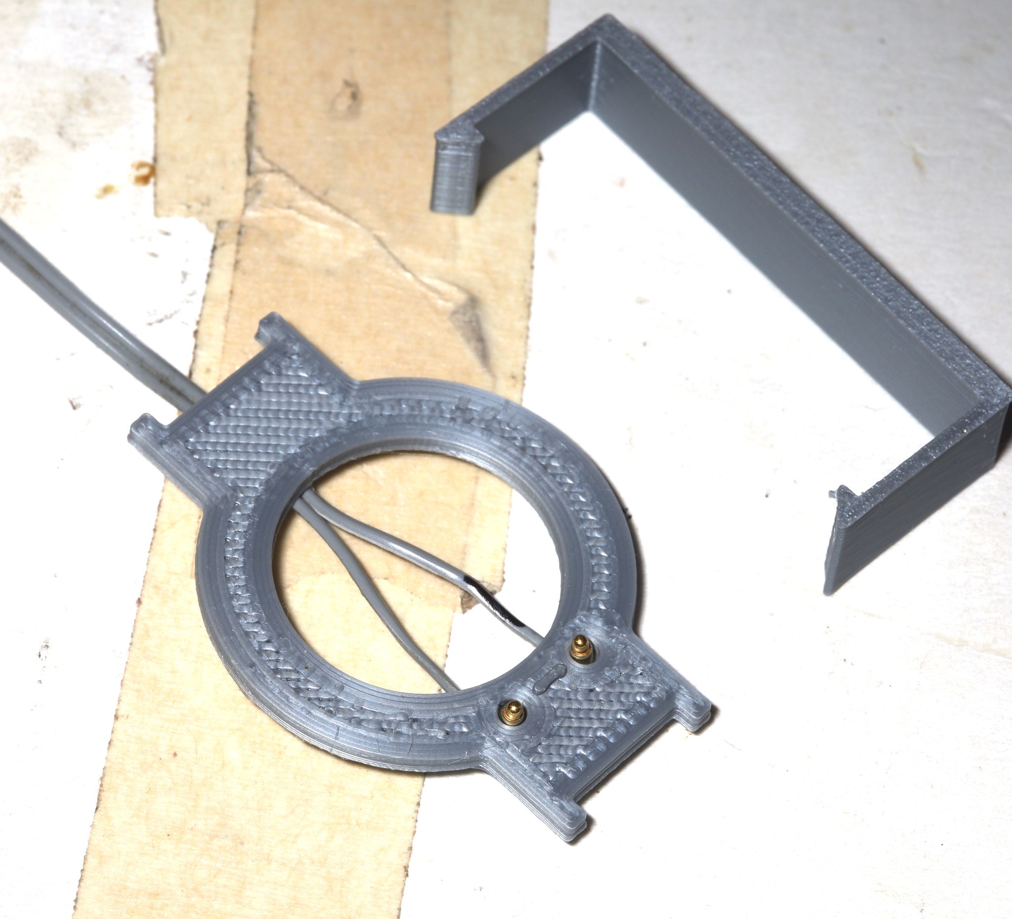

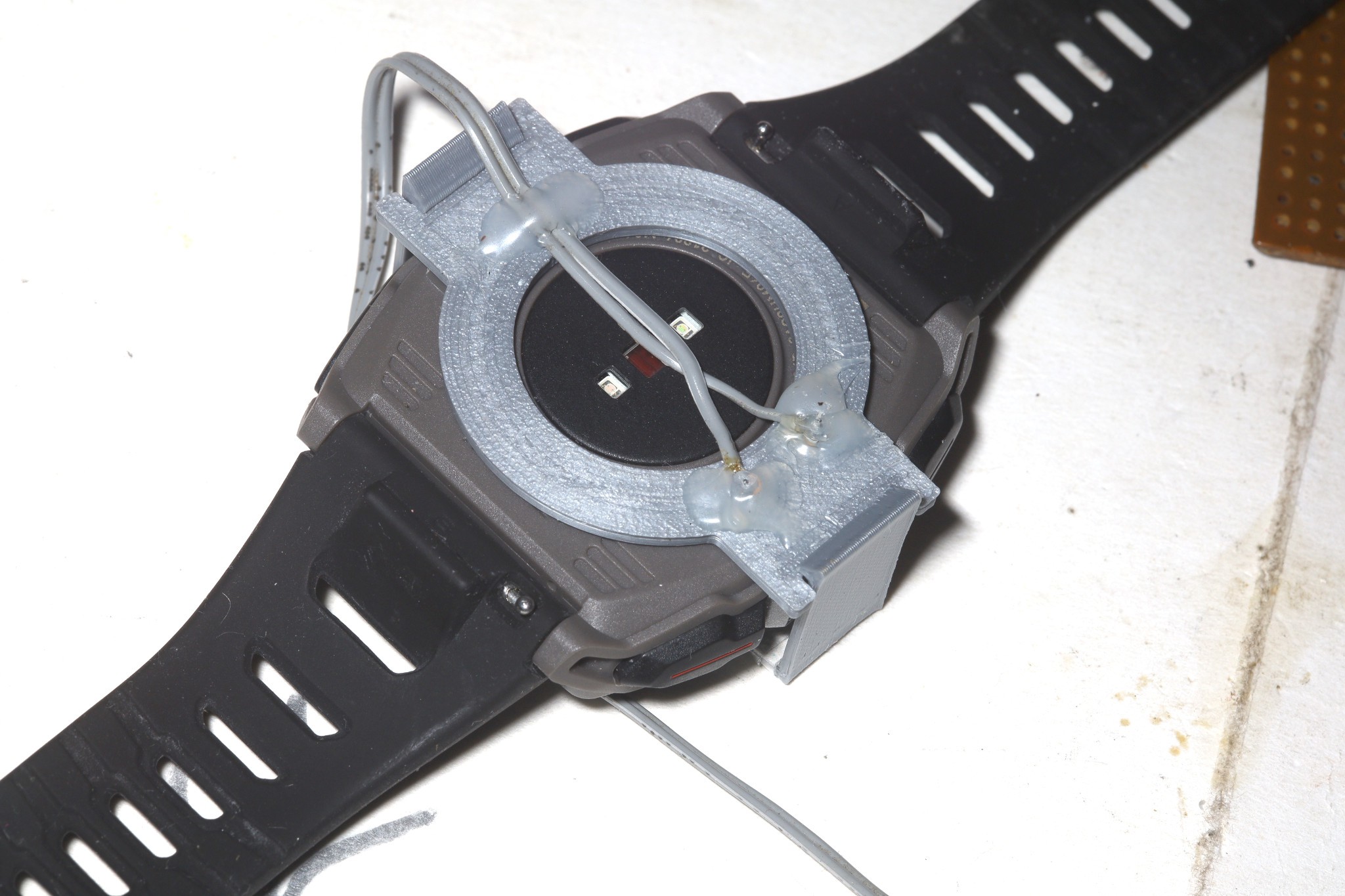

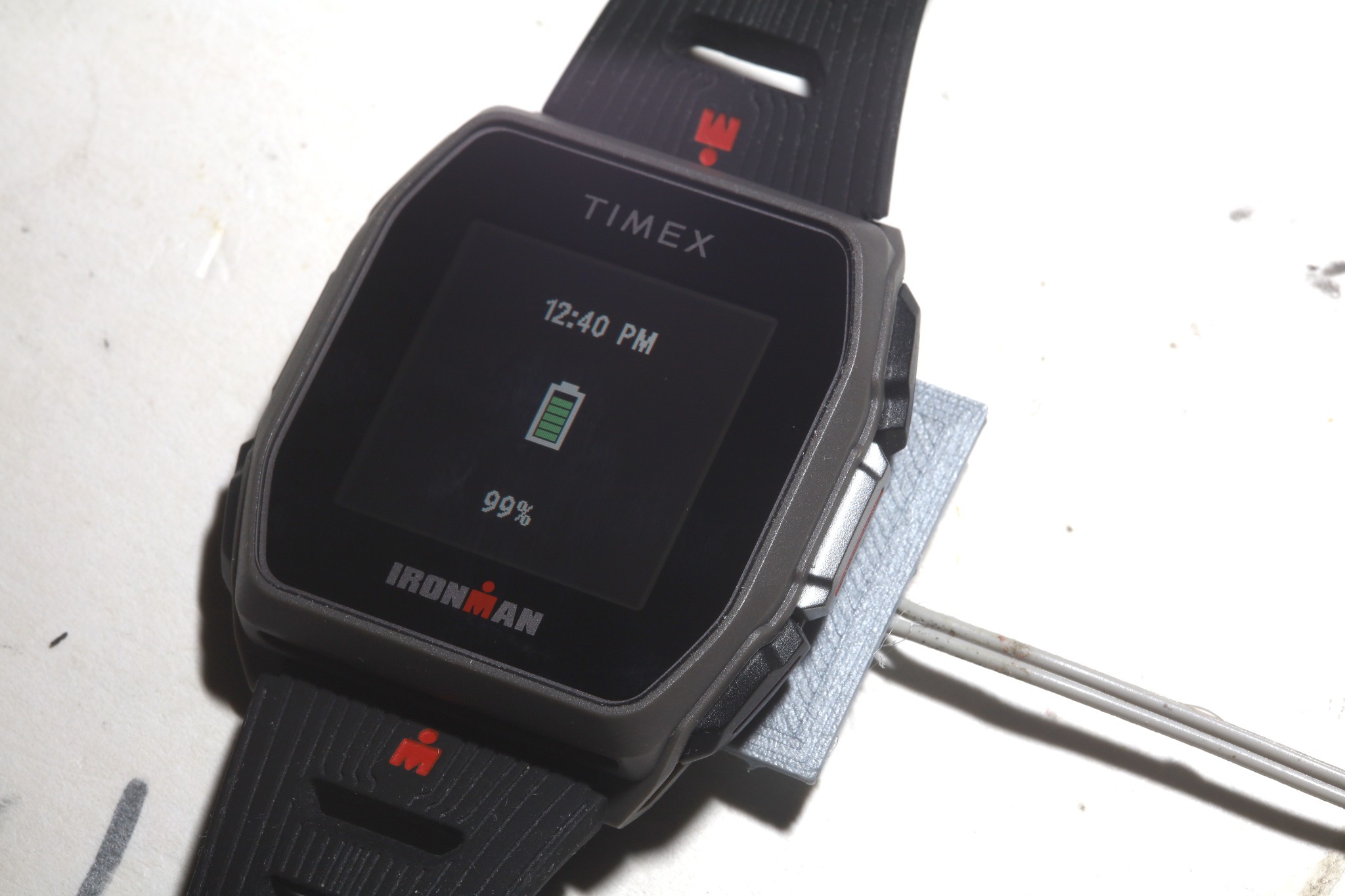

    Fortunately, we can attempt to make the $60 GPS watch a reality by fabricating a custom charger.  It's just 2 pogo pins held on by 6x3mm magnets.  3D printing it is no problem, but getting good contact is.  These particular pogo pins were particularly finicky.  A better contact would be a solid gold pad.  It draws 40-130mA at 5V.  A few attempts with a magnetic carrier were failures.  The magnets couldn't provide enough force to get the pogo pins to compress so the assembly just stood above the  watch.  It needed a lot of fidgeting & was unreliable.
    It's hard to believe anyone had a pleasant experience with contacting chargers.
    Printing the alignment fiducial & magnet holders is difficult.  The magnets alone seem to get it close enough.

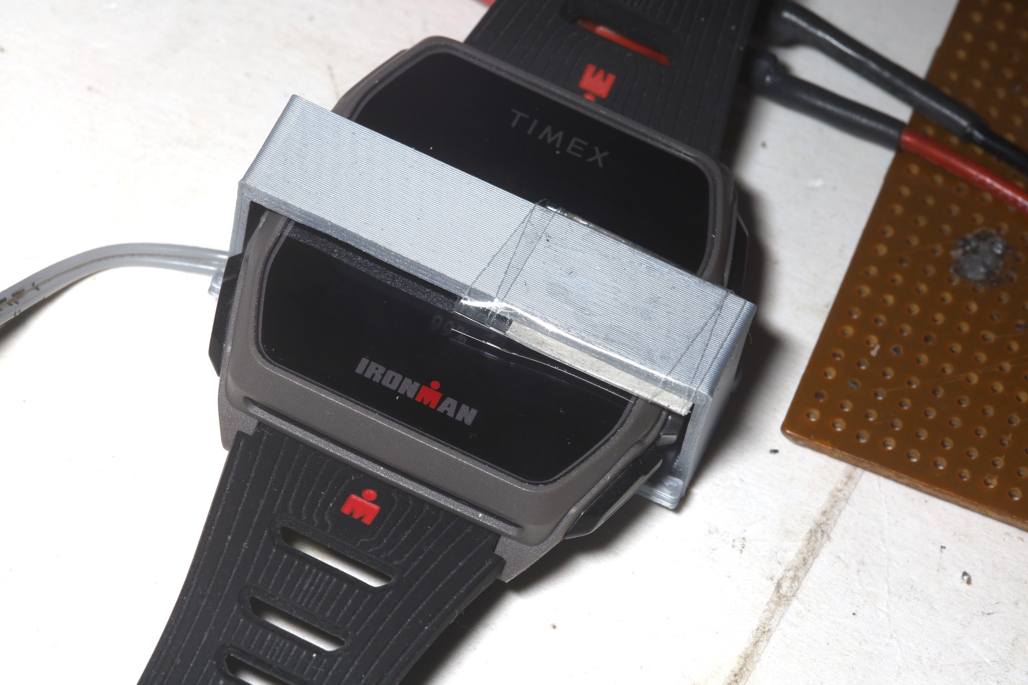

    A few failures with magnets gave way to a side clamp.  The pogo pins couldn't retract enough to get it on the watch.

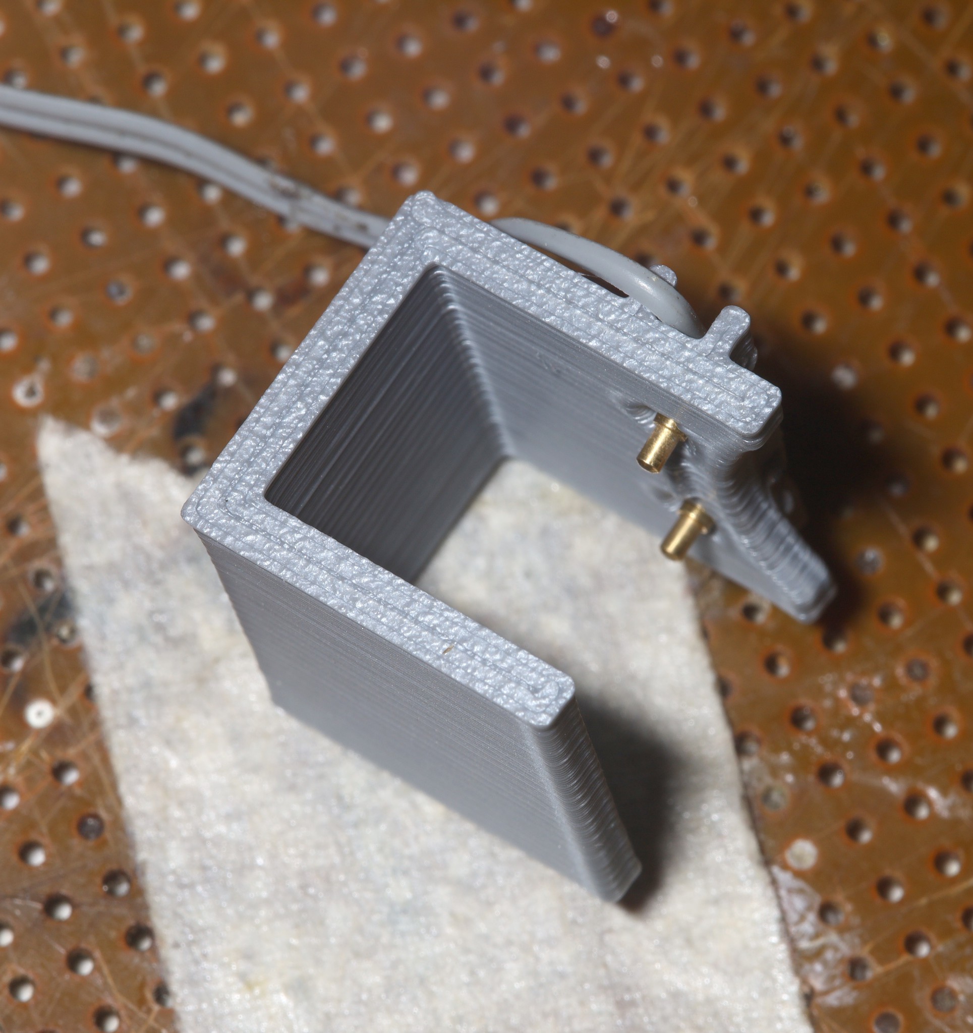

    A full sized charging clamp showed more promise but was hard to align.

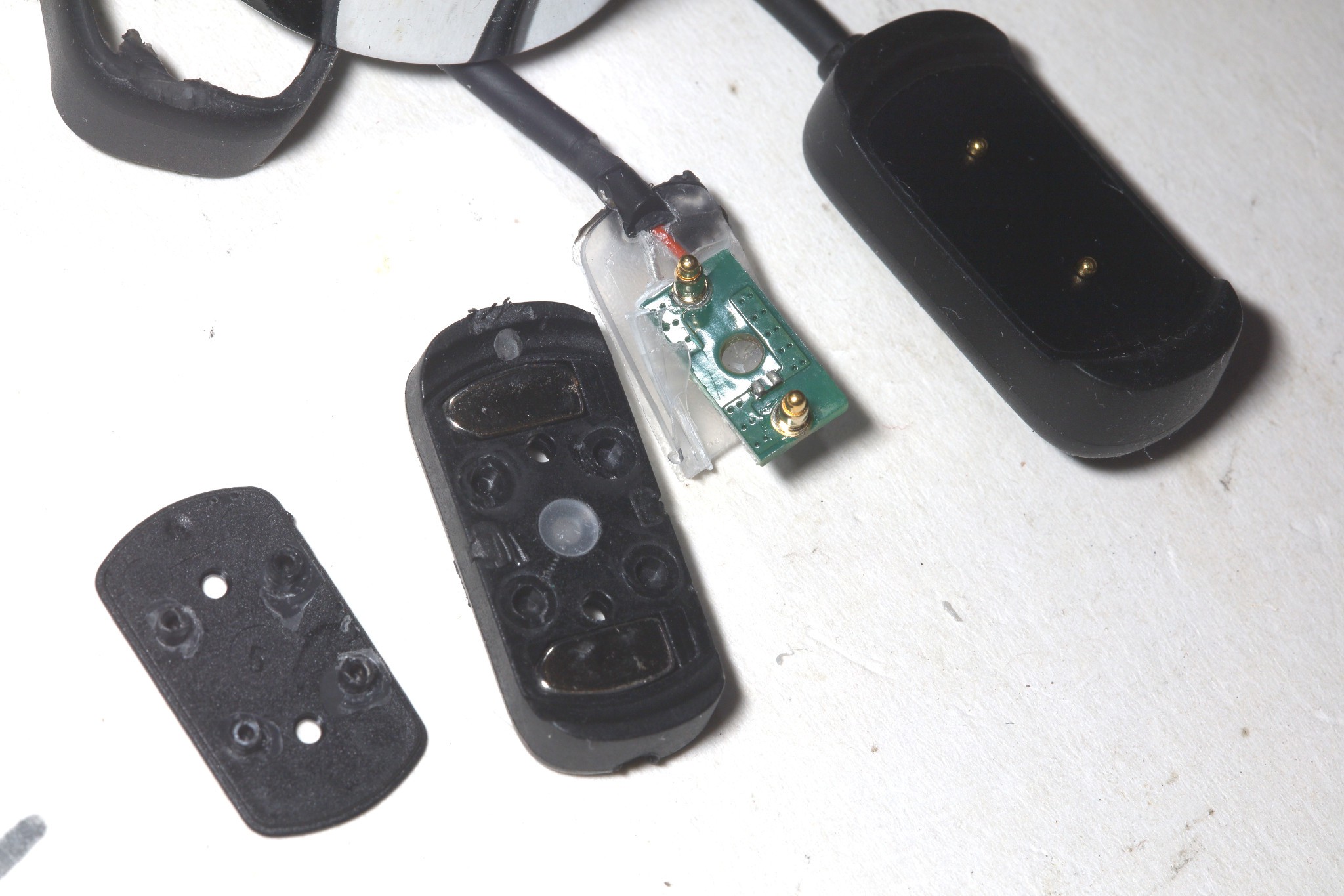

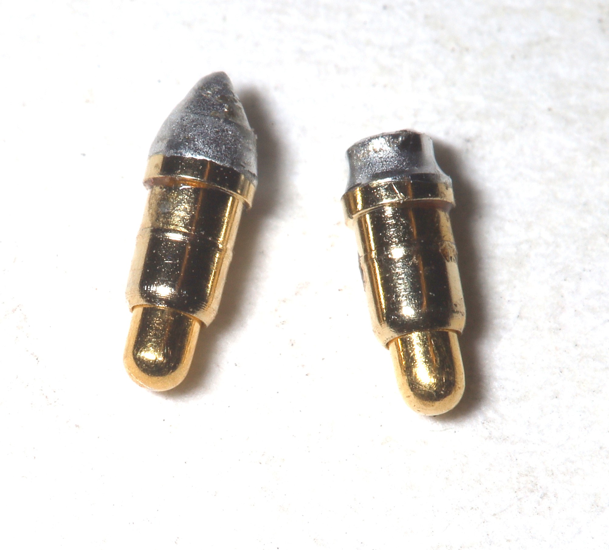

    The incompatible chargers had scavengable pogo pins.
    These pogo pins were solid.  The only time it absolutely wouldn't connect was a USB charger which made 4.5V.  Giving it slightly over 5 seemed to help it.
    Lions wouldn't bother with the magnetic system, even with solid pogo pins.  Only the full clamp is going to guarantee a charge when it's essential, the night before the race.  In what lions managed to get working, it doesn't seem to take any input when it's charging, so there's no need to have the screen exposed.  During other tests, it briefly showed a charging icon in the interactive screen, as if there was another mode where it could take input while charging.

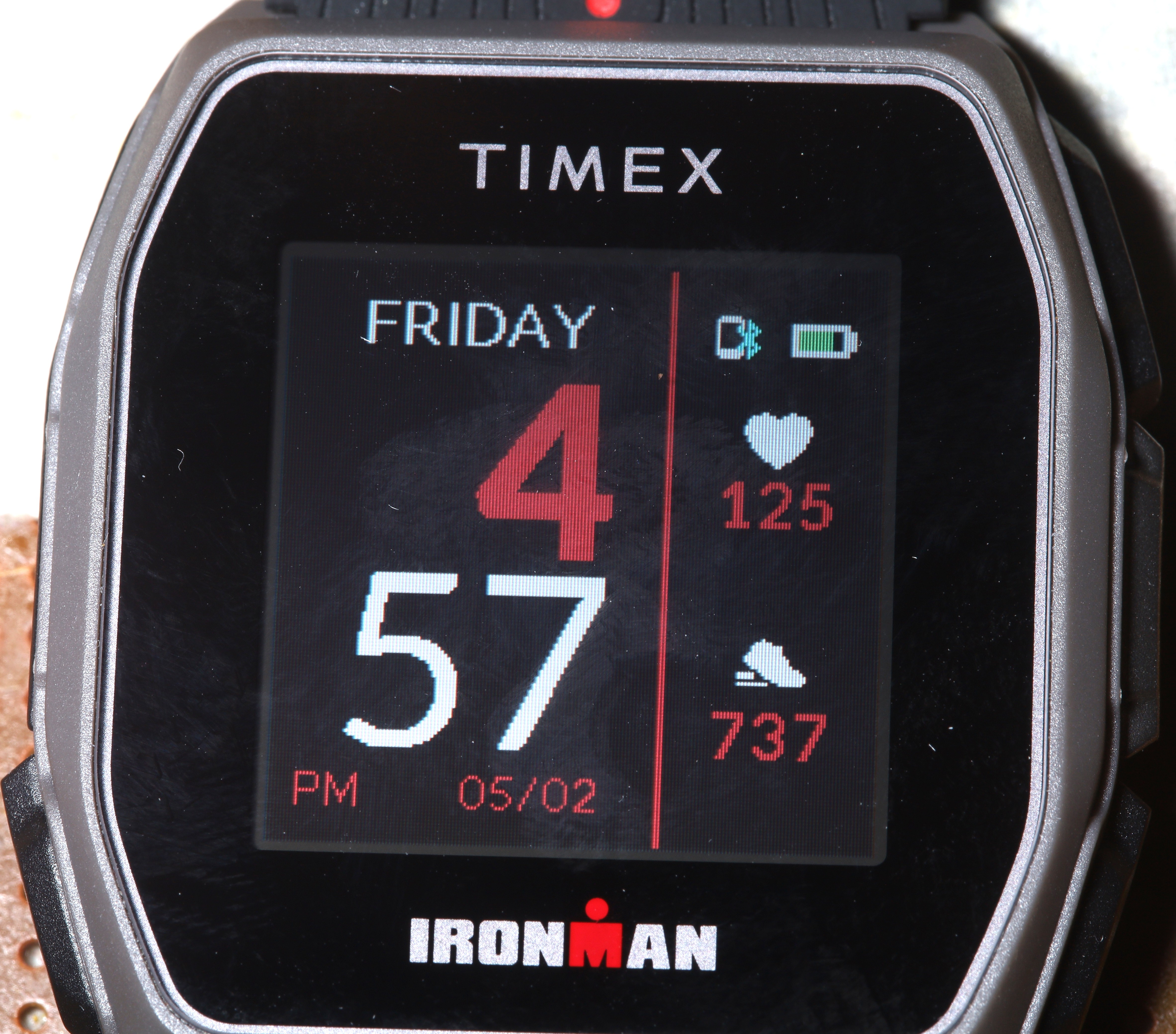

    The screen is surprisingly bright, compared to lion memory of past transflective displays.  The last transflective display a lion saw was a powerbook in 1994.  It was only legible in direct sunlight.
