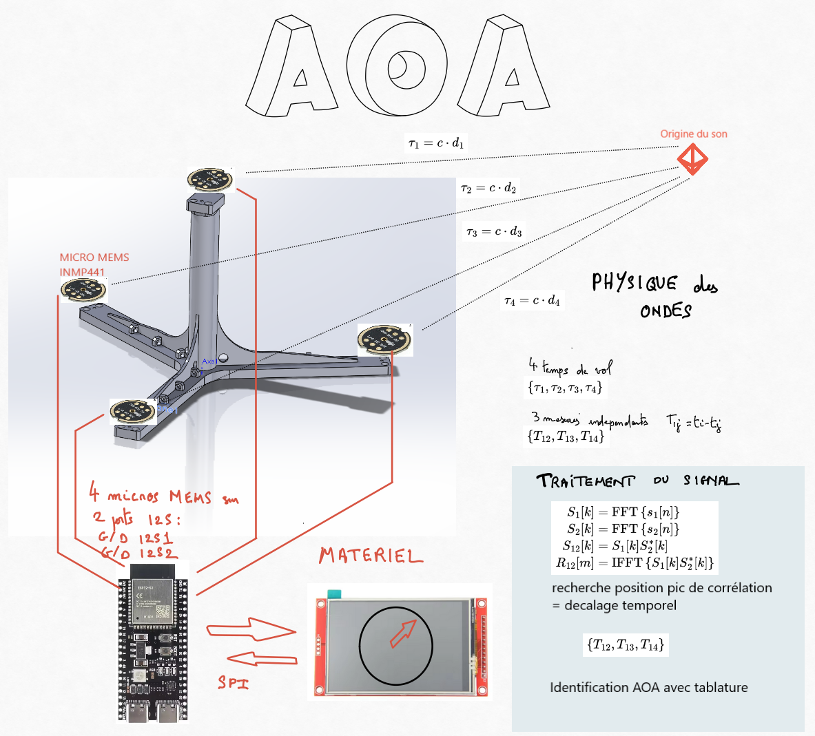

This project showcases a compact system that determines the direction and elevation of a sound source using a Raspberry Pi Pico. Equipped with four analog microphones arranged on a 3D-printed spherical frame, the device captures audio signals to compute the Time Difference of Arrival (TDOA). By applying Fast Fourier Transforms (FFT) and cross-correlation in the frequency domain, it efficiently calculates time delays between microphone pairs. These delays reference a precomputed lookup table to ascertain the sound's origin, which is then displayed on a 3.5-inch touchscreen.

Operational Mechanics
Upon detecting a sufficiently loud sound, the system:
  1. Captures audio signals from all four microphones.
  2. Applies Fast Fourier Transforms (FFT) to convert time-domain signals into the frequency domain.
  3. Computes cross-correlations between microphone pairs in the frequency domain using the formula:
    R(τ) = INV_F{F{x(t)} · F{y(t)}*}
    where F denotes the Fourier Transform, INV_F its inverse, and * indicates the complex conjugate.
  4. Identifies time delays by locating the maxima in the cross-correlation functions.
  5. Determines the sound source's direction by referencing a precomputed lookup table based on these delays.
  6. Displays the result on the touchscreen, indicating the direction with a graphical pointer.
This method offers computational efficiency with a complexity of O(n log n), suitable for real-time processing on resource-constrained hardware.

Indeed, if you only need detection in the horizontal plane, you can limit yourself to just three microphones. With three microphones, you get two time-difference-of-arrival (TDOA) measurements, which gives you two parameters. That is sufficient to solve for the two spatial coordinates (x and y).
Using an FFT is not mandatory. The processing here is quite straightforward (it was a first try) : I use the full signal bandwidth. A time-domain correlation would work in the same way. I chose to use the FFT to compute the correlation in order to speed up the computation (Pi Pico is slow). Working in the frequency domain reduces the computational complexity.
The detection range mainly depends on the microphone’s signal-to-noise ratio. As long as the three microphones can clearly hear the sound, the system will work. I would say a few meters in practice.
