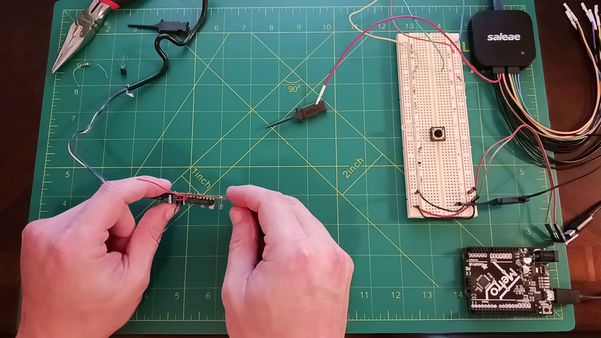

So if you want to repurpose a light gun, do you have to exactly mimic a CRT TV? That’s what I wanted to find out, so I built this test rig:
For reference, here is the pinout of the Zapper’s connector:
Both the trigger and hit lines need pull-up resistors. The trigger is super simple — pull it and it grounds the signal. It is completely independent of light sensing even though a lot of explanations out there link them. That is definitely not the case.

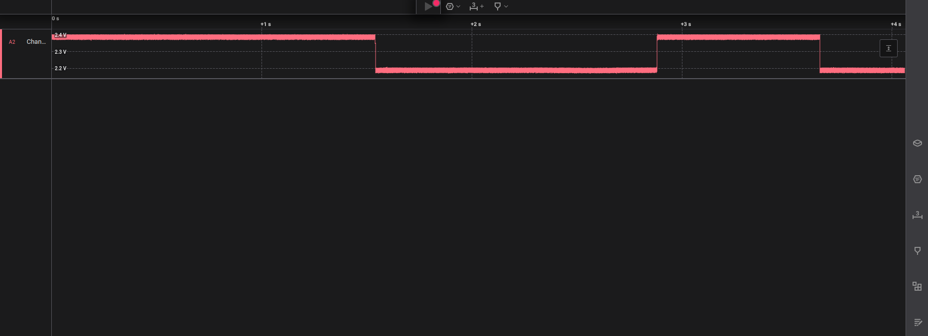

To find out what exactly the light sensor responds to, I have a white LED being rapidly switched on and off at varying frequencies by an Arduino clone. That light shines right at the photodiode inside the Zapper.
I have it flashing the light at frequencies above and below the expected 15.7 kilohertz triggering frequency. I am monitoring the LED switching frequency and the response of the hit signal with a logic analyzer. Here is a signal trace (there is more detail in the video, or see here):
The bottom trace is the hit signal, and when it goes high, it is registering a hit. What I found is that it transitions to high when the frequency is between about 20kHz and 13.5kHz, so there is some wiggle room in there.

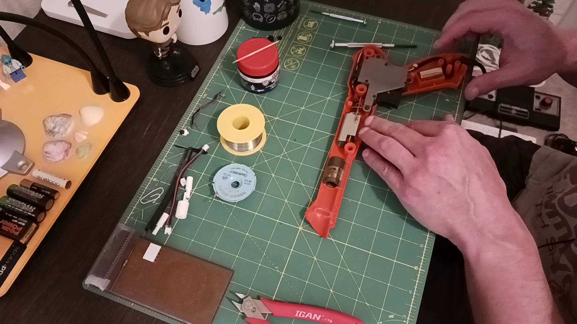

The Hardware Teardown
I completely disassembled the Zapper (see the video).
After examining the hardware, I made this schematic:
The key component is the Sharp IR3T07A:
This chip clearly determines what frequencies of light the Zapper responds to, but unfortunately, it is completely undocumented. There is no datasheet, and it seems no one outside of Nintendo in the 1980s knows how it works. Possibly the values of the capacitors and resistors would modify the frequency range, but I don't know that. I don't want to fry a 40 year old chip that is long out of production, so I don't really want to try either.
