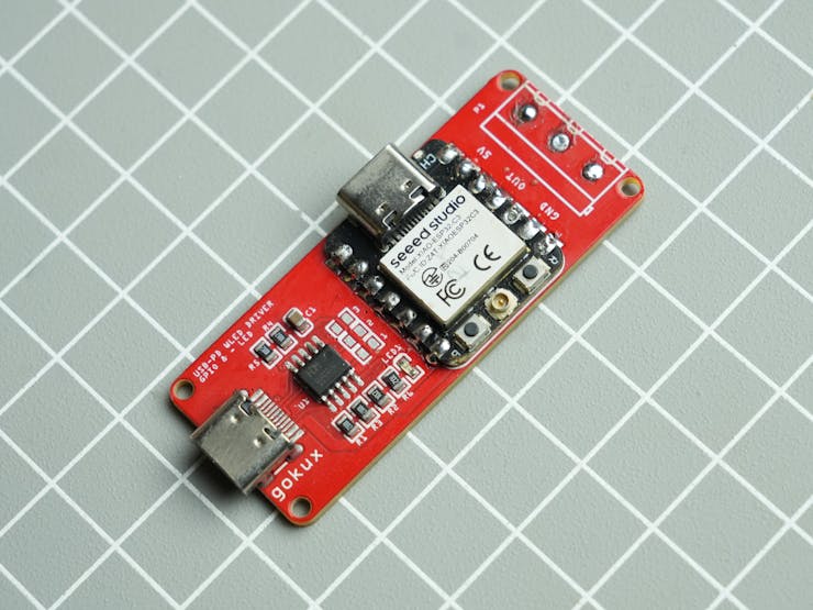

Step 1:PCB design and manufacturing
I designed this PCB according to the schematics given above using Easyeda and exported it to a Gerber file for fabrication
I used SeeedStudio Fusion PCB Service, which offers comprehensive PCB manufacturing, prototype PCB assembly, and more. Their services cover everything from PCB fabrication, parts sourcing, and assembly, to testing, ensuring top-notch quality throughout the process. Furthermore, once you've gauged market interest and validated your prototype, the Seeed Co-create Program can assist you in bringing your product to market with expert guidance and a well-established network of connections.
Step 2: PCB Assembly
for this project, I sourced all the parts for the USB PD module, I desolder all the components from that module. and solder all the components to the new PCB, in the end, solder both the OLED and wire connector
R1, R3, R4, R5=10K
R2, R6=1K
C1=1uf
Apply solder paste to all SMD pads using a fine nozzle or stencil.
Place components one by one:
  • CH224K
  • Resistors (check their orientation if needed)
  • Capacitor
  • LED (watch the polarity)
  • USB-C female connector
Preheat the mini hot plate
Gently place the PCB on the plate. Watch the solder melt and components self-align.
Carefully lift the board off once the solder paste reflows and allow it to cool.
Solder the XIAO ESP32C3 (either directly or via headers, depending on your PCB design).

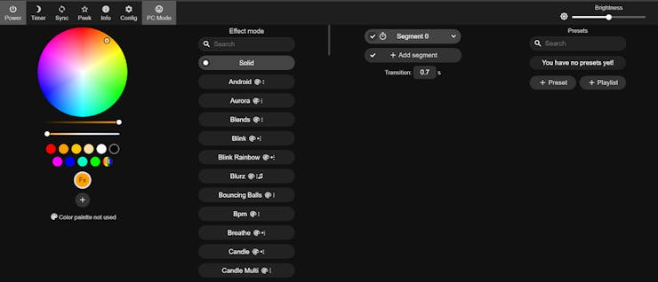

  • Your WLED firmware should boot and broadcast its Wi-Fi hotspot
Also, we are using GPIO 8 as DOUT pin for WS2812b make sure to enter this in LED configuration
