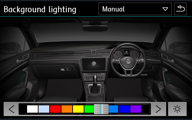

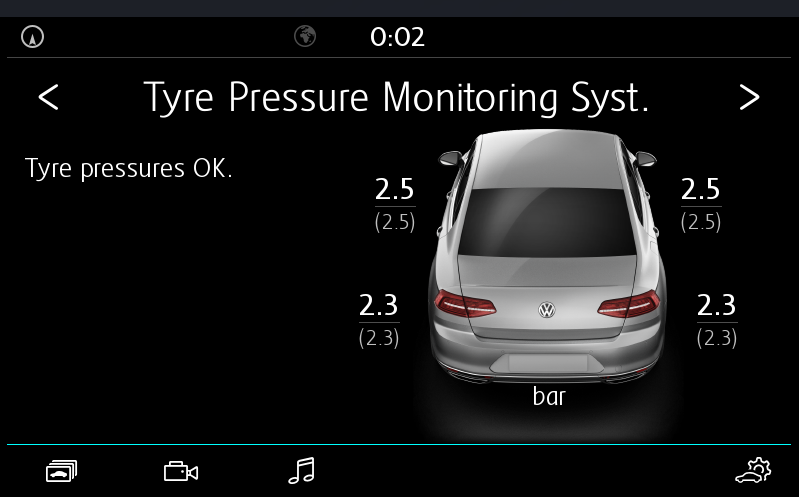

- Unlock MQB menus and advanced features on PQ platform MIB2 units

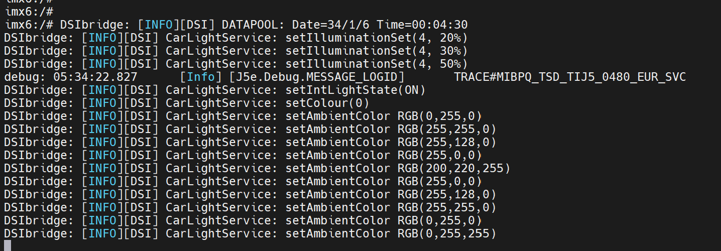

- Interface with the DSI (Device Service Interface) to dynamically update the HMI state from external tools

  • 2026 Huge Progress
    MIG02/02/2026 at 01:10 0 comments
    The DSI IPC protocol has now been fully worked out, and i can emulate menus and have any of the MQB menus work on the PQ units.
    Next steps are confirming the hardware needed to send and receive the missing car states back to the MIB2
