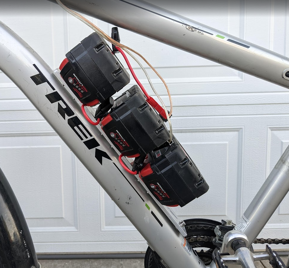

Batteries:

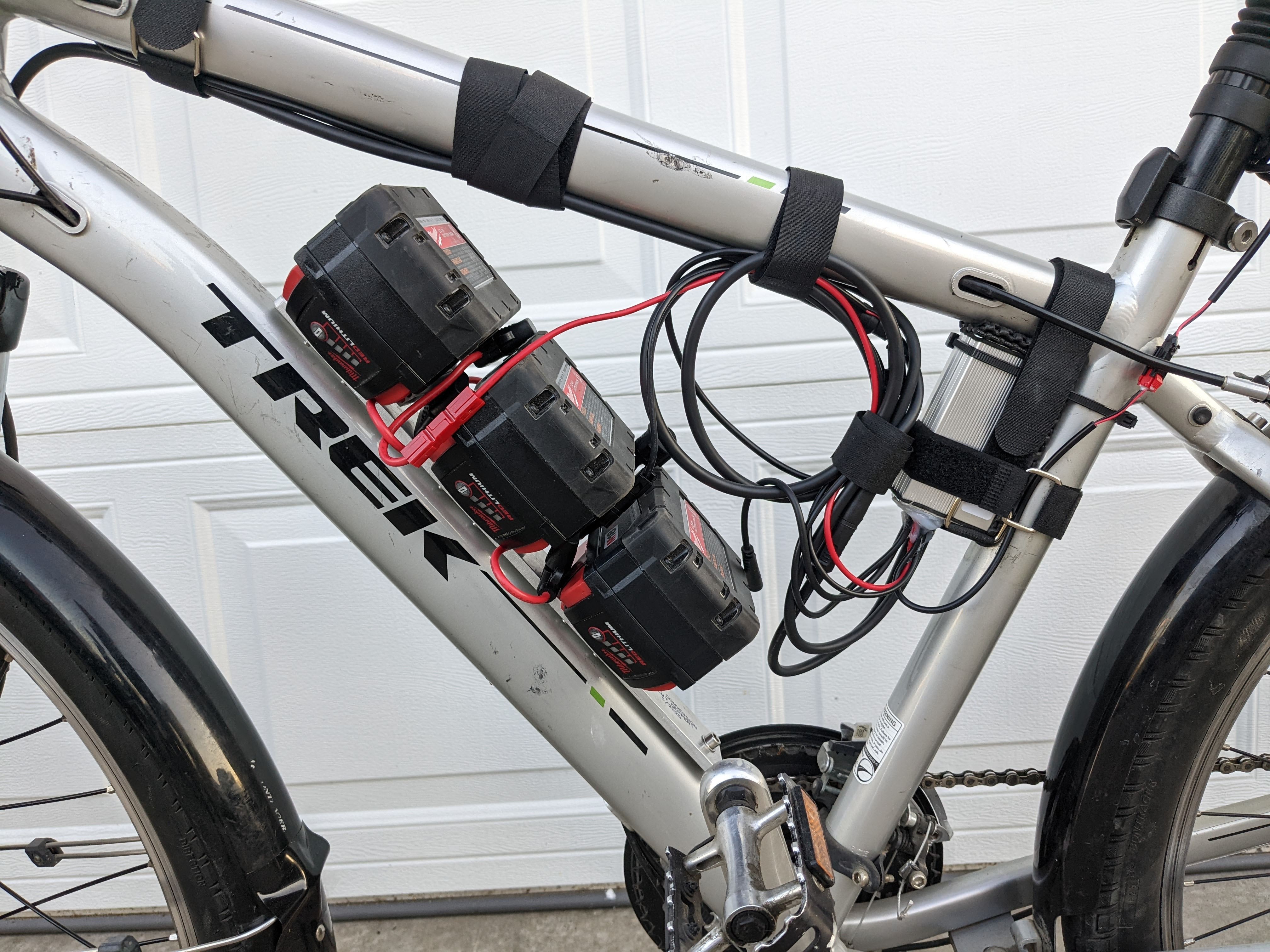

My approach is to use three 5 Ah M18 batteries in series to keep things light and practical based on what I have. There is enough clearance for larger batteries if desired.
Kit Details:
The kit I purchased is a BAFANG 48V 500W front hub motor/controller. I checked with the manufacturer for the maximum input voltage on the controller and learned it is 62.4 vdc. There is a cut-out voltage of 39 vdc. Three M18 batteries fully charged are a little over 20 vdc each with the series total staying under the 62.4 vdc. Perfect! The controller is quite smart as it uses the source voltage to help determine capacity remaining. There are some settings to tell it what battery voltage you are using or just use the source.

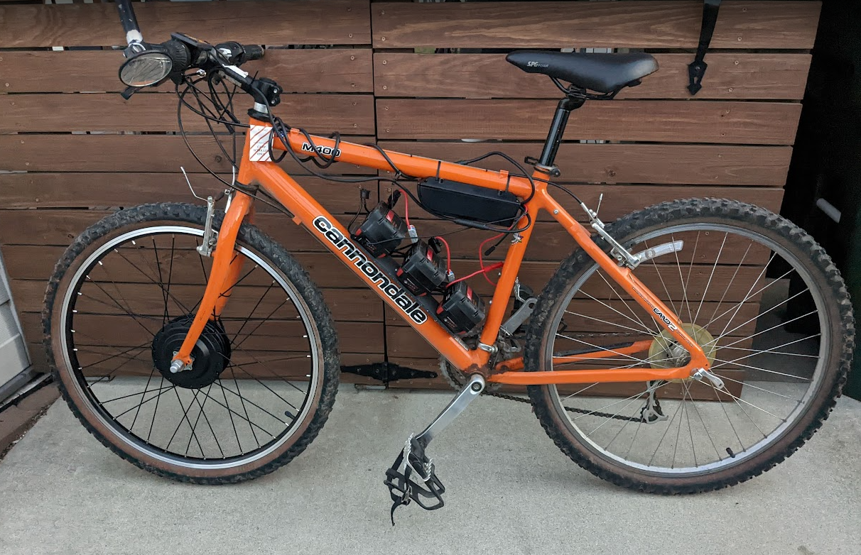

Bike:
I originally hacked this kit onto my 27 year old rigid frame Cannondale mountain bike. It worked great but I am physically not the same person I was 27 years ago in regards to tolerance for discomfort. Ouch. Just ignore the rushed janky mount and wiring situation.

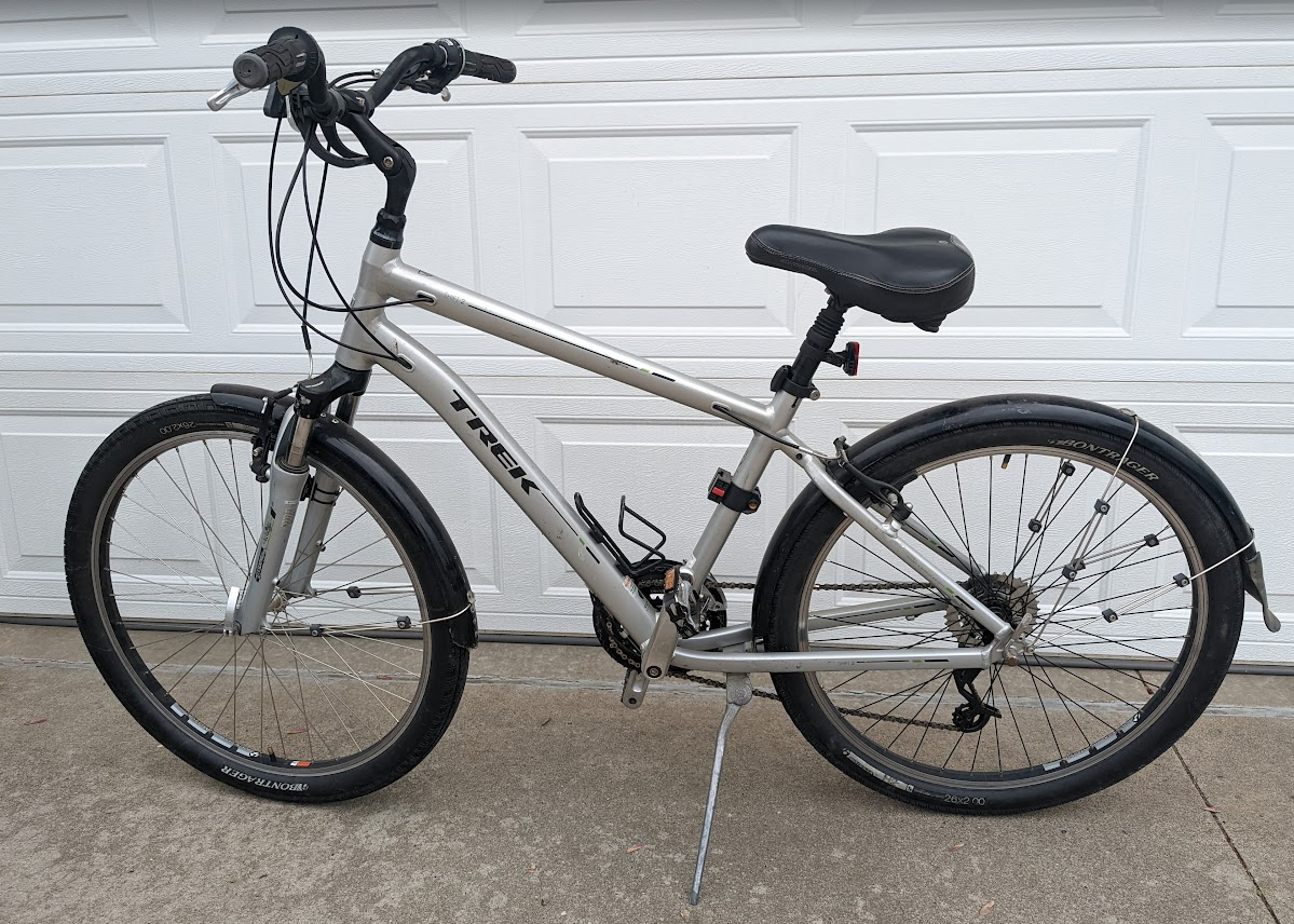

Time to find a different base bike. Marketplace is flooded with really nice older "meat powered" bikes. I picked up this 10 year old donor bike for $180 locally. That might have been a little high but it didn't require me to drive a long ways to get it wasting time and fuel. It checked all the boxes: Upright riding position. Front suspension. Comfy seat with suspension seat post. Fenders and the basket were a bonus.

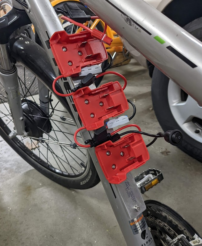

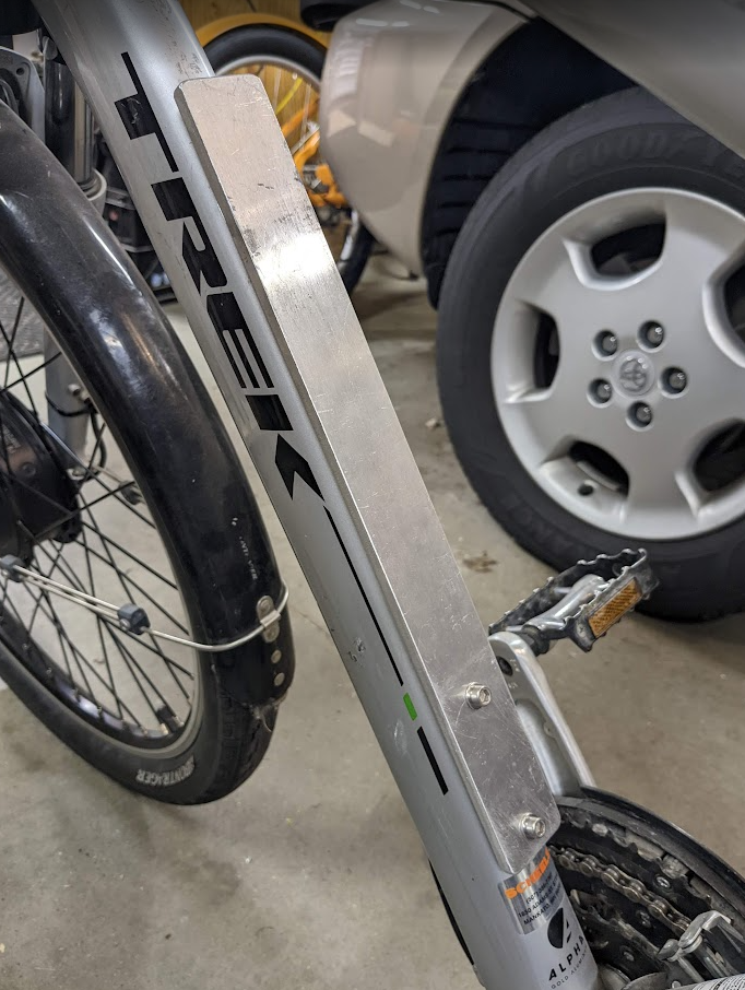

Battery Mounting:
I used a hunk of 1/4" aluminum plate that I had in the scrap pile and drilled holes that let me mount it on the water bottle holder points. I then mounted the battery holders/adapters to the aluminum plate by drilling and tapping them for 8-32 stainless machine screws. There is a piece of foam tape between the aluminum and the bike frame to keep things tight. It's very solid.
Controller and Wires:
This isn't super pretty but it's definitely out of the way and secure. This is probably how it will remain. Function before fashion. It stays out of the way and gets plenty of air for the little heat it produces.

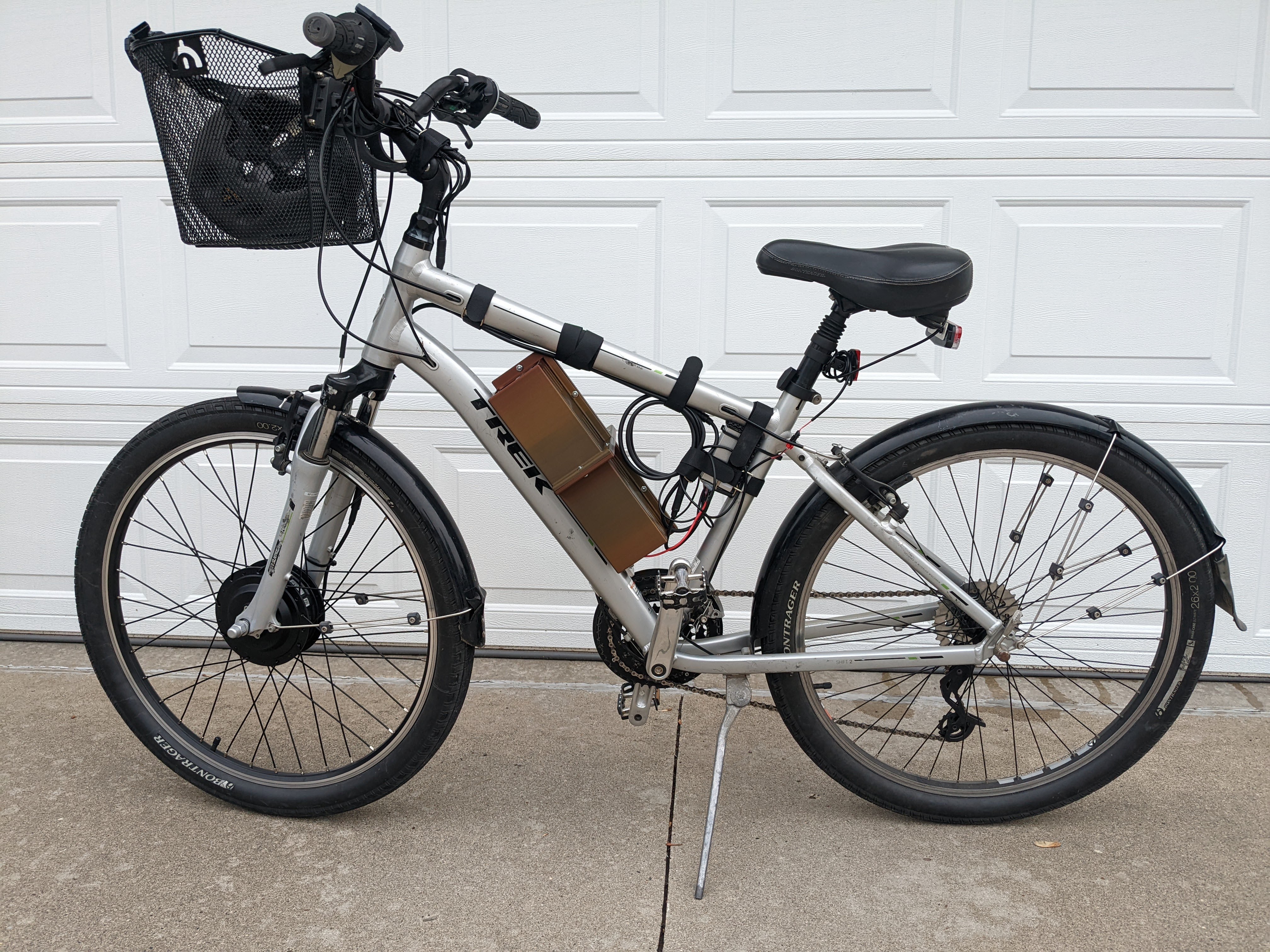

Test Ride:
It works great. It goes 25 mph if you give it full throttle and will spin the front tire if you are not careful. I had originally considering hacking the controller to go faster. Nope. 25 mph is plenty fast on a bicycle. Plus, I think there are some laws on e-bikes some cities are putting in place. I need to install the pedal assist sensor yet so for now it's just a thumb throttle.
The first cycle of the batteries was me doing lots of aggressive acceleration showing off to and racing the neighbor kids. BTW, they think this middle aged gray hair guy is cool now because of this project. Additionally, I tried out the steepest hill in town multiple times from a dead stop to see what it could do. It eats hills and even accelerates up them. The last part of the test was a 6 mile ride with the family. 50% meat powered bikes and 50% e-bikes. The batteries lasted 10 miles with all that testing and riding.
I estimate that if I actually pedaled some and was easy on the throttle it could easily go double that.
I do have a problem though... If there is a throttle I will use all of it. That isn't great for efficiency.
[Update]: I was able to get 19.5 miles out of a charge by mixing in maybe 25% pedaling and avoiding any huge hills and only a couple full throttle speed runs.

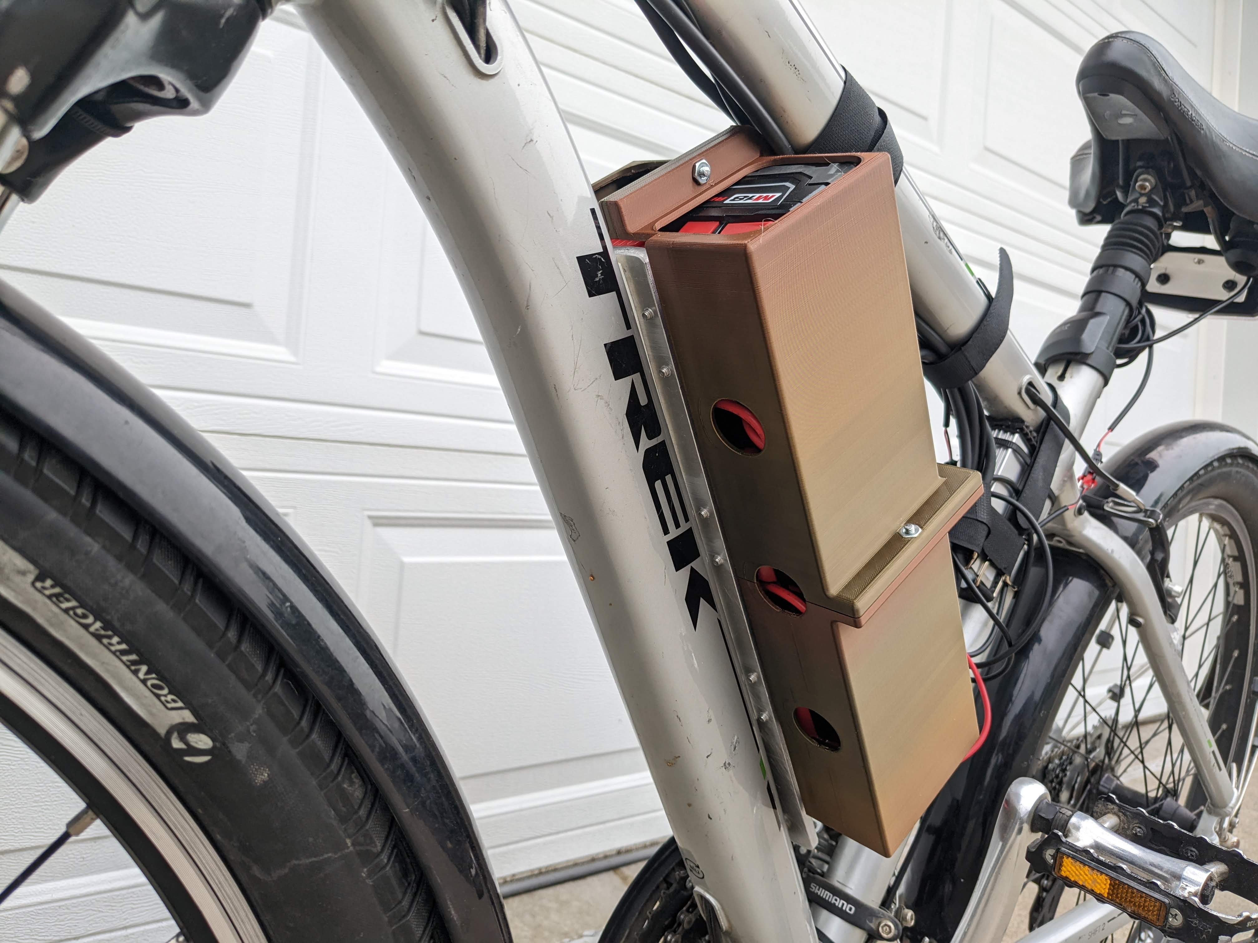

    jeremy.geppert06/19/2025 at 18:40 0 comments
    The battery cover print was intended to be a prototype and likely discarded. However, it fit great on the first try. Rather then reprint in silver filament I painted it with some silver high temp grill paint I had on the shelf. I wanted to stencil something on it to make it feel official. Rather than cutting stencils and painting over it I removed the paint with my fiber laser on low power to reveal the darker plastic underneath. It worked great! A maker friend recommended clear coating the whole thing which I did. This will help with durability.
    The whole thing is looking "less" janky now. Some sort of enclosure for the wires and controller might be next.

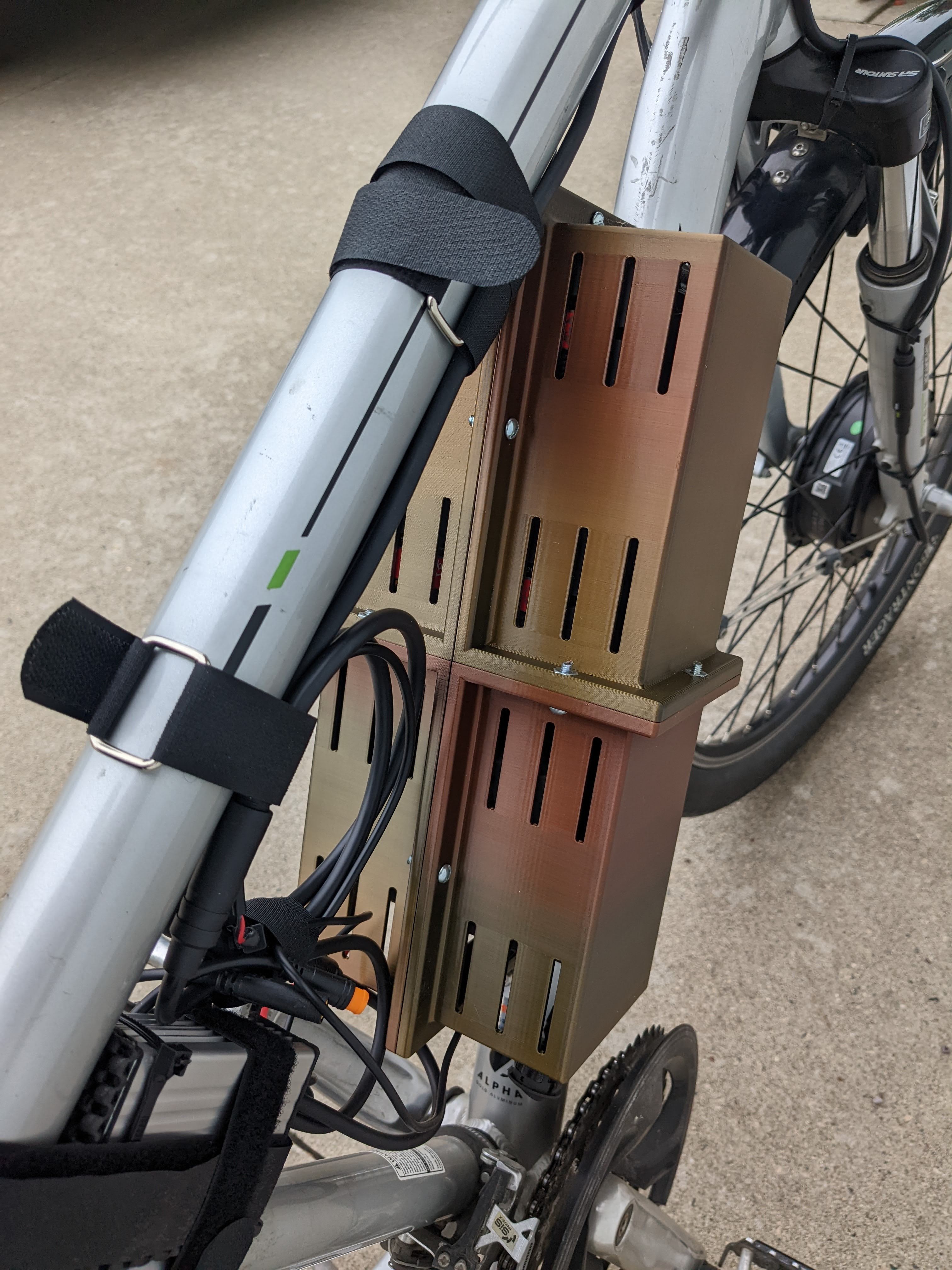

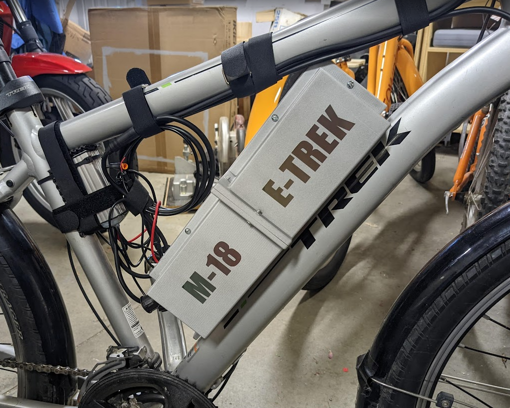

  • Battery "Security"
    jeremy.geppert06/04/2025 at 18:09 0 comments
    The downside of my battery solution is they are quite easy to steal. Real e-bike batteries seem to have locking mechanisms.
    My approach to address this is "security by obscurity". I designed and 3D printed a battery enclosure that encapsulates the batteries to make it less obvious what is there. It requires a screw driver and some time to get around or some bashing to free the batteries. My hope is that in the rare short instances the bike is left unattended and locked up this will be enough.
    The enclosure is ventilated to keep the batteries cooler. Next is to design and print a mesh style end cap for the enclosure so you can't see the batteries from the top side. It was left open for wires to exit on the backside and to shorten the print time requiring less support.
