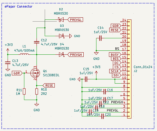

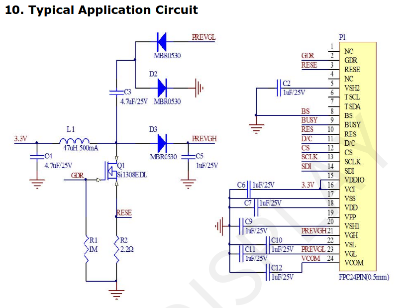

The module supports four distinct display colors (black, white, red, and yellow), allowing for eye-catching visuals even in low-power applications. For electrical connections and proper integration, a recommended circuit is provided in the manufacturer’s datasheet.

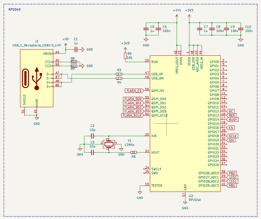

The main controller is a RP2040. The program is sent to the microcontroller using an USB-C, in which only the USB2.0 pins are used.
To function properly, the RP2040 requires a 12 MHz external crystal oscillator for its system clock, along with several decoupling capacitors to ensure stable power delivery.

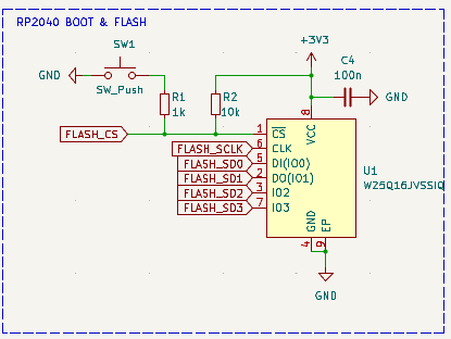

For program storage, the RP2040 relies on an external flash memory connected via a QSPI interface. In this design, we’ve used the W25Q16, a 16 Mbit (2 MB) flash chip that offers fast and reliable access to firmware and data.
The board includes a BOOT button, which is used to place the RP2040 into USB bootloader mode—allowing you to easily upload new firmware.
Power is supplied via the 5 V line from the USB port. A low-dropout (LDO) voltage regulator then steps this down to 3.3 V, which powers the microcontroller and all other onboard components.
Finally, the display is connected to the board using a flat-cable connector. The circuit used is provided by the vendor.

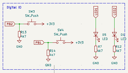

In addition, 2 push buttons and 2 leds are added to the board.
