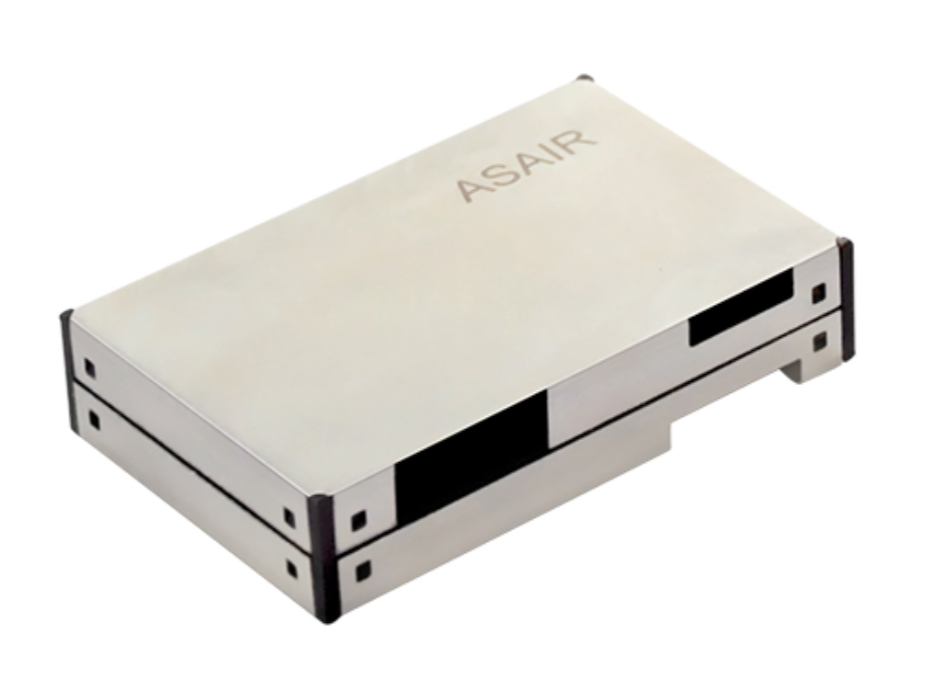

The particle sensor, in addition to PM2.5 data, also measures PM1, PM10 and calculates PM2.5 Index. The project is based on the ASAIR APM10 sensor.

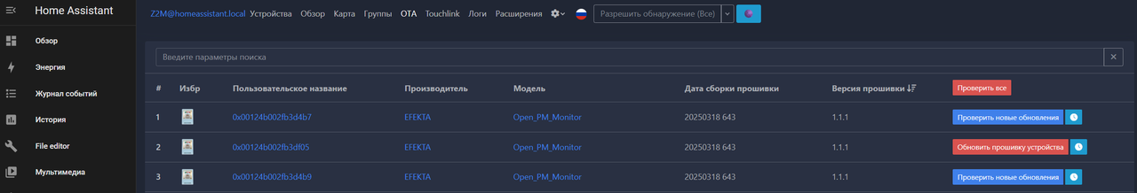

OTA
The sensor can be updated with new firmware versions over the air (OTA).
https://github.com/koptserg/OTAClient )

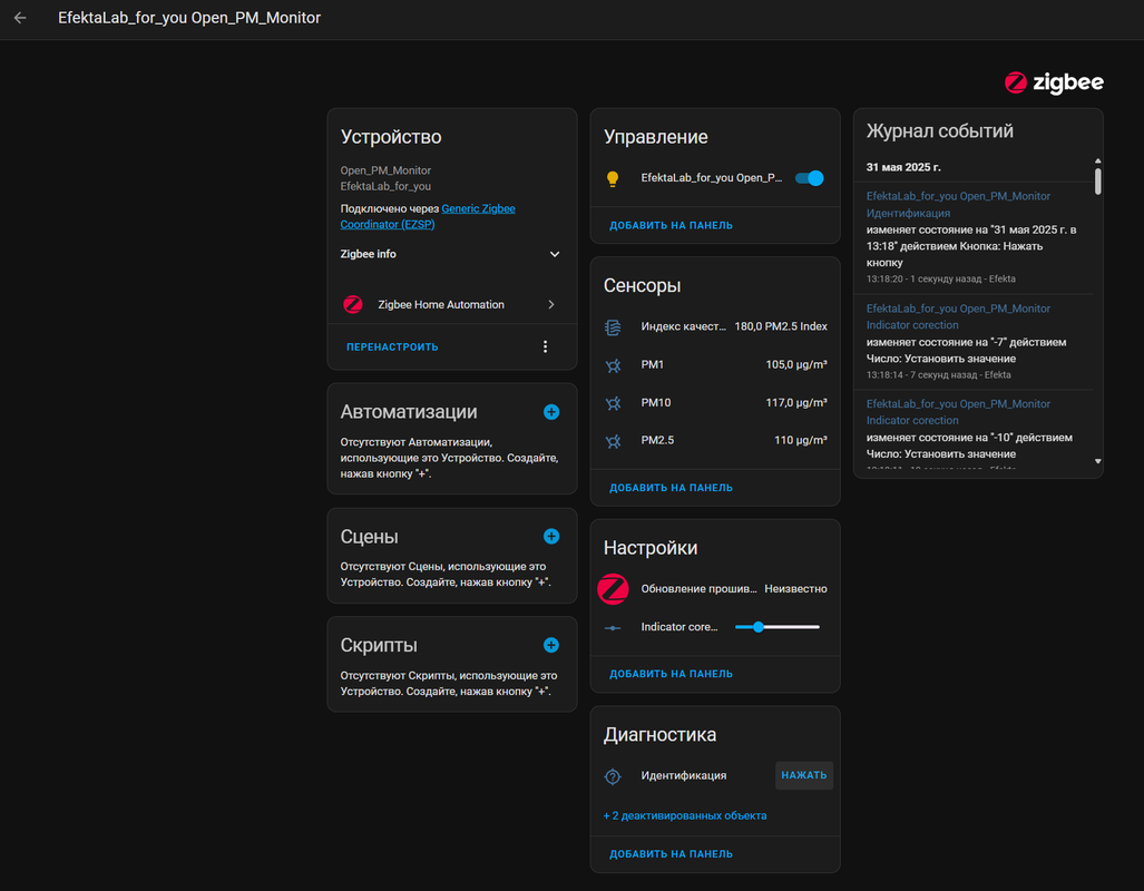

    EFEKTA Open PM Monitor

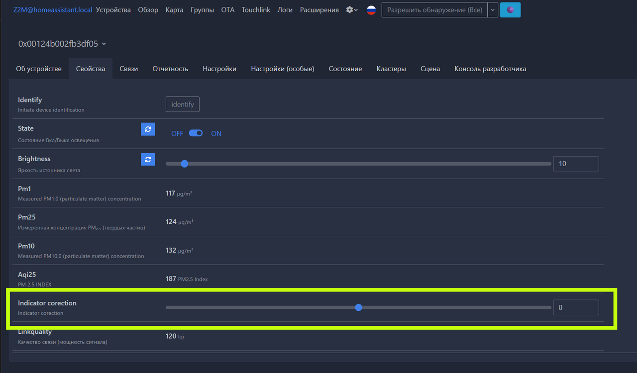

Configuration data:
  • Indicator correction - adjustment of the arrow indicator

If you do not see all the values of the configuration attributes on the "Properties" tab (empty fields, switches in an undefined state) or there are no filled lines on the "Reports" tab about the PM data types, etc., then most likely the configuration that immediately follows the interview was not completed.
To repeat the configuration, go to the main page of z2m, find the sensor line and click on the "Reconfiguration" button on the right (yellow button), then press the joystick button on the side several times - this will cause all the main and configuration data to be sent. If the configuration is successful, a pop-up message about the successful reconfiguration should appear in the z2m interface. In the sensor section, on the "Properties" tab, the values and settings of all configuration properties should appear, and on the "Reports" page, lines with the configuration settings of reports should appear.
