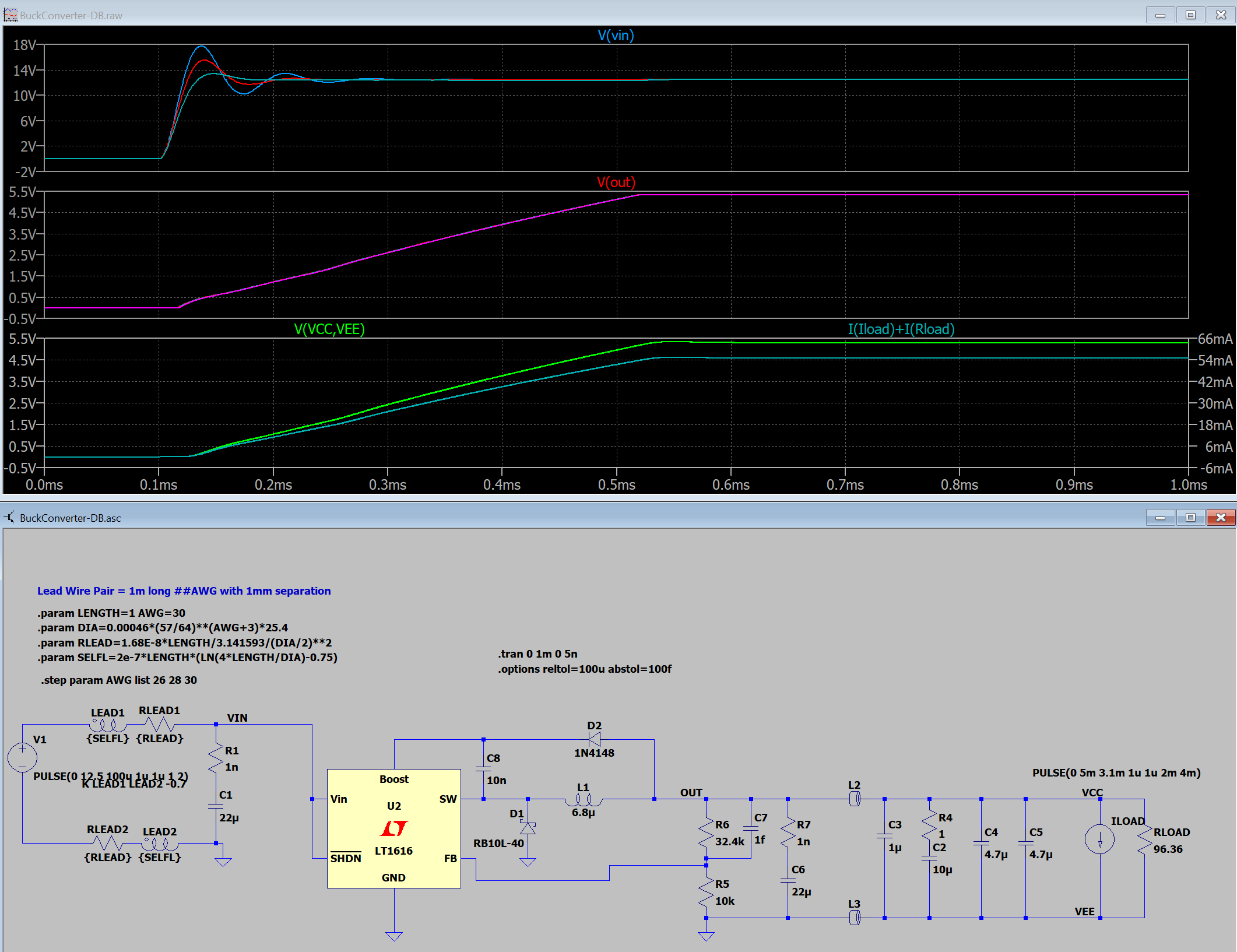

Mutual Inductance Effects on the Buck Converter Daughter Board Design:
After all of that prior discussion, I won't bore with the details here. The problem I have is that I was not able to simulate the buck converter (off-brand manufacturer with limited modeling resources) and released the design without adding any discrete snubber resistors.
I fudged a simulation by using a similar switching converter IC model that ADI had a model for: the LT1616. As expected, the buck converter did not like the inductance of the input leads either. But it appears that the snubber resistors might not be necessary. The only way to tell is to build it and test it.
I put the lead inductance model in series with the buck converter input and checked in over various simulation parameters. There is one interesting phenomenon that show up: if you connect a powered adapter to the daughter board there's a chance that you can damage the daughter board. Here's one case where having cheap 30AWG leads from the adapter can save you. I ran a simulation of this event using 26-30AWG lead wires. Here is the result (without a snubber at the input):
The smaller AWG wire doesn't produce as large of input spike because the higher wire resistance de-Qs the L-C tuned circuit at the input. The way to avoid this scenario is to solder the adapter lead wires to the daughter board -- the rising voltage waveform will be much slower. Otherwise, even a 0.5 Ohm snubber resistor in series with C1 will do the job.
