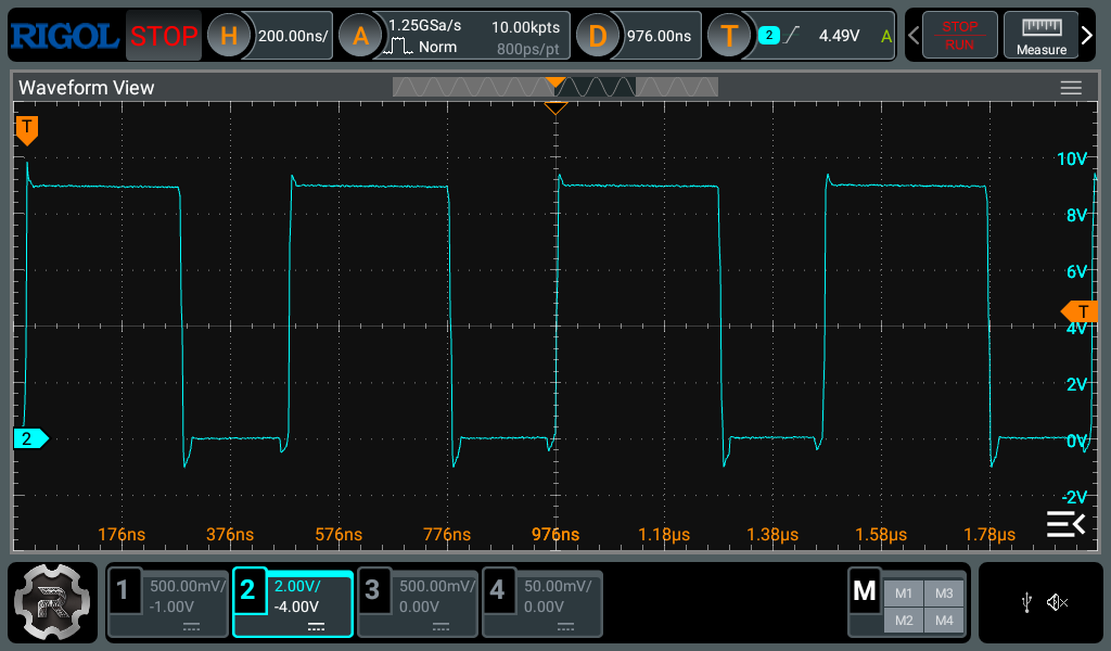

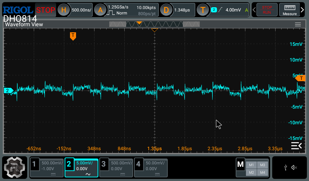

The NEX40400B:
This switcher is forced PWM -- that's what the "B" stands for. I didn't think there would be any good reason to have the converter change modes for improved efficiency give that the probe pretty much consumes a constant load current. Used a Sunlord SPH2016 10uH inductor. Under the active load the converter had pretty poor load regulation, dropping from 5.34VDC with no load to less than 5.3VDC with a 70mA load current. It's line regulation was excellent -- less than 2mV change from 7V to 12V applied input voltage. I took scope traces of the switching node and the output ripple voltage. Both were excellent.

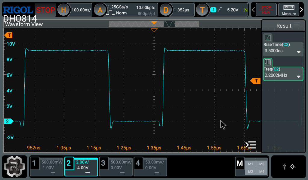

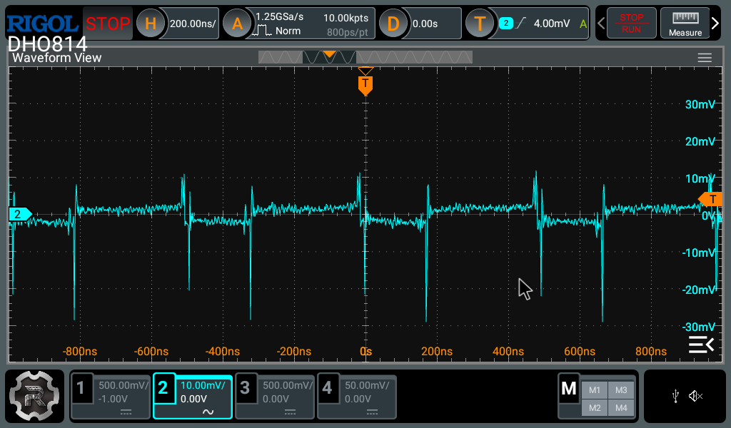

The AP64060Q:
I used a different inductor -- Suntech SLW2016 10uH. This converter IC can change its UVLO voltage using a single resistor connected to its EN input. A 2.2Meg resistor sets the UVLO above 6V -- and it works. The line and load responses were both excellent -- less than 2mV change over expected line and load variations. Here's what the switch node and output ripple voltage look like:
The switch node looks very good, but there's quite a bit more spike transients at the output than the NEX40400B.
