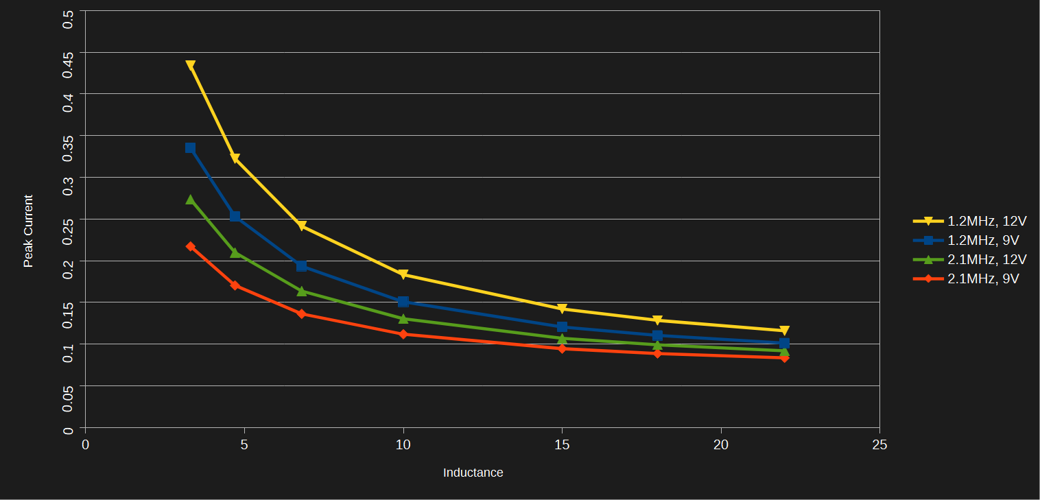

The buck converter datasheet will give a recommendation that inductor ripple current be about 30-40% of the max load current, which is ridiculously small in our case and would call for a very large (>100uH) inductor; or the datasheet will specify ripple current be 30-40% of the max switch current which will work but make the ripple current unreasonably large.
The peak inductor current is given by this equation:
Which yields curves like this for Vout = 5.3V:
Remember to account for the tolerance of the inductor, usually +/- 20%. Avoid small inductors for two reasons -- the larger peak currents will require a larger switch current rating and also cause higher power dissipation in the switches (or switch+diode), input/output capacitors and inductor. You should avoid large inductor values because they will saturate at lower currents and have larger parasitic series resistance which causes power loss. For me, the sweet spot is an inductor value between 10uH and 22uH. The 10uH inductor is a more common value and has better availability. I will also set the USB-C trigger board to output 9VDC.
So now I'm selecting a 2MHz converter and a 10uH shielded inductor with a saturation current above 200mA. The RMS current will be equal to ILoad + Iripple/( 2 * sqrt(3)) = 89mA. The inductor should have a heating related current significantly above this. It's not difficult to find an inductor to meet these specs.
