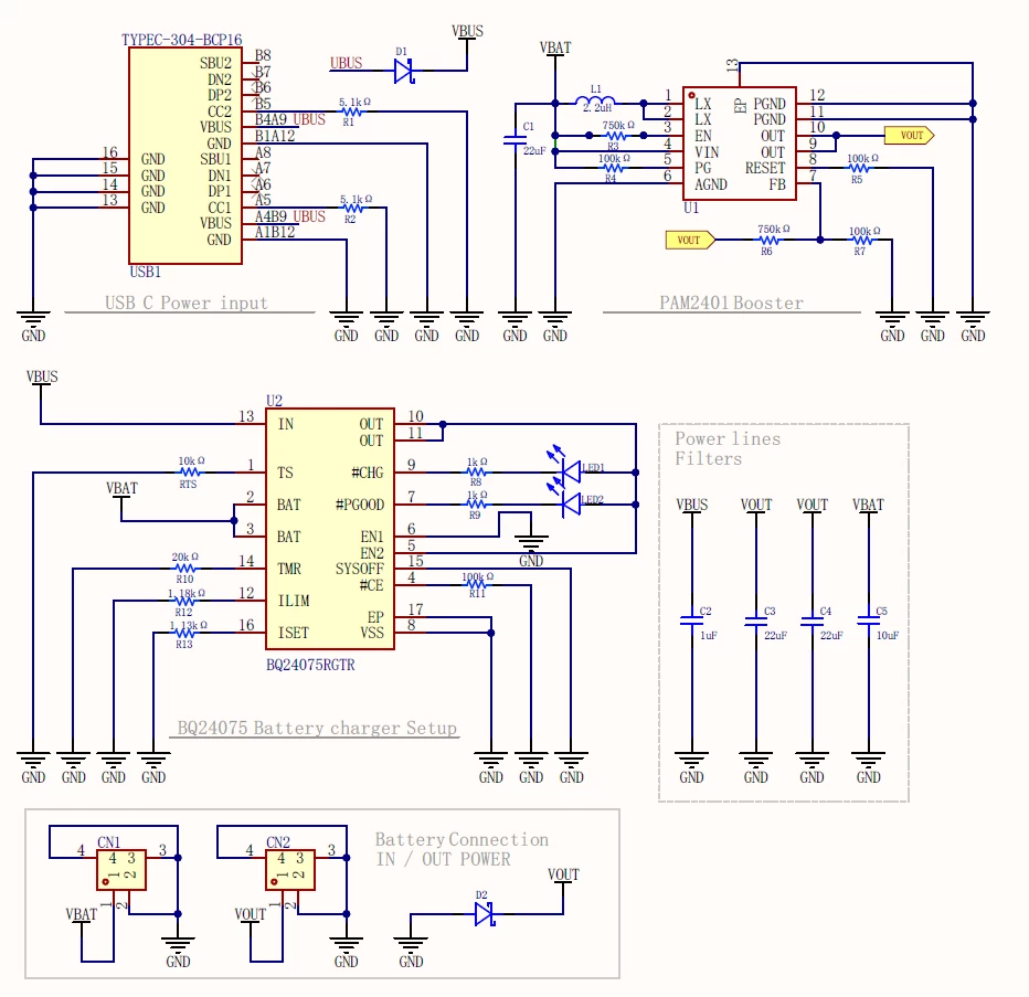

The Two Key ICs
BQ24075 Charger IC
Why? Handles all lithium battery charging logic
Key Feature: Built-in thermal regulation (no cooked batteries!)
Setup: Identical to my previous project (USB-C in, 500mA default)
PAM2401 Boost Converter
Why? Converts low battery voltage 0.9V–4.2V battery voltage to a stable 5V/500mA output
Key Specs: 1MHz switching, needs 2.2µH inductor (I used a 2A-rated one)
Gotcha: LX pin requires careful PCB routing
Schematic Tips
- Isolate power paths! My mistake: Accidentally connecting charger/booster outputs (more in Step 4).
- Add reverse protection (Schottky diode on USB input).

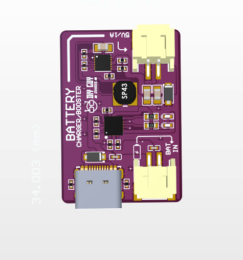

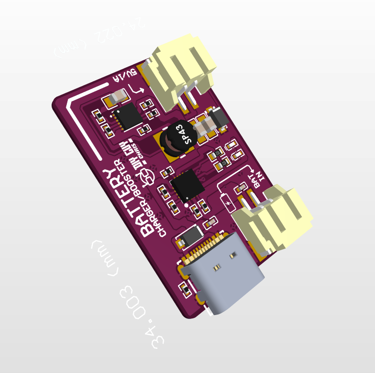

Critical Design Choices
- Size: 24mm × 34mm (fits behind a battery)
- Ground Plane: Full copper pour under power components
- Component Placement:Inductor <5mm from PAM2401 (reduces noise)
- USB-C port on left edge for easy access

Debugging the "Voltage War"
After getting the circuit very well assembled, I moved to do some tests targeting a 5V output voltage from a Lithium 3.7V battery so the needed result should be a boosted stable voltage coming from this circuit:
❌The Problem
- Booster output stuck at 3V instead of 5V
- Inductor overheating
- LX pin showing glitchy pulses (scope capture below)
Symptoms & Fixes
Inductor overheating ---> Output short ---> Check LX pin with scope
3V output (not 5V) ---> Booster disabled ---> Verify EN pin voltage
Erratic LX pulses Feedback ---> loop broken ---> Measure FB pin (0.6V?)
- Root Cause:
- My schematic accidentally connected the charger and booster outputs!
✔️The Fix
- Cut the conflicting trace between ICs.
- Verified clean 5V output afterward.
- Check the output Pulses signal from the booster LX pin to the inductor
I then updated the Design files and fixed the GERBER as well :)
