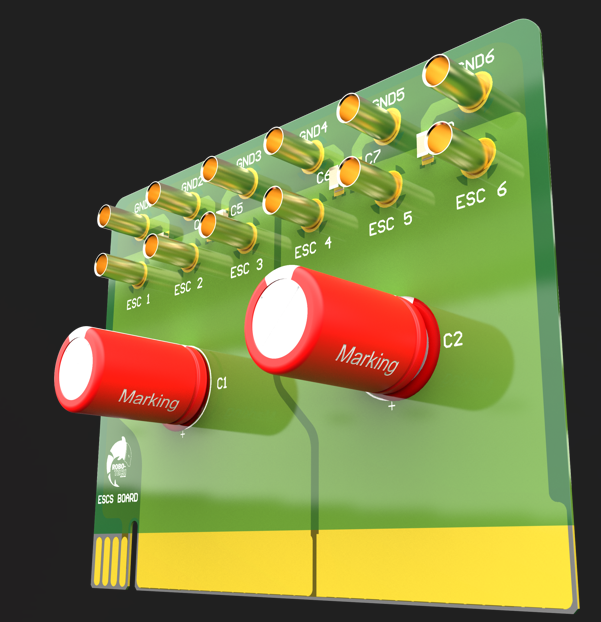

ESC Board Supports 6 ESCs with power delivery via bullet connectors and integrated decoupling capacitors.

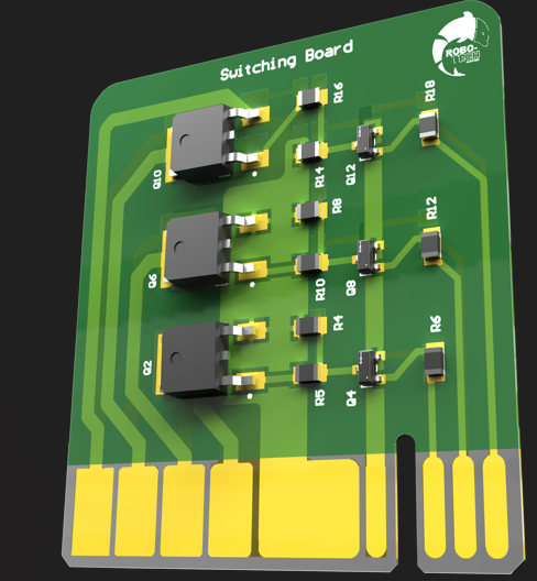

Switching Unit A MOSFET-based, six-channel circuit controls flashes, DC valves, and additional loads. The double-layer PCB with edge connectors ensures easy maintenance.

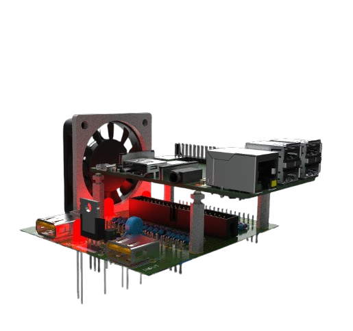

Protection Board Includes a crowbar circuit, GPIO protection with Zener diodes and resistors, status LEDs, and active cooling to safeguard the Raspberry Pi.

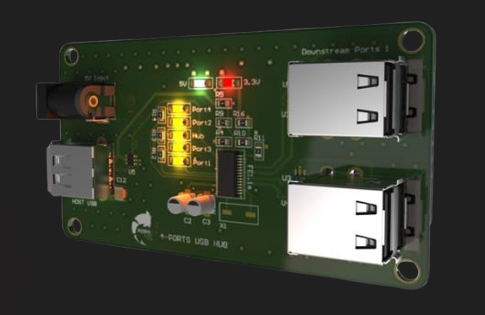

USB Hub Externally powered hub using the FE1.1S controller. Supports four USB 2.0 ports with overcurrent, ESD, and reverse polarity protection. Enables up to 16 cameras to be used safely.
