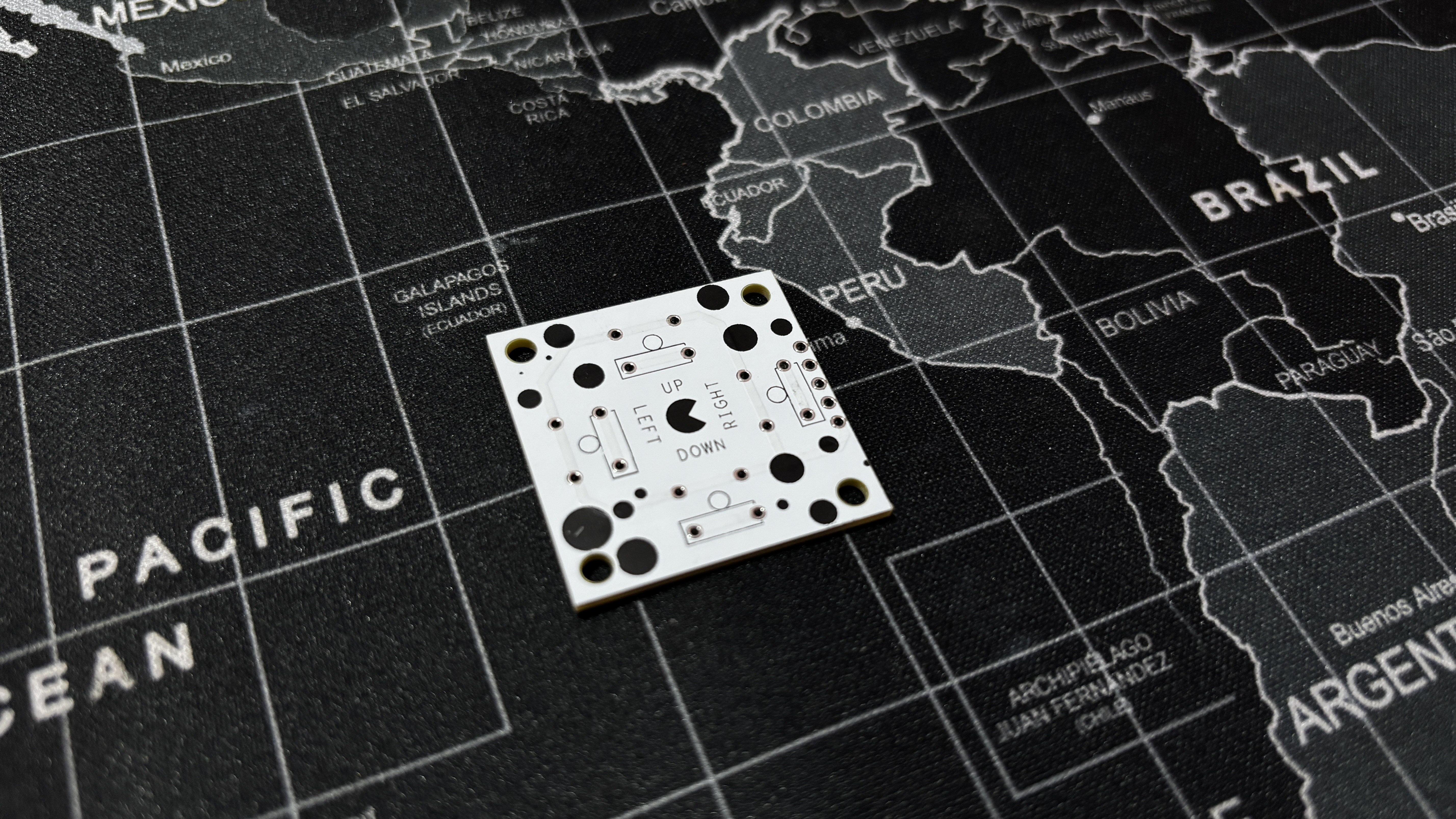

The Switch Board contains four push buttons that are coupled to a CON5 terminal, which will be used to connect the Switch Board to the PICO 2 GPIO Pins.

In this project we are reusing two PCBs from the previous Snake Game Console project that were the Button board and the PICO driver board. Two orders were made: one for the button board and one for the PICO driver board.
The button board PCB was ordered in white solder mask and black silkscreen, while the PICO Driver PCB was ordered in blue solder mask and white silkscreen.
After placing the order, the PCBs were received within a week, and the PCB quality was pretty great.
