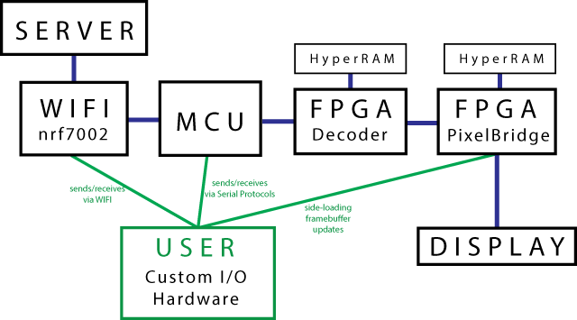

At the core of the current prototype is an STM32H7 microcontroller. It drives a 720×720 RGB666 display and connects over Wi-Fi using the NRF7002 companion chip—fully controlled by the MCU, no separate nRF core involved. The MCU has two cores: one handles networking, the other decoding. In the near future, I will move decoding to a low-power FPGA and networking to a smaller, more lightweight MCU (see Roadmap).
The device receives live GUI frames streamed from a Linux machine running a custom video encoder. The compression within a frame is close to JPEG, but instead of MJPEG I use delta-frame logic based on differences between frames. It’s simple enough for an MCU to decode. While the STM32H7 supports hardware-accelerated JPEG decoding, I’m currently not using it—too cumbersome with my encoder setup, though not impossible.
Bandwidth depends on GUI complexity—ranging from nearly nothing up to ~25 Mbit/s at the target 25 FPS. These numbers lack context, so check the videos on YouTube (and for more context check the Research page).
On the client side, decoding time per frame at 720×720 RGB888 ranges between 40 and 150 ms depending on content. For worst-case testing, I transmit RGB888 compressed data—even though the display is RGB666. Throughout the pipeline, RGB888 is maintained, and the LTDC simply ignores the two LSB bits when reading from framebuffer. I’m planning to support more displays in the future, so it makes more sense to test the worst case for now.
End-to-end latency—from host encoding to display decoding—is low enough for responsive, simple GUI use. The Linux host handles all the heavy lifting. The device just receives rendered frames over the network. It is already usable for some cases, though I’m not fully happy with the result. Check out how I will speed things up more on my Roadmap.
The Linux server runs a software encoder that takes approximately 20 ms per frame on an Intel i7-4820K CPU. It’s currently single-threaded, unoptimized, without SIMD or GPU acceleration. I’m confident I can drastically improve speed.

- Offloading the codec to an FPGA to reduce latency and power (see Roadmap)

This project is not just about a display—it’s a modular system meant to adapt to different embedded environments. The design enables:
- Pixel-level framebuffer sideloading over SPI or parallel buses
- Display bridges via FPGA bitstreams that support different interfaces and panel types
- Optional local rendering for overlays and UI elements, even without network
The idea is that you always have a fallback: the main streaming path ensures a working GUI, even in minimal setups. But over time, you can enrich your system—by sideloading optimized UI blocks, adding local overlays, or routing through custom display bridges. Each layer can be upgraded independently, while the base functionality remains usable throughout.

- Move decoding to a low-power FPGA (<20 ms/frame goal for decoding)
- Refine server program (encoder) and speed further up
- Support for multiple displays and resolutions
- Peer-to-peer networking mode without router
- Optional cellular connectivity for remote use
- Display bridging architecture with pluggable bitstreams
