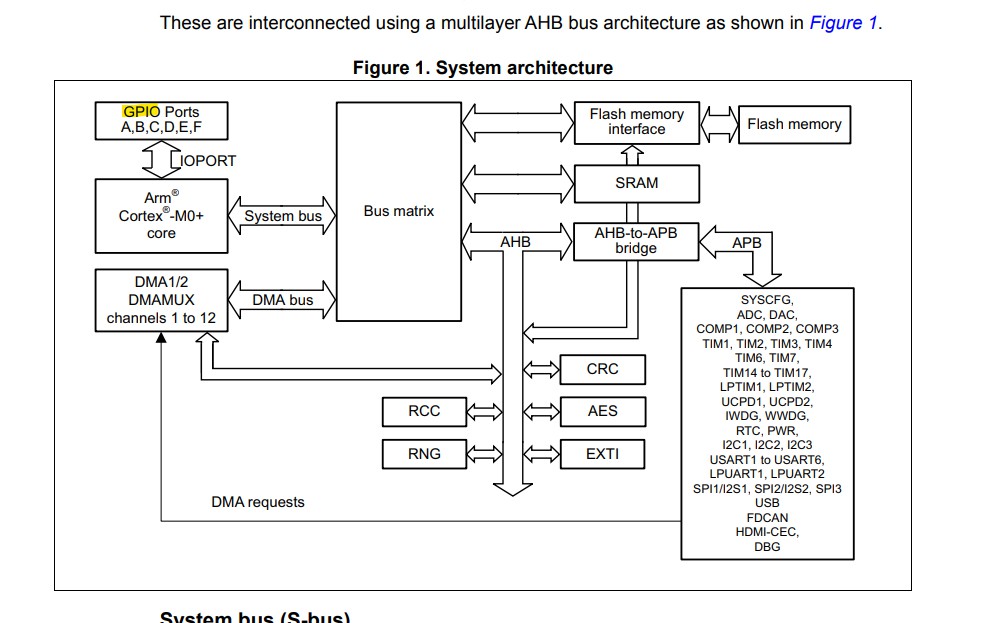

I wanted to use DMA to do the copying from GPIO to SRAM and vice versa. But, as I found out after much frustration, the GPIO on most Cortex-M0+ chips is not accessible via DMA! Unfortunately, the only reference to this is in the system diagram and an error bit getting set when you do a DMA transfer with GPIO.
When instead I tried to do the reading of data myself as suggested, the code that I was writing had to do work *and* have precision timing (it can't drift relative to the timer clock I am providing the camera). It is hard to do this, and IMO requires hand-writing it in assembly to make sure the periodicity in when it reads GPIO is aligned to a multiple of the camera pixel clock. While I could in theory extend the back or front porch timings for a row to allow for the CPU to do "reading" work, then do "algorithm" work, both of the camera chips I was using weren't acting as I was expecting in this regard.
It feels a lot easier to have a system where the concerns are decoupled. DMA is periodically reading from GPIO into a SRAM buffer "A" and is triggered by a timer periodically. If it's delayed a few <internal> clock cycles, no big deal, as long as it starts the process at a periodic time. Meanwhile the CPU is operating on the previous row (SRAM buffer "B") and has no concerns about the periodicity of when exactly it executes reads/writes and I can keep that work in a higher level of abstraction and readability. As long as it completes on time (within the row time), it's good. There's some bus contention issues that I hope won't be a problem, we'll see.
