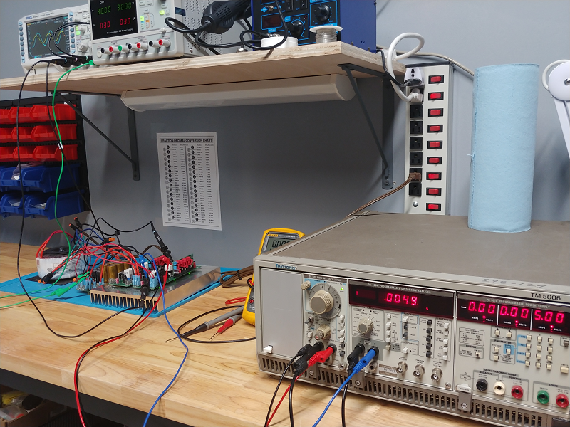

The design proved to be exceptionally quite and stable, and is capable of producing 60W into 8ohm load from 35V power supply.
The final tests showed average THD+N = 0.02% at 60W. Low final bias current let's the amplifier run very cool. With my 0.4°C/W heatsink the idle temperature is about 40°C.

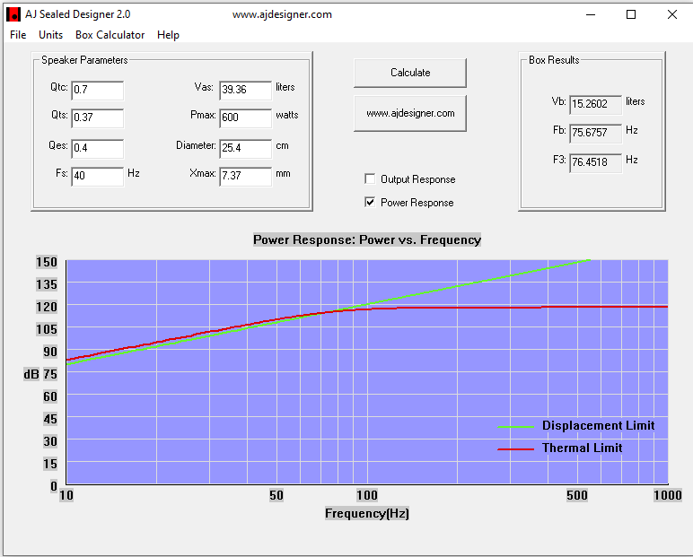

All parts are designed to be cut out of a single 3/4" MDF (or HDF) board. The baffle will be composed of two panels glued together. The enclosure is heavily braced to increase the stiffness of the panels and to raise the resonant frequencies (the higher the resonance, the less acoustic power it has). The enclosure has two separate volumes for woofer and mid-range. The ribbon tweeter doesn't require a separate enclosed volume. The size of the baffle pretty much depends on the choice of the speakers, since we are staying in the "bookshelf" category for this particular project. The width will be just enough to fit in the woofer, and the height - to fit in the mid-range and the tweeter on top, and the amplifier with all the terminals in the bottom. By adjusting the depth we can regulate the volume to push the response of the woofer as low as possible (in our case it will be 15 liters).

Next step is building a sealed sub-woofer with builtin class-B amplifier.
