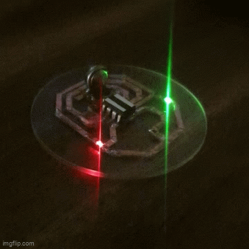

Abstract ATtiny85 Aircraft Sculpture
It just sits there and pretends to be an aircraft at night with a 1hz strobe.
Ultra low power ATtiny85-based 'glass PCB' style sculpture, featuring a pair of position and strobe lights that activate automatically at night. An abstract representation of an aircraft, quite useless if you ask me. The strobe flashes once every second!
I need to get a power profiler to find the real power consumption but it's been running for weeks now on a 30mAh coin cell.

  • Print the circuit guide, place it beneath the glass and replicate it over the glass with thin copper tape. If the adhesive side is non-conductive, solder the tape joints. Use flux and low temperature or you’ll burn the tape.
  • Use the schematic and footprint diagram as a guide to place and solder the components. Start with the pin headers (bend them inwards a little with pliers to give them enough tension to hold the coin cell) and work your way out to the edges.
Project background:
This month I finally jumped into PCB design after spending a few months yelling at a few stalled projects that require a working boost regulator circuit. I designed PCBs for a few of my circuits, breakout boards to make my life easier with SMD ATtiny85, and a bunch of 'test regulator' boards to see if I can finally leave behind this era of despair and LCR parasitics (and probably enter an even worse era of more complex problems).
It turns out PCBs take a while to arrive so the idea came to design a 'single layer' board and recreate it with copper tape. I made the design as visually appealing as I could. You can probably make it look cleaner if you use the kind of tape that is conductive on both sides, so you don't have to solder the joints. I was also tempted to use the surface mount version of the MCU, as I've made different projects by soldering coil wire to its tiny legs, but decided to 'make it pop' (hopefully only figuratively) with the TH version.
