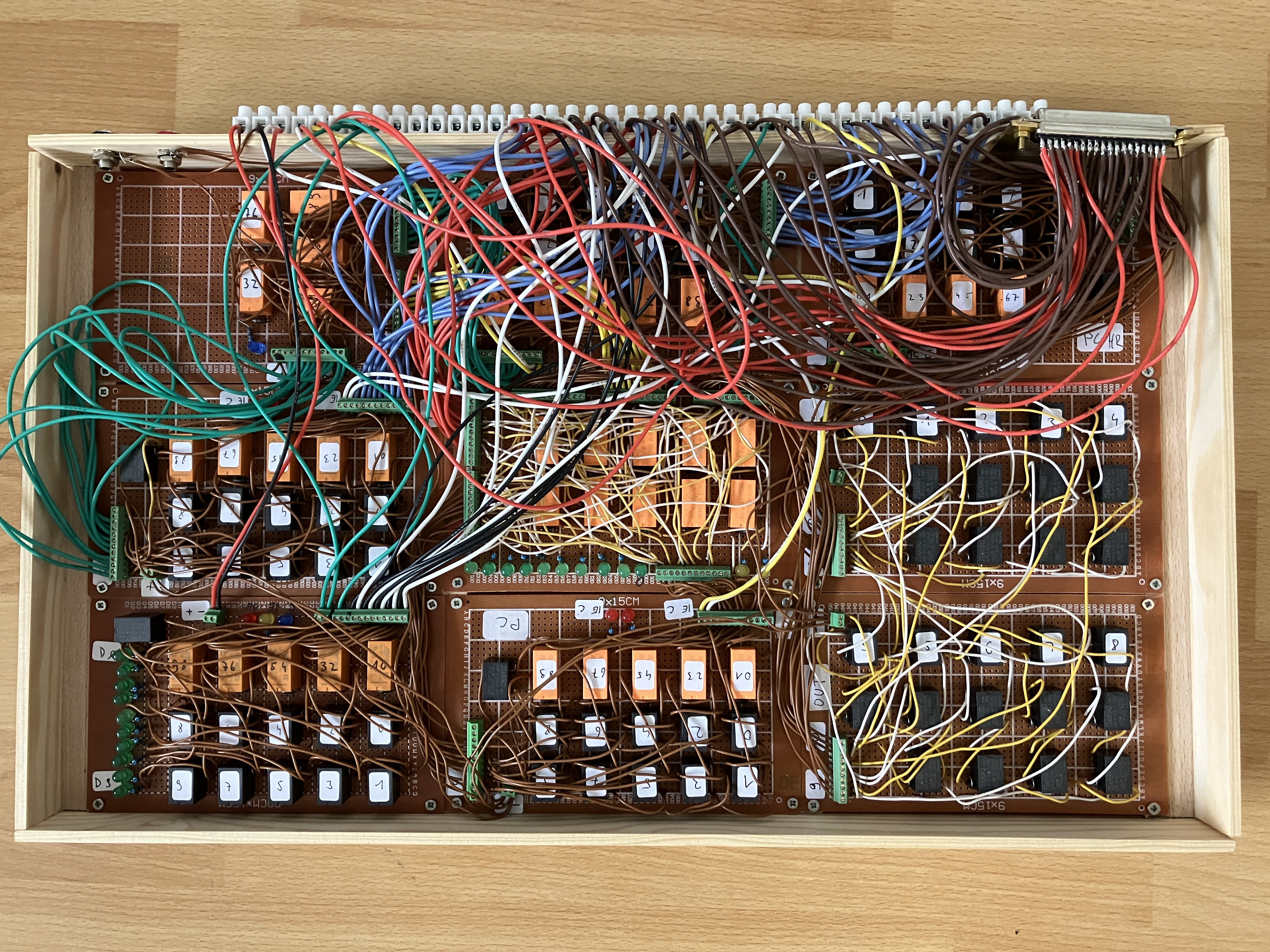

And now you see some pictures of the different module boards. The first one here is the control board:
The following board is responsible for address calculation:

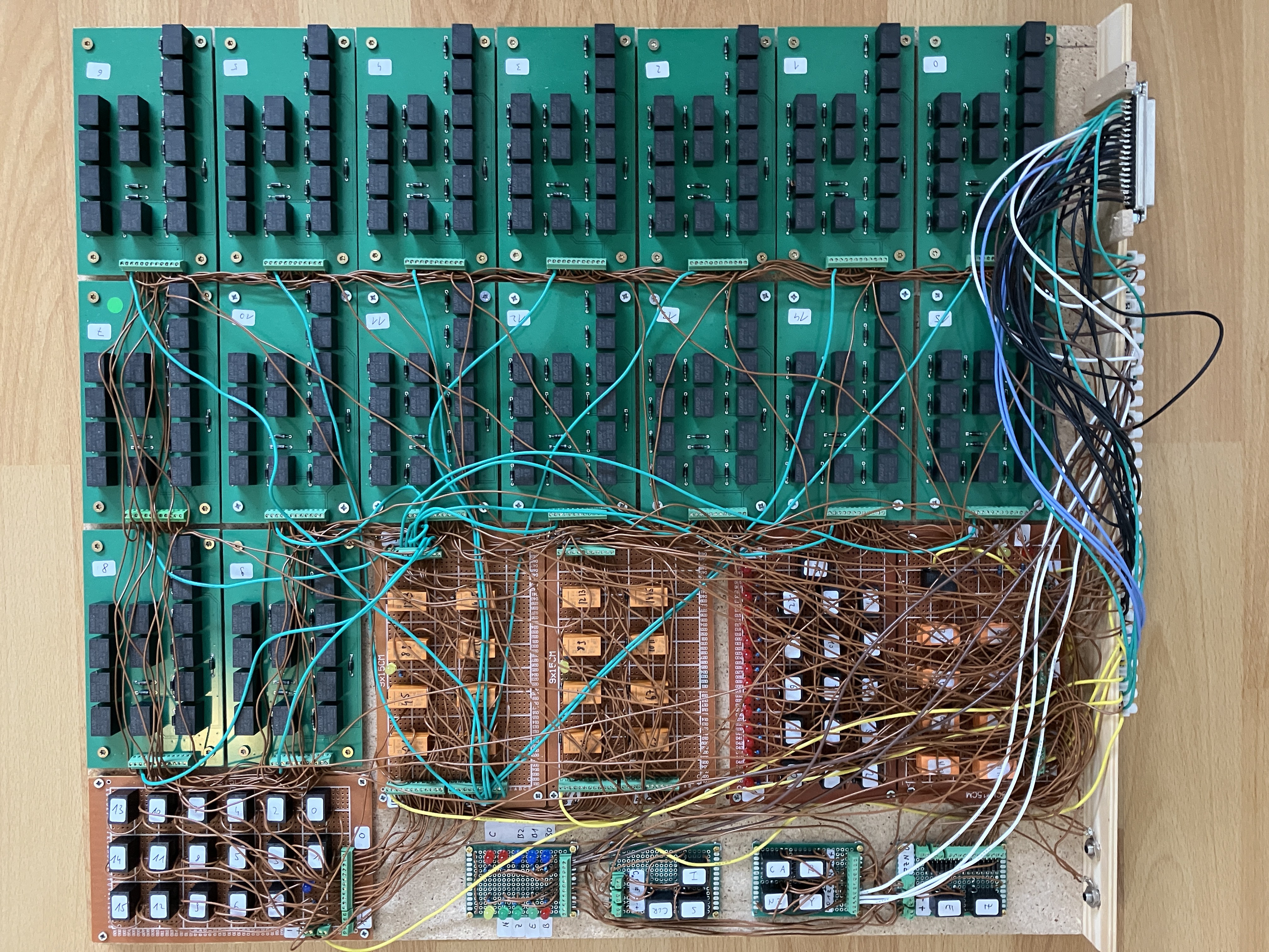

Here you can see the complete ALU, the accumulator register, and the branch logic. The green PCBs make up the 16-bit ALU, while the small boards at the bottom implement both the branch and carry logic.

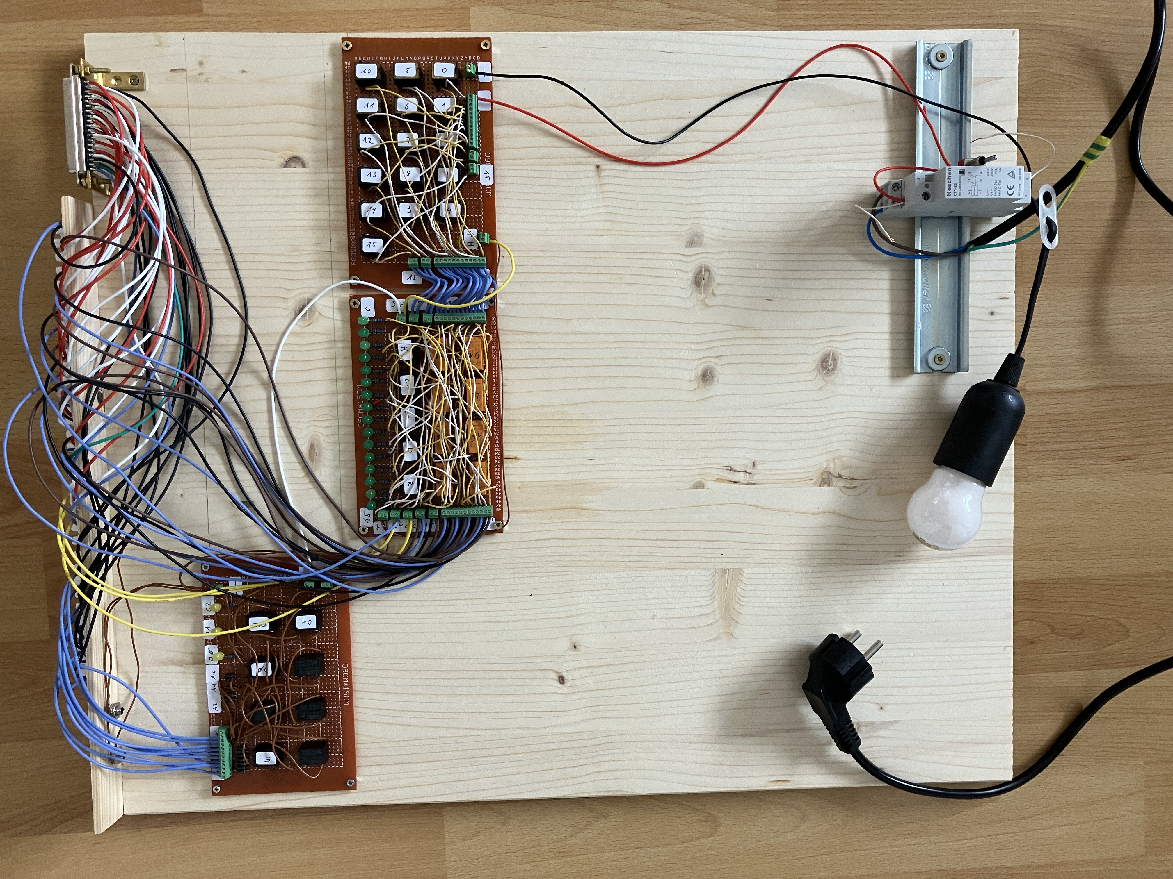

Here is the input/output decoder, the 16-bit output register, and the contactor, which switches the lamp.

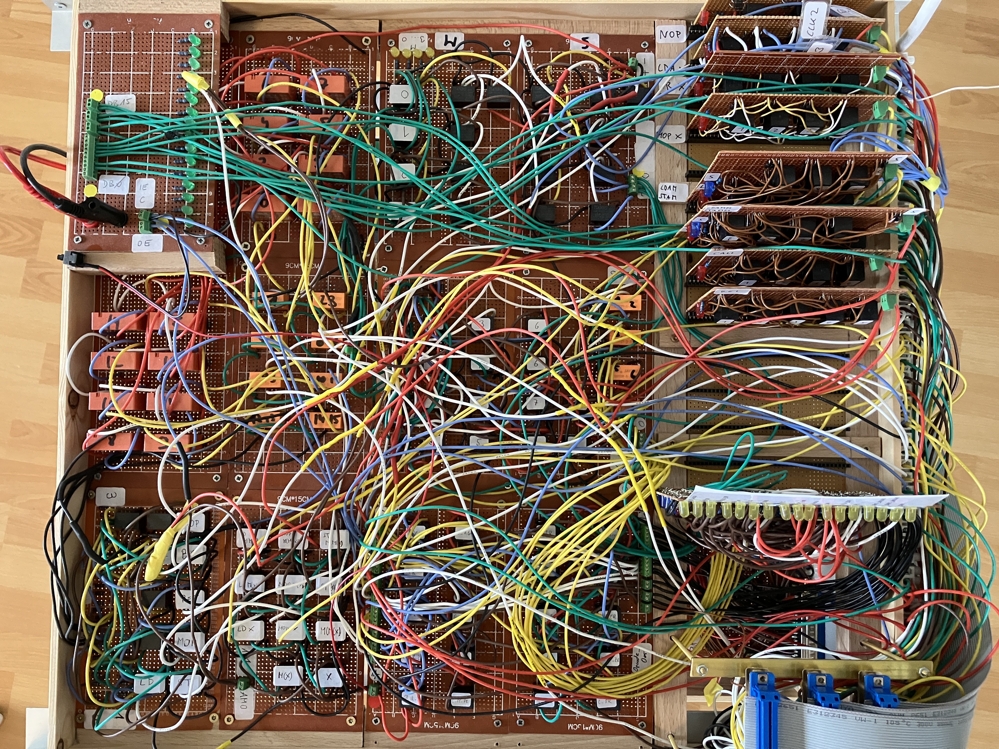

At the very bottom, we find the memory implemented using an Arduino, as well as the clock generator, which is also built with a separate Arduino.

    And here you see a picture of the new output-module of the relay system. The new memory mapped output register is located at memory address 2.
