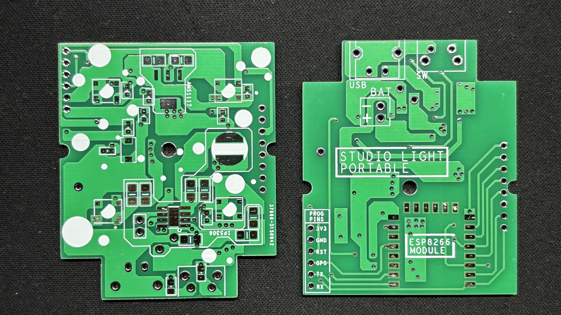

PCB Design
Let's have a look at the schematic for this project, which is divided into four primary parts, one of which is the microcontroller section, which in our case is the ESP12F setup. Here, we've connected the ESP12F module to a few 10K resistors in the minimal configuration required for the ESP12F to work. We also included a CON6 Header pin connector that connects to the TX, RX, GPIO 0, RESET, VCC, and GND pins of the ESP12F Module; this connector will be used to flash the ESP chip using a UART adapter.
Next, we have the Power source section, which is the IP5306 Power management IC Setup, which we have previously used in many of our battery-related projects. This SOIC8 Package IC can provide a stable 5V 2.4A from a 3.7V Lithium Ion or LIPO Cell and also includes many important functions such as overcharging protection, overdischarge, battery fuel level, and charging status.
Below is its datasheet if you want more info on this IC.
https://www.skytech.ir/DownLoad/File/2566_IP5306.pdf
Our ESP12F is a 3.3V device; however, the IP5306 provides 5V, which will easily destroy our ESP12F setup. To avoid this issue, we used an AMS1117 3.3V Voltage Regulator, which takes the 5V from the IP5306 IC and lowers it to 3.3V so that our ESP12F setup can function properly.
Finally, we have the RGB LED Array, which consists of four WS2812B LEDs linked together to make a four-chain addressable LED. We have also included four 100 nF decoupling capacitors, which will be placed near the VCC and GND pins of each SMD LED.
After finalizing the schematic, we prepared the PCB Design, which was really simple. We began by creating the board outline using a DWG file exported from our Fusion360 model, which we then used to construct the PCB outline in our PCB cad software. We placed all of the SMD components on the top side of the PCB except for the ESP12F module due to space constraints; all SMD components were extremely small and could easily be placed on the top side, but our ESP12F module occupied a larger area, so we had to move it to the bottom layer.
All of the through-hole components, including the Type C Port and Right angle Push button, were installed on the bottom side according to the mounting dimensions provided in the design. The mounting hole in the middle was also added by following the dimensions from the 3D model, as was the placement of RGB LEDs.

After completing the PCB Design, Gerber Data was sent to HQ NextPCB, and two orders were placed in a white solder mask with black silkscreen.
After placing the order, the PCBs were received within a week, and the PCB quality was pretty great.

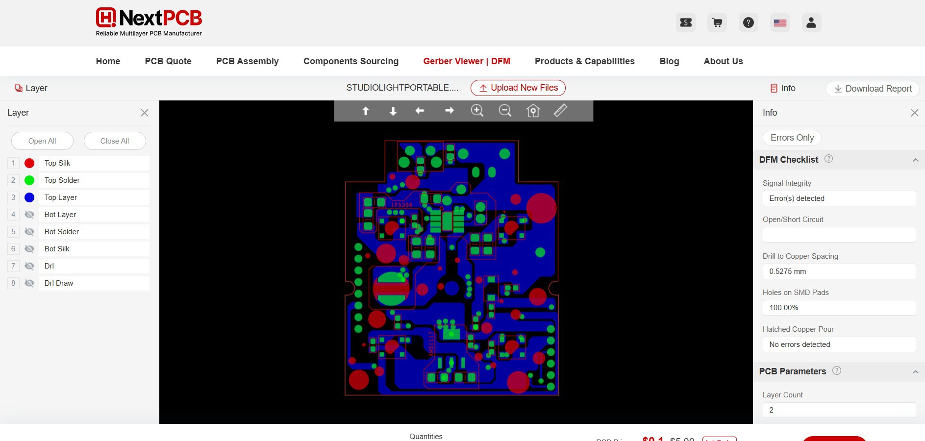

HQDFM: Free Online Gerber Viewer and DFM Analysis Tool
Also, NextPCB has its own Gerber Viewer and DFM analysis software.
Your designs are improved by their HQDFM software (DFM) services. Since I find it annoying to have to wait around for DFM reports from manufacturers, HQDFM is the most efficient method for performing a pre-event self-check.
This is what I see in the online Gerber Viewer. It's decent for a quick look, but not entirely clear. For full functionality—like detailed DFM analysis for PCBA—you’ll need to download the desktop software. The web version only offers a basic DFM report.
With comprehensive Design for Manufacture (DFM) analysis features, HQDFM is a free, sophisticated online PCB Gerber file viewer.
With over 15 years of industry experience, it offers valuable insights into advanced manufacturing processes. If you’re looking for reliable PCB services at a budget-friendly price, HQ NextPCB is definitely worth checking out.
