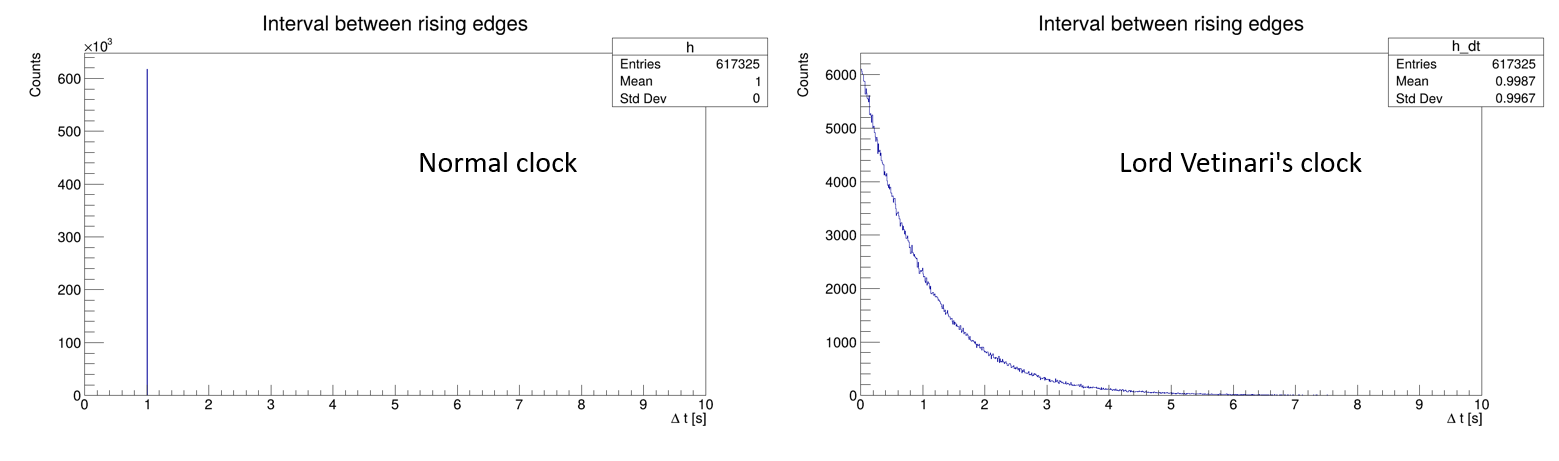

    The distribution of intervals between individual ticks shows a very different picture between a normal clock and our contraption.
    Left: tick duration you want from a normal clock. Right: tick duration you get from Lord Vetinari's clock
    The tick duration in our clock has the expected exponential distribution of time intervals, with short ticks being balanced out by long ones. The mean value of this distribution is very close to 1, providing the long-term accuracy of the timepiece.

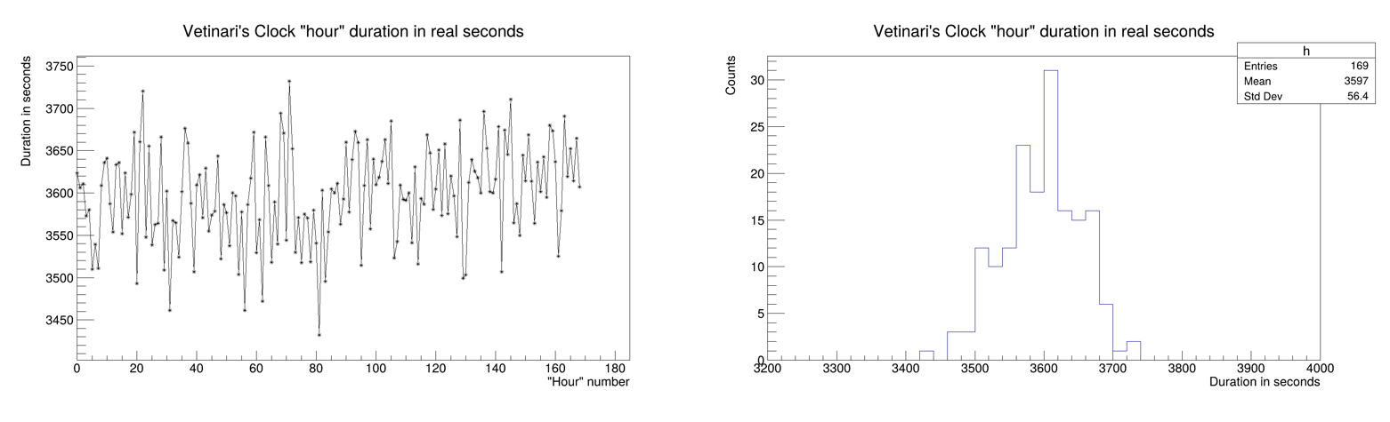

    Looking at the duration (in seconds) of an hour measured by our clock we are again greeted with a fair bit of randomness.
    Left: Time series of the duration of an hour, as measured by Lord Vetinari's clock. Right: Histogram of the same values
    While the duration of each individual hour, as counted by our clock, can be off by more than a minute, the histogram shows that the standard deviation is about 60 seconds. That is to be expected from counting statistics, with sigma being on the order of the square root of our measured counts -- here about 3600.

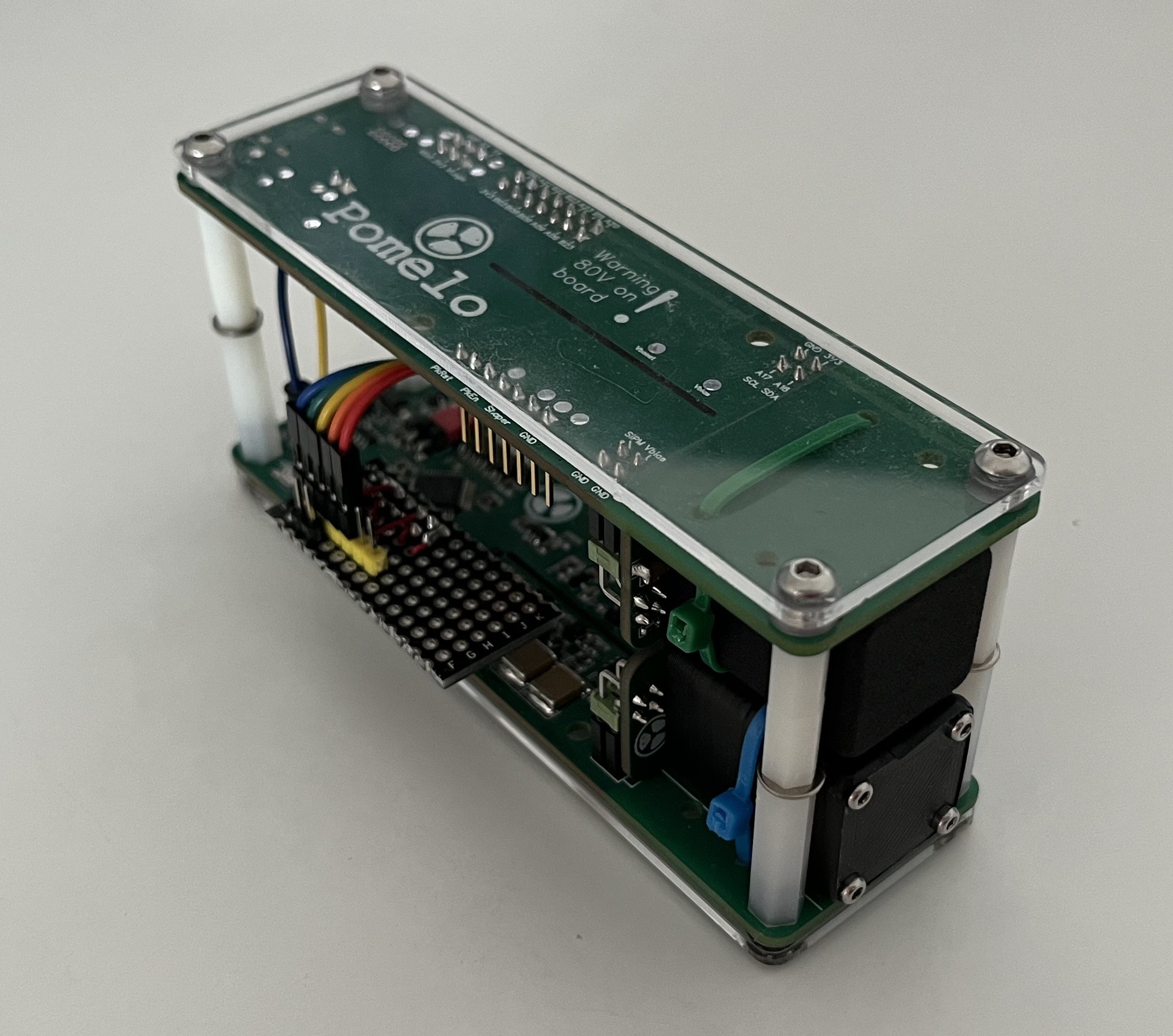

    Pomelo detector pair configured in coincidence mode. Bottom one also houses the Am-241 source.
    Two Pomelo detectors are configured in coincidence, in a fixed configuration with the Am-241 source. One of the detectors is sensitive just to the gamma rays that easily pass through the enclosures, whereas the other will see the alphas too.

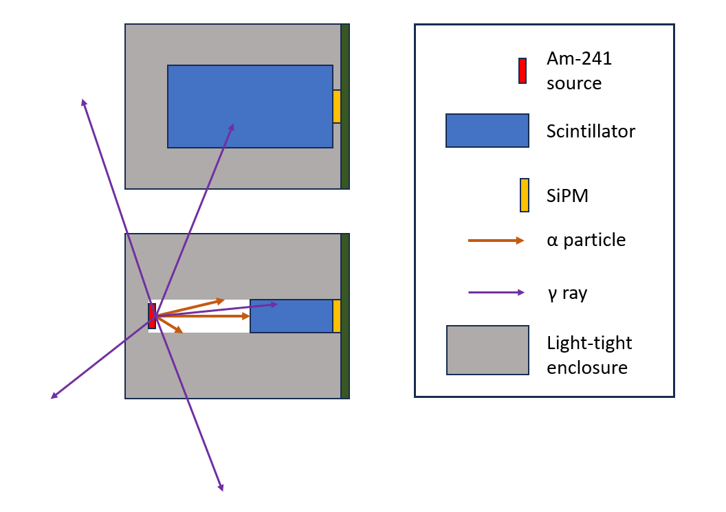

    Schematic representation of the two detectors and the physics process. A coincidence pulse is generated only when one gamma hits the top detector and one alpha hits the bottom one.
    The bottom detector is made insensitive to gamma rays by setting its energy threshold above the gamma ray energy. Even slowed down by some air in between the source and detector, alphas still deposit more energy than the 59.5 keV gammas.
    Changing the distance between the two detectors adjusts the coincidence rate by lowering the gamma count rate in the top detector. This distance has been adjusted to produce around one coincidence pulse per second.

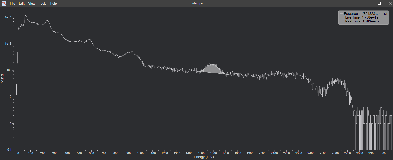

    Another option I considererd before settling on the coincidence setup was to use a higher enerrgy gamma line where there is lower background, as this was the main problem identified in the previous log entry.

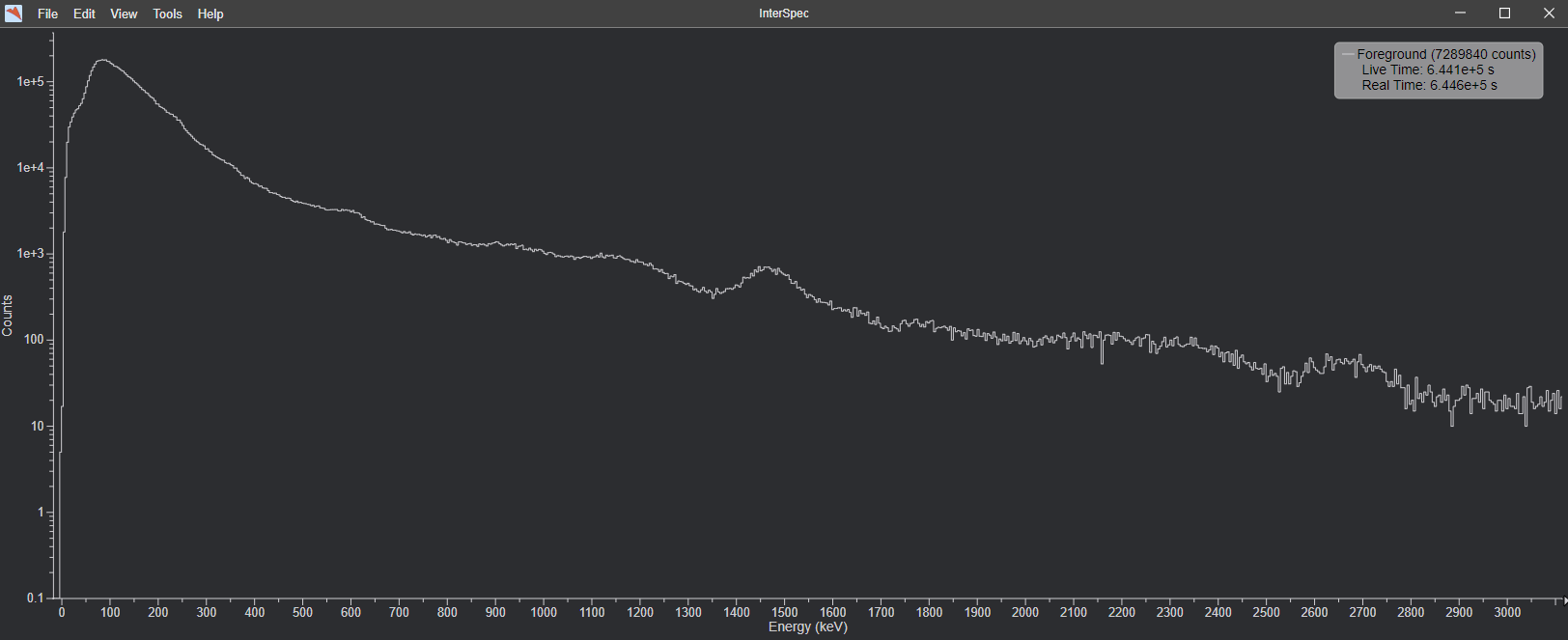

    The natural background quiets down at higher energies. Above the 1.46 MeV peak from K-40 there are not enough counts in the detector to interfere with a one count per second source, if we can find it.
    Background gamma spectrum taken with Pomelo. The K-40 is visible at 1.46 MeV
    The only source I have that gives such high energies are thorium welding rods. Unfortunately they are way too weak, the highlighted peak in the Th-232 spectrum below, around 1.6 MeV, only has ~0.5 counts per second including its background.
    Th-232 gamma spectrum taken with Pomelo from thorium welding rods. Bump around 1.6 MeV is a collection of closely spaced gamma lines from thorium decay
    Unfortunately for my setup this means this method is unavailable for the clock timebase.

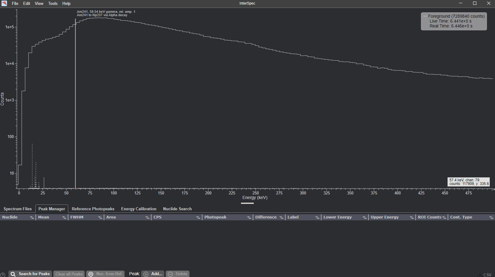

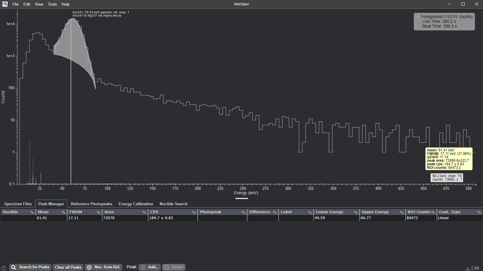

    Before settling on the coincidence setup I considered using just the gamma line from Am-241 decay. As Pomelo can perform gamma spectroscopy we can look for the 59.5 keV gamma line and use that for our timebase. In the example gamma spectrum below we see we would have to look for counts in the energy range ~40 keV to ~80 keV, because of limited detector energy resolution.
    Gamma spectrum of Am-241 with source pretty close to the detector
    While we can increase the source distance to the detector to get on average 1 count per second in that region, natural radioactive background also has a significant contribution there. The background spectrum below is accumulated over a very long time without the Am-241 source close by.
    Background gamma spectrum with no Am-241 source. Position of the Am-241 gamma energy is still indicated for reference.
    This spectrum has ~2.6 counts per second in the energy region of interest. This means background alone gives more signal than we need for the timebase. One fix for this would be to shield the detector and source in lead to remove the background contribution, but I have not explored this option.
