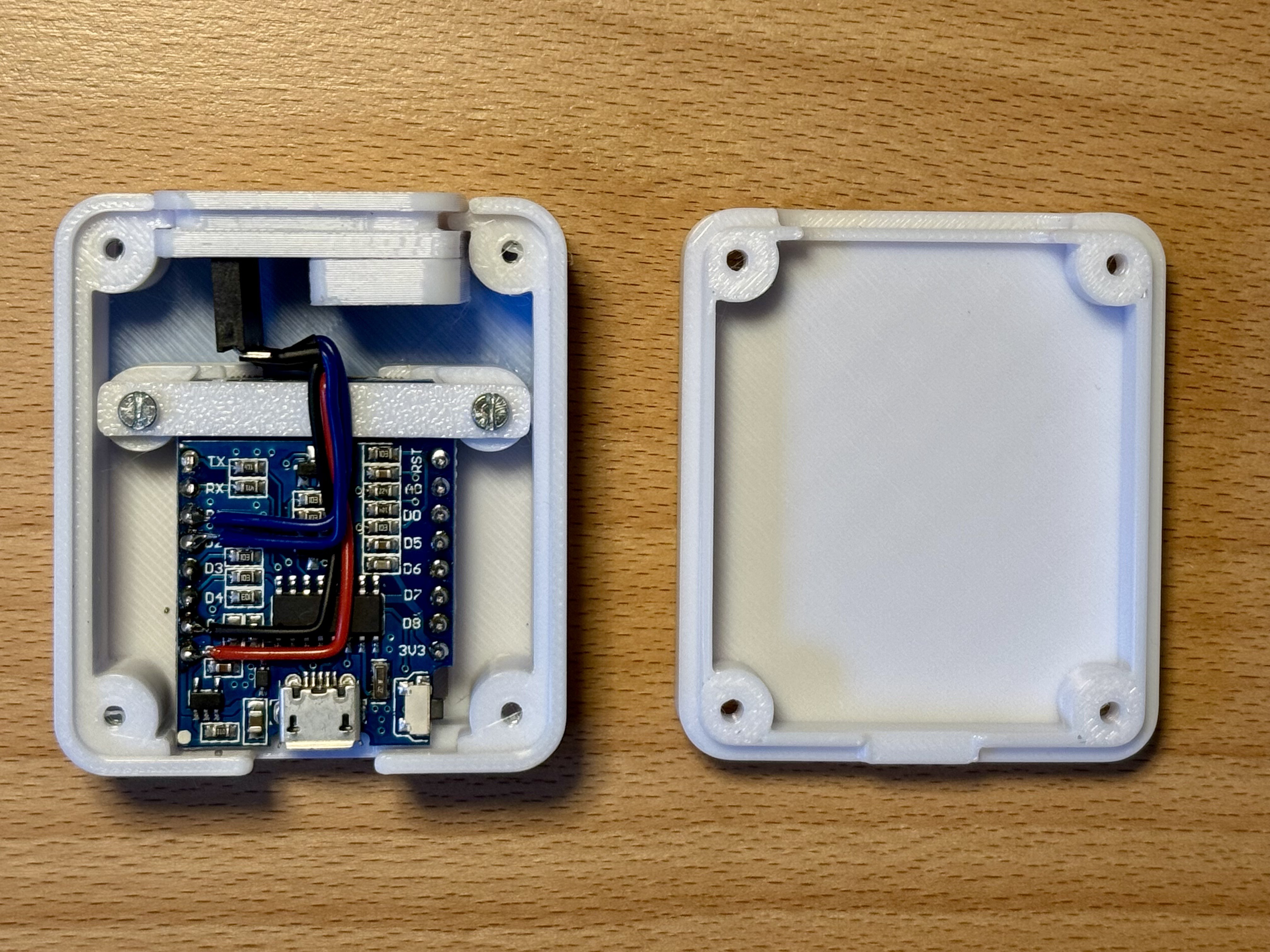

Fusion 360 Case Design
To ensure a compact and well-integrated device, a complete 3D model of the enclosure and electronic components was created in Fusion 360.
- The design centers around a structural top shell, which holds all components in place.
- The Wemos D1 mini with its soldered-on OLED display is mounted directly inside the case and secured with a crossbar.
- The MAX30102 sensor is placed on top, held in position with a custom clip and holder.
- The bottom shell closes the enclosure securely.
All 3D models are available as STL files in the GitHub repository, so you can print and customize the case to your liking.

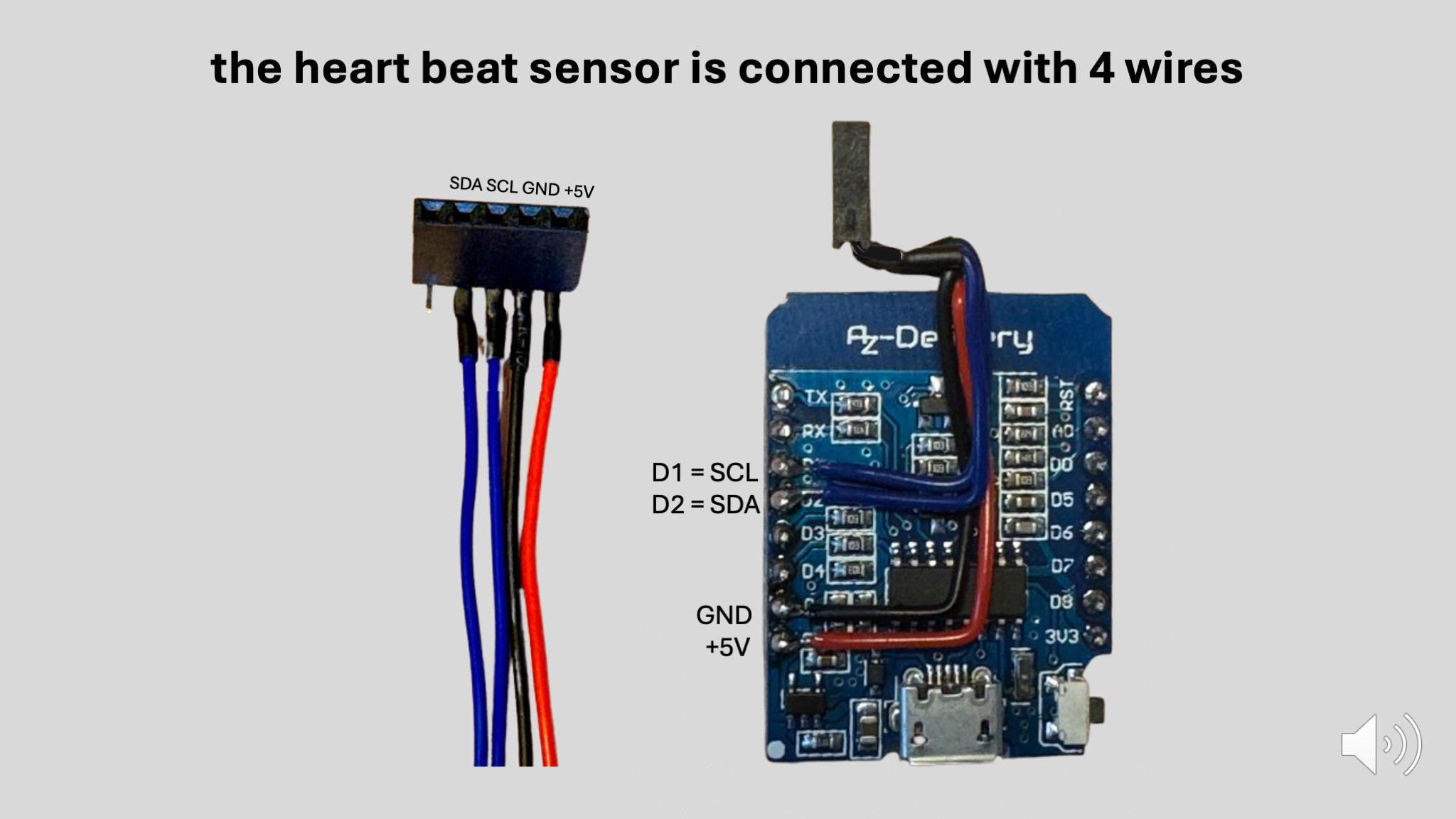

Wiring and Power
The wiring is simple and uses only four essential connections between the Wemos D1 mini and the OLED display:
- GND (ground)
- 3.3V (power)
- SDA (data)
- SCL (clock)
These are standard I2C lines, which are also shared with the MAX30102 pulse sensor.
The sensor itself is powered via 5V, which is available from the D1 mini’s USB supply.
The entire circuit is powered through the USB port, so no additional power supply or battery is required for basic operation.
This setup keeps the wiring minimal, clean, and easy to replicate—even for beginners.
Soldering the Sensor Connector
To connect the MAX30102 pulse sensor, a 4-pin connector is soldered directly to the back side of the Wemos D1 mini.
This approach keeps the wiring compact and out of sight, allowing for a cleaner build and easier assembly within the tight space of the custom 3D-printed case.
The four wires—GND, 5V, SDA, and SCL—are then connected from this header to the sensor.
This method avoids clutter on the top side and contributes to the device’s neat and integrated look.
Final Assembly
With all components prepared, the final assembly begins.
The microcontroller with the OLED display is mounted into the top section of the case using a small bracket.
The MAX30102 sensor is inserted into its dedicated holder and secured with a clip from above.
Once everything is in place, the bottom cover is attached, enclosing all electronics in a compact and robust housing.
To keep the video concise, this step is shown at increased playback speed — but as you’ll see, assembly is simple and straightforward.
All STL files for the case are available in the GitHub repository, so you can print and assemble it yourself in no time.
