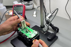

    2) Boards
    For the board, (where everything will attach) you need to figure out what you will be removing. For example, I'm doing a;
    Battery
    USB 2
    Speakers
    EDIT-
    This is me from the future, I realised that the battery has more than just positive and negative connectors, as you saw in the video, so I didn't do the speaker, so make sure you know what all the pins do in the battery, speaker, etc.
    It's not a lot, but the usb 2 will use accessories like thermal cams, etc. I have the board file, which I think is pretty modular across all phone types. You will need to solder though. The setup for usb is complicated but this is how it will work.
    The charging port can be mounted at the bottom while you can cut the wire for the USB 2 board and solder it.
    For the components, I am using 0.8mm pogo pins from aliexpress. I have 10 rows of 8 pins in each “cluster”, so I will need at least 80 pins.
    Here is where i went wrong when writing this.
    DO NOT, and I repeat, DO NOT, solder the pins to the base board itself. It was a moment where my brain was not in gear as if you solder only what you need to the blocks, you will only end up doing a fraction what that was. For example if I do one USB 2 Device, and One Battery, that ends up being only 8 pins I have to solder. So just hear me out, Make the pins pads on the main board, and solder the pogo pins to the bloks.
    For the components themselves, I will add pads into the PCB software “EASYEDA.com” for connection to the board to the component. This is where you need soldering and PCB editing skills. For the battery, you will need to replicate the connector on it as the pads are way too small to solder wires to. For example, this is a ribbon cable I designed to wire the battery connector to the board.
    I will use a FPC ribbon board like this
    Which then connects to a soldered on battery connector, and the ribbon cable goes to the main connector board, like this.
    They will then go to where they respectively locate.
    (i.e. Micro USB to USB C splitter, BAT FPC to the Bat connector, etc)
