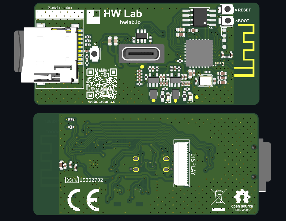

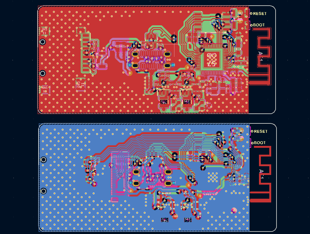

Hardware Design
We designed the PCB from scratch using KiCAD. Signal integrity for the SPI bus was a top priority, ensuring stable communication at high speeds with the display and SD card sharing the same bus. The board includes all necessary decoupling capacitors, series resistors, and thermal considerations. The USB-C port is used for both power and serial programming.

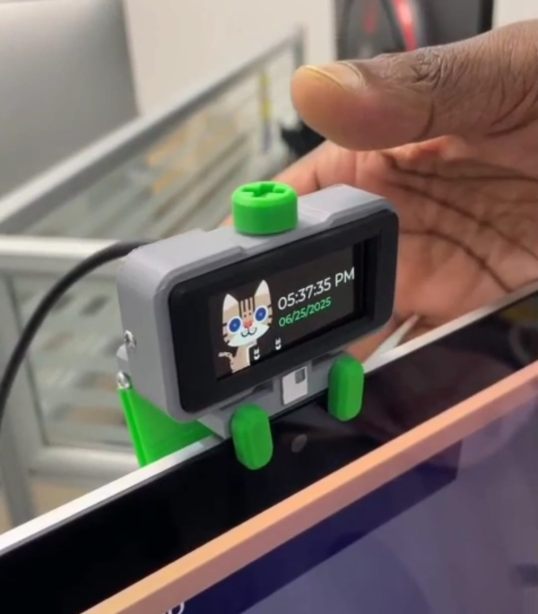

Mechanical Design
The case is 3D printable and requires no screws or glue. It's designed to clip cleanly on the top edge of most monitors, with optional bottom or top tripod screw mounts. The enclosure was modeled in FreeCAD and optimized for PLA or ABS. Variants can be remixed to include holes for LEDs, ventilation, or alternative mounting strategies.

    The electronics were meticulously designed with signal integrity in mind. All high-speed traces are routed with matched lengths and series termination resistors, while ground pours and decoupling capacitors help reduce RF noise generated by the ESP32‑S3. A 128 MB serial flash memory module ensures ample room to store firmware, configurations or custom JavaScript applications loaded via the microSD slot.

    Mechanically, WebScreen measures just 74 × 80 × 53 mm and weighs a mere 53 g, reflecting a purposeful minimalist design. It snaps securely onto the top of monitors using internal clamps, and includes standard ¼‑inch threaded holes on both top and bottom surfaces—perfect for mounting a webcam or stacking multiple units.
