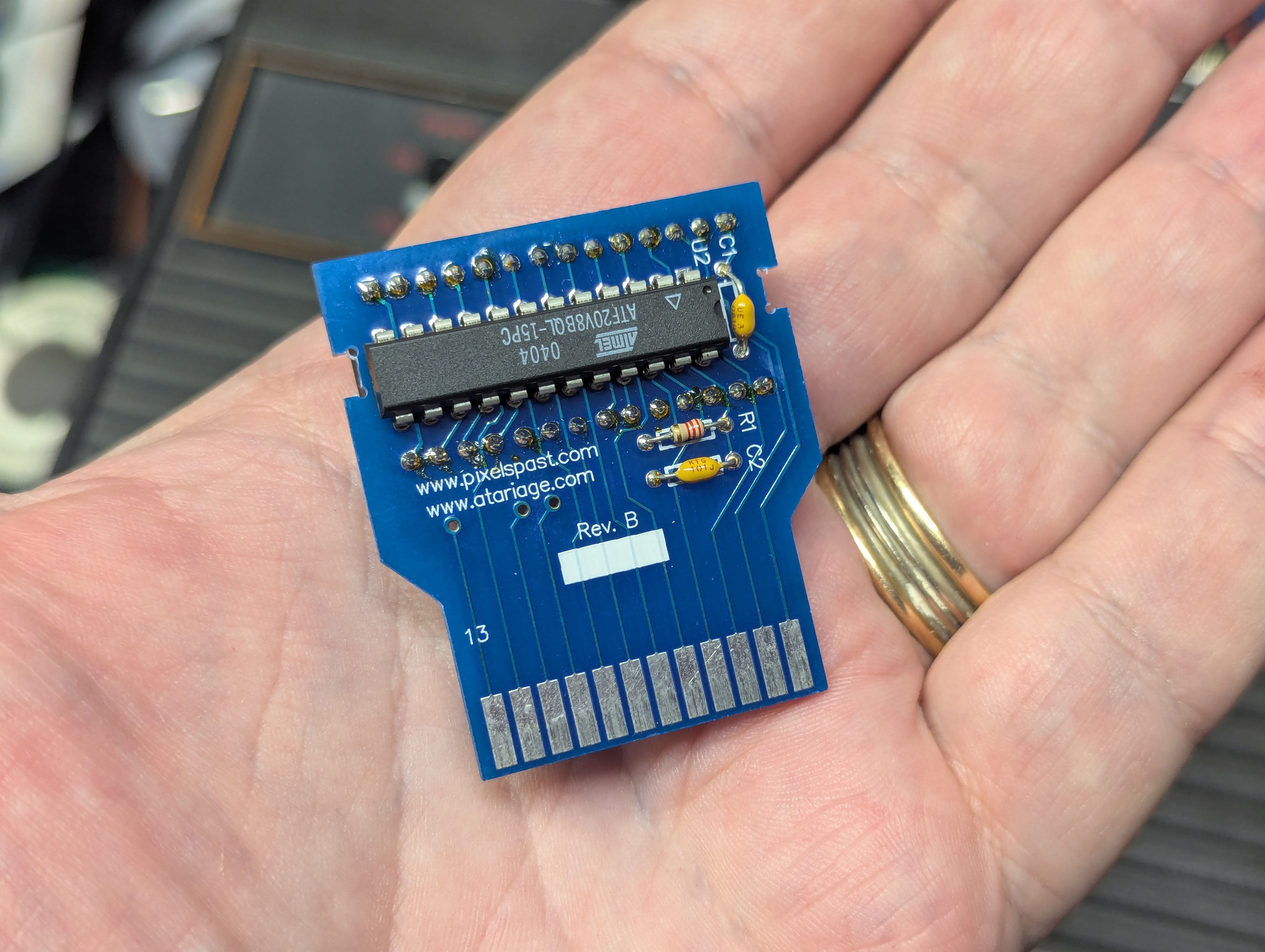

Why yes, yes I can.  So I did.  I made a new cartridge.

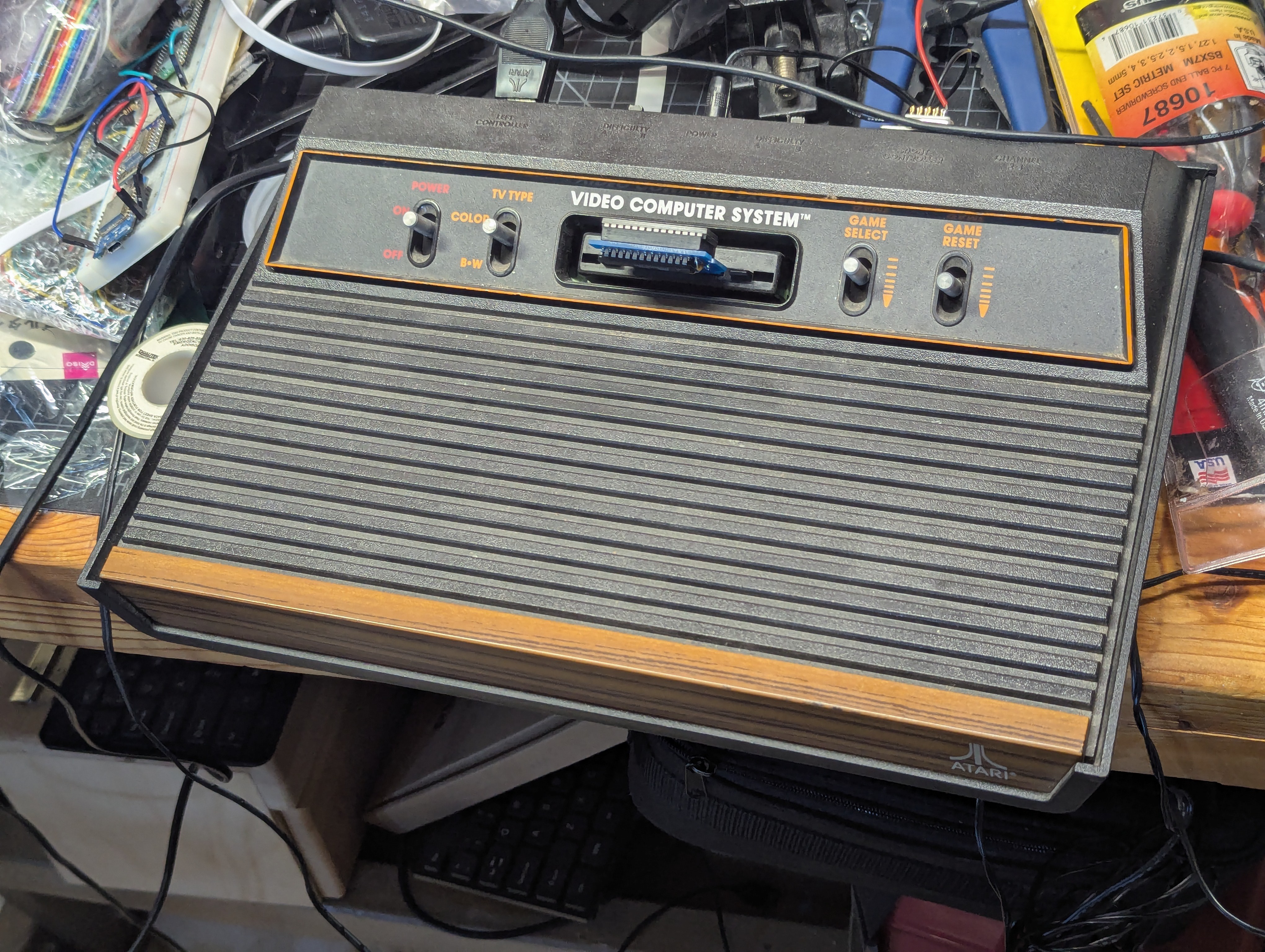

I then pulled my ailing Atari 2600 out of storage, found a monitor with a cable input (hard to do, all mine are HDMI these days) and got it running.

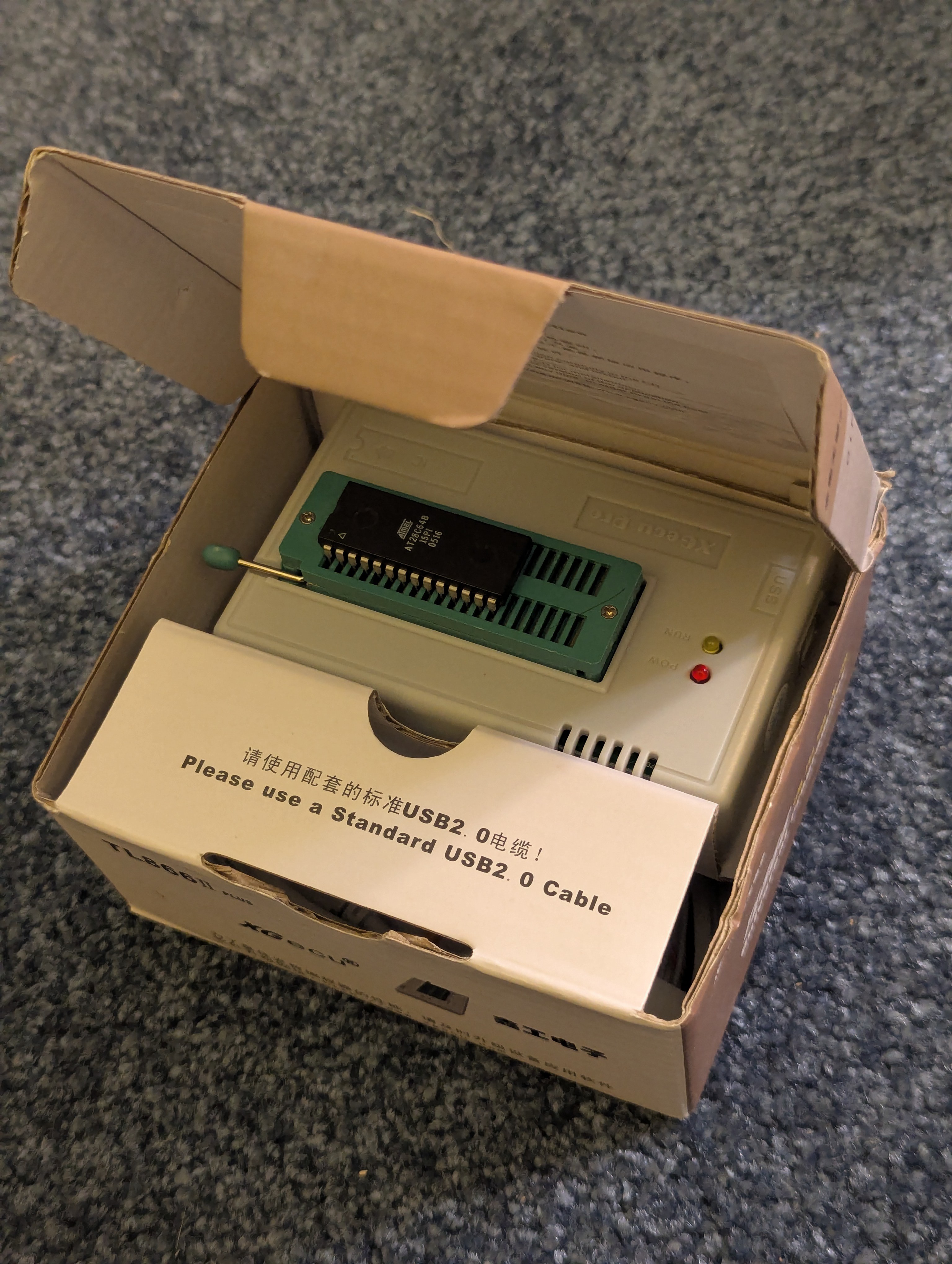

Back in the 2000s, I was able to source Atmel AT28C64Bs from Digikey at a modest price.  These are 28 pin DIPs which are pin compatible with the early 2716 or 2764 EPROMS that were used by early experimenters.  These chips aren't easy to source anymore: I had a couple left over in one of my bins.  And of course to use them, you need a programmer.  Originally I had a programmer than ran on DOS through a parallel port, but at some point I acquired an XGecu TL866II+ USB programmer which I used to program this hardware.  Shockingly, this open source software worked with it perfectly, and I was even able to run it under WSL on my Windows box after I got the USB passthrough working.

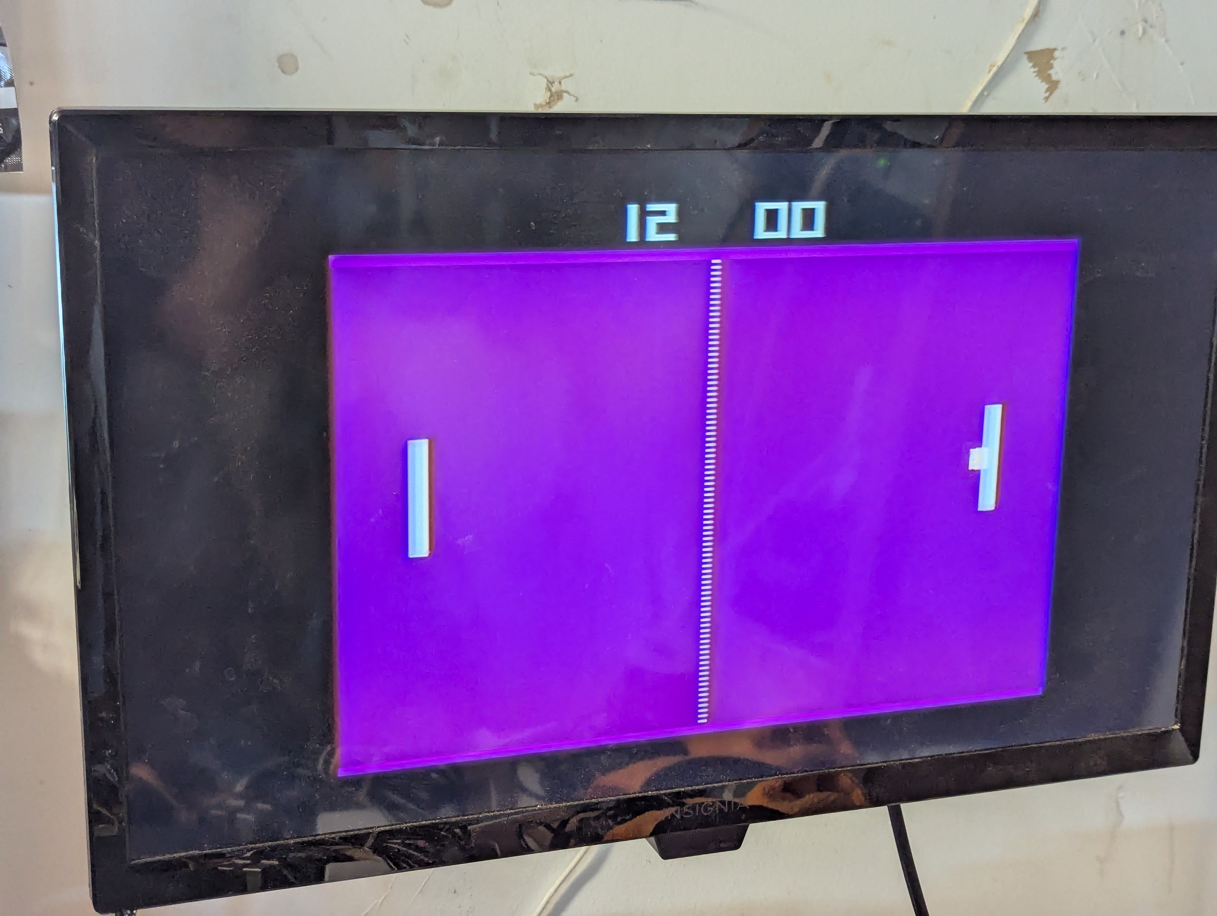

My Atari 2600 is getting glitchy

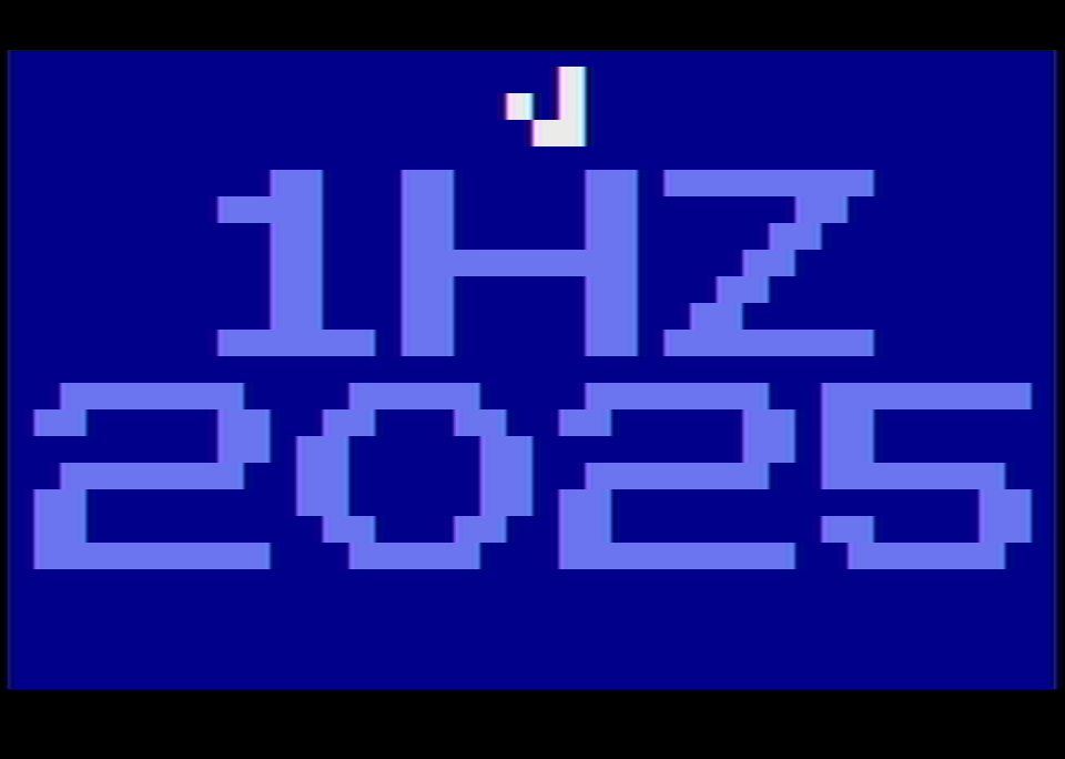

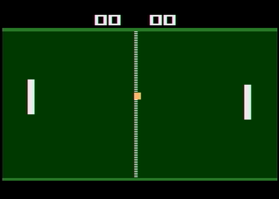

I'm not sure what's going on with my hardware.  On Stella, I get these colors:  a nice blue background on the title screen, and a nice green field for the actual game board.)
But on my TV (apologies, it's in my garage, since that's the only one with a TV input in the house anymore), the colors are somewhat different.
Not sure what's up here.
