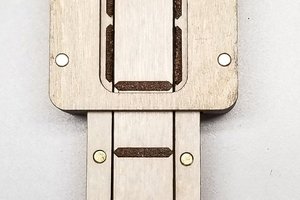

3) Display & Decoding Logic
- Seven-segment display, driven according to a 4-bit counter value.
- Optional mode where the module functions as a simple 4-bit decoder for input from external logic (such as feeding with outputs from a half adder chain or microcontroller).
- DIP or mode jumper selects between autonomous counter or decoder operation.
