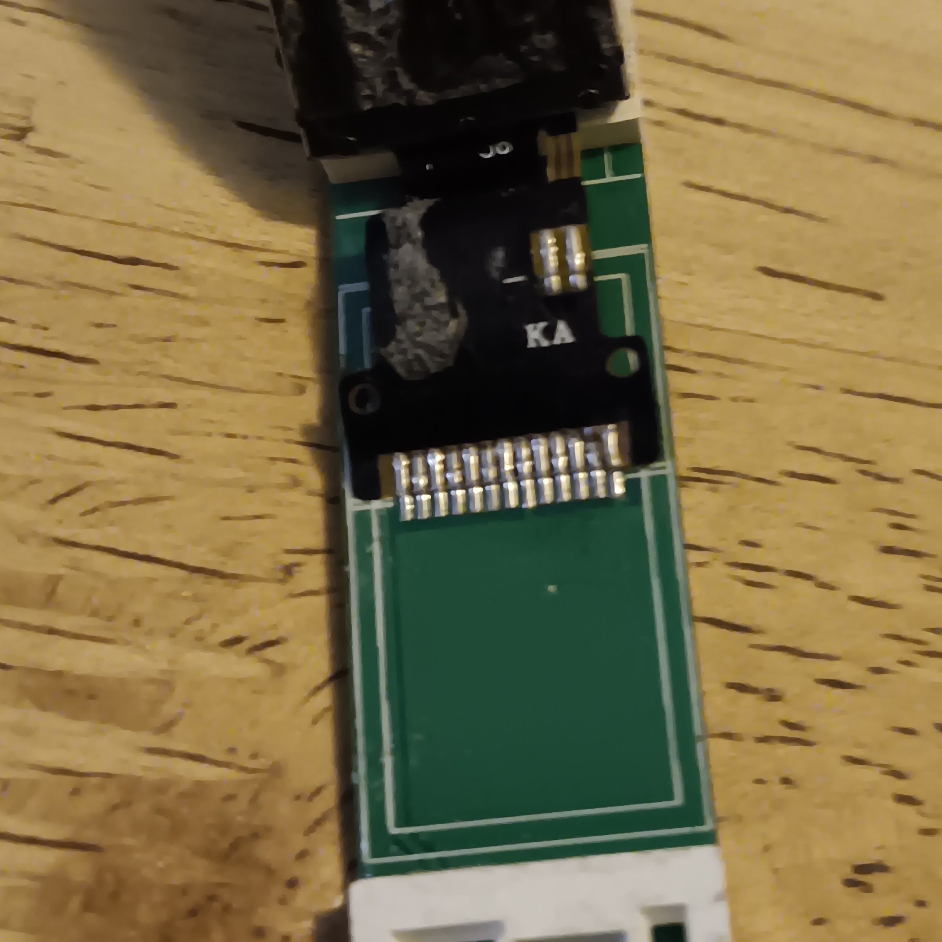

    I got a oscilloscope for christmas and decided this is the project I need it on.  One thing to note, I may have gotten the ribbon connector backwards.  I went to remove another screen and was able to peel it off gently (10th times the charm) and can see the K A markings on the cable.  Based on this new information, I think my original pin out is backwards.  Im working the pinout again using this new data but so far its not making too much sense.
    I did open a new vape and was testing out my new tool, yet the pin headers broke about halfway through.  There are a few lines that operate the board LEDs but they go through some transistors, Im assuming to select which LEDs to light up since theres both red and white.  I think some of signals I was looking at on the o-scope were being sent to flash the LEDs and not clock or data signals like I was looking for.  However since they came apart before I was able to verify which ones were which, I'll have to crack open another.  In the meantime, Im re tracing the PCB to see whats going where and then i'll verify with the scope.

    I was able to separate the screen from the board.  It took several attempts and in each attempt, I tore the cable ribbon each time due to some glue that was use to secure it. So i decided to leave it attached to the board for now.  There was number on the ribbon that was the only indication of a part number.  It lead me to an alibaba page  (https://www.alibaba.com/product-detail/0-96-tft-lcd-display-80_62563989971.html) and I was able to use that information to search for more information.
    After much searching, I found a pinout that may match the ribbon cable.  Locations of the ground plane as well as a K and A marked on the back of the ribbon, which I assumed was for the backlight anode and cathode, gave me an indication that I had the proper pinout for the screen.
    Now I have a pretty decent idea of what I'm working with.  Its a .96" 80x160 pixel display driven by a ST7735.  It operates on 3.3v and there is 13 pins on the ribbon connection. However, theres 11 connections (far left side in image below).  I ran a power supply, voltmeter and continuity tester to identify as best as I could which of the far left connections, connects to the ribbon connector.
    Finally I took a fresh screen and soldered wires onto the old header pins.  With this I should be able to talk to the display.  Next I'll decide what microcontroller or arduino to use and methods to test.  While i was doing this, I did find out the vape had a arm controller(32 bit arm cortex +m0cpu) as well as a small possible flash, probably for image data.  I didnt dig more into this but I plan to in the future, possibly as another project.
