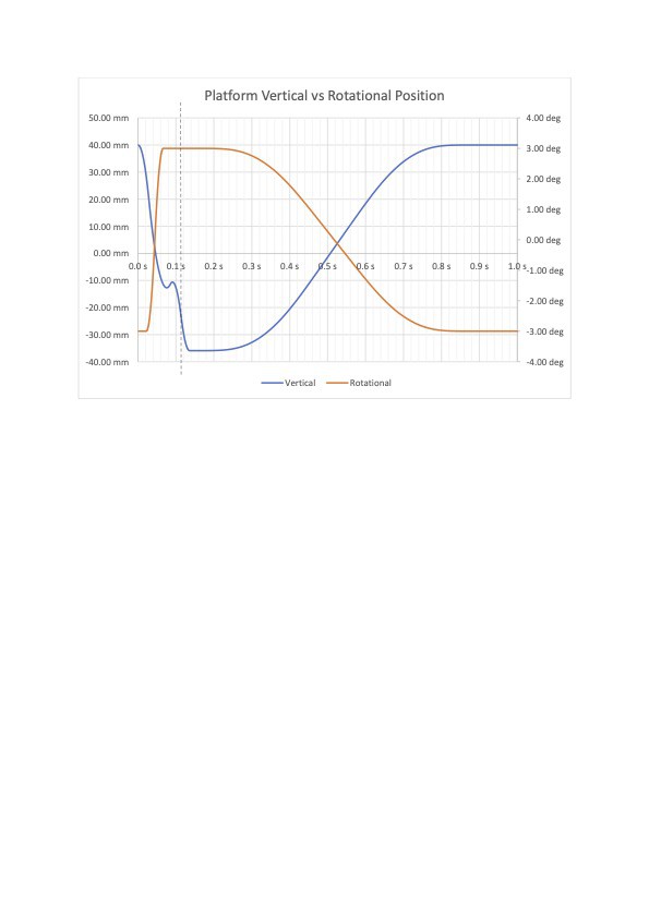

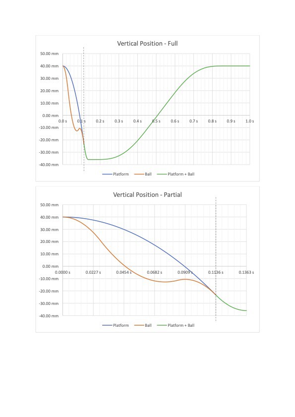

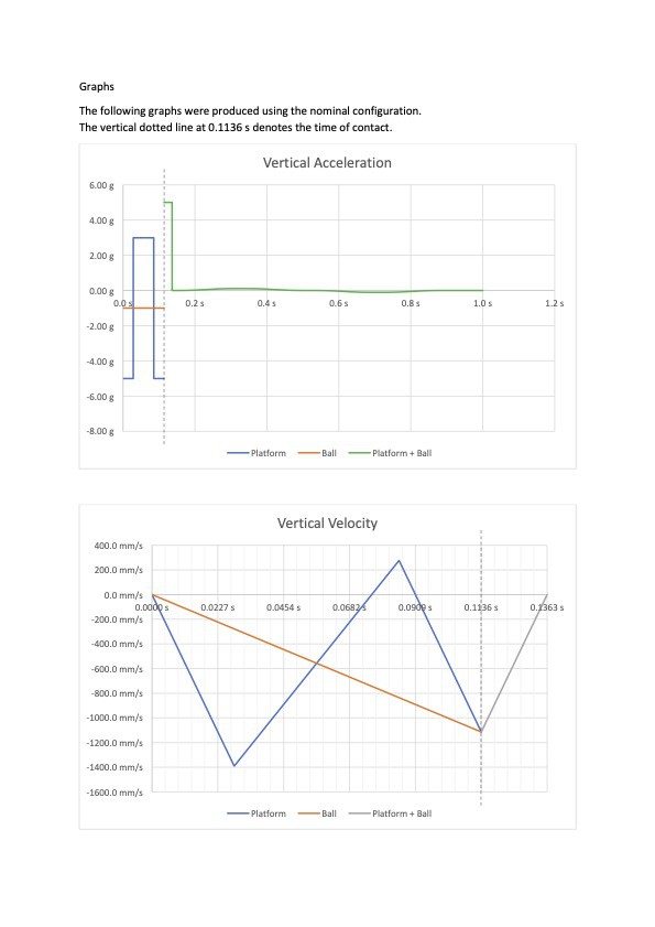

Catch Trajectory (0.000s - 0.136s):
  • Platform drops at -5.0g, breaking contact with the 40mm ball
  • Ball falls freely at -1.0g while platform rotates 6° to align with next pocket
  • Platform reverses direction (+3.0g briefly, then -5.0g again)
  • Calculated timing ensures both platform and ball have identical velocities at contact
  • Minimal-impact catch at t=0.114s, followed by +5.0g deceleration to complete stop

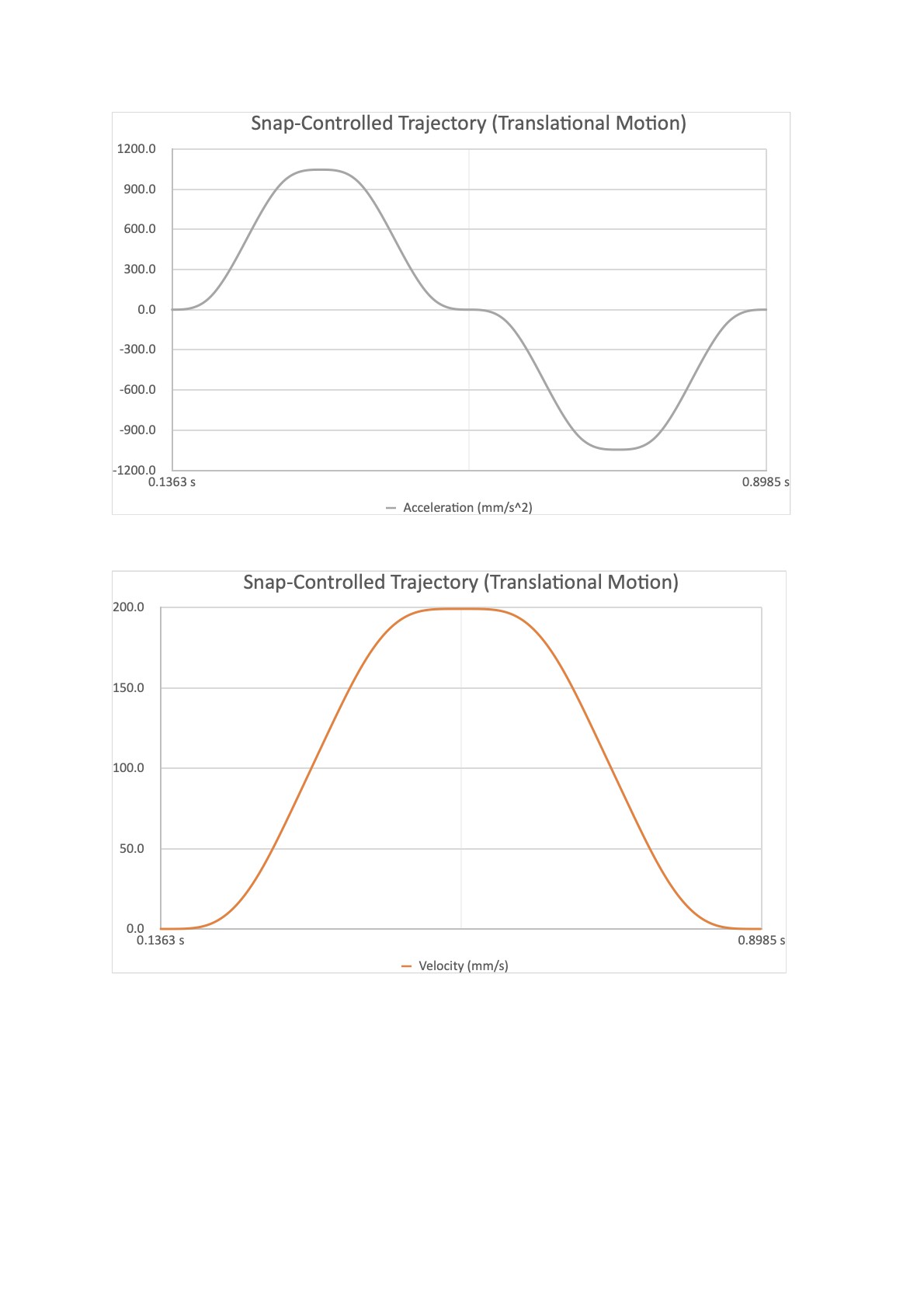

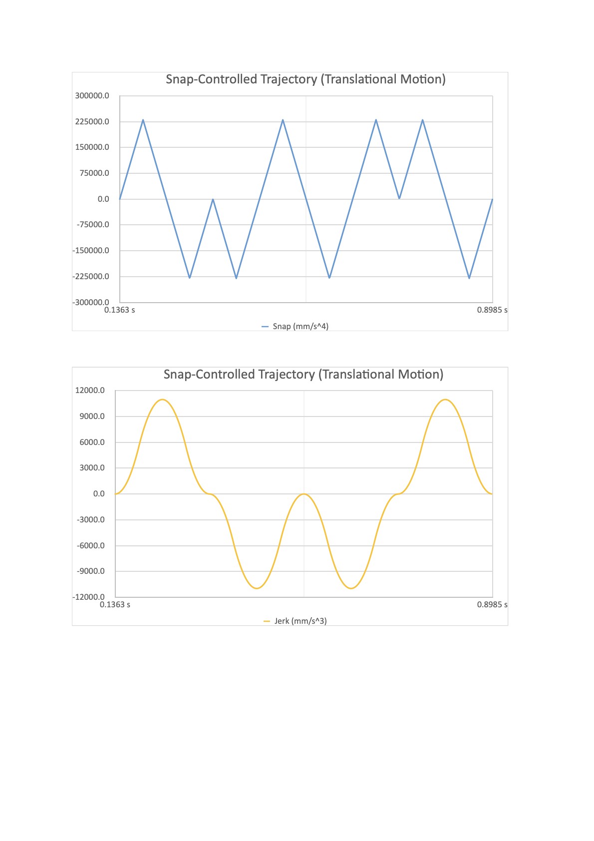

Return Trajectory (0.136s - 0.898s):
  • Smooth snap-controlled motion returns platform and ball to starting position
  • Uses advanced S-curve trajectory planning with kinematic constraints
  • Acceleration, jerk, and snap are all continuously controlled for seamless motion

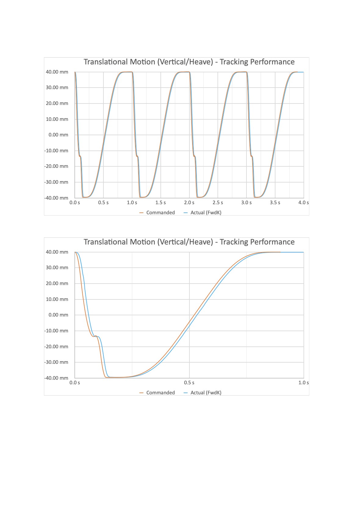

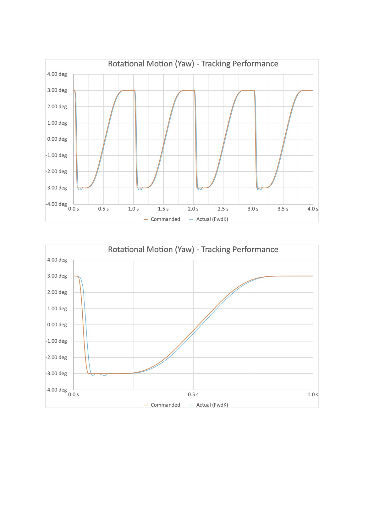

The included graphs demonstrate:
  • Precise acceleration profiles during catch trajectory
  • Smooth snap-controlled return motion
  • Real-time tracking performance showing commanded vs actual positions
