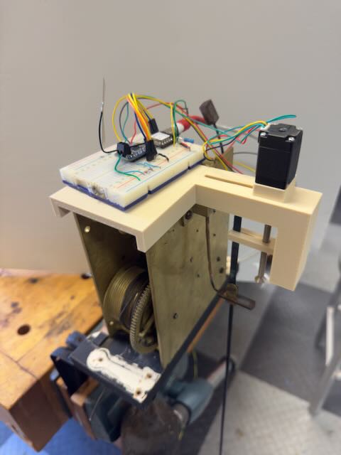

This clock has had a hard life.  At some point its case was lost or irreparably damaged.  A common practice was to create a wag-on-the-wall.  The works were attached to a bracket and hung on the wall where it continued marking time.  So it was with this one on the wall of my dad’s house.   I inherited it from him 20 years ago and it sat in a closet until a couple of weeks ago when I realized the One Hertz Challenge was an excuse to do something I’ve thought about for years.
While long cases were the accuracy champs of 1790, they are not so good by modern standards — plus or minus a few minutes a week.  A few bucks worth of parts, some software and it can recover past glory — atomic clock accuracy over long periods while synced to NTP.  Why not?
The first rule of old clocks is that changes must be reversible. Don't drill any holes or permanently attach modern hardware.  So a 3D printed bracket rests on top of the works.  An arm extends down behind the pendulum holding a clip that slides up and down the spring that holds the pendulum, changing the pendulum’s length and the timing of the clock.
A NEMA 9 stepper motor attached to a 10-32 machine screw moves the clip.  The stepper has 400 steps per revolution.  1/32" linear movement per revolution gives ridiculous clip precision of   0.000156" per step.  A DRV8833 dual H-bridge drives the stepper, an ESP32C3 runs the H-bridge, the PID controller, an NTP client, and serves a web page for monitoring and control.

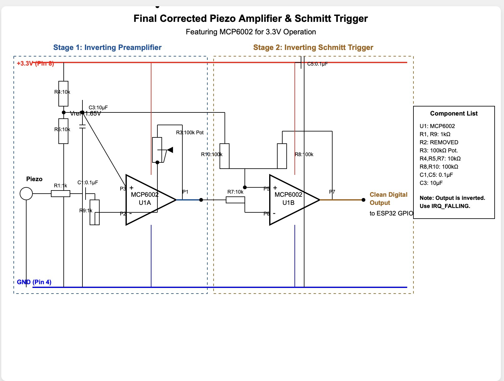

A piezo sensor taped to the clock's back plate provides the pendulum timing.  The sensor is connected to a dual op-amp.  One section of the op-amp amplifies the piezo signal 47 times.  The other section is a Schmitt trigger providing a clean pulse to the ESP32C3.  The circuit is shown below.  This is well outside my expertise, but Gemini made it possible.
