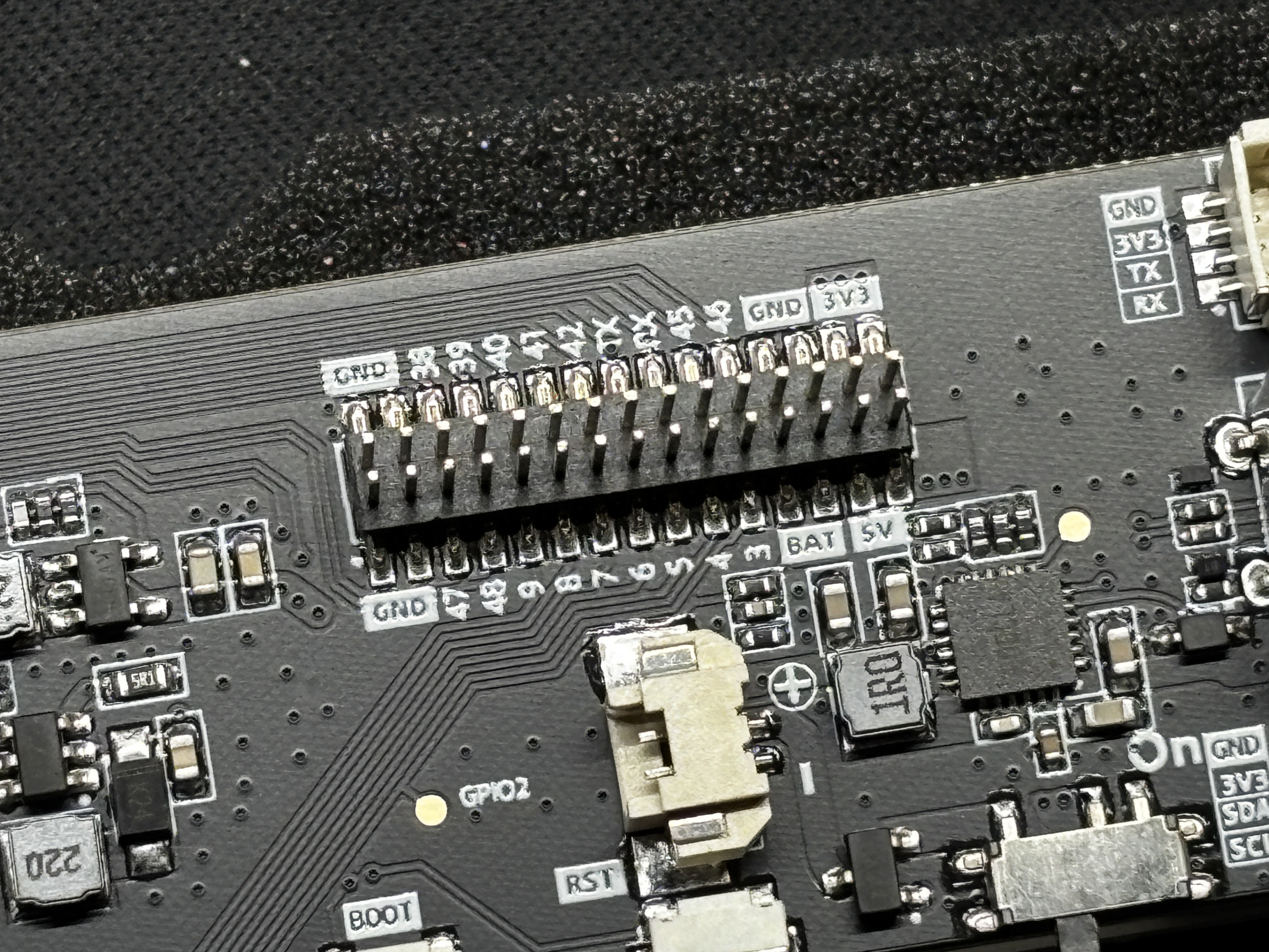

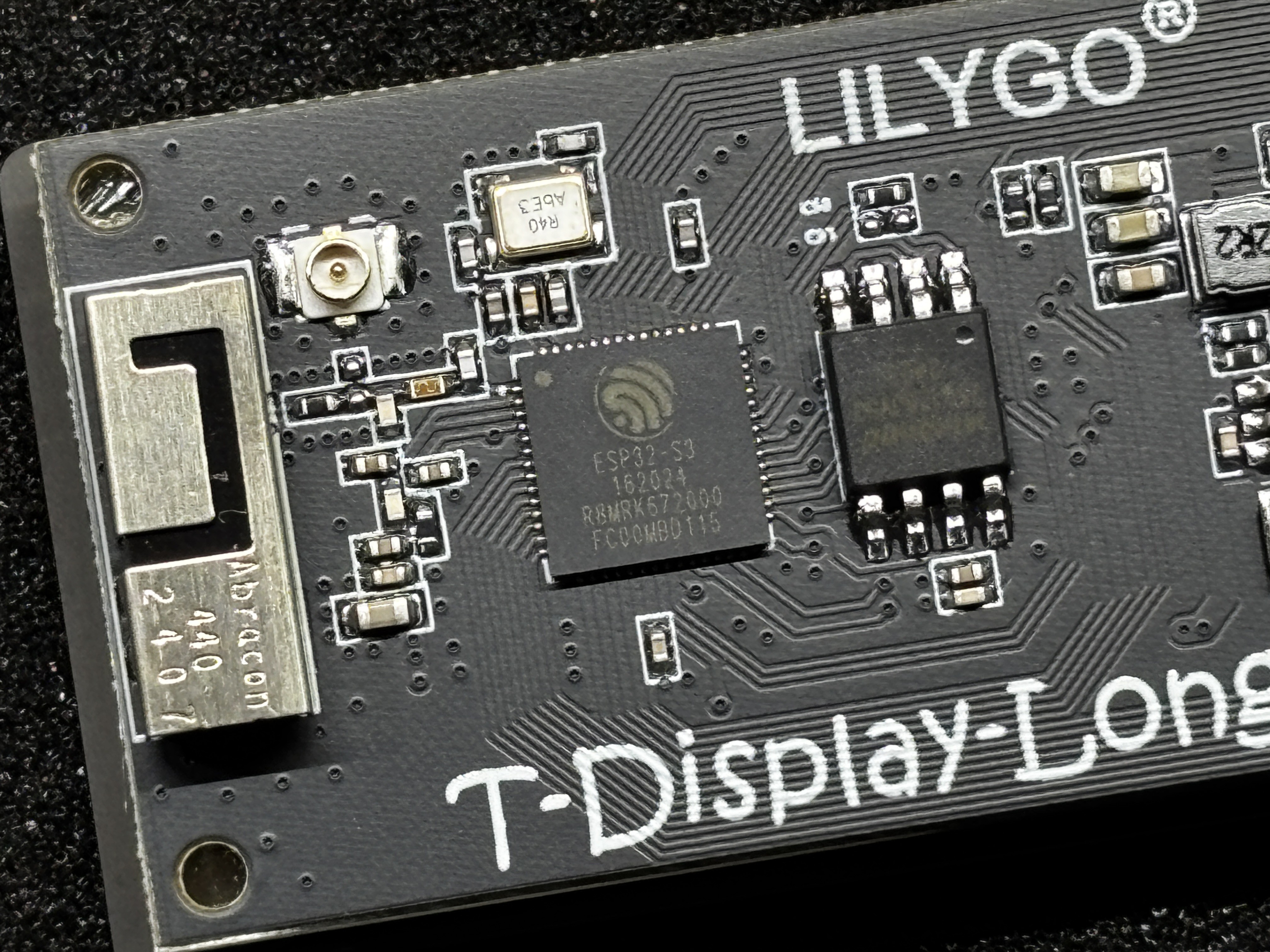

TTGO T-DISPLAY ESP32 S3 LONG
The Liligo TTGO T-Display S3 Long, which is the brain of this project, is powered by an ESP32-S3R8 dual-core LX7 microprocessor and provides strong performance for demanding applications.
It is perfect for connectivity projects because it has Bluetooth Mesh, BLE 5, and Wi-Fi 802.11. It can easily handle complex graphics and multitasking thanks to its 16 MB of flash and 8 MB of PSRAM.
Its most notable feature is the 3.4-inch capacitive touch TFT LCD, which uses a QSPI interface and has a 180 × 640 RGB pixel resolution, making it ideal for touch-enabled, long displays.
I think LILIGO should have created a proper wiki to make this amazing hardware user-friendly because I had a very difficult time figuring out exactly how we can use this display and had to rely on the Volos Project Video about the TTGO T DISPLAY S3 LONG Board. The information on this display is very limited; by limited, I mean the documentation is very weak. I suggest you should watch Volos Video on the board because it goes into great detail regarding essentially every aspect of this display.
