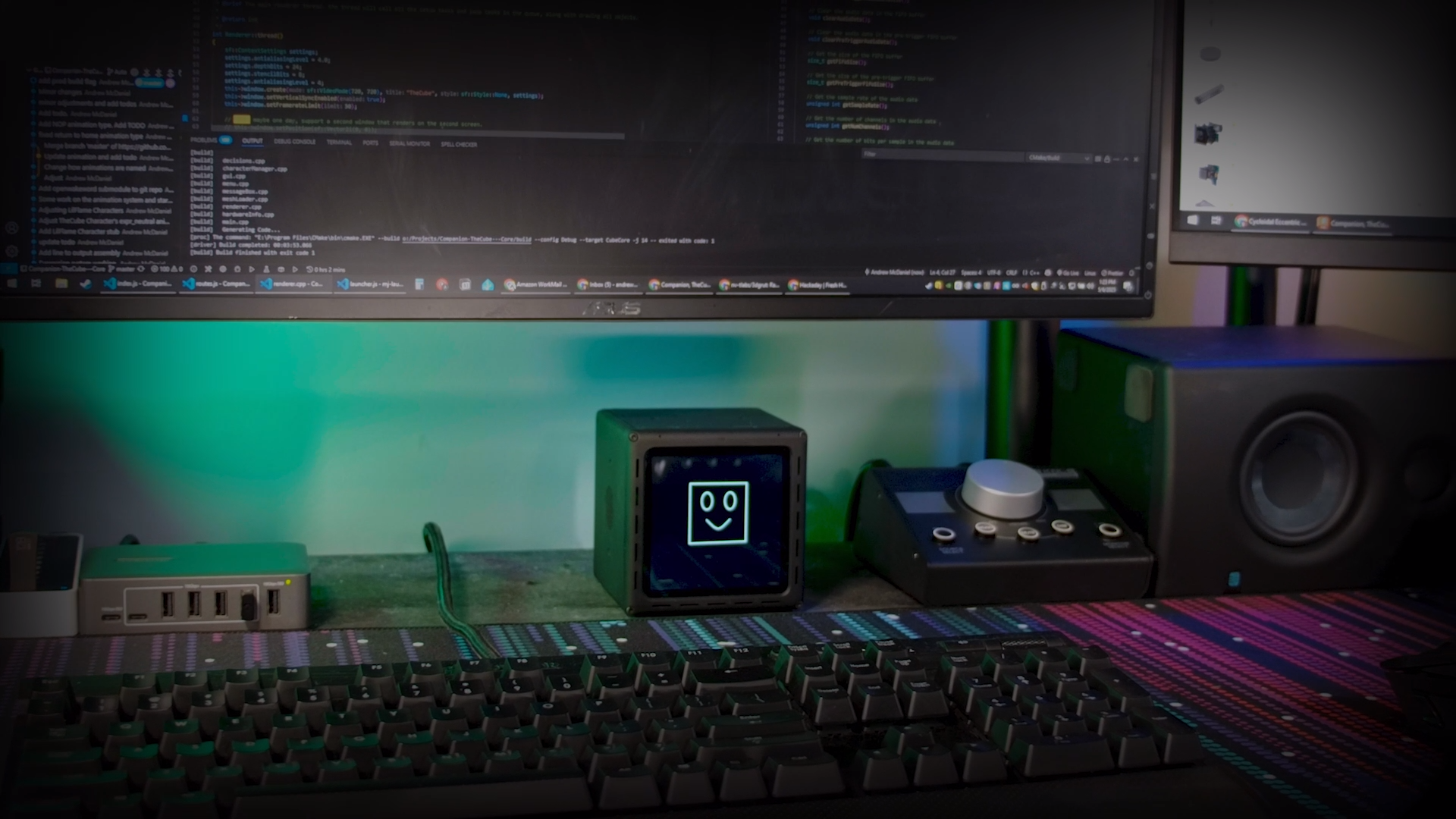

TheCube is a 10cm³ desktop companion powered by Raspberry Pi 5. At first glance, it looks like a simple cube with a screen — but it’s actually a hybrid of productivity tool, desk assistant, entertainment hub, and Tamagotchi-style virtual pet.

    Every project needs a “Hello World,” and for TheCube, mine is simple: get the hardware booting, the display working, and the voice pipeline online.
    Here’s where things stand so far:
    Hardware Prototype
    • Raspberry Pi 5 with 8GB RAM + NVMe SSD
    • Custom carrier board (in progress) for expansion ports and clean stacking
    • 4" square 720×720 LCD (DSI)
    • mmWave presence sensor hooked into GPIO
    • Stereo mics + speaker wired through USB audio adapter
    • Early 3D-printed shell with magnets embedded for stackability
    Software Stack (early build)
    • Base OS: Raspberry Pi OS Lite
    • Core process: C++ service managing JSON-RPC app interface
    • Voice pipeline:
      • Wake word → [OpenWakeWord]
      • Speech-to-text → Whisper.cpp (local inference)
      • Intent parsing → in-progress - Function Registry + Spacy + AI model
    • Display: SDL2-based renderer (Planned. Currently using SFML.)
    • First “Hello World”: TheCube listens for “Hey Cube,” and prints a notification to stdout/log.
