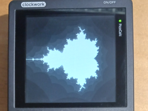

After completing the steps above, turning on the PicoCalc should launch MachiKania. It will look like the image below.
Now that the editor has launched, you can start writing BASIC programs right away. You can also load a program by pressing the “F1” key. The image below shows the program list that appears after pressing “F1” and navigating to the “SAMPLES” directory.
In the file selection screen, pressing the up or down arrow keys will move the highlighted selection, indicated by a blue arrow. To load the selected file, press the “Enter” key. Once the program is loaded, it will appear as shown in the example below.
To run the program, press the “F4” key. The result of executing “RAYTRACE.BAS,” as shown in the image above, is displayed at the top of this page.

MachiKania is characterized by its ability to execute BASIC programs at high speed. It runs at about half the speed of C and several times faster than Python. Try running the sample program "MADELBR.BAS" to experience it.
This is a port of "mand.bas" originally written for MMBasic, adapted for use with MachiKania. While MMBasic takes about five minutes to render the entire image, MachiKania completes it in just over ten seconds. This difference is due to MMBasic executing programs in an interpreted format, whereas MachiKania processes them using a compiler-based approach.

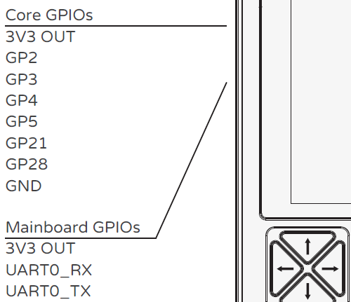

To use GPIO with PicoCalc
On the left side of the PicoCalc unit, there are terminals connected to the GPIO port, which can be used. The PicoCalc manual includes the following description:
As you can see, GP2, GP3, GP4, GP5, GP21, and GP28 are available along with 3.3 V and GND. In addition, "UART0_RX" can be used as GP1 and "UART0_TX" as GP0. However, when using GP1 (UART0_RX), you must set the internal board’s "SEL1" DIP switch to "M_UART_RX". Failing to do so may result in device malfunction.
