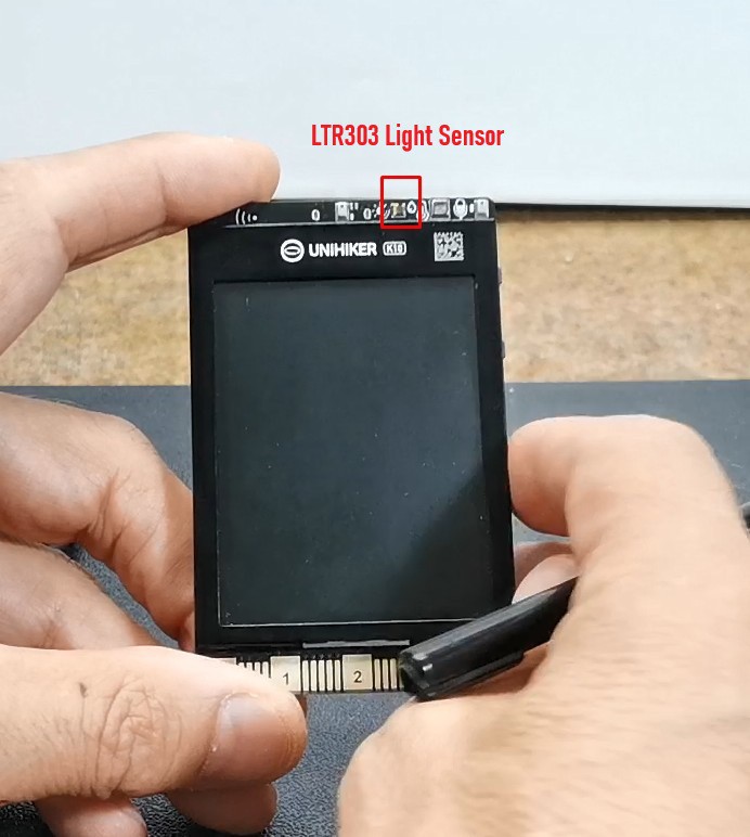

After this, it was logical to try to activate some sensor from the board, and its values would be displayed on the Analog meter. I decided on the LTR303 light sensor located just above the display.
In this case, I use the Adafruit library designed for this type of sensor. I took most of the program from the example in the library and it concerns drawing and moving the needle of the analog meter. The other part uses the Adafruit library to read the values received by the sensor. To my surprise, this library also functions quite normally on the K10 development board.
The device is very practical and displays several parameters. The main part is the analog meter and it displays the relative light intensity received by the sensor on a scale from 0 to 100.
This value is numerically displayed on the lower left part of the instrument. Below the instrument are two important values: the raw value provided by the sensor and the range in which the instrument is currently operating. The value of the light intensity can be easily expressed in Lux units using a simple formula provided by the sensor manufacturer.
The real raw values for the intensity of light from complete darkness to direct sunlight range from 0 to several tens of thousands, so if the entire range was displayed on this scale, the resolution would be extremely low. Therefore, for greater precision and flexibility of the device, I introduced auto-range min-max values, which are based on the light intensity at the moment the device is turned on. If the intensity at a certain moment exceeds the limits of the set range, it will automatically change. Let's see how it looks in reality.
